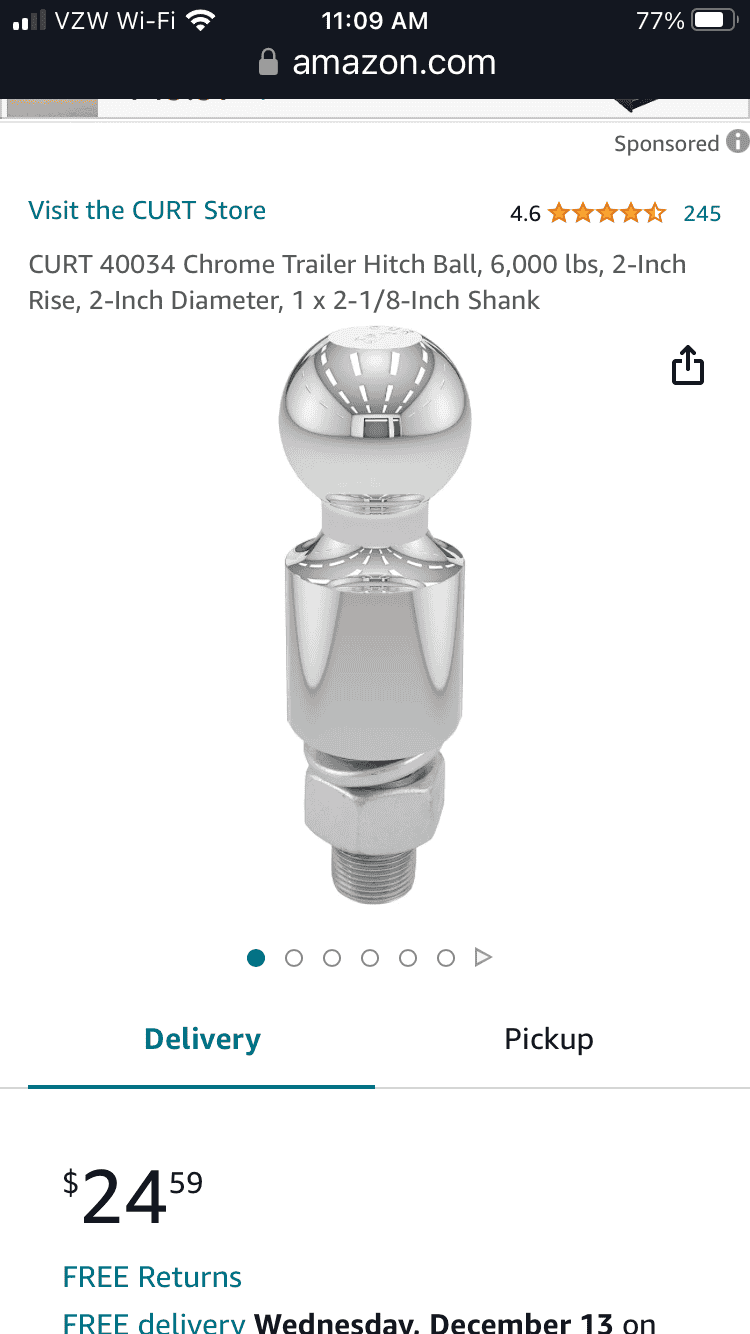

One thing that perhaps would make you sorry on the trail is turning radius would be a bit less, and right now you can Jack knife that trailer about ninety degrees you would lose a lot of that.
Ok thinking way outta the box and just throwing it out there, if your hitch skid had a solid receiver bar stock could you drill it and mount a ball just past edge of bumper. In other words you would have a raised tall 2” ball mounted ahead of the skid. The ball I am talking about is taller then standard so you would have more height. Just saying Bobby!…..Jack
Jeep Gladiator X IMG_2299

Most trailers have the hitch coupler mounted about 18 inches above the ground.
On my stock JTR, I would have to buy a drawbar with a 4 inch drop
in order to pull a trailer level.
A trailer should be level or slightly lower at the hitch
to prevent jackknifing.
