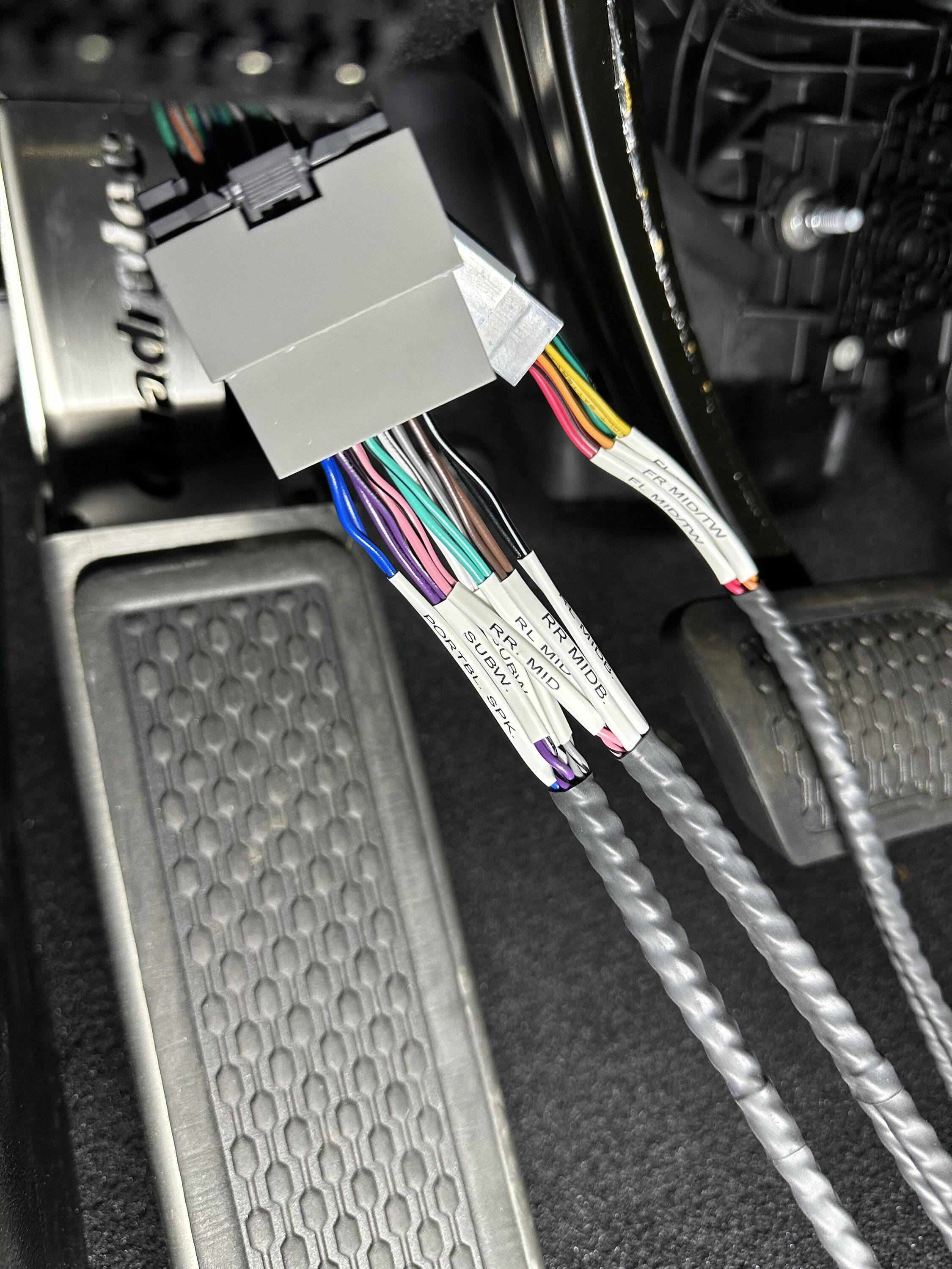

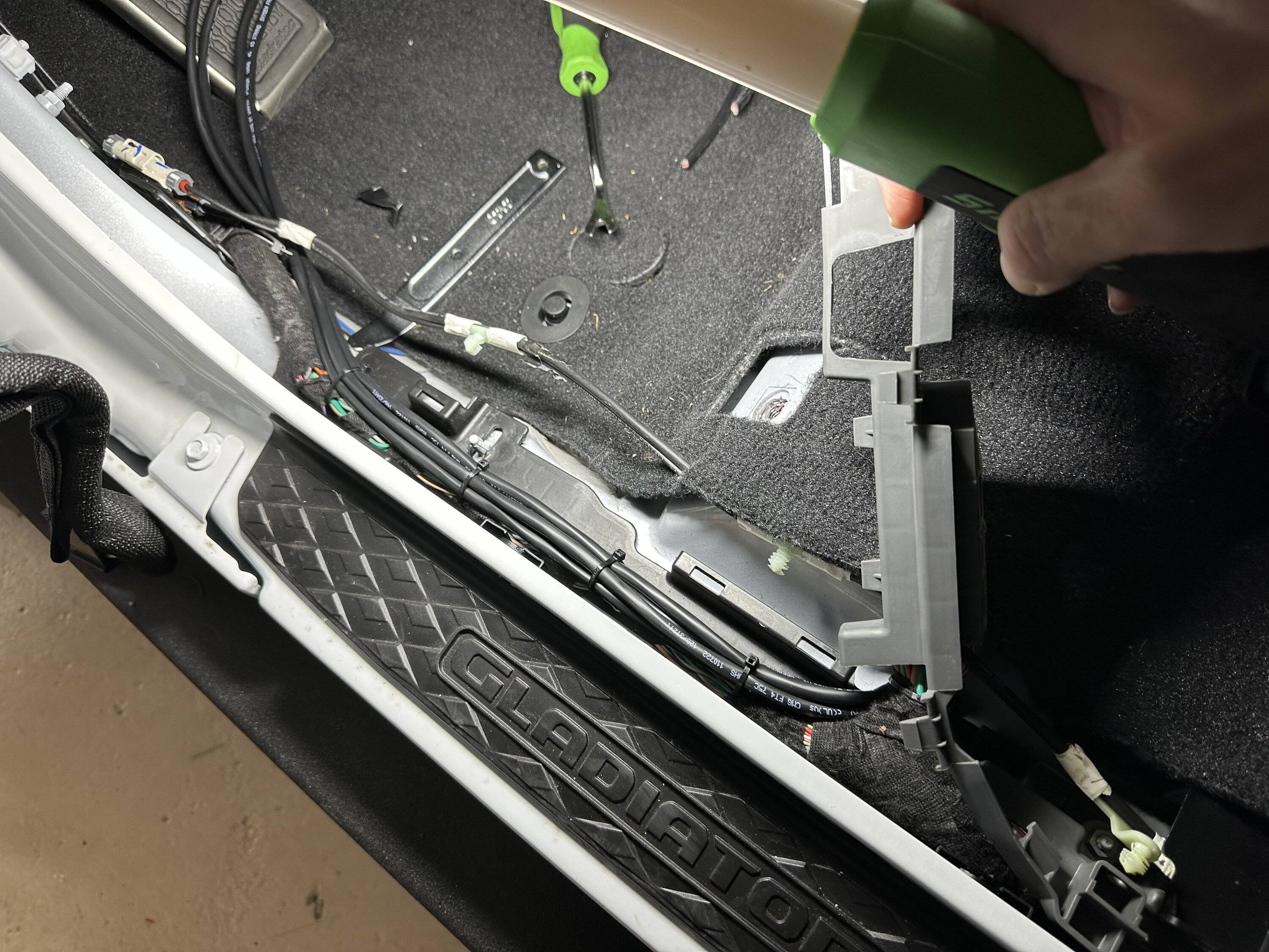

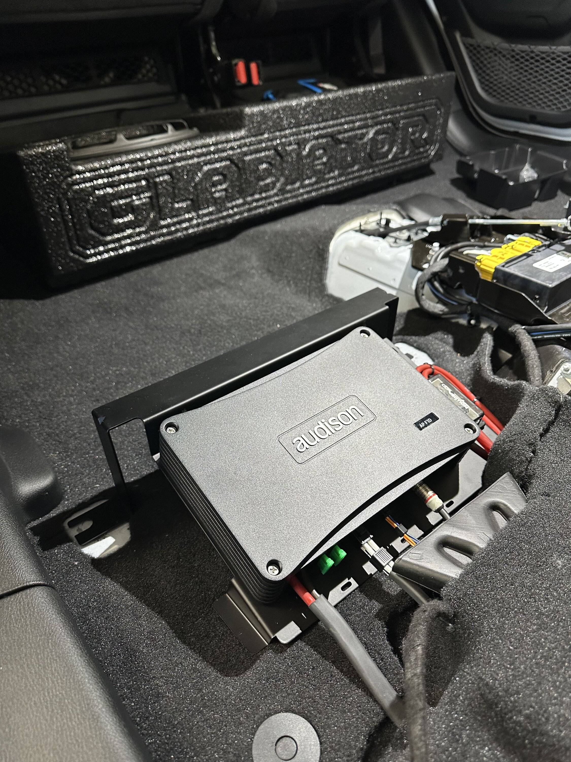

Enter Musicar NW of Portland, OR and an Audison DSP Amplifier - based upgrade…
I contacted my buddy Sean at Musicar Northwest to discuss my various ideas and goals. He patiently quoted me a variety of options and explained the pros and cons of each decision I needed to make. Upgrading OEM amplified systems is one of their specialties (they do a lot of high-end German cars and Teslas and so forth) and he helped me confirm all of my research and assumptions regarding how to upgrade a Jeep in the least-intrusive manner possible. They tend to deal in higher-end brands such as Morel, Focal, Audison, Hertz, HELIX, BRAX, etc., but he was happy to follow my requests for various components (as long as it was something he felt comfortable recommending/using himself).

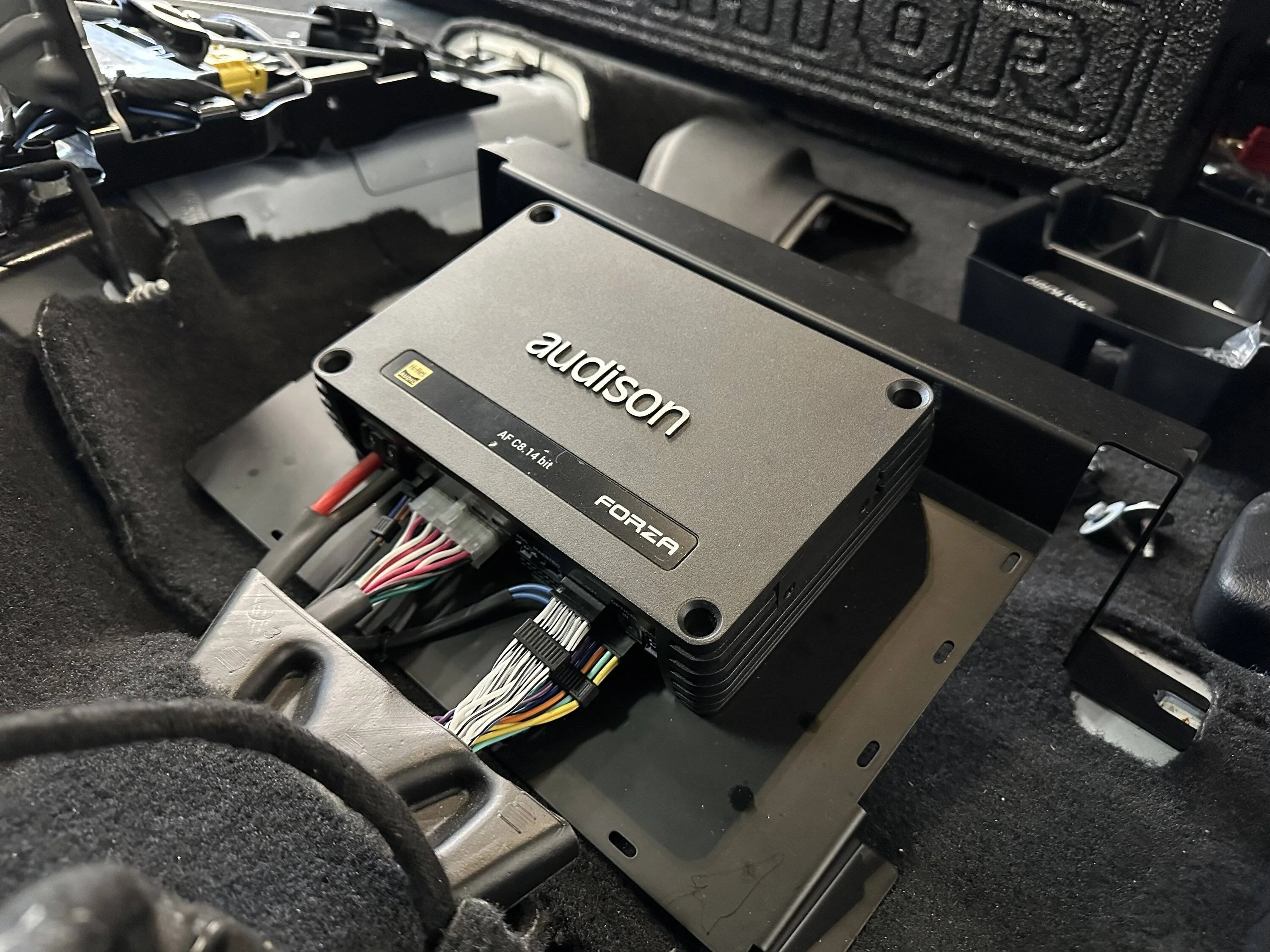

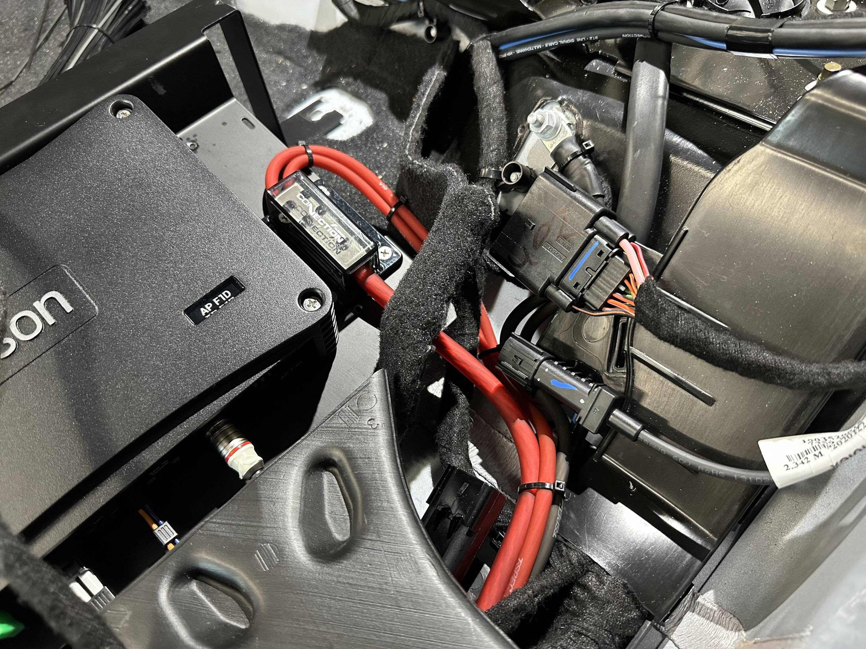

Newly installed major parts:

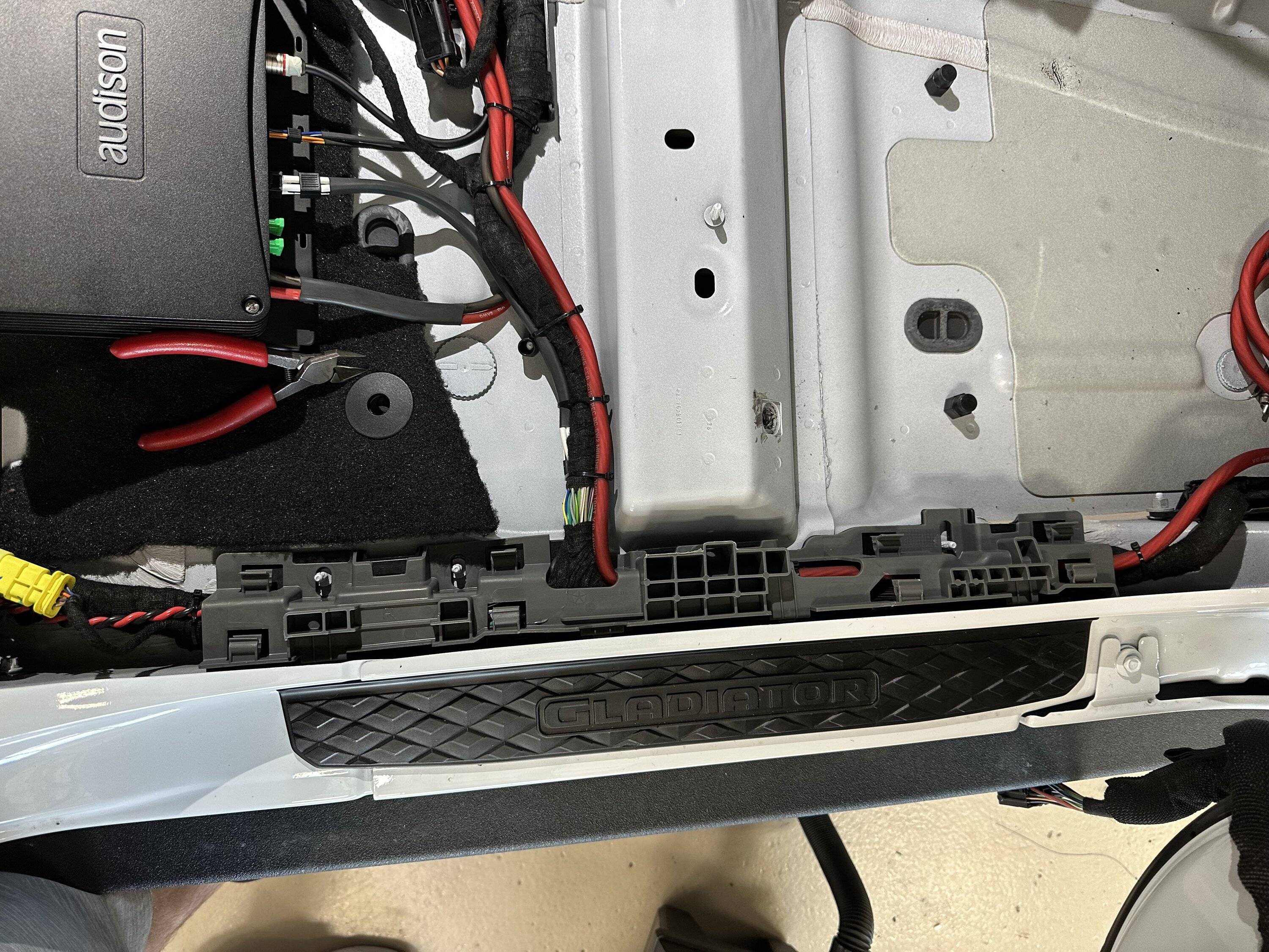

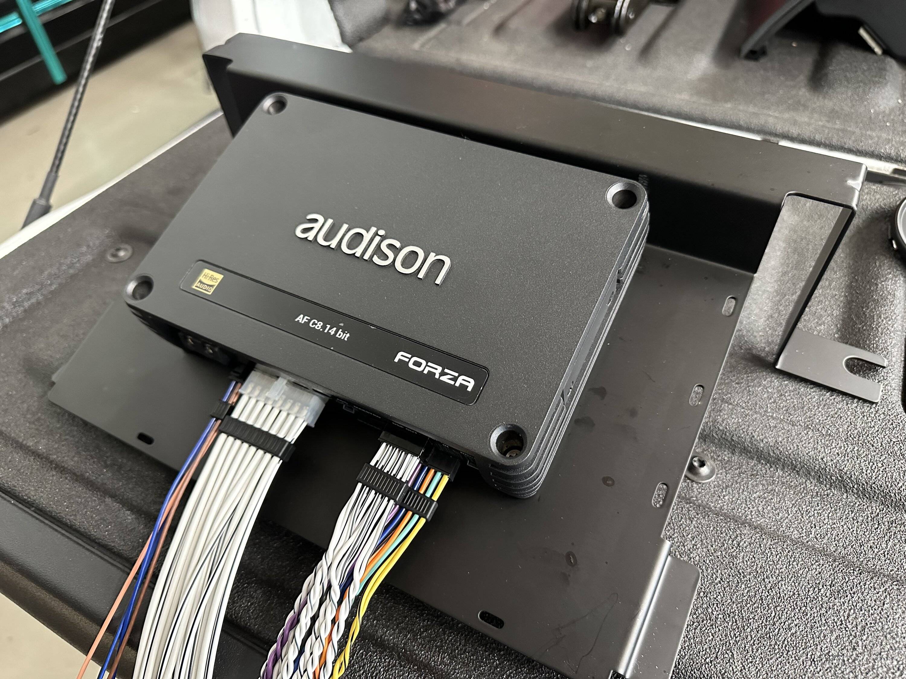

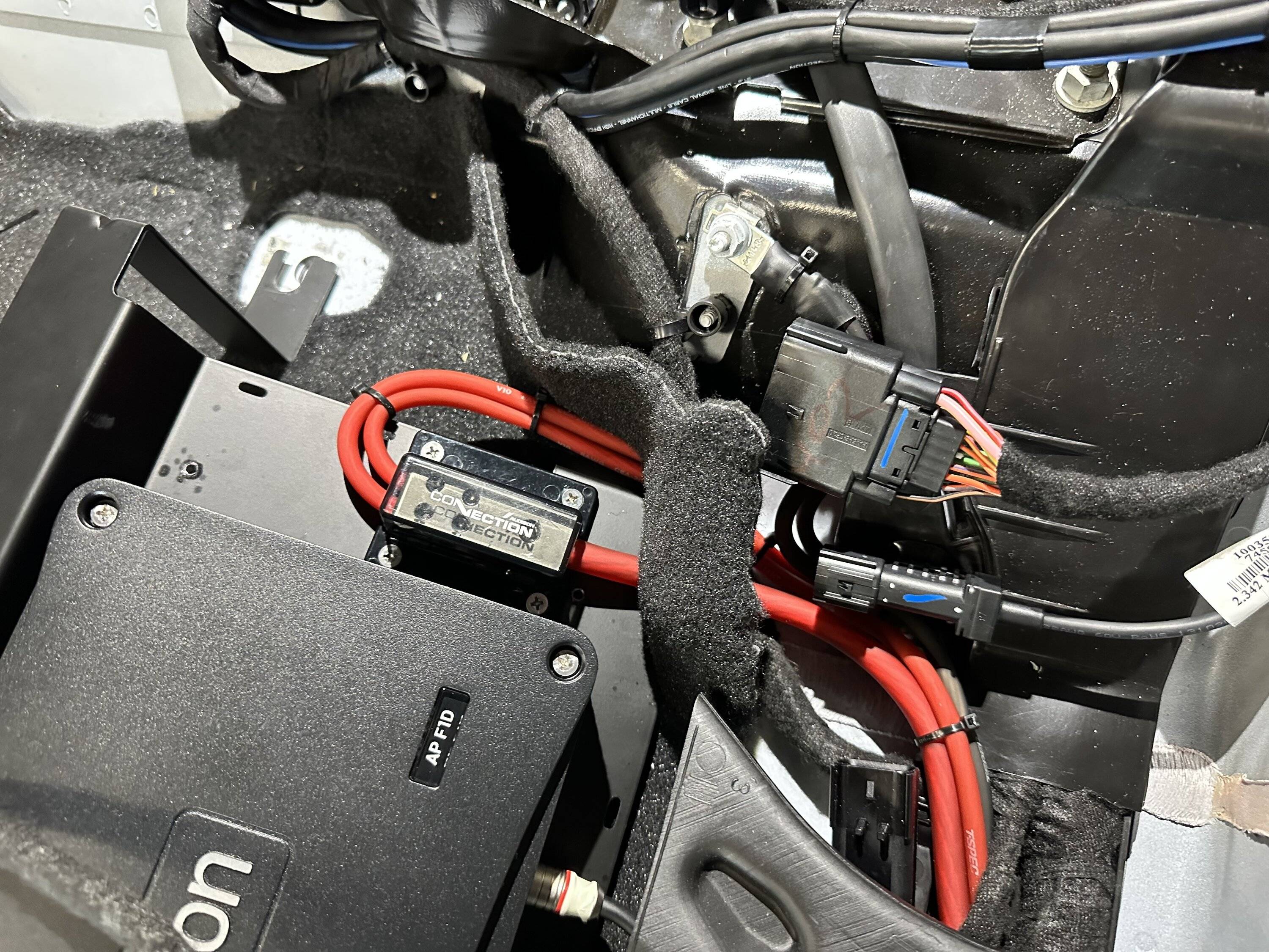

This effectively replaces the active factory amplifier with an active 8 channel amplifier and a mono amplifier for the subwoofer stage. The newest Audison bit DSP software allows for custom-assigning individual outputs based on individual or summed inputs, de-equalizing and flattening the factory headunit output, removing any factory time correction, complete crossover and EQ tuning, per-channel phase correction, etc. It’s a very impressive bit of kit, especially in the right tuning hands. Sean initially recommended HELIX DSP amplifiers (amazing in their own right), but I preferred the small footprint and clean install packaging of the Audison components. The Audison rep for Elettromedia also lives here in Portland and I always like supporting the local guys ?
Everything is tied together with an incredible install and final tune by their amazing installation and tuning staff. Pierce and TJ did an amazing job on my truck; by far the cleanest and most thoughtful install I’ve ever had on the variety of vehicles I’ve owned and upgraded over the last 25 years. The attached pictures of the work in progress do not do their talents any justice. Thanks to the plug-and-play products and careful install, everything is completely reversible if desired in the future.

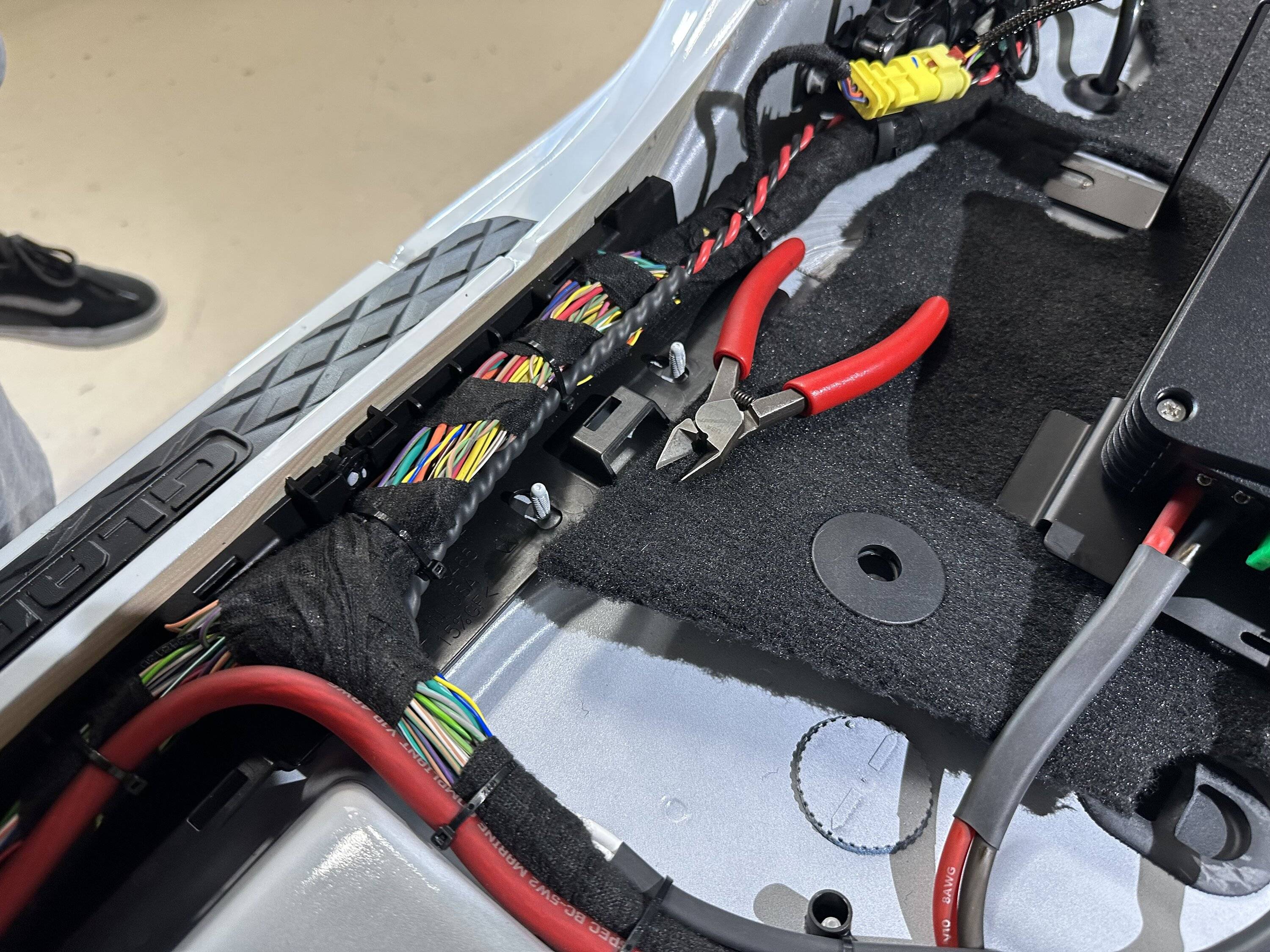

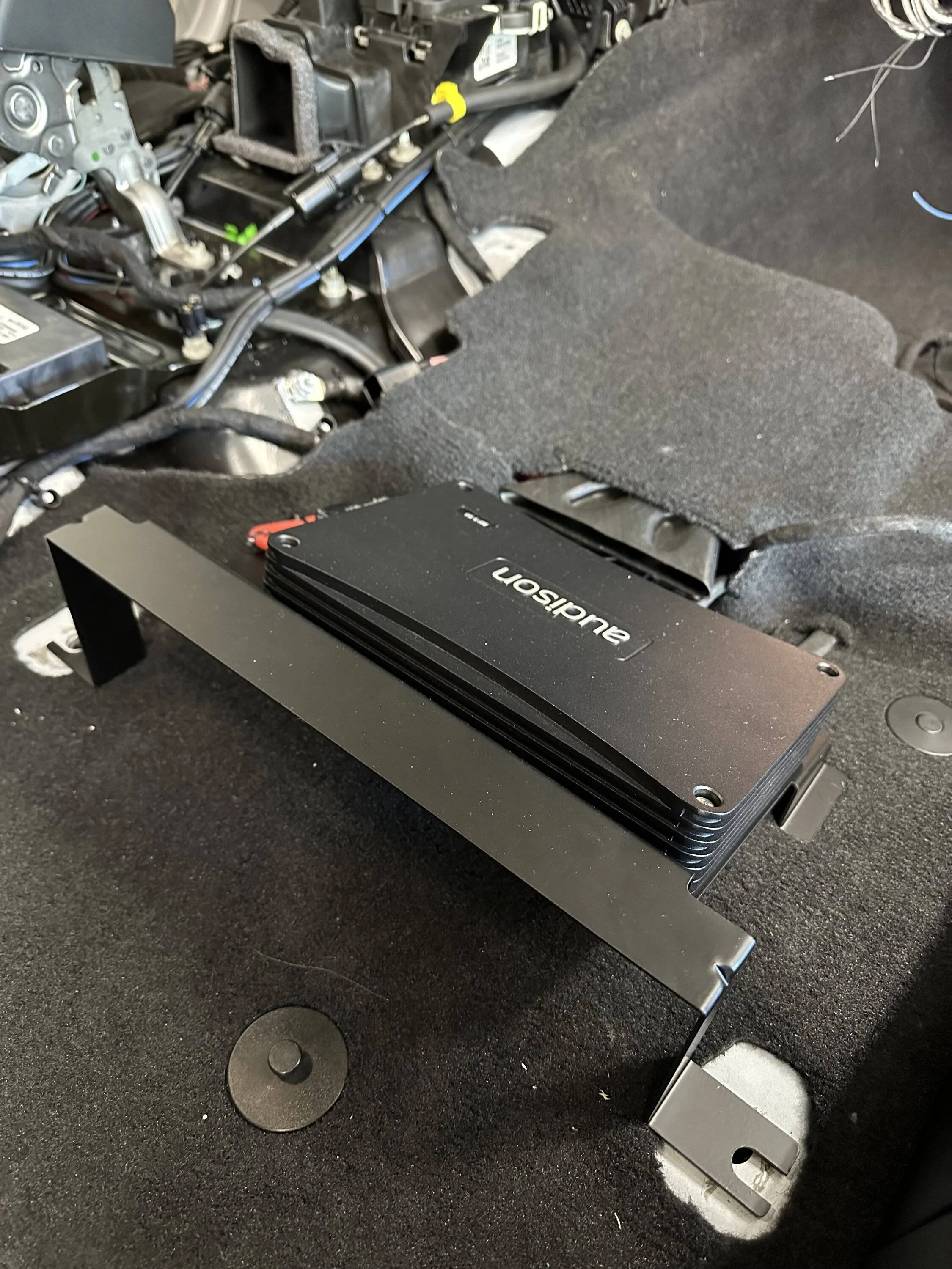

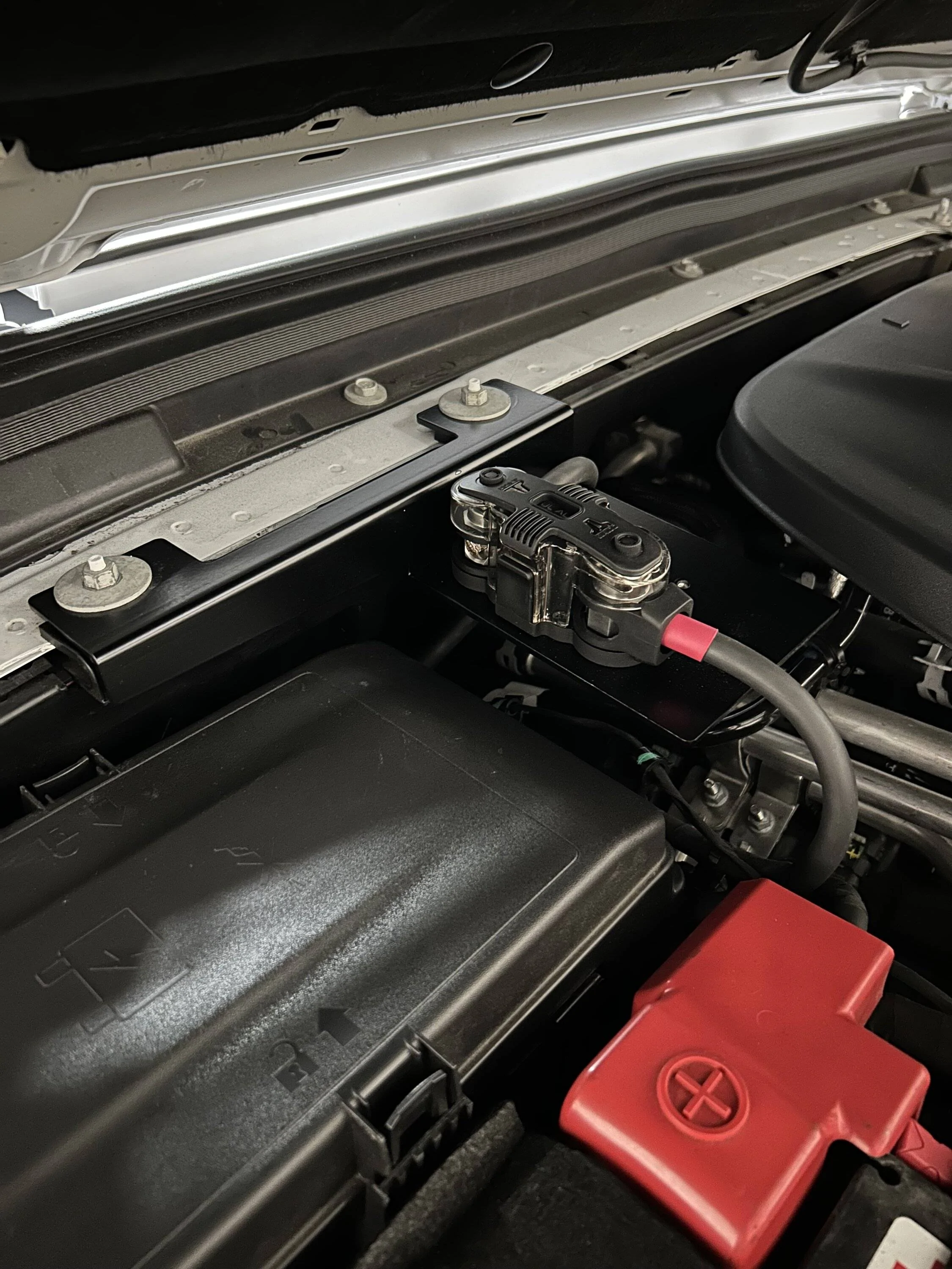

The Metra amp racks and JL fuse holder bracket for JL/JT make things that much easier for us Jeepers; it’s nice to have a vehicle that is supported so thoroughly by the aftermarket. These kinds of easy solutions for things like fuse and amp mounting give the installer more time to focus on the finer details. The second fuse holder position on the bracket is still available for a future project, such as a high-power inverter or onboard air…or more stereo ?

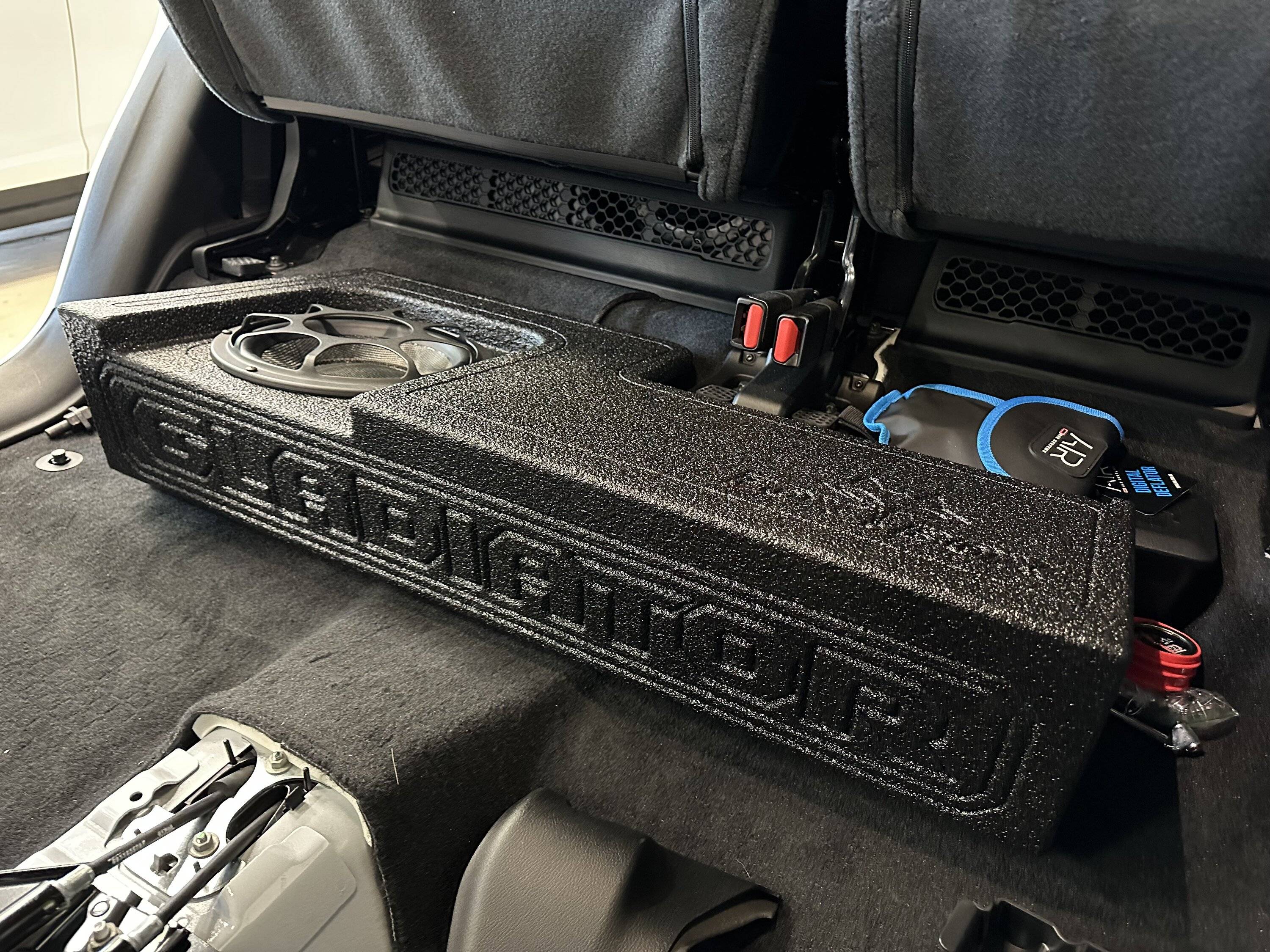

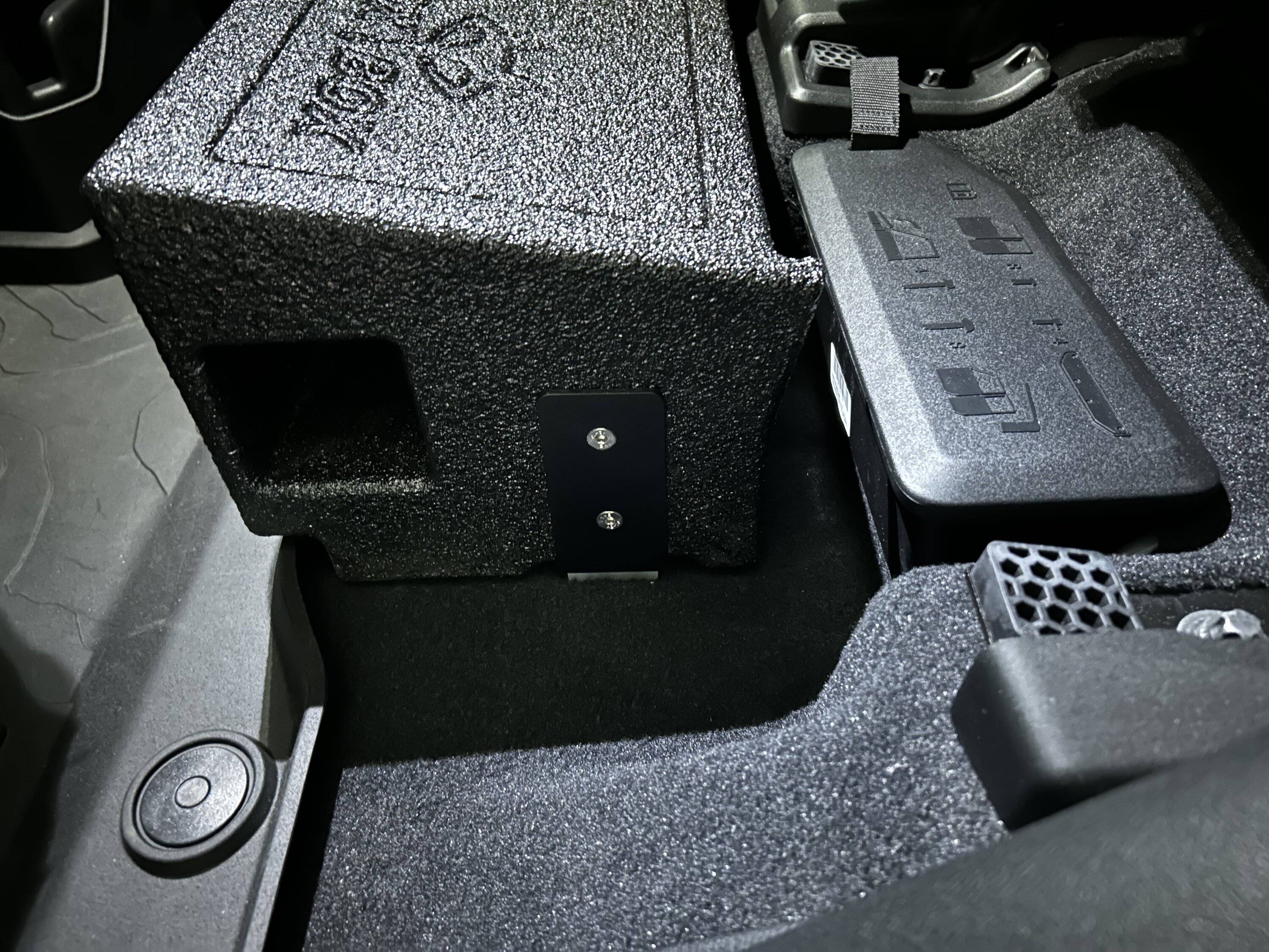

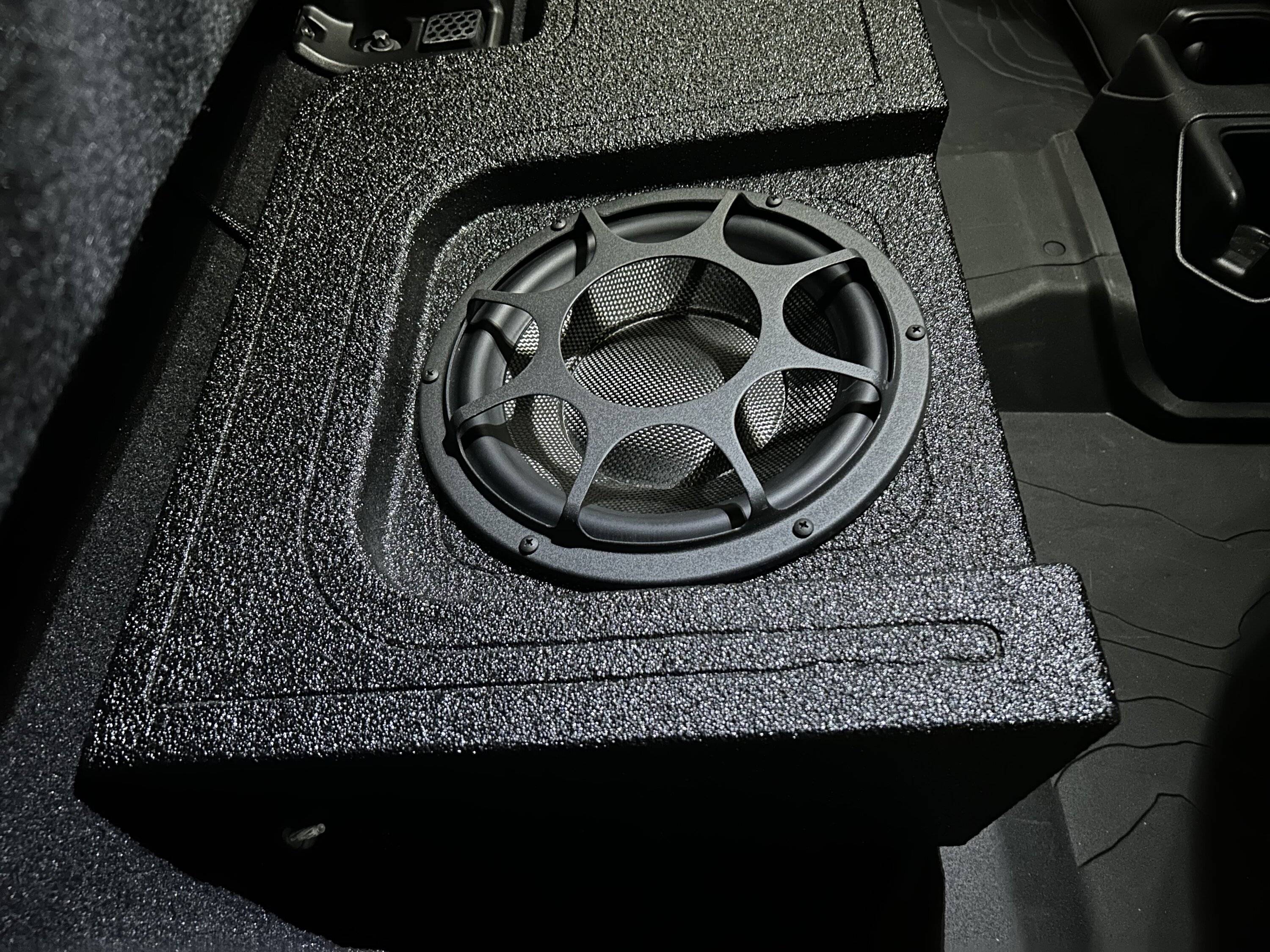

The Fox Acoustics enclosure is nicely constructed, but does not include any provisions for mounting, which would be concerning during any kind of evasive maneuvers, offroad inclines or an accident. One benefit of the Fox box versus other pre-fab options is that it retains the OEM hardtop hardware box whereas others require moving it; there’s also a bit of room on each end for odds and ends under the seat. Pierce was able to utilize existing OEM fastener locations to mount the box on the passenger side through the bottom wall of the enclosure under the woofer, and on the driver’s side with a custom aluminum bracket down to a factory attachment point. This kind of clean and seamless custom bracketry is why I love a highly-skilled boutique shop like Musicar; their standards are far higher than mine and they have the unique tools and resources to quickly produce just about anything. Custom CNC aluminum parts and 3D-printed doodads are commonplace to their installs.

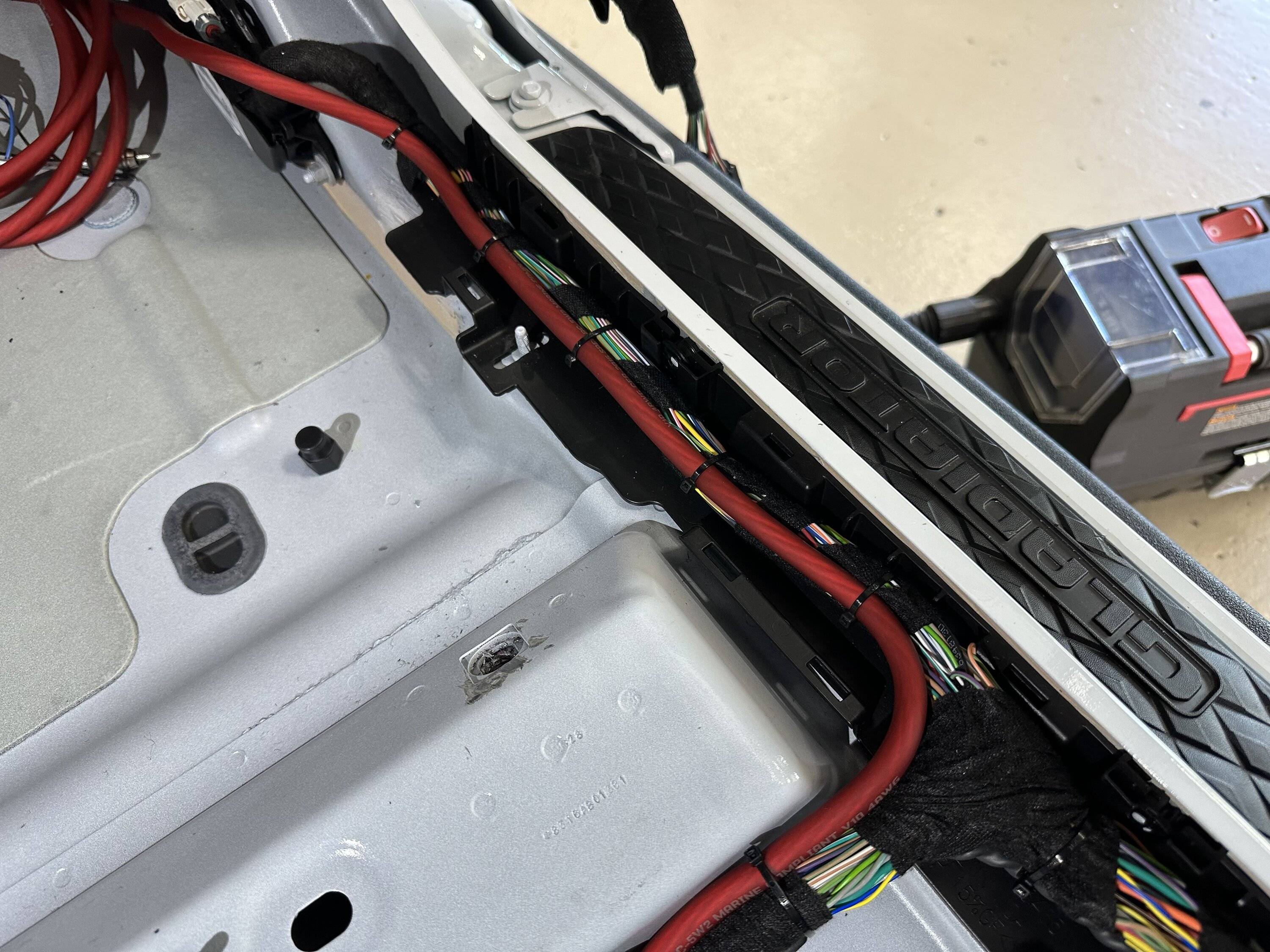

Another nice touch was their utilization of a open high amperage lug within the factory power distribution box to minimize any extra attachments at the top of the battery.
The PAC Audio interface and Audison amps integrate perfectly into the OEM system with absolutely no hiss, turn-on/turn-off pops or otherwise. I’d never know any of it was there if it weren’t for the significantly-elevated audio quality and much-bigger thump emanating from the back seat. The only visible part of the install is the small bass knob mounted to the front of the shifter console. It is as if the factory system is still in place but with a nuclear reactor powering it ?
The only downside is the predictable bummer of the loss of most of the underseat space; front seats for amps and rear seats for the sub. You could certainly do a similar upgrade with a smaller and/or single amp as well as a smaller sub configuration if you wanted to keep more interior space available.
I’m absolutely stoked with the final product and definitely did not think that a Jeep could sound this good with stock / mild speaker upgrade, even with the Sunrider top flipped back. It’s easy to get a lot of volume in the rear of the cabin with a sound bar full of 6.5’s and lots of wattage, but doing it with a correct front stage and correct processing/tuning makes all the difference in the world for making it sound great. I am looking forward to a second final upgrade including upgraded midrange front speakers in the knee panel and sound bar with a retune for the finishing touches. Thanks to everyone at Musicar for an A+ install, and to a variety of different threads in these forums for helping me research my decisions.

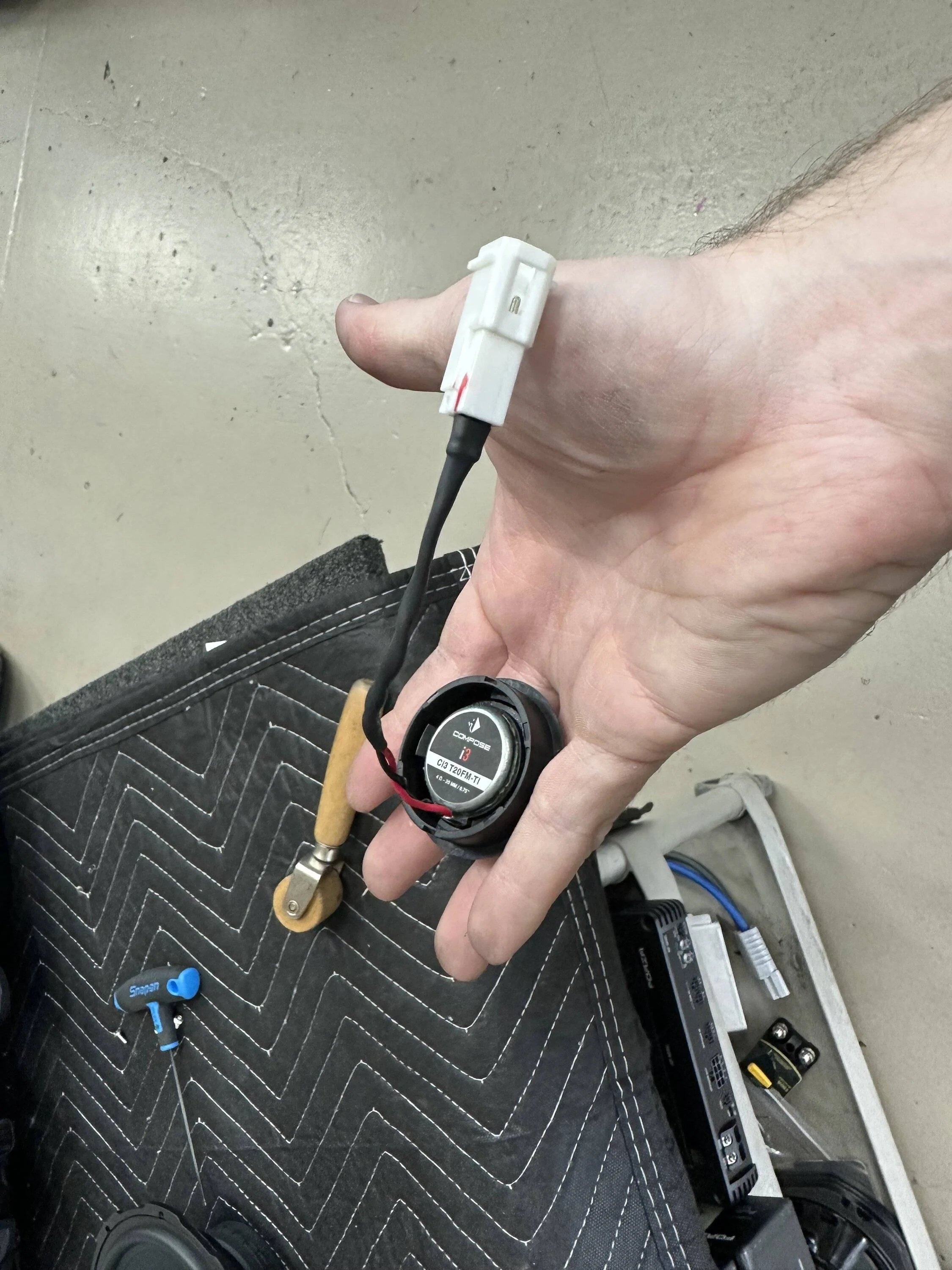

Round 2! Shortly before SEMA I decided to have Musicar NW finish the up the system...the first round upgrade of a DSP Amp + Sub upgrade had turned out far better than I ever imagined and I was eager to go even further ?
The previous tune was amazing for taking advantage of every last bit of performance offered by the factory speakers, but a cheap 4" OEM midbass can only go so far. My rap and rock favorites sounded very good, but not quite great, without a deep and accurate midbass to fill in between the tweets/mids and sub.
After consulting with the Musicar team and going over my goals, they recommended using Helix's new Compose i3 line of midbass and tweeters. The Ci3 line is meant to bring the performance and tech of the Ci7 line down to a more affordable price-point while keeping much of the same overall design -- I believe the retail price on the Ci3 6.5" woofer/tweeter/crossover component set is $450 USD. Helix offers the Ci3 6.5" midbass in a 2 ohm option that allows for making the most of the Audison C8.14 bit amp. This gives a full 100w x 4 for the front and rear midbass, with 65w x 4 for the Terra Acoustics fronts and Ci3 rear tweeters. Doing this allowed for a healthy amount of power to all 8 channels in an active configuration, without any bridging or switching down to a 6 channel setup with a coaxial in the rear. This also allows for some future flexibility by allowing an easy switch to active 3-way setup in the front with passive 2-way in the rear. Helix sells the Compose Ci3 line as individual drivers or as a component set with passive crossover, so I was able to save some money by foregoing the unnecessary crossovers.

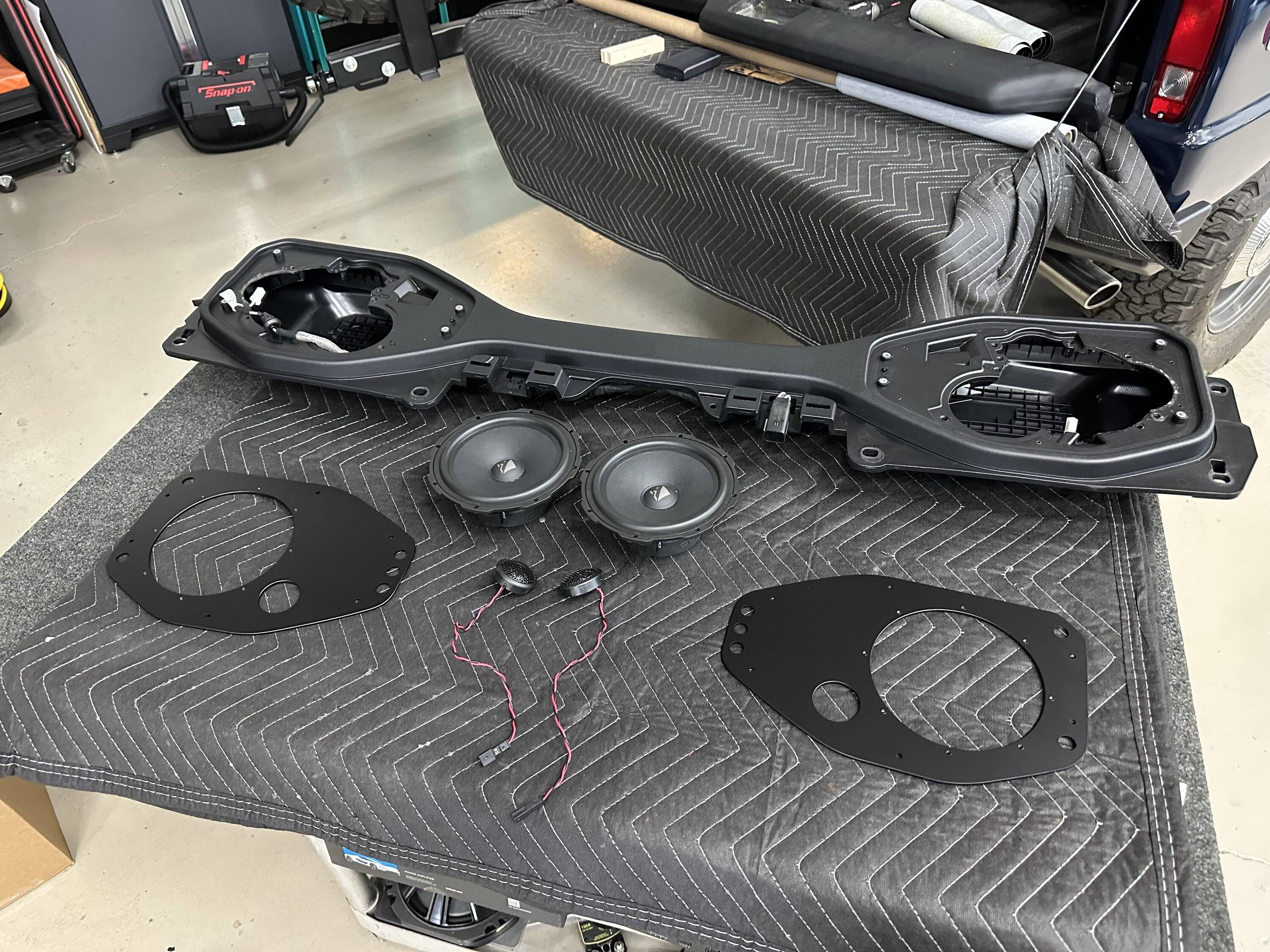

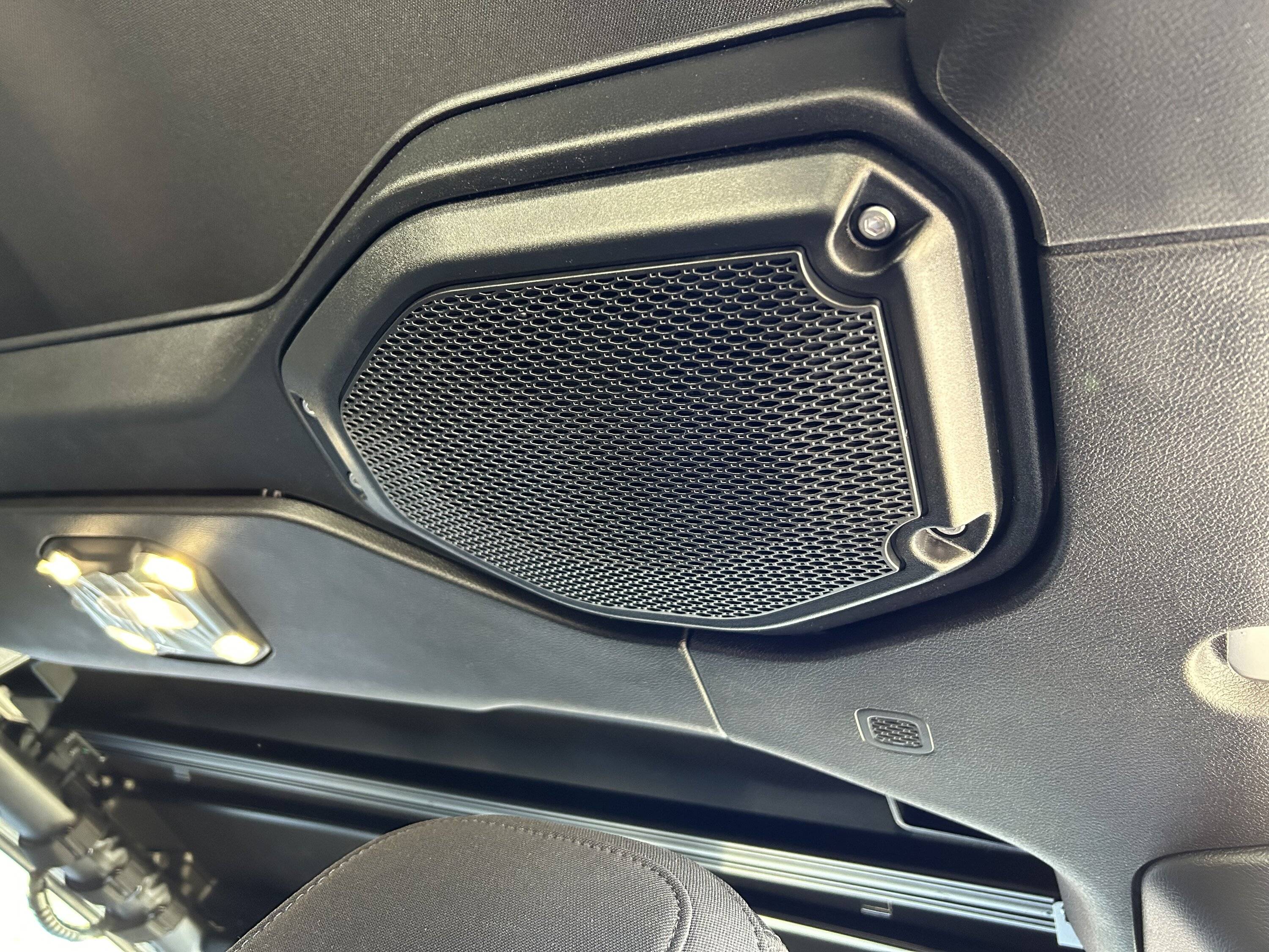

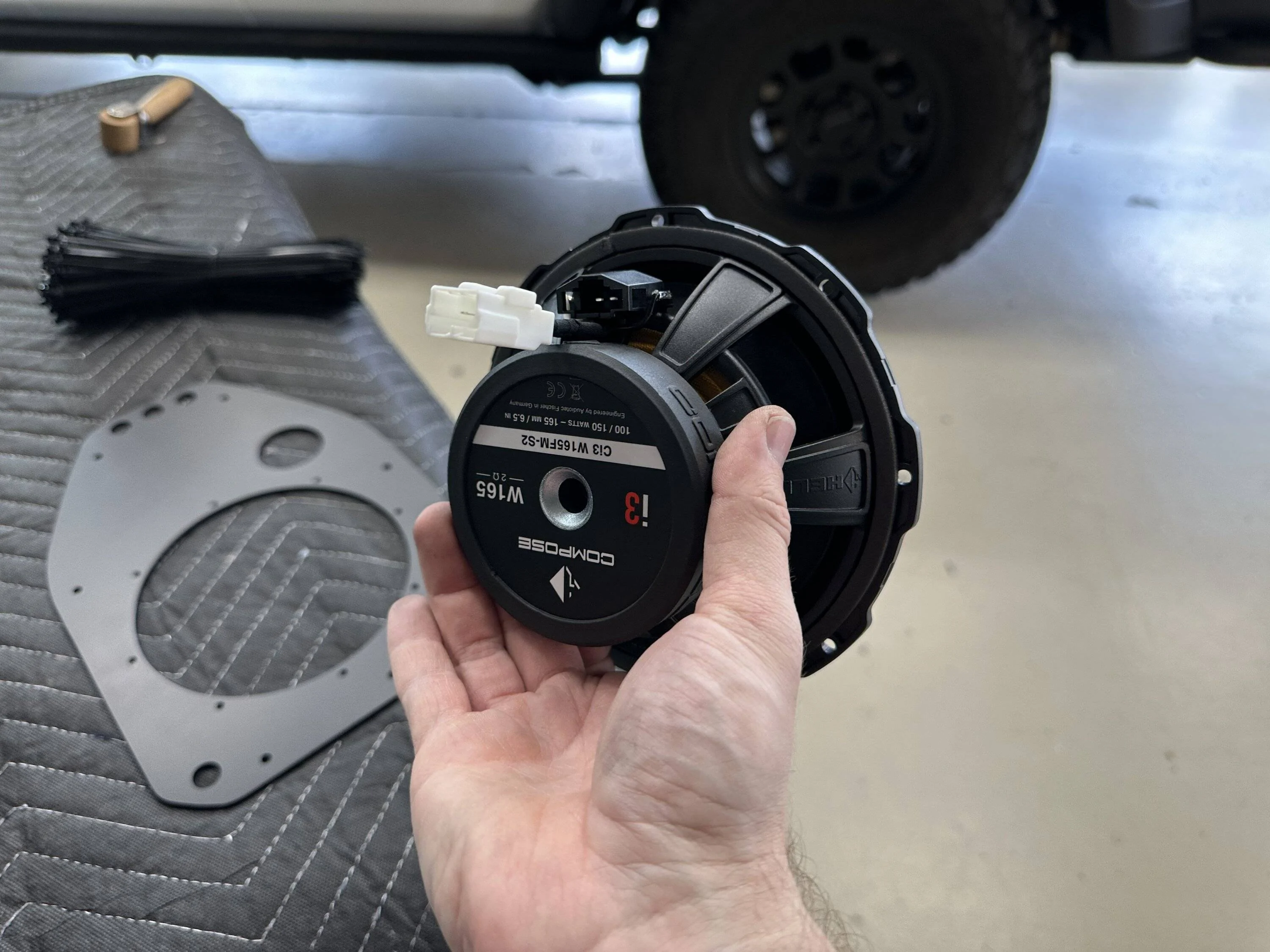

This upgrade replaces the remaining 4 factory speakers and the previous MOPAR/Kicker 3.5" upgrade in the soundbar while retaining the Terra Acoustics fronts, which we felt would be right at home with the Helix woofers.
For speaker install, we used the standard Metra JL/JT front speaker pods and the Stinger JL/JT sound bar rear speaker upgrade kit. The Stinger sound bar kit was chosen over Select Increments, Metra and MB Quart options as the Stinger kit uses a new OEM-appearing grill to hide the speakers, but they do require cutting the sound bar.
Musicar did their normal sound deadening to the front pods, but they suggested going one step further on the soundbar kit. The speaker mounting plates provided by Stinger are ABS and easily flex by hand. This would have worked well enough, but these guys are all about the details, and they asked for permission to make a rigid aluminum plate instead, which I was happy to agree to. Their custom mounting plates turned out fantastic and work great within the Stinger grills and mounting kit. I'm sure they have the design saved and could resell the same setup if anyone is interested ? They also took the time to hard-wire the speaker adapters to the new speakers to eliminate the unnecessary spade connectors...they plug in just like a factory speaker would ?
New components installed:
Results? Absolutely amazing! A Wrangler or Gladiator utilizing all OEM speaker locations certainly won't be winning any professional SQ competitions against purpose-built competition vehicles, but the sound quality is absolutely amazing for a Jeep. Instruments and voices I'd never heard before in my favorite songs are now apparent and clear; the imaging is precise and focused incredibly well, despite all of the challenges and less-than-ideal speaker locations offered by a Jeep.
Even with the Sunrider top open, it only takes a low to middle volume setting to completely overcome all road and wind noise. The system never seems to be straining or operating near its limit; cranking the volume knob just amplifies the amazing sound with no distortion right up to my listening comfort limit. And even with such an elaborate upgrade, the truck is essentially unmodified -- the only cutting or trimming done was to the sound bar for the speaker mounting kit. No OEM wires have been cut and all other speaker mounts are OEM. I don't ever plan to return to stock, but this setup could easily be swapped into a new Gladiator in just a few hours with the various PnP connectors.
Regrets? Zero. There are some things I would do in addition or differently if I had a bigger budget, but I think it is absolutely perfect for the money that was spent. You'd also be hard-pressed to find a better-sounding Jeep without a much more elaborate or expensive build. Every component meets or exceeds my expectations and the sum is far greater than the parts. This build only scratches the surface in terms of what Musicar can really do, and I'm ecstatic with the final product.
Hope someone found this build interesting, and thanks so much to the entire Musicar NW team for the outstanding work and customer service every step of the way.

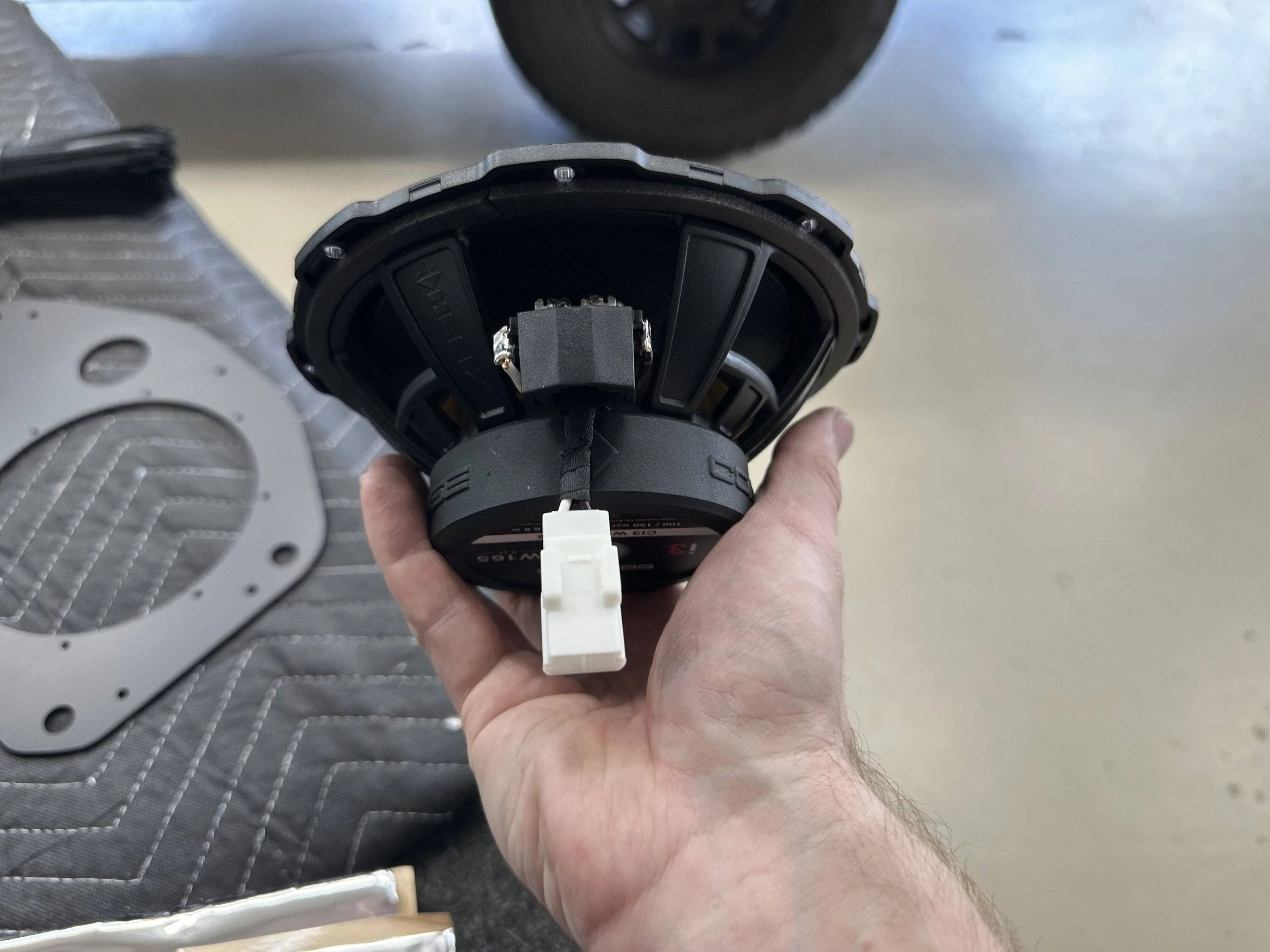

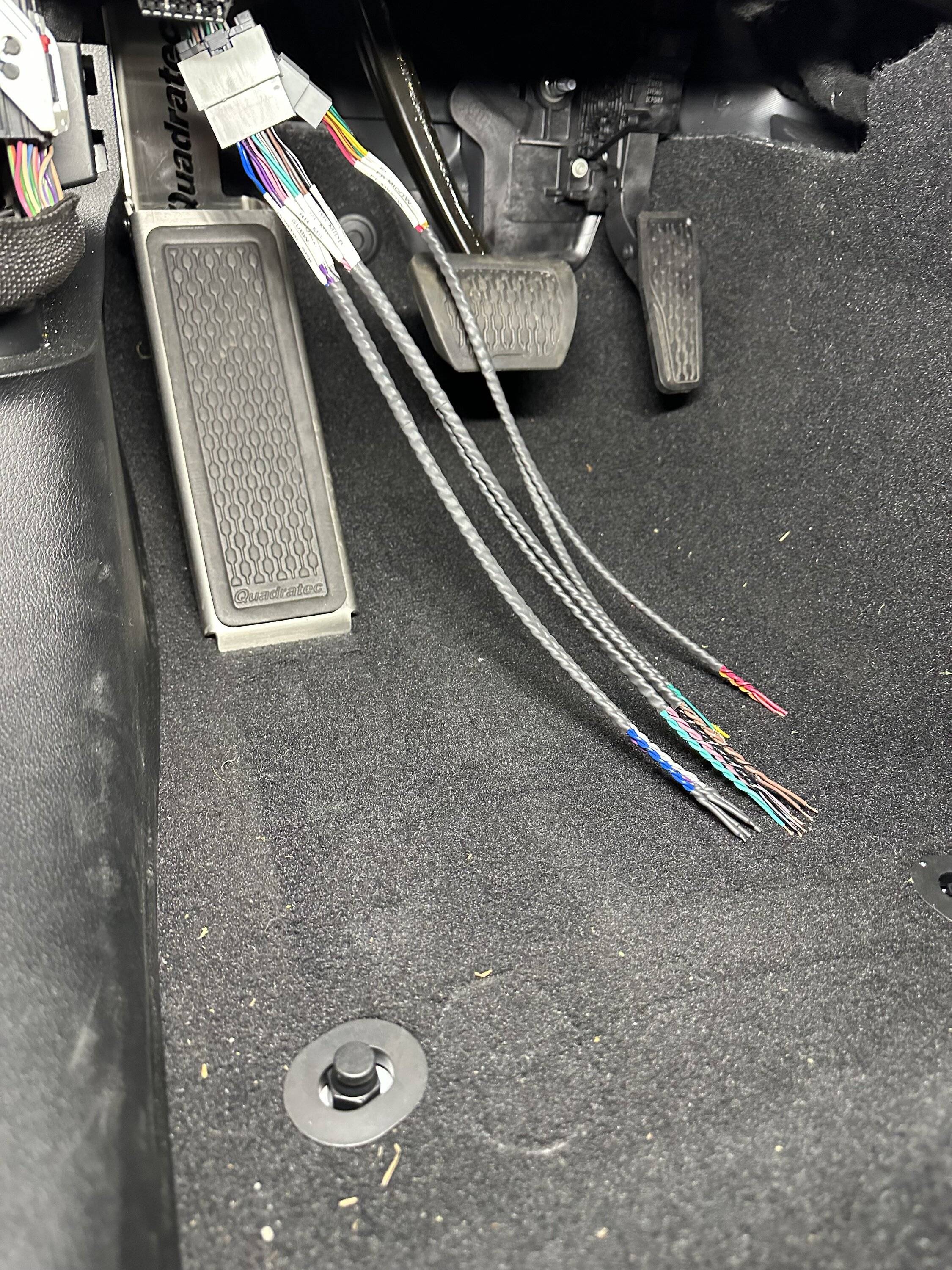

PnP Metra adapters hard-wired to speakers for a single-plug OEM connection:

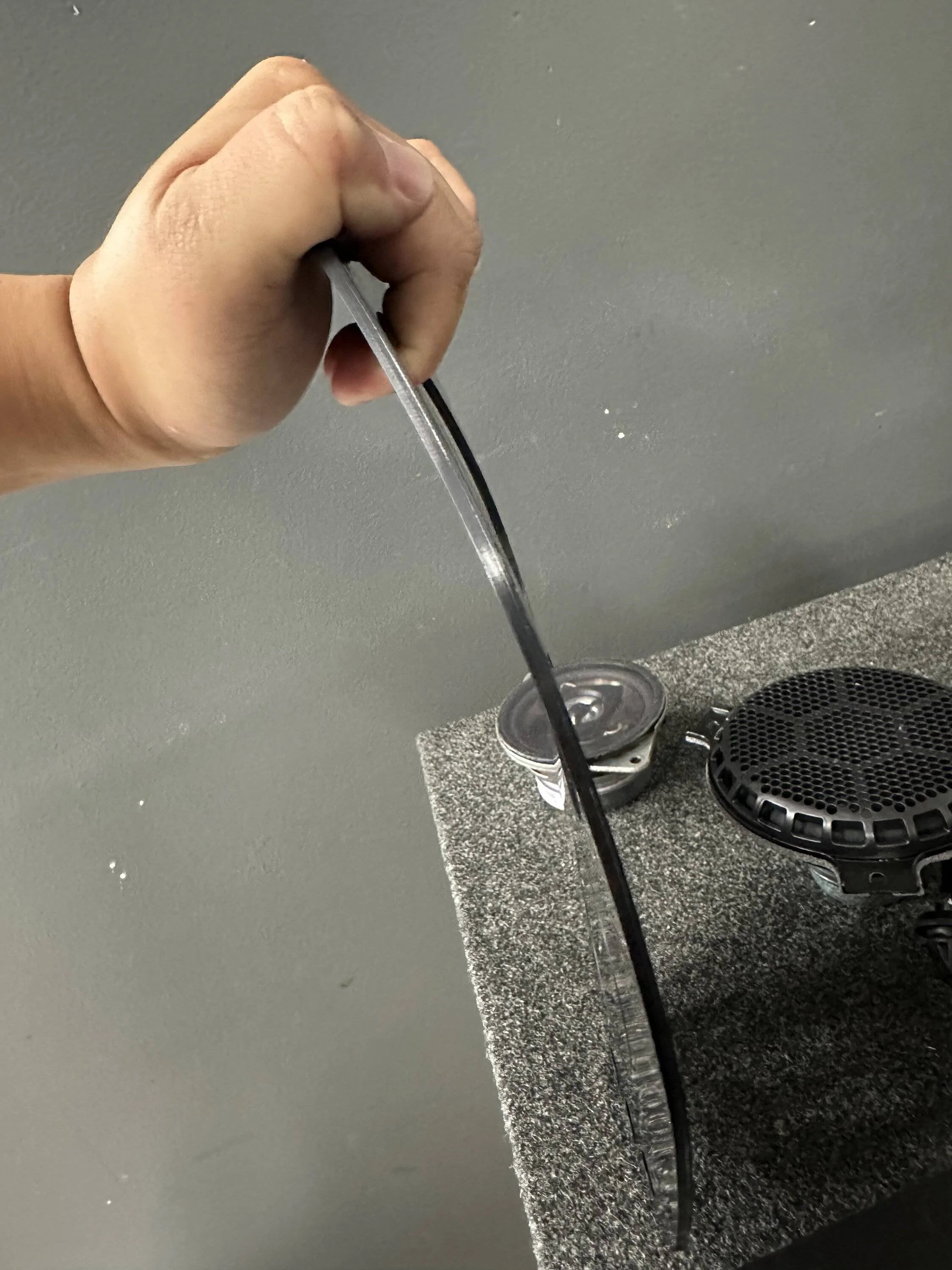

Flimsy Stinger speaker mounting plate:
Jeep Gladiator Gladiator Audio Upgrade - Alpine to Audison DSP and Morel Sub - now with added Helix! Photo Oct 09 2023, 5 05 13 PM

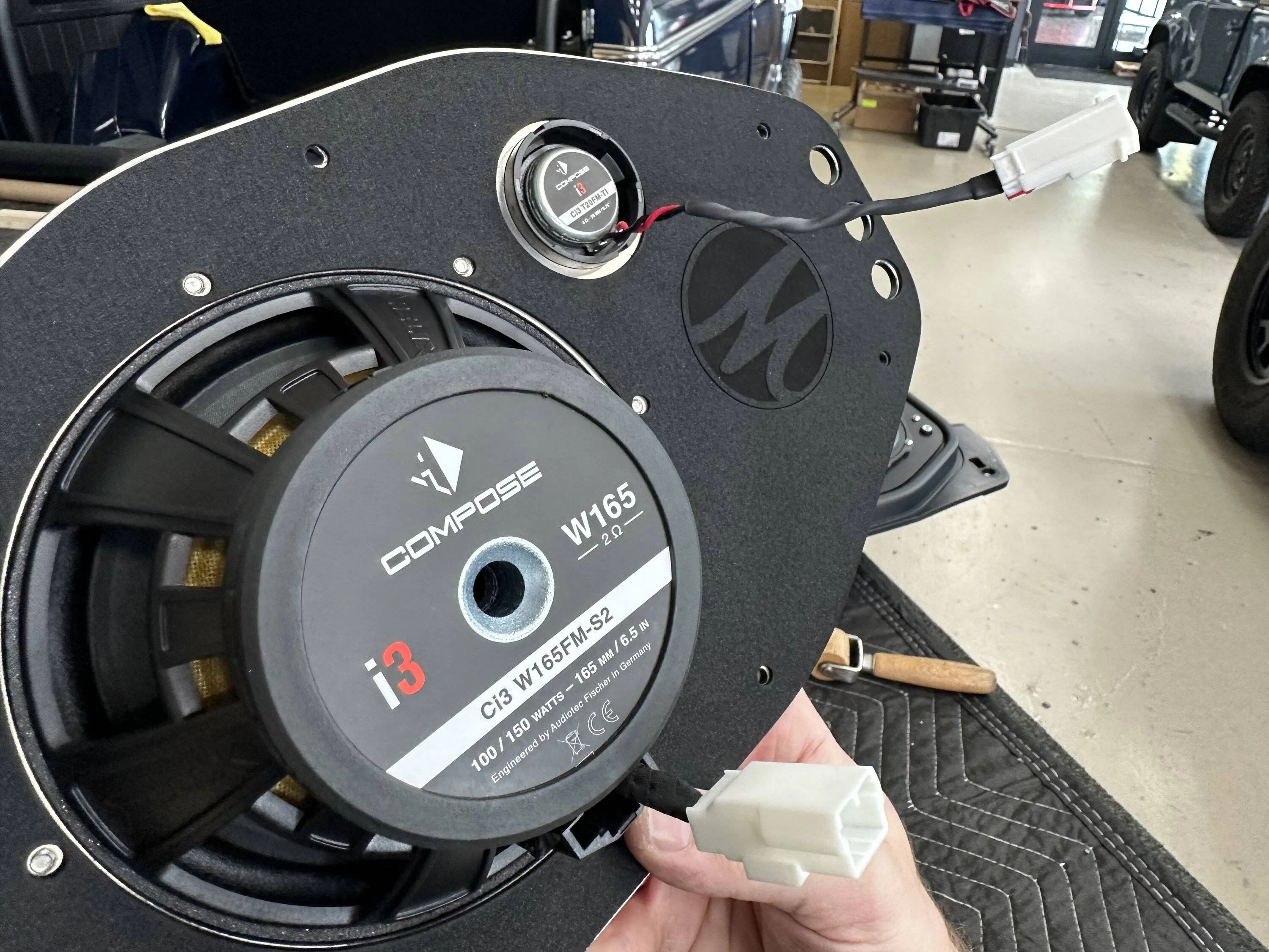

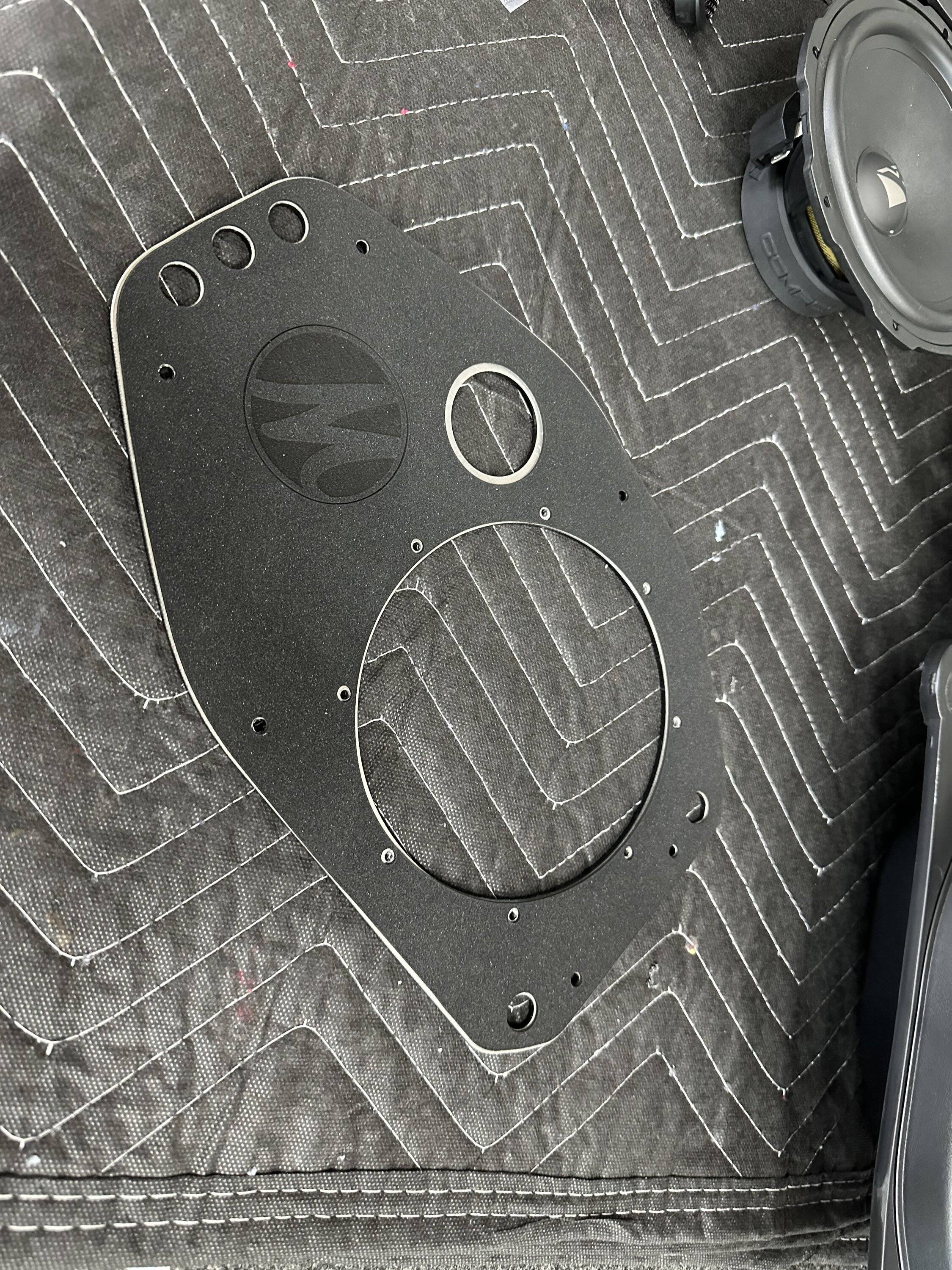

Not-so-flimsy Musicar custom speaker mounting plate:
Jeep Gladiator Gladiator Audio Upgrade - Alpine to Audison DSP and Morel Sub - now with added Helix! 53256410205_bb838efa44_o
Jeep Gladiator Gladiator Audio Upgrade - Alpine to Audison DSP and Morel Sub - now with added Helix! 53255924641_3eac9a20eb_o

I used your setup as inspiration for mine. It’s not been easy t find a setup that maintains the integrity of the original fascia and builds around the OEM format. Mine is not quite as high-end, however. I am having one issue that we haven’t been able to resolve…the dreaded whining noise when accelerating. I have a 2023 Gladiator Rubicon and supposedly, noise on the head unit when adding another amp is not uncommon. But thus far, no fixes. Is it possible that the crossovers in the enclosed speakers up front are too close to the head unit? No matter what we tried, sound is still present. Install is professional…grounds are sound and yet, still noise. Please help????
Man, those types of problems can be frustrating. As mentioned above, a good shop should be able to diagnose their own work on this, so I'd definitely put the onus on them to make good on it. It sounds like most of the main components have been tested/swapped, but perhaps the PAC Audio unit itself is bad, or you may have some type of grounding issue the shop has yet to find. With my setup, even using RCA's between the PAC Audio adapter and the DSP Amp, there is absolutely no whine, hiss. floor noise or otherwise. Even with the volume level set to maximum, it is dead silent between tracks and during silent portions of songs. It's the best system and setup I have ever had in that regard.
ok, BEAUTIFUL BUILD!!! love it, I have the fox box with 2 10s and I am loving it except the fact that the internals are super low in volume compared to the SUBS... so let me get this straight... You can BYPASS the whole factory amp system by plugging in that wire harness from PAC CH41 behind the radio to get the signal... then go to the 8 ch AMP that YOU bought, then the OUTPUT of that 8 ch AMP that YOU bought has a wire harness that goes back in to the system by the PAC CH03 wiring harness? and that will go send the sound to the speakers, right? and what are you supposed to plug in to the factory amp to keep making sure that it sends a signal to keep the radio on? I am so confused and I really want to get my small speakers to be much louder than what they are right now.... thanks for the help.
The factory amp stays in the truck and plugged in to keep all diagnostics happy, but the outputs from the factory amp do not power any speakers. The harness that normally connects the speakers to the stock amp outputs now goes to the PAC adapter harness and the speaker outputs from the aftermarket amp. It all works beautifully TBH.
G3N1U5
Gerald
Mar 20, 2022
52
NorthEast Florida
2022 Jeep Gladiator Overland EcoDiesel Gobi
Costco Wholesale Inc.
Ok, so the plug that is exposed and that we are looking at is the OUTPUT plug of the factory amp? Is that correct? And the harness CH03(?) it looks like only a 4 channel plug, I have a 4 channel amp, does that mean I need to get an 8channel? Also, thank you so much for your reply man, building this thing get frustrating.

Thank you for the write up. My plan is similar. Did you use the Metra JP 1018 Speaker Grill cut-ins? They open up the factory grills for the front mids from 4" to 6 1/2".
Zonian
Shawn
Feb 28, 2024
Fredericksburg, VA
2023 Willys Ecodiesel
One more question if you don't mind. How does the Fox Box look with the seat down? I've narrowed my sub(s) decision down to the Stinger Dual 8s ported, Alpine Halo Dual 8 ported, or the Fox Box with decent 10" I already have. I'm leaning towards the Stinger because of the mounting system and retaining the factory jack location. But, I would save a few hundred dollars and a lIttle space on the ends of the Fox Box like you mentioned.
