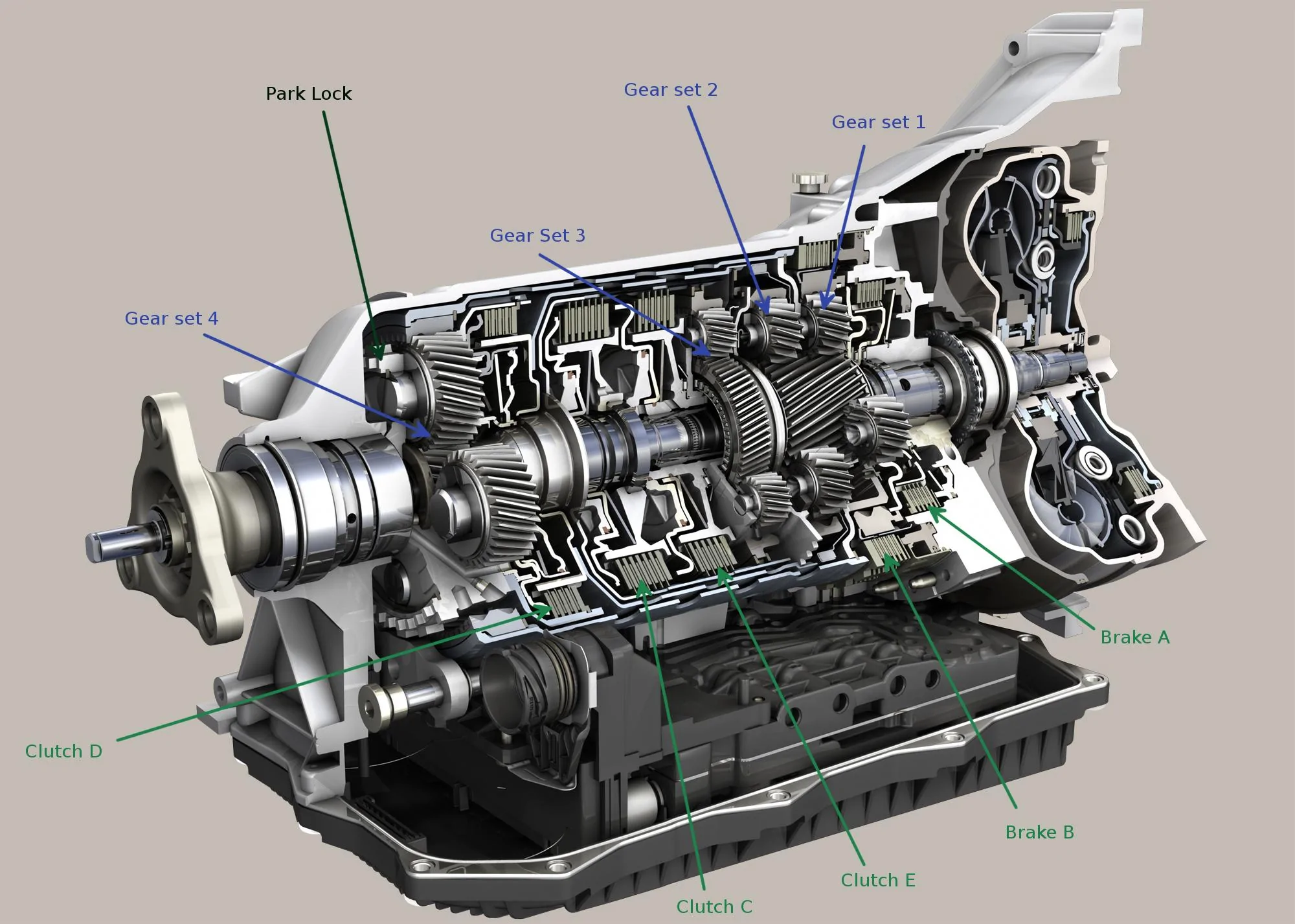

Valve bodies are simply castings with balls for check valves and shuttles for valves that control shifting and control pressures and so on. At least in legacy transmissions. They don't go bad. They get dirty or gummed up.
I've worked on at least two where a piece of lint caused destruction by locking a shuttle in the valve body bore.
In short, it's highly unlikely to be "bad" - but likely if there's a problem, it's dirt, debris or gum.
Maybe by "planetary clutch" you mean the clutch pack for a specific "gear" or combination of gears.
There are only 4 planetary gear sets, amazing how they can achieve any gear with only 3 of the 5 hydraulic clutches or brakes applied and can skip gears completely.
That’s about right. I wasn’t trying to go in to that much detail. Also in todays flat rate, worst way to pay a technician world. No one fixes valve bodies. They just replaces them. Yes I mean planetary clutch there are 3 clutches and two brake packs. Clutch D in the diagram.
Here’s a good link if anyone wants to understand their transmission a little better
https://www.thetruthaboutcars.com/2014/03/saturation-dive-zf-8-speed-automatic/

That's a better image than what I have. In the past bands would have been used to stop the planetary gear set "drum" from rotating - wow, that was a long time ago.
I used to take valve bodies apart and go over every bore, every valve, every plate, every shuttle, every spring - and a single piece of tiny lint........ forget it.
Clutch packs of old could have a nicked or rolled seal. The teflon seals were a lot better than the early "rubber" seals but were still subject to nicks and damage. Seals of the past would get hard and leak fluid and not hold pressure leading to slipping clutches (or bands if it was a servo seal)
No one could afford to do today what I did back then.
I really enjoyed my years doing transmissions and other work - but I'm glad I'm not in that any more. That German engineering - can't beat it.
