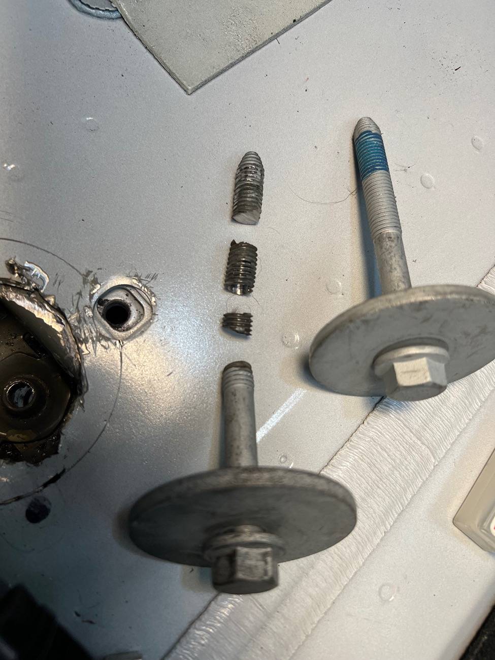

I know this has happend to a few people when installing sliders. I got a chance to help a buddy fix his. SO, I took a lot of photos with measurements and putting it here to help anyone who may need it.
The body bolts on the Jt and the JL are held in with lock tight and if you want to avoid this, I recommend an induction bolt heater which you can buy from Amazon sub $200.
Jeep Gladiator DIY: Remove and replace drivers broken body mount bolt -- how-to instructions w/ photos 1000012992

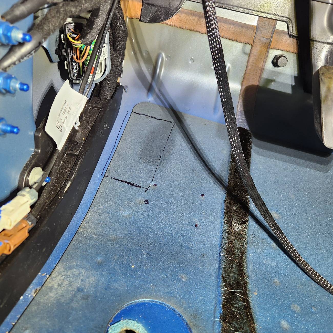

the black dots represent spot welds. The black line it where we measured
Jeep Gladiator DIY: Remove and replace drivers broken body mount bolt -- how-to instructions w/ photos 1000012994

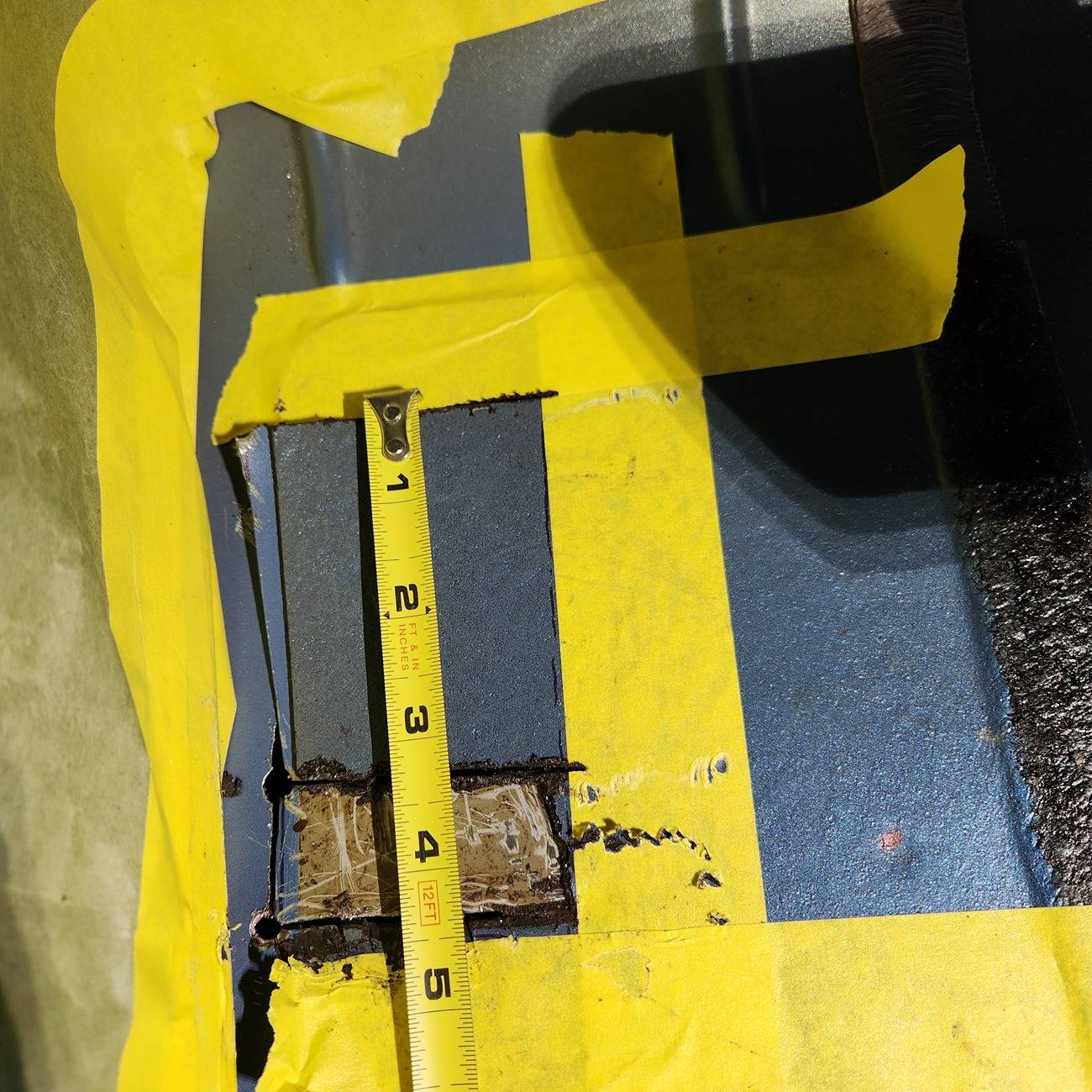

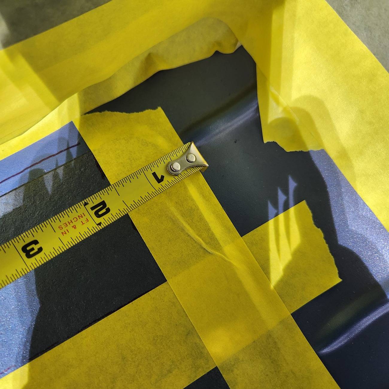

measuring down from the rib in the floor, I went 1.5 inches​
Jeep Gladiator DIY: Remove and replace drivers broken body mount bolt -- how-to instructions w/ photos 1000012999
Measure from the top line it put my second cut at 3.25" (you will notice my first attempt was at 4 25" however this is past a hidden weld).​
Jeep Gladiator DIY: Remove and replace drivers broken body mount bolt -- how-to instructions w/ photos 1000013037

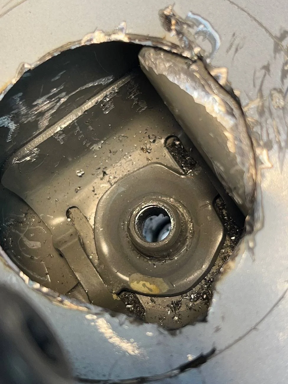

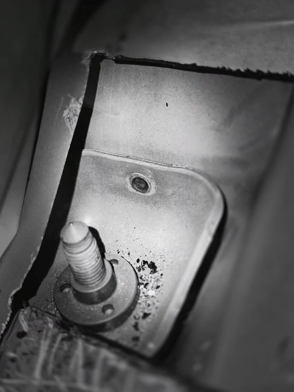

From here the sheet metal is very thin and i was able to peel back with my hands and expose the top.​

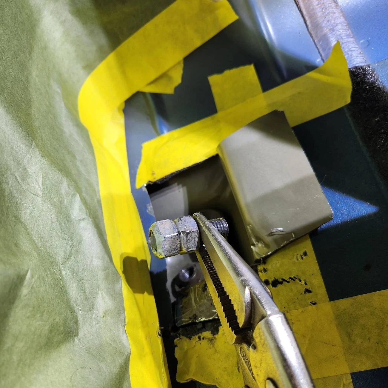

Now that you can see the nut and bolt, I put two nuts on it and heated it up with a propane plumbing torch (Keep an extinguisher and a wet rag near by for safety and heat control).​
Jeep Gladiator DIY: Remove and replace drivers broken body mount bolt -- how-to instructions w/ photos 1000013003
It came out with minimal effort.​

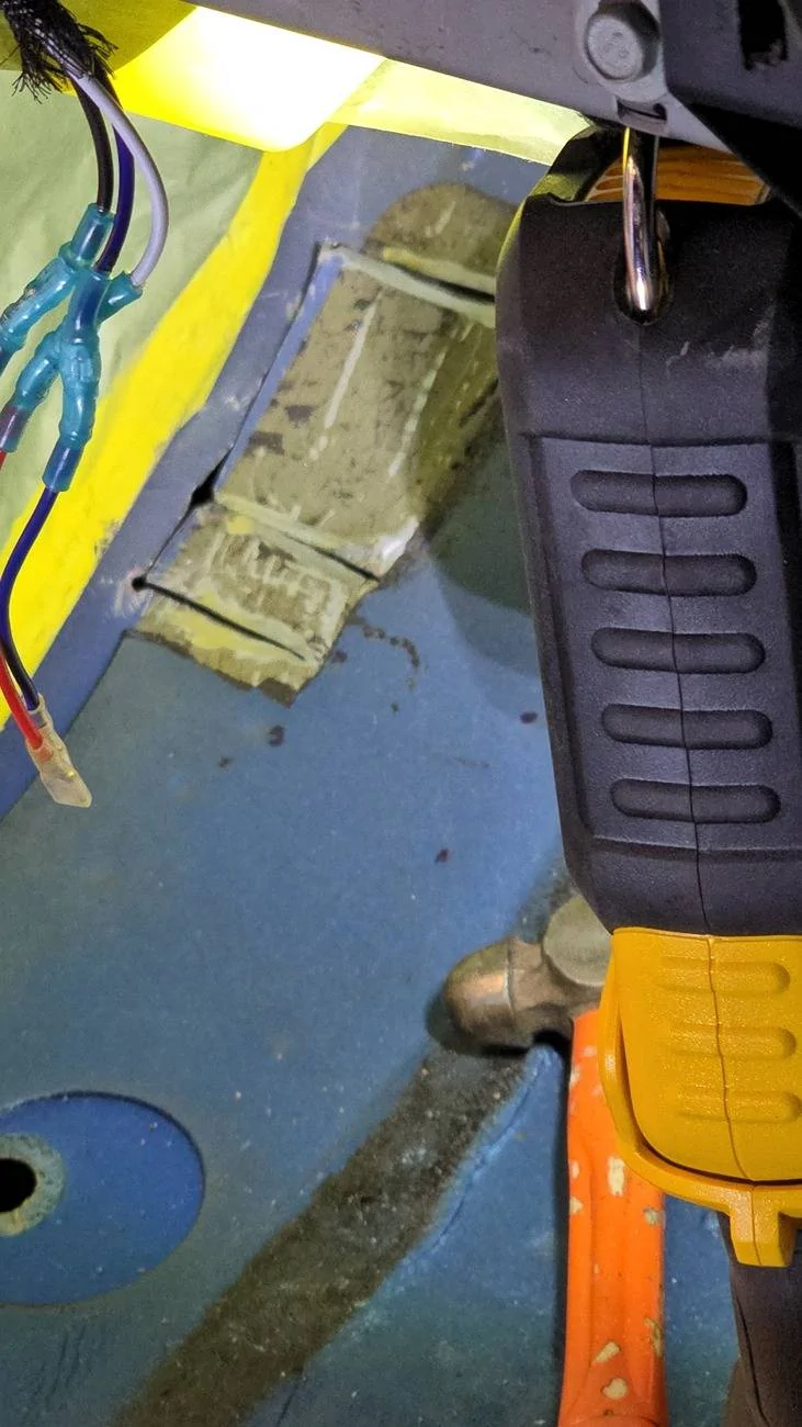

Next I carefully put the panel back​
Jeep Gladiator DIY: Remove and replace drivers broken body mount bolt -- how-to instructions w/ photos 1000013026

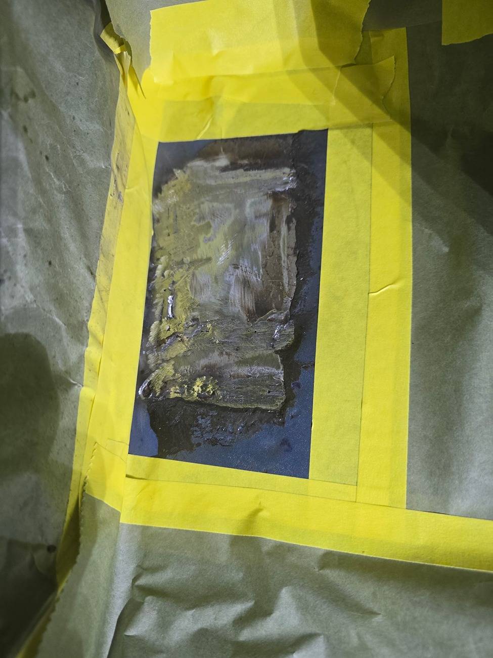

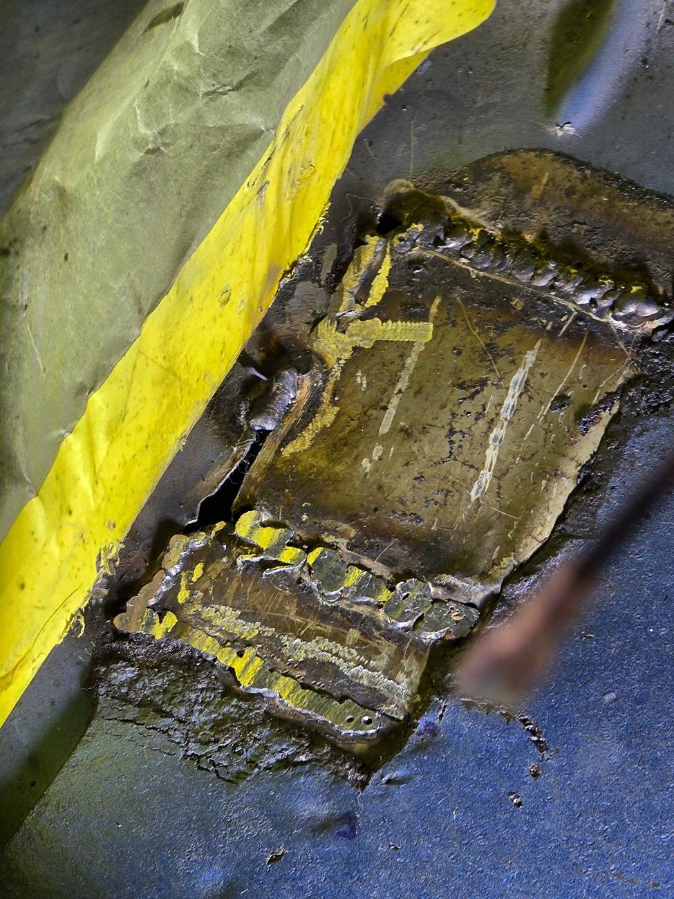

Then the fun of spotwelding​
Jeep Gladiator DIY: Remove and replace drivers broken body mount bolt -- how-to instructions w/ photos 1000013020
Lots of grinding and sanding​
Jeep Gladiator DIY: Remove and replace drivers broken body mount bolt -- how-to instructions w/ photos 1000013015

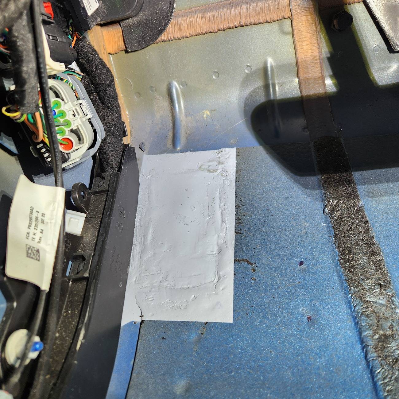

More sanding, then a little body sealer to ensure it's water tight.​
Jeep Gladiator DIY: Remove and replace drivers broken body mount bolt -- how-to instructions w/ photos 1000013009

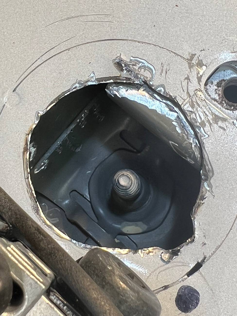

Been there - Done that…….. These are before pictures and afterwards I cleaned up the circle and made a beautiful patch panel then silicone and screwed it in place.
Jeep Gladiator DIY: Remove and replace drivers broken body mount bolt -- how-to instructions w/ photos IMG_2784
Jeep Gladiator DIY: Remove and replace drivers broken body mount bolt -- how-to instructions w/ photos IMG_2781
Jeep Gladiator DIY: Remove and replace drivers broken body mount bolt -- how-to instructions w/ photos IMG_2783
