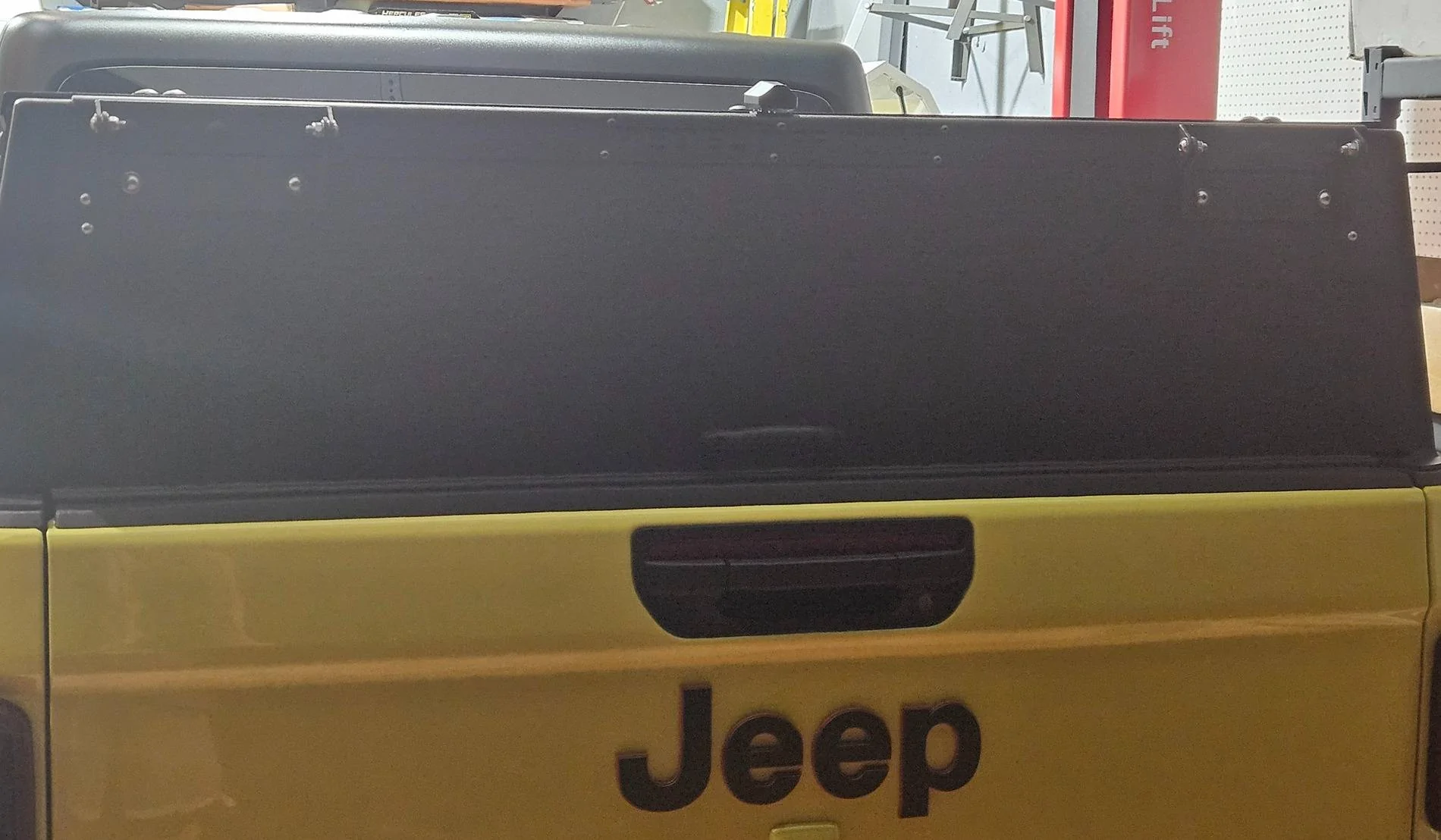

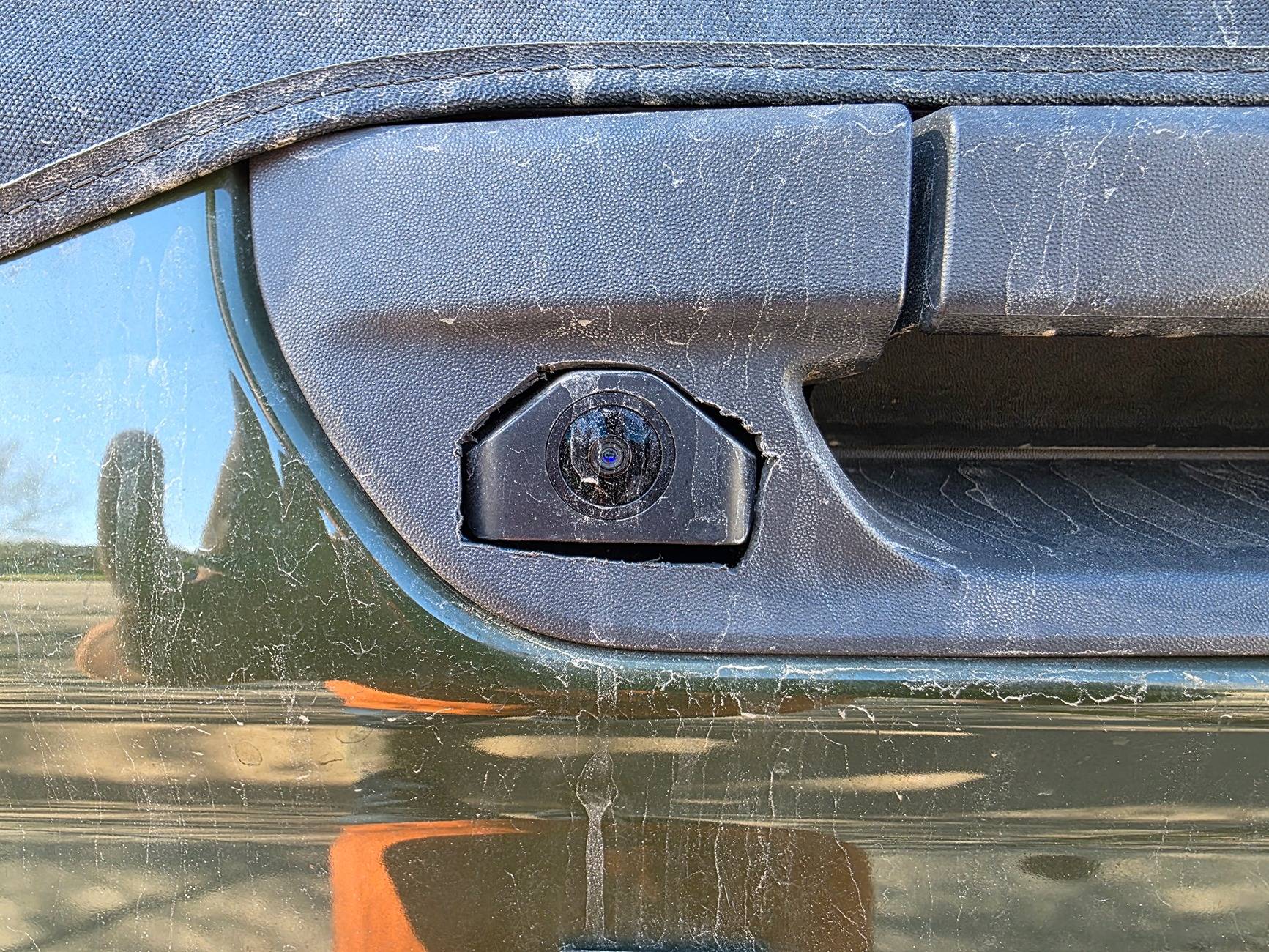

I originally planned to install the rear camera on the crossbars of the Wildtop bed topper that is blocking my view. I taped it up there and turned it on. I realized it was mounted too high to be used as a mirror because my daughter was behind the truck and I couldn't see her. I then moved it down to above the receiver, but that was too low; I thought it would get a lot of road dirt and splash. Then I saw, on THIS POST a guy who put his backup camera on the tailgate handle, and I thought that was perfect, but the Wolfbox rear camera is unsuitable for this method. I originally drilled a hole about the size of the camera lens and tried mounting it with the camera body pressed against the hole, but the plastic on the tailgate latch housing was so thick it gave me a tunnel view. it cut off the sides too much. I decided to get creative with a Dremel, knowing this is plastic and easily replaceable. I got a little off when eyeballing the cut with the Dremel because the plastic kept melting. Once I had the basic shape cut out with the Dremel, I used a file to refine it.
Jeep Gladiator Wolfbox G900 TriPro install & review with pictures. 20250502_170753

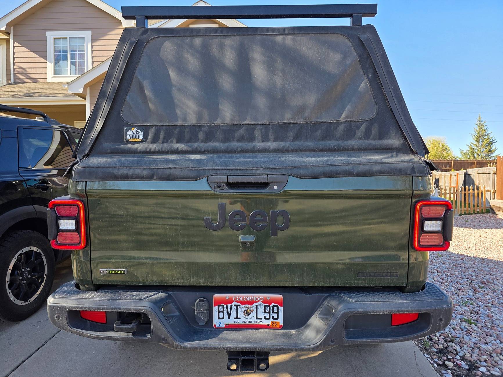

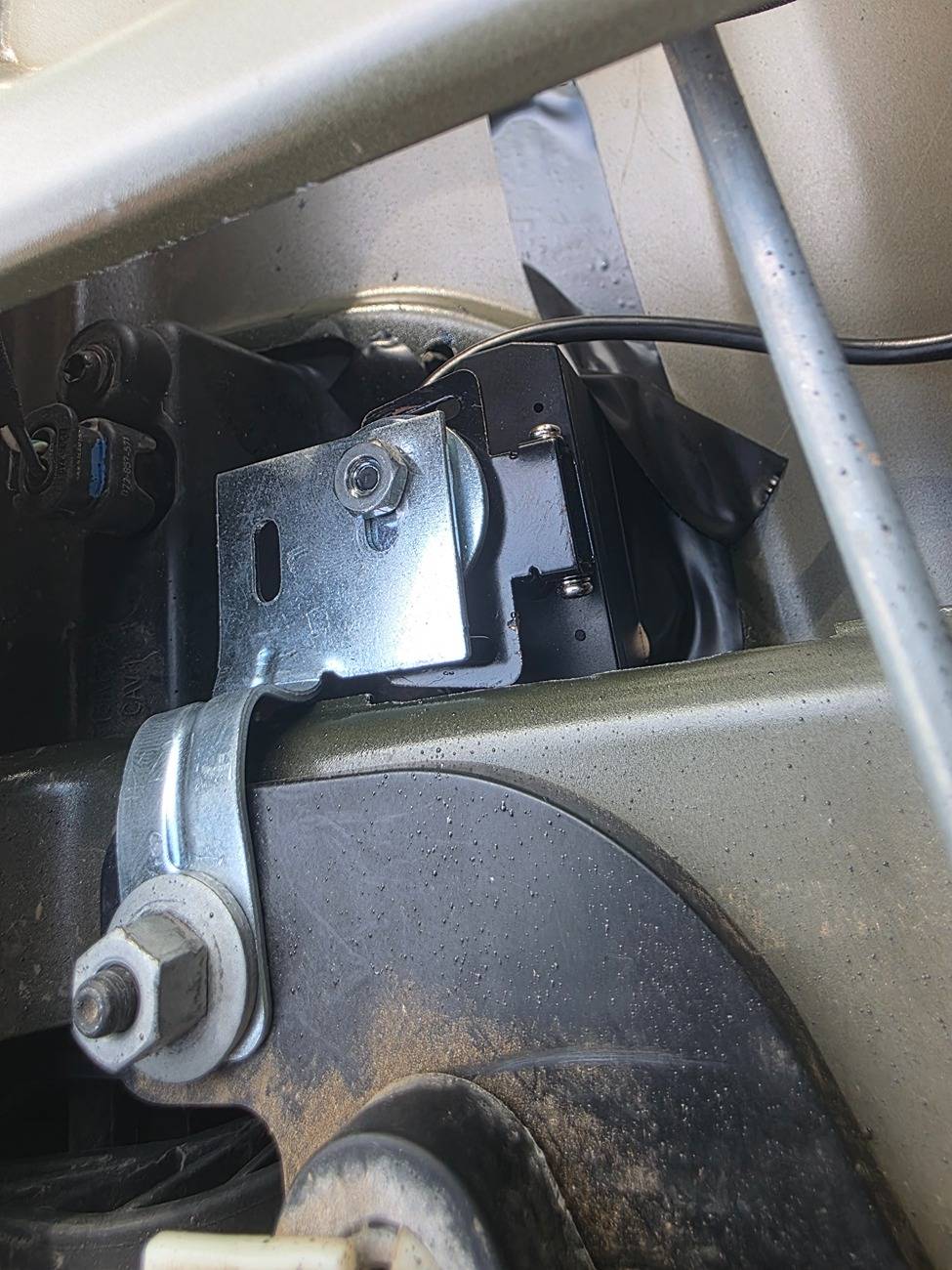

I went through my junk drawer looking for something to make a bracket from. I tried several things and found a piece of metal from some other hardware I never used—maybe an extra or broken piece. After bending and trying several ways, I found a nut that holds the latch attachment. I bent the piece again and attached the camera to that bracket and then to the tailgate.
Jeep Gladiator Wolfbox G900 TriPro install & review with pictures. 20250509_171840
With it in place, I added some foam and tape to help hold the camera still and to close the gap.
Jeep Gladiator Wolfbox G900 TriPro install & review with pictures. 20250509_171829
Jeep Gladiator Wolfbox G900 TriPro install & review with pictures. 20250509_171814

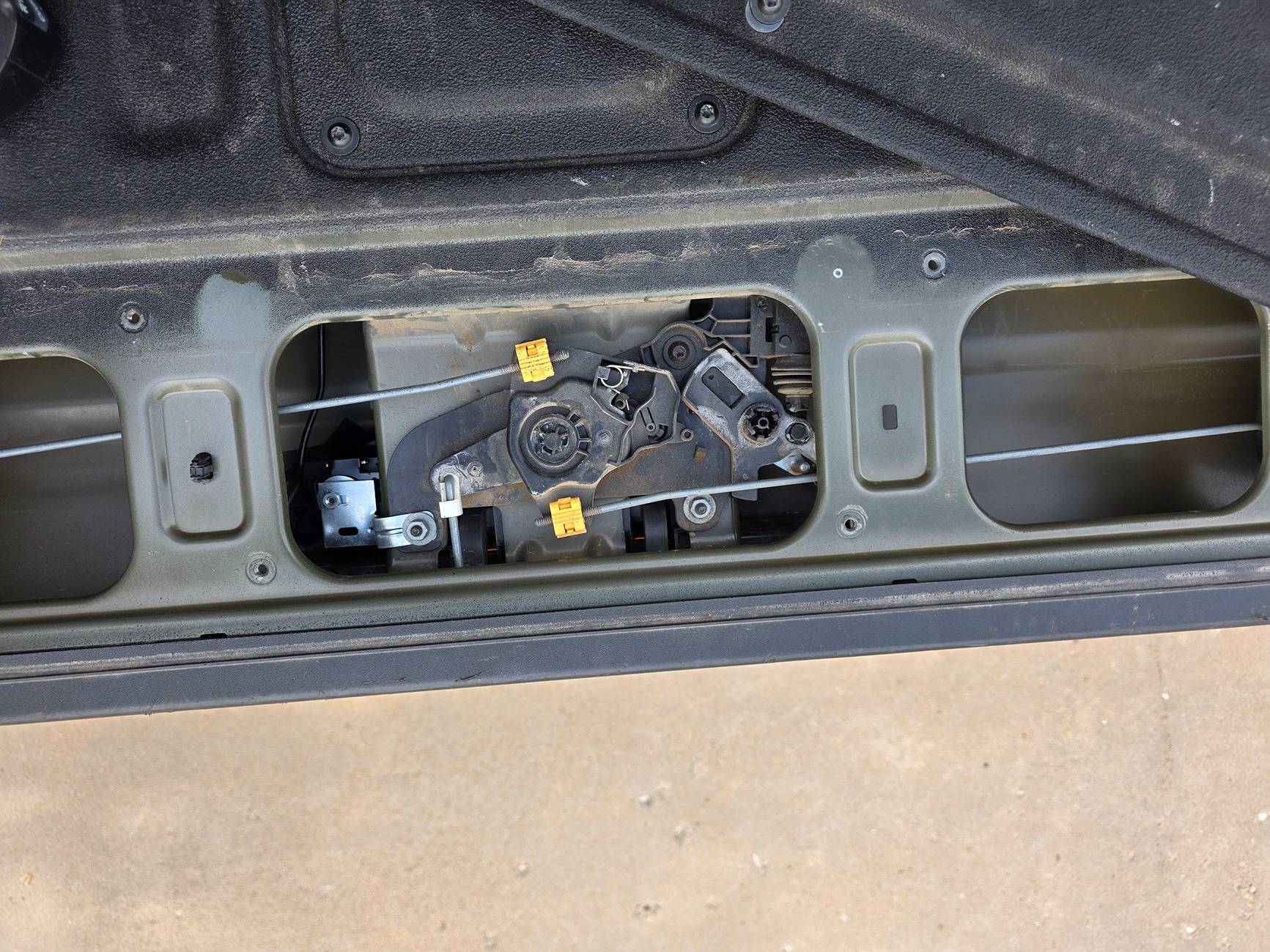

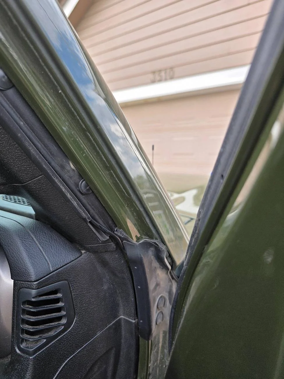

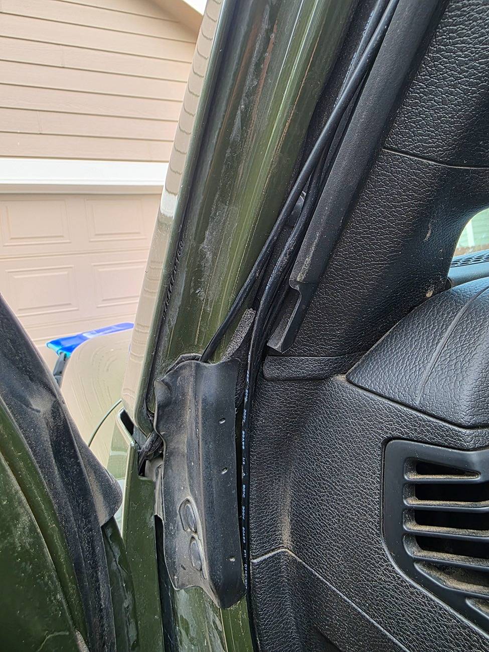

I routed the wire through the rest of the tailgate, under the bed, among other wires I had run for a different project. Then I routed the wire up through the engine compartment, up and out through the cowl, and into the soft foam that is in the door.

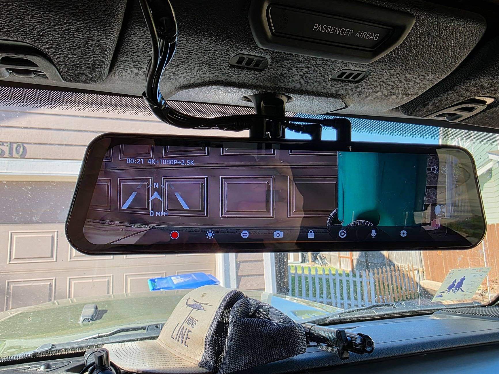

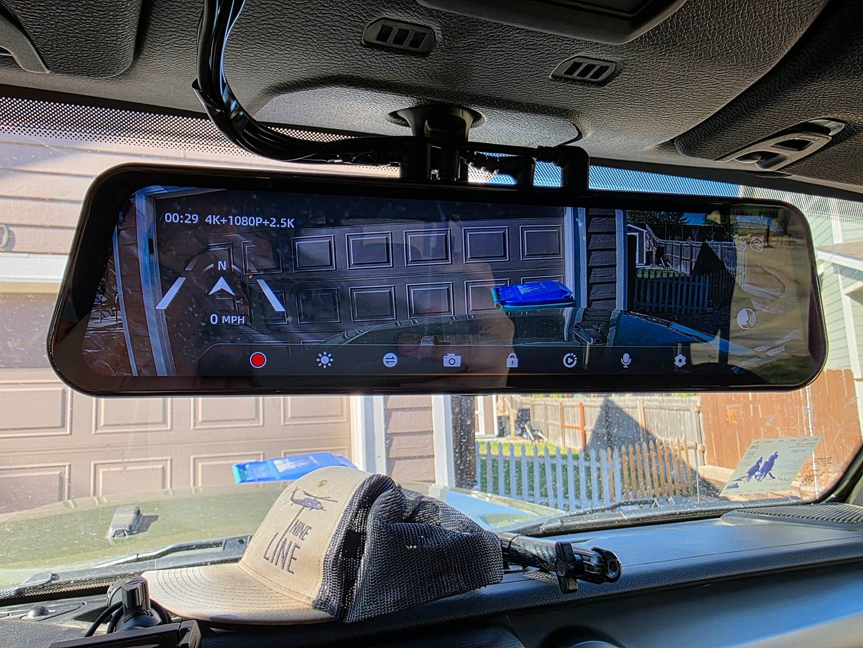

It does exactly what I needed it to do—replace the mirror—and it is super clear. One thing I was worried about was a delay between when a car would go behind me and what I would see in the mirror, but it's almost immediate; I can't even perceive a delay.
Jeep Gladiator Wolfbox G900 TriPro install & review with pictures. 20250502_170907
High resolution makes it very good for seeing details on things that are very close to you, but in the mirror, you can't see much detail on things very far away; cars look a lot smaller in the Wolfbox than they do in the mirror, but that's alright; it's really not a problem.

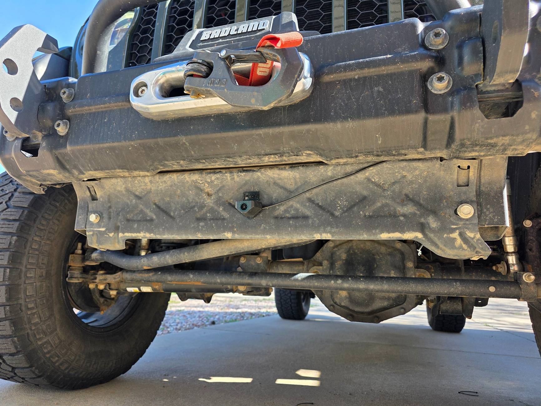

Having the bumper camera on the bumper, the view is very similar to what's coming out of the dash camera. I think I might move the bumper camera to maybe above or behind the axle, and hopefully, I can see the tires; that would really help, especially when I'm wheeling in the Rockies.
Jeep Gladiator Wolfbox G900 TriPro install & review with pictures. 20250502_170842
Here you can see the difference between the dashcam thats on the mirror and the bumper cam dashcam.
Jeep Gladiator Wolfbox G900 TriPro install & review with pictures. 20250502_170918
Bumper cam
Jeep Gladiator Wolfbox G900 TriPro install & review with pictures. 20250502_170910

I have had mine for about a year. My install went well but I may get brave enough to take the blade to my tailgate!
I need to go through my wiring. Over the last month, on wet days my rear view camera will intermittently switch to the back-up view mode while driving. And at the same time my left Oracle tail light dims out! On my initial inspection I could not find anything getting wet. I hate wiring!

If you do decide to cut the tailgate plastic, a dremel with a cut wheel is the wrong tool. gets too hot

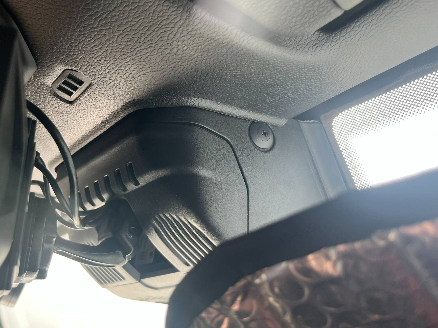

They have an OEM Bracket for the Jeep. That is what I used to install mine.
WOLFBOX OEM Bracket for Smart Mirror for G900Tripro (Model 179 OEM Bracket)
How to Choose Wolfbox Dash Cam OEM Bracket?

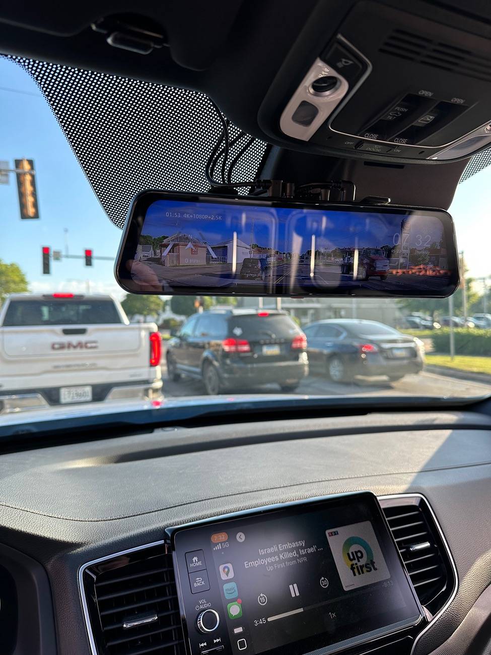

Jeep Gladiator Wolfbox G900 TriPro install & review with pictures. IMG_4844
Jeep Gladiator Wolfbox G900 TriPro install & review with pictures. IMG_4845.JPEG

My only real gripe is the glare. How do you guys deal with it?
Jeep Gladiator Wolfbox G900 TriPro install & review with pictures. IMG_4423

I have the film, but have not put it on yet. Was hoping to get the screen at the right angle and not have to use it.
I just got mine installed but I am also working on getting other parts installed so I haven't actually driven mine with it installed yet so it has only been tested in the driveway. I hope to have everything installed next week but since mine is so modified and all the parts are for stock vehicles the installation always takes longer since I have to spend time modifying everything to work with mine.

Looks awesome guys? Did you use some caulking or sealant around the camera?

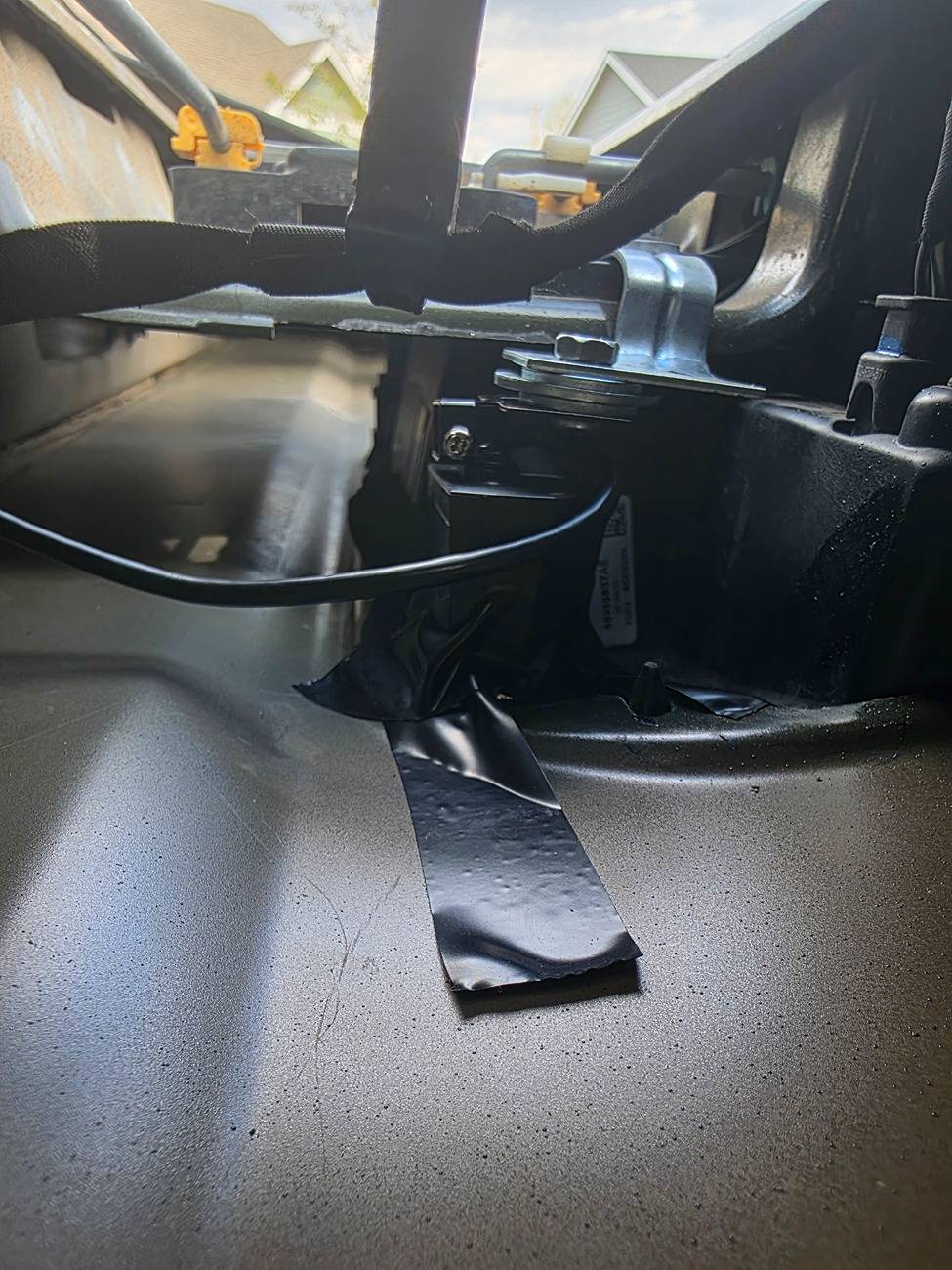

Jeep Gladiator Wolfbox G900 TriPro install & review with pictures. 20250510_233252
