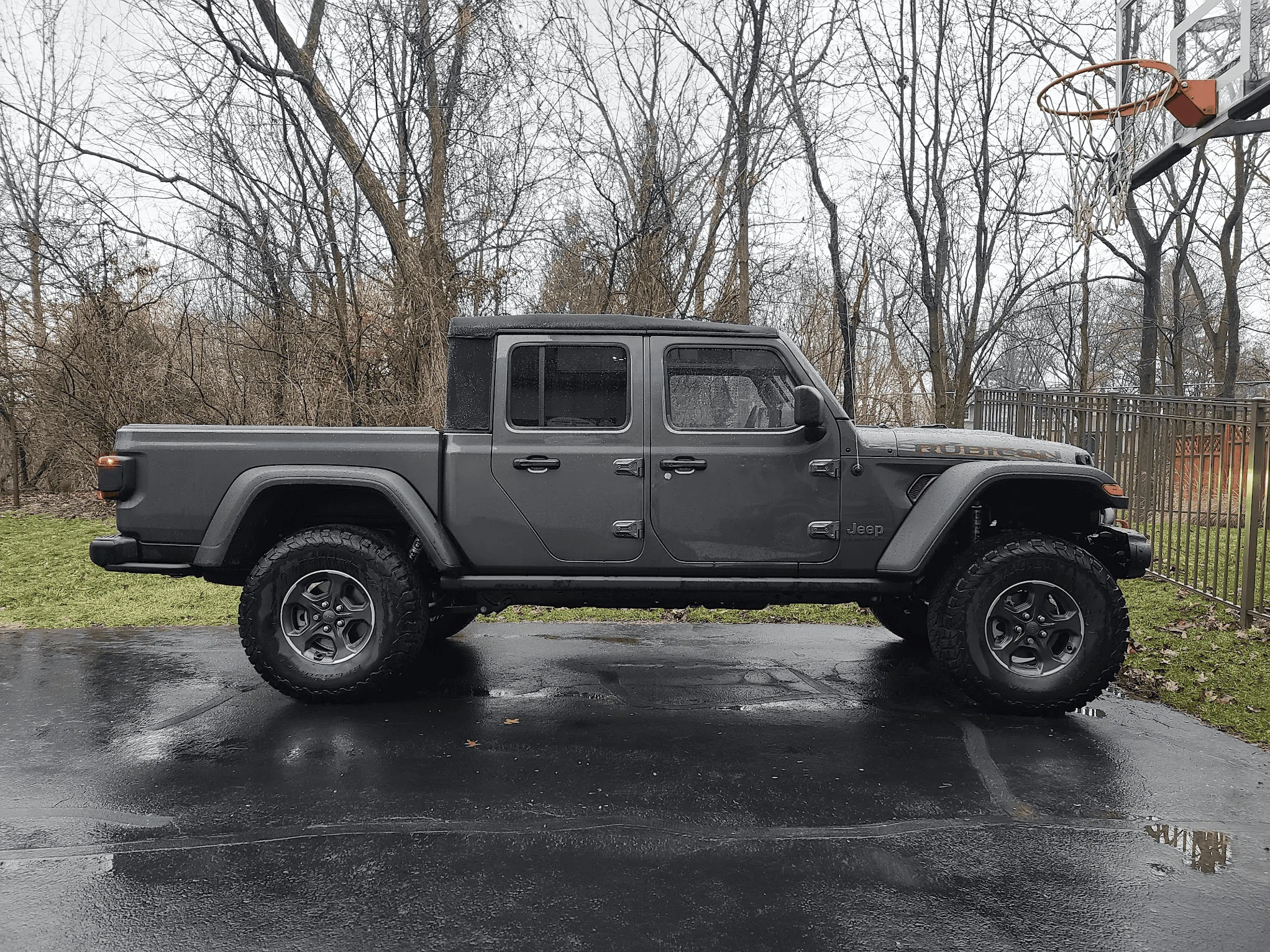

The sag is called "rake" and there is some from the factory so that when you load up the bed with stuff, the rear will drop due to the weight and the truck will be "level". Without it, the front end would be higher.
Having said that - most people don't like the factory rake (including me) and use a front leveling spacer to compensate.
Like you, I have the MOPAR kit and the steel bumper and a 12k winch. I used the teraflex 1.5" spacers up front to correct it.
Mine sits like this with 37's:
Jeep Gladiator A bit of front end sag...couple ?'s 1669998275215
