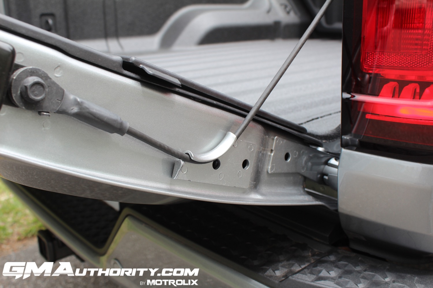

Trucks have been doing this for years (decades?).
On a Colorado/Canyon:
JT:

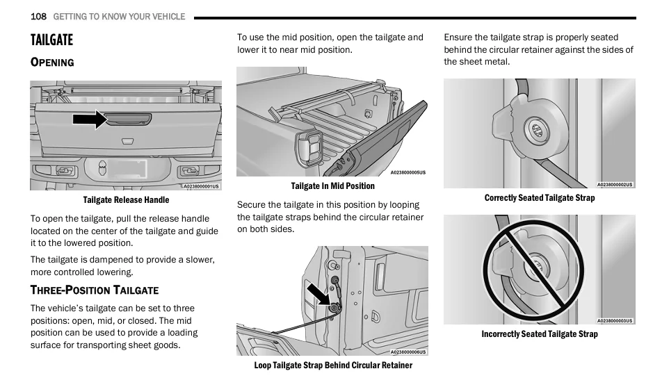

Max load at this position is 500#.
Even years before the manufacturers added the cable mount for half way, I used to flip the cable over the latch bung used to hold the tailgate closed.

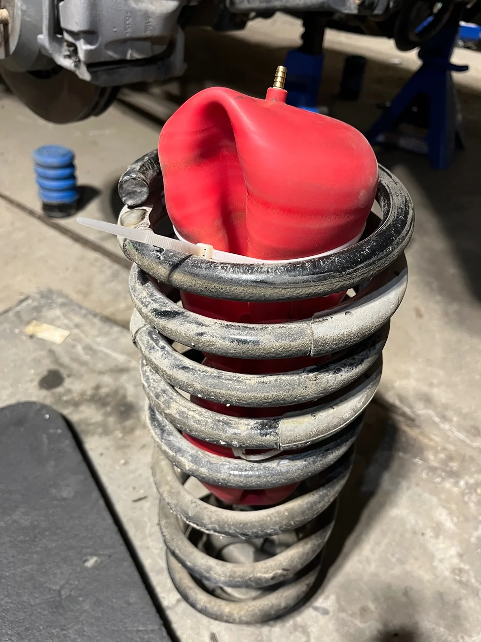

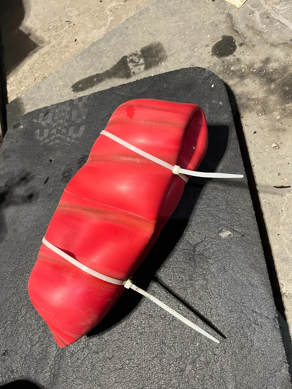

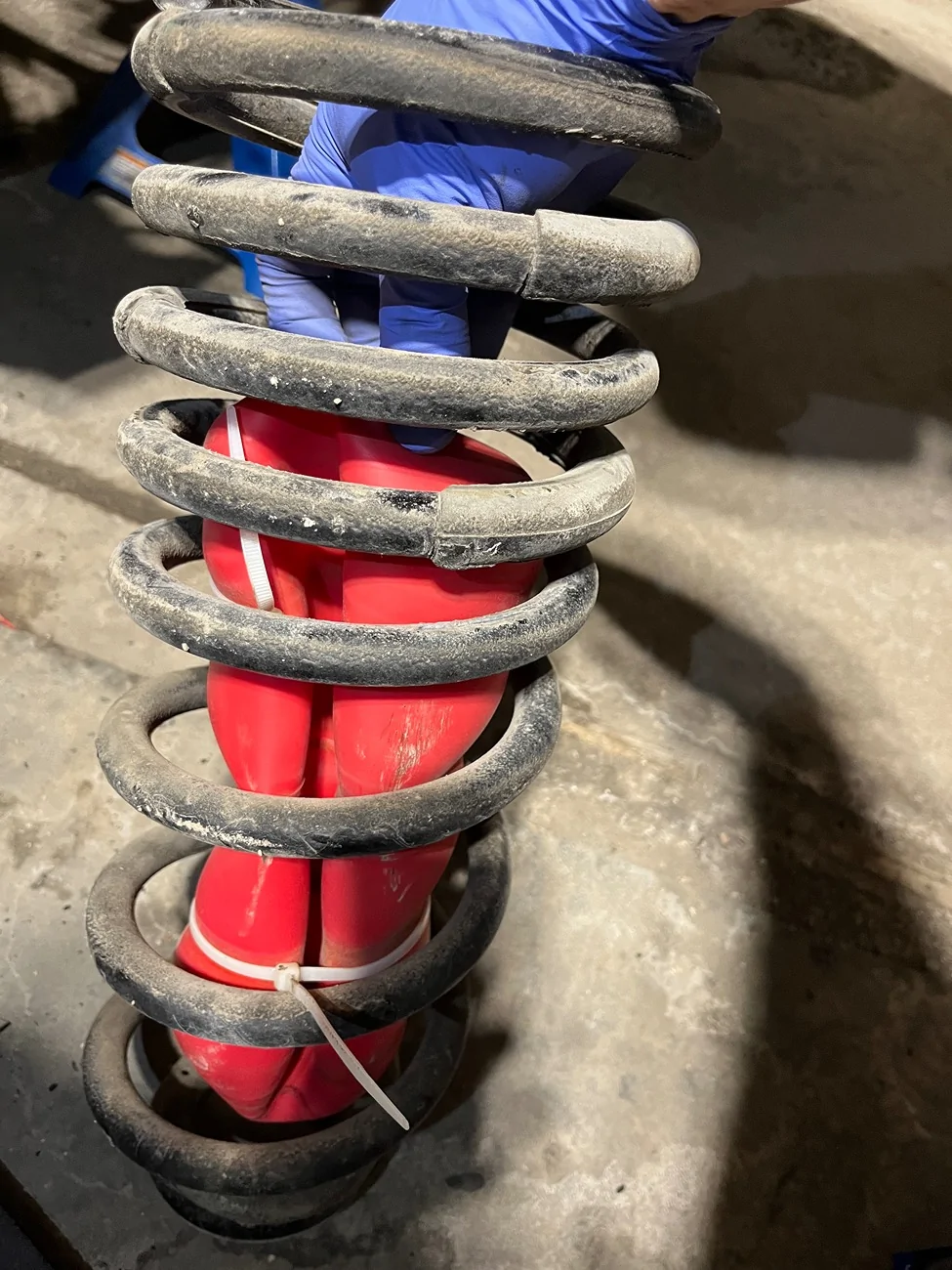

It’s not a bad job. I just did this, removing the bags from my 21 JTR and reinstalling on my 23. Coils out, squish the bags in the coils till they fold long ways, get a couple zip ties in there to hold the fold then pull them straight out.

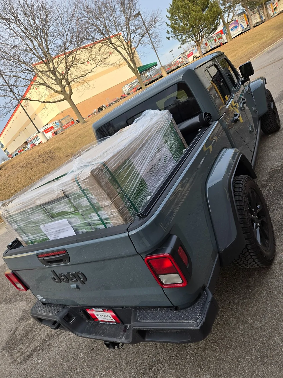

It's your load distribution. If the quad could roll forward that additional foot or so the weight would be more even and I bet the sag would go away. I've had 1000# of mulch in the bed before and all it did was ride level. (Willys, so same suspension as a sport S)

The bulk of the weigh from that quad sits behind the axle line. The uneven load dissuasion will contribute to the sag. Teh load capacity is about ~1700 lbs and this will include gear and passengers. What's the quad ~700lbs?
Seems to me load distribution would be teh biggest contributor. Do you notice its riding on the bump stops?
AEV 700lbs over springs. Wonderful
