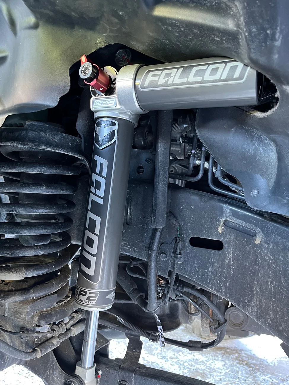

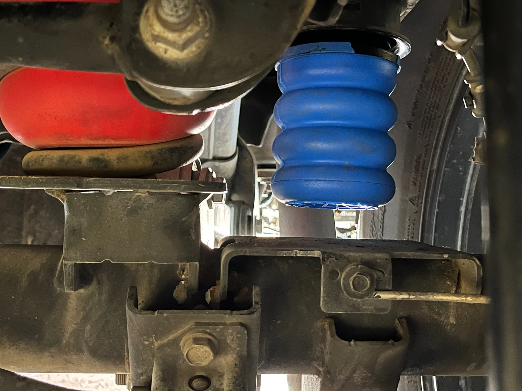

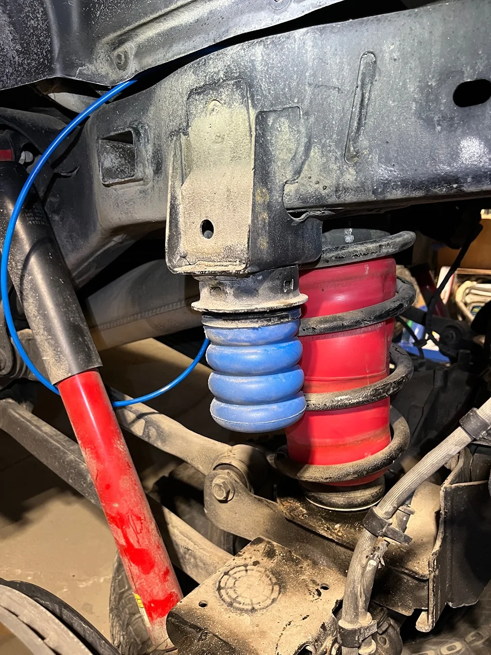

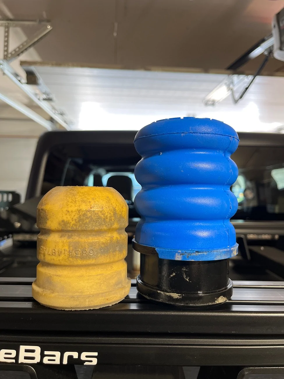

#1 mod addition is Air Lift 1000 air bags. 1000 lbs in the back and stay level.
#2 mod addition that compliments #1 is to upgrade the bump stops to Sumo bump stops and;

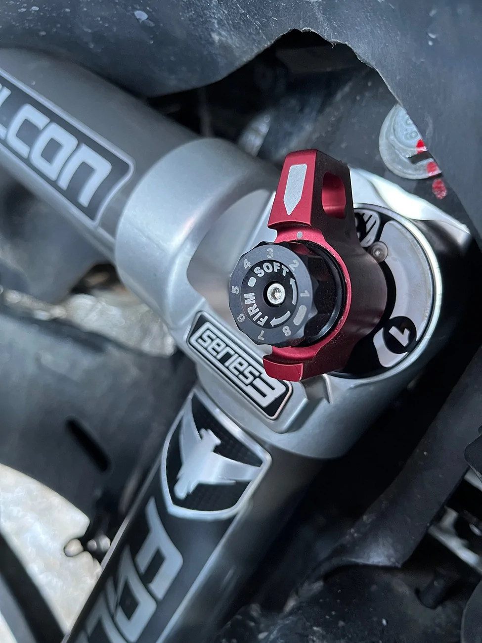

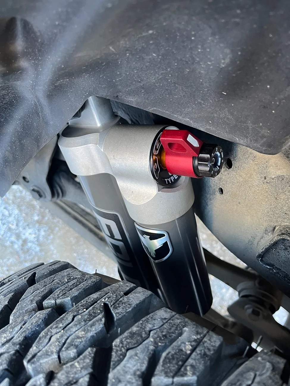

#3 addition, Falcon 3.3 adjustable shocks set to #3 position and you’ll ride like a king with all 3.

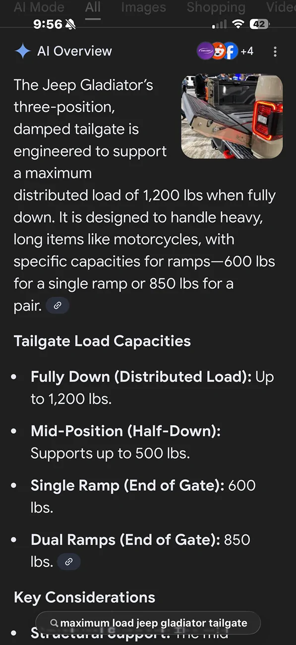

I'd be just as worried about overloading the tailgate, as it looks like both rear wheels are fully on the tailgate from your picture. What's the max load on the tailgate when fully folded down? Most of the specs I've seen are for the tailgate in the mid position, at like 300#.

Okay so how do you get it to stay half cooked? I smell AI in there some where .
