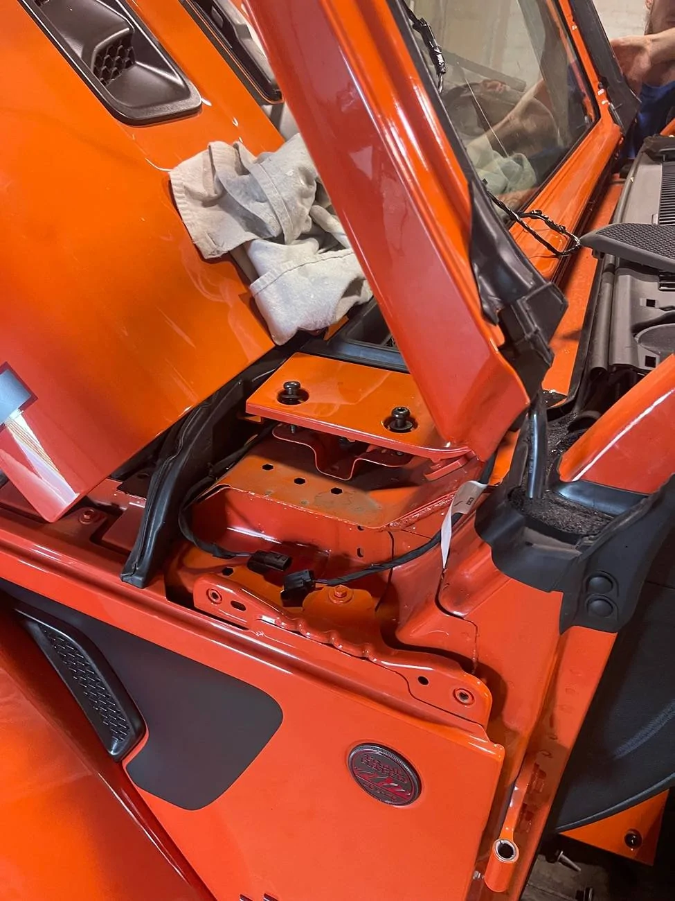

Hi, I'm in the middle of doing the ACC retrofit on my 23 diesel, I am trying to prewire for the heated windshield, but I can't for the life of me find a diagram of where the wiring harness plugs into. It seems to run down the A column pillar, I believe the Drivers side?
Any information would be greatly appreciated. I scoured the service manuals, but I haven't been able to locate anything that has helped. Thank you.
