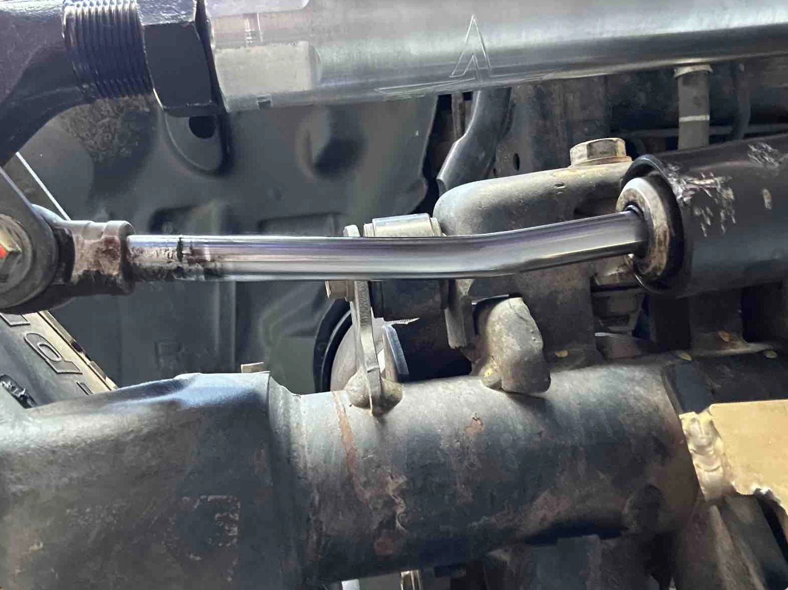

I experienced death wobble just one time due to a bent steering stabilizer rod damaged from rock crawling.
Jeep Gladiator Advice from local Jeep shop on a repair 1766421028202-ks
This was the Teraflex Falcon (HD) Nexus EF 2.2 Fast Adjust Steering Stabilizer mounted in the stock location. I had it replaced with the same, but clamped above the tie RPM tie-rod instead for better protection. The total cost for the Falcon steering stabilizer, RPM 2" HD Stabilizer Clamp (RPM-4001FAL), plus labor was $738.
