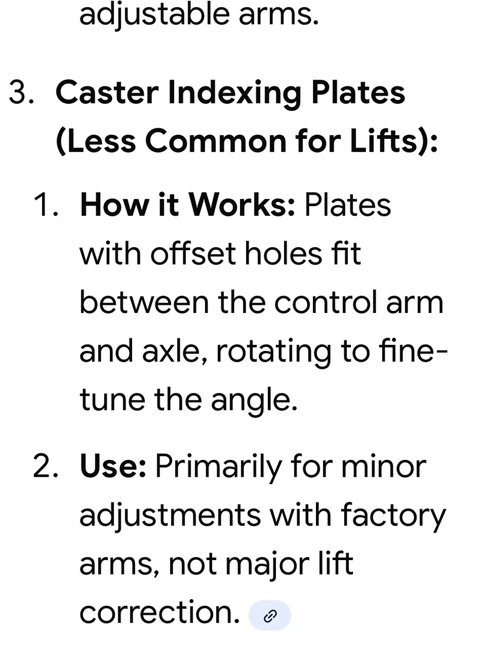

How exactly did they "reset" your caster if you have a bone stock Sport S?
Ok this is what they gave me to understand how they did it. Exactly what I thought after looking before and after.

That worked very well.
Interesting. That makes sense as there is no way to adjust the control arms on a stock Gladiator witout additional brackets. I've never heard of them doing that before...
