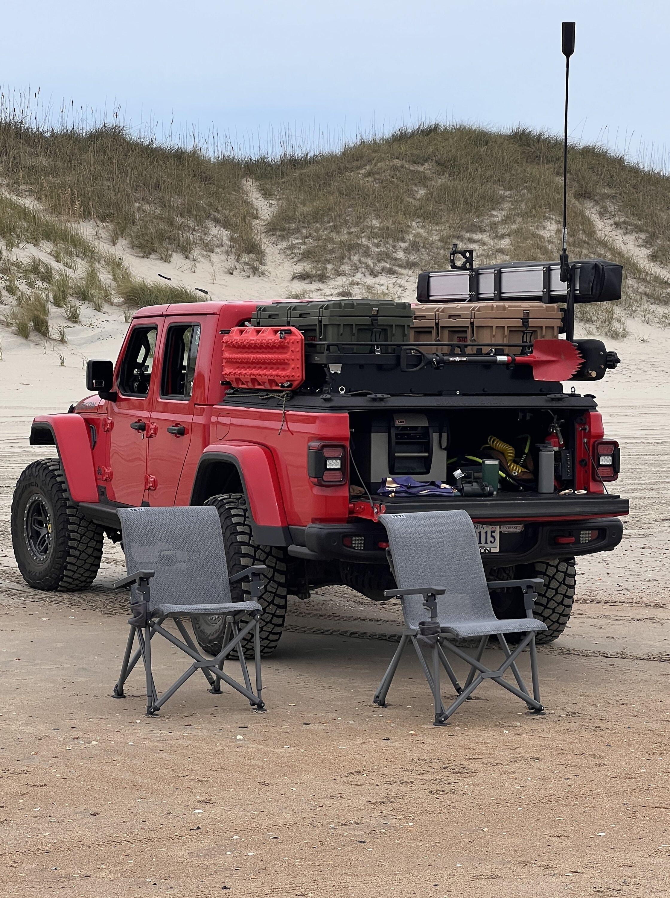

Yeah, mine is a Rubicon. This is what it looks like with the 2.5s and most of the gear
TLDR Version: when overlanding, I easily carry 1000+ lbs of gear consistently.
Jeep Gladiator AEV Dual Sport 2.5” Diesel Springs 169A3B70-615B-419A-A677-C7FD7C6A1E96
Jeep Gladiator AEV Dual Sport 2.5” Diesel Springs 42852C20-3851-4DFE-BEEB-FEA3AFC71959
This looks a little saggy in the rear but that’s an illusion because of the front flair design and the angle of the photo. It’s basically level when fully loaded with all my crap.
With all my gear, the rake is gone. It looks fine but it feels a little soft. I’d say it’s still better than stock That softness probably helped off road, but I wanted more preload for when I’m traveling with all my gear. It’s hard to say how much weight I’m carrying but it’s easily 1000+ pounds.

I’m not sure what all that adds up to but it’s easily beyond the rated load capacity of the truck. Probably over 1200lbs with passengers. However, GVWR goes out the window, within limits, when you modify the suspension. Maybe not for legal purposes, but for practical ones. Jeep specs the diesel with extremely light springs, that can’t handle the unloaded truck imho, let alone its 900lb payload capacity. The 2.5 springs bring you back to better than stock performance when fully loaded. The next limiting factor are the brakes and engine cooling. But this truck is designed to tow and stop a 6000lb trailer.
With all my gear, I’ve noticed zero change to brake performance, engine cooling (even in the mountains in 90° weather) or MPGs. I get about 23-24 combined.
The new 3 inch springs noticeably brought the rake back to the truck when partially loaded. It’s 1.5 inches higher in the back. The front is an additional .75 inches tall. So the truck now effectively has a 4 inch lift. With loaded ROAM boxes, the awning, etc., but the fridge, water and gear inside the bed removed, which is still easily 500lbs, the truck feels a bit “springy.” I wouldn’t run the 3 inch springs without some constant load. It would be harsh and bouncy. I’m actually considering reservoir shocks now. The 3 inch springs are the same length as the 2.5, but massively heavier and thicker. They’re taller by virtue solely of being heavier springs. They’re not designed to provide additional lift and only due so as a result of additional preload. I do think the truck looks a little better with the “3” inch springs.
