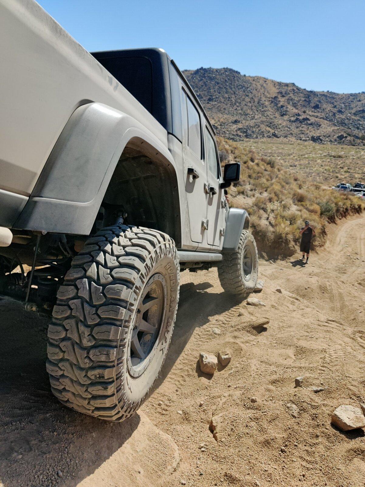

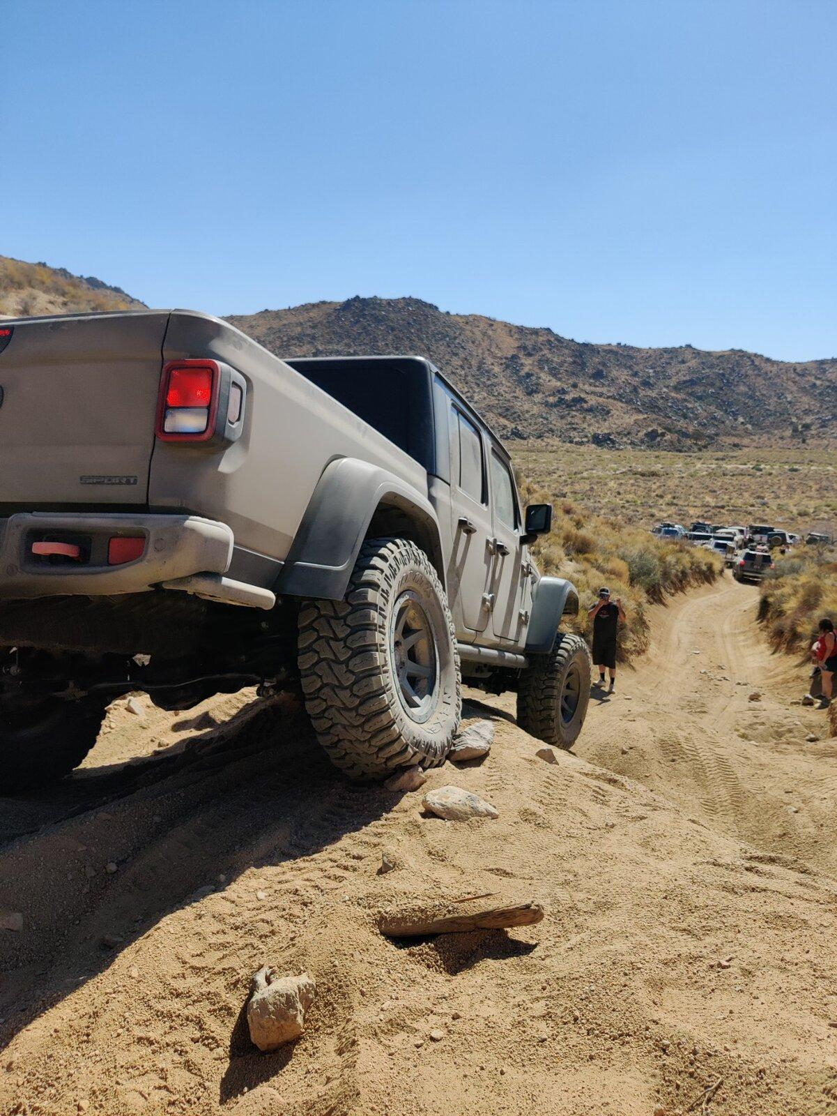

I’ve been curious to the articulation compared to stock on these lifts. Have you tests out the flex much?
I have. No complaints at all. Had better in Moab but unfortunately no pics. Had two people comment on how flexy it was getting on the radio.
