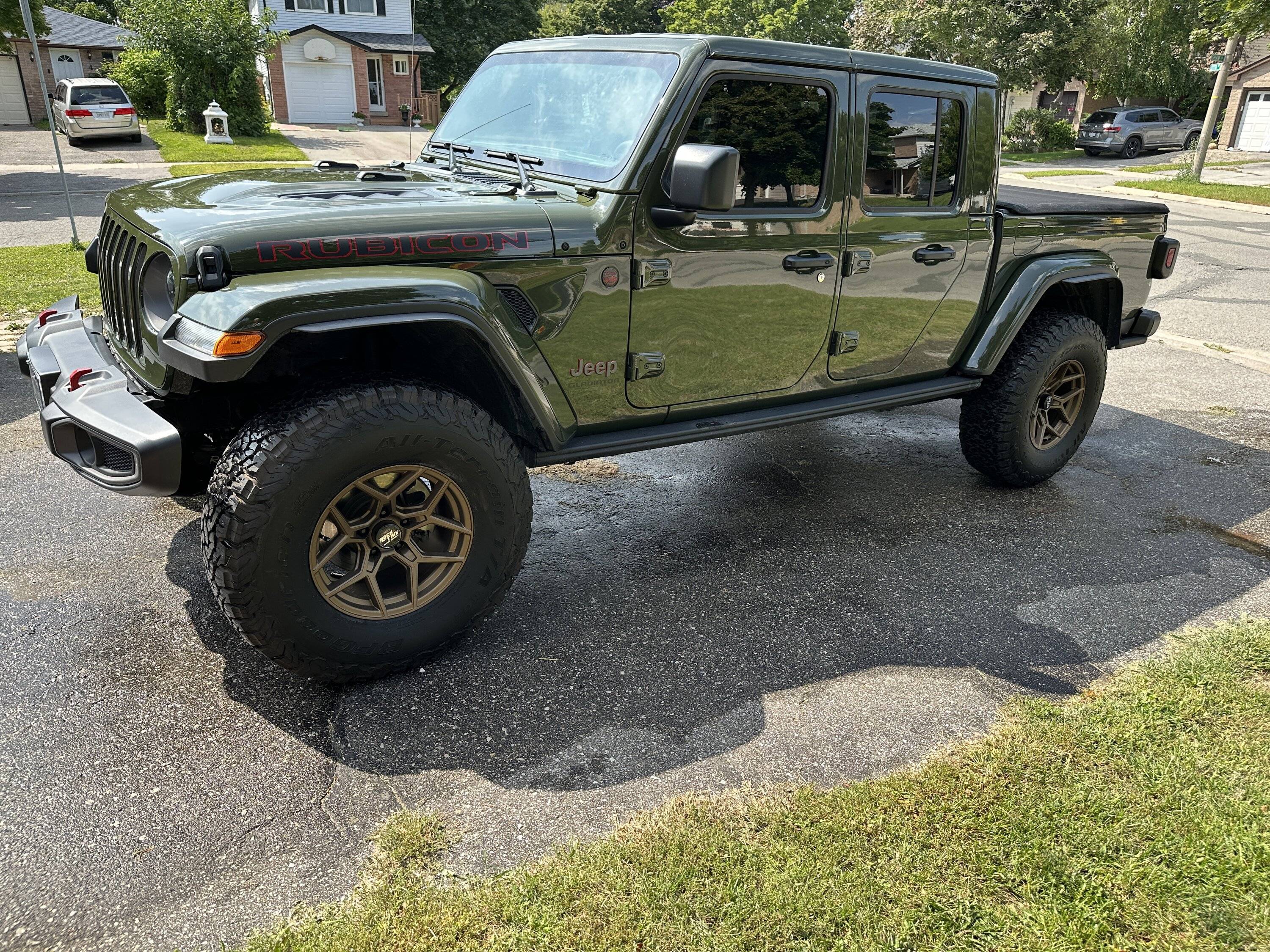

Good afternoon, I ordered an AEV dual sport rt 2.5" lift and synergy front track bar for my 2023 JTR. Currently has the 1.5" teraflex and .75" daystar in the rear with 37" ko2 on 17’s.
Was wondering if anyone had a long term review with the 3" HD springs? How much lift did you get and did you ever run them unloaded? I may eventually move to the 3" springs and 39" ko2, being in Canada I like having something winter rated.
would love to see some pics

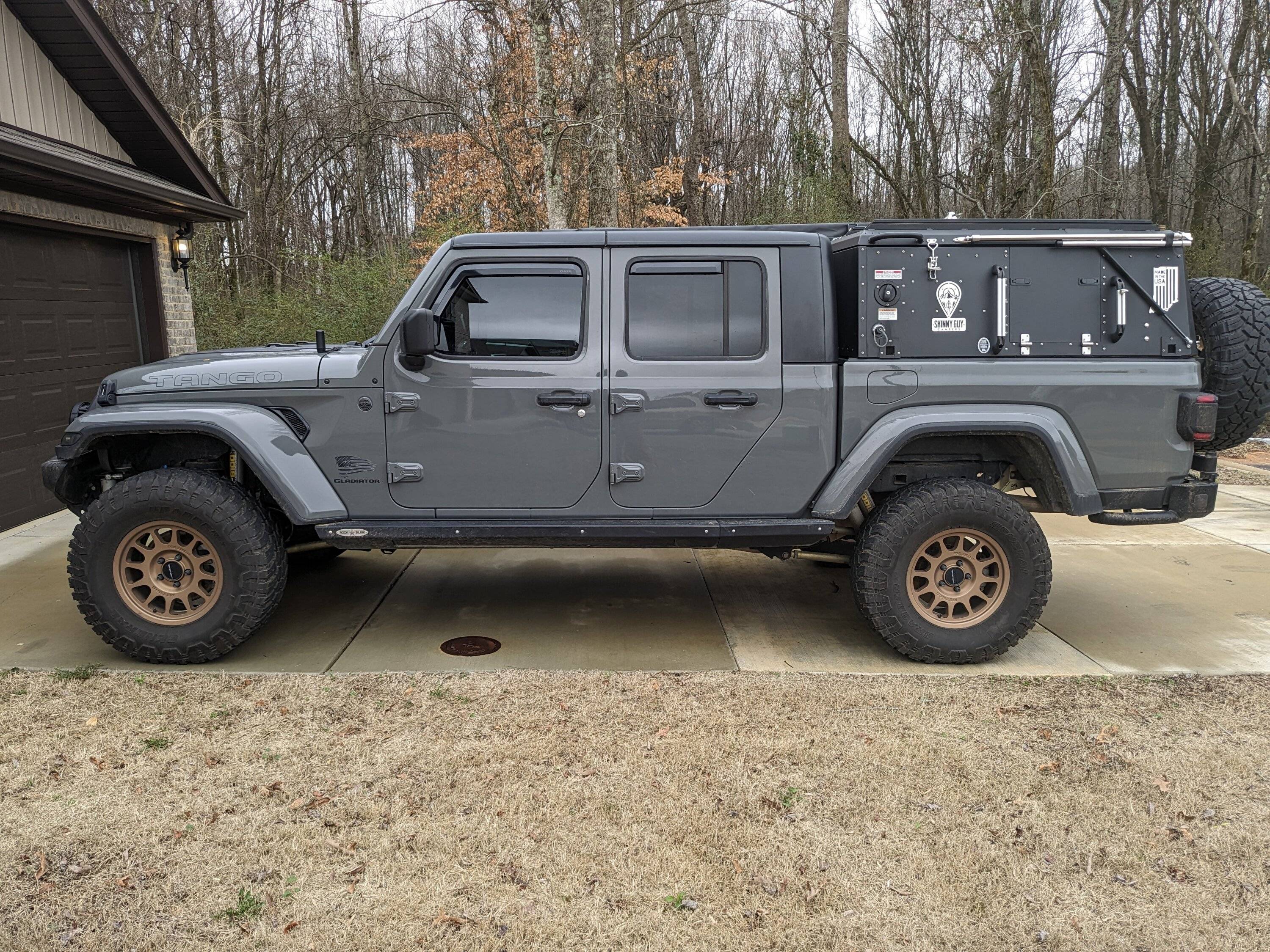

I had them on for a few weeks and just didn't care for them with my setup. AEV makes a great product, the HD springs just didn't fit my use case. When unloaded it was just too much rake for me to stay with them since I usually only have a 100 lbs in the bed. Adding a load on the hitch helped- about 400 lbs brought it down.
Thank you very much for the feed back, that’s kinda what I thought would happen as I’m unloaded 80% of the time. Guess you could add a 1 to 1.5 inch front spacer but then be into control arms and front driveshaft among other things.
May I ask what you switched them out too?

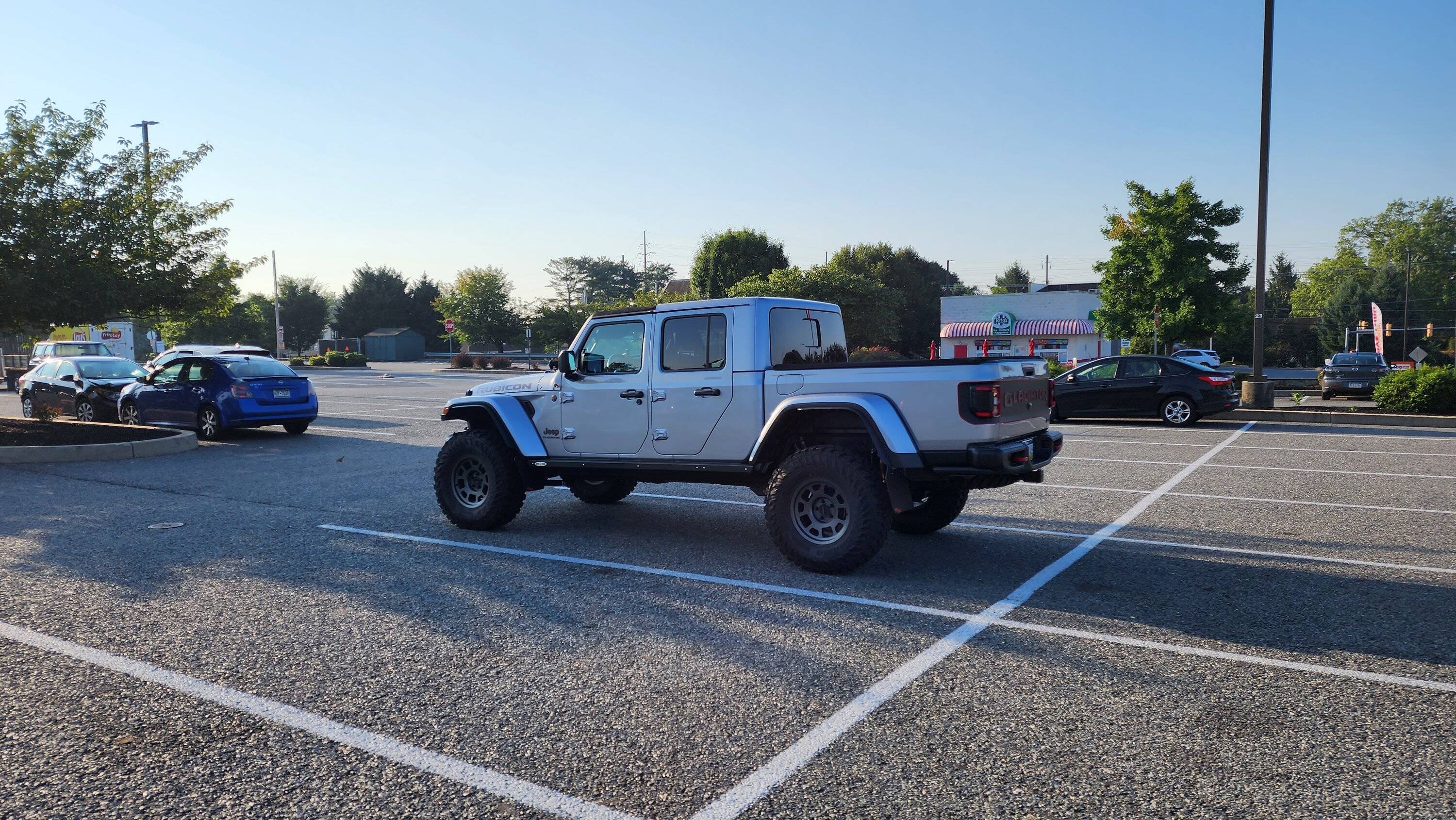

I've had it for over a year now and love it, but it's definitely intended for heavy bed loads. Even with 1k lbs or so on the rear, I still have rake. The few times I've ran it empty it's enough to be annoying.

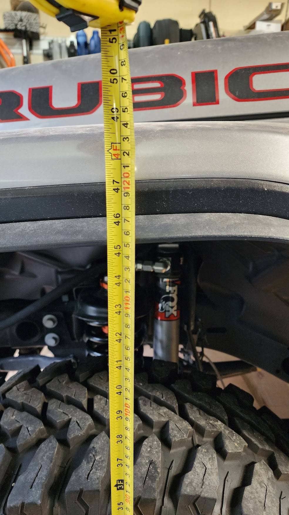

Running Clayton's 3.5 HD rear springs and Clayton diesel 3.5s up front but I have a 3.6; I just have some extra weight. That pic I posted above is with a 1 inch Teraflex spacer if I remember correctly.

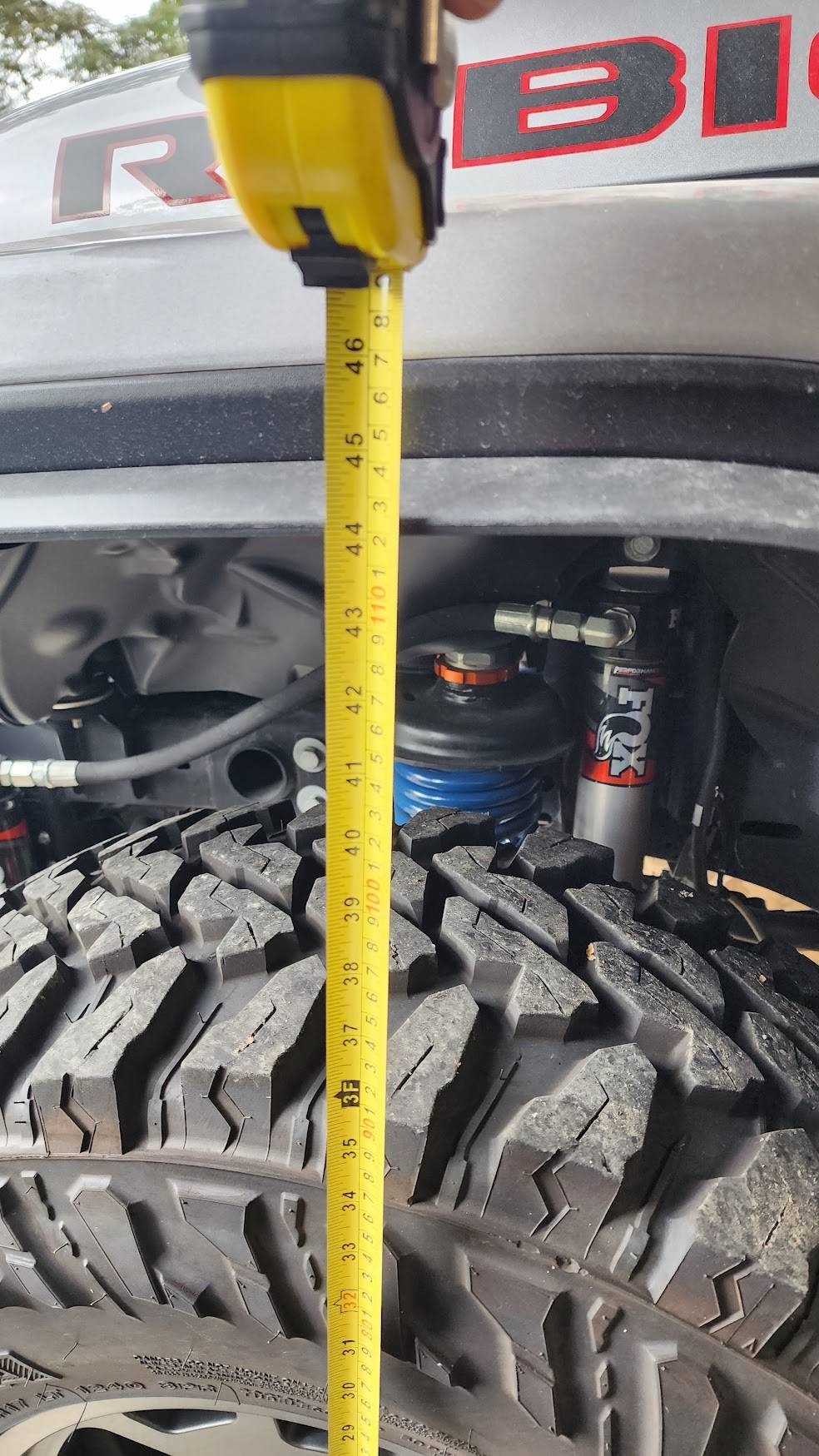

The AEVs were good springs, tho I am 100% happy with the switch. In either case, I was/I am oversprung, but the Jeep seemed to ride a little better with AEV. I run adjustable shocks, so I can dial things in to suit whatever it is I am doing (on road, off road, towing) and that helps a lot.
The Clayton springs put me in the next zip code for Fox 2.5s though, I am running the shocks for 4.5-6 inch lifts.
The pic below is with a 1 inch spacer on top of the AEV springs
