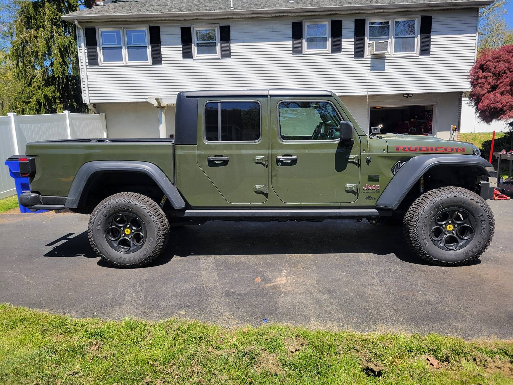

AEV kind of explained it, full rebound the end link will hit the backside of the Sport wheels. Unless you have Max Tow option with the wide track axles, the standard narrow track Sport axels and factory Sport wheel offset will hit as they explained. Could you get away with casual city pavement driving, maybe but how risk adverse are you?
I had this same kit on my 2022 Rubicon JT but that was with with the wide axles and AEV wheels.
