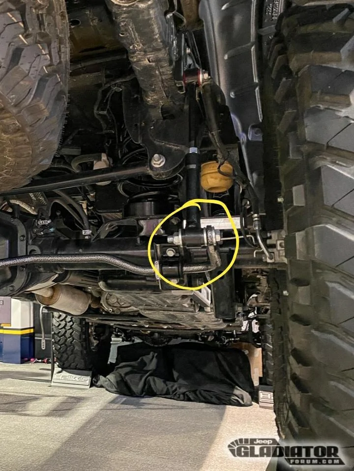

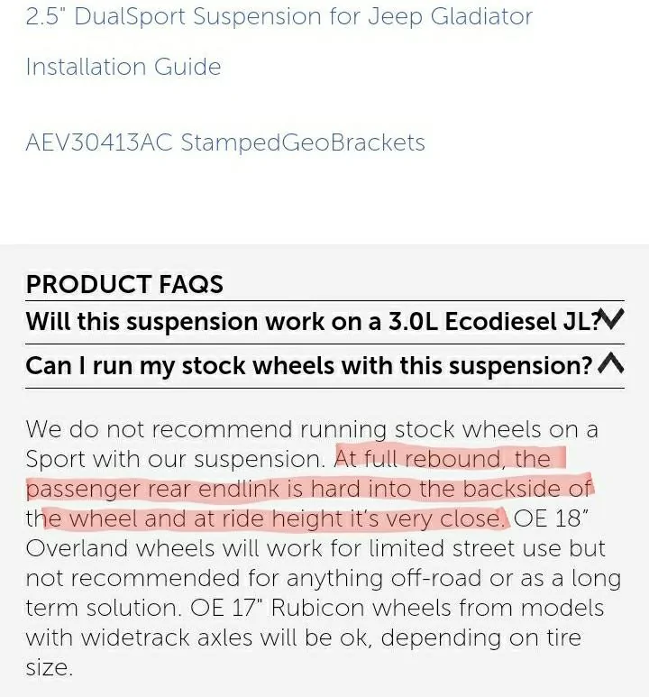

@JeepDadiator Enjoyed reading your thorough review and explanation of your decision criteria with the lift. Like you were, I am now between the Mopar and AEV DS for various reasons. I have a Sport S with standard axles (not max tow) which should be at my dealer soon. One thing I've found interesting about the AEV kit I've not seen mentioned with others is found in their FAQ section. They don't recommend running this kit with OE wheels and the standard axles due to interference with the wheel and passenger rear end link. I do plan to keep the OE wheels and run 33s or pizza cutter 35s so I'm not sure if this may preclude me from the AEV.
Jeep Gladiator AEV JT 2.5″ DUALSPORT RT SUSPENSION - Installation, tips and MOAB results! Screenshot_20220109-234359_Chrom
I'm guessing that some part of the wheel/tire contacts the link to bar connection circled below.
Jeep Gladiator AEV JT 2.5″ DUALSPORT RT SUSPENSION - Installation, tips and MOAB results! Screenshot_20220110-000010_Chrom
It doesn't seem to be clear as to why this is and I can't figure out why other lifts don't mention this but I am wondering if the cause has something to do with the rear axle being off center post lift given the kit doesn't have an adjustable rear track bar, or maybe it has something to do with the short rear end links and the end link brackets AEV use on the rear OR a combination of both.
When you installed yours, was there any indication as to why this situation can occur and if it can be remedied somehow for use with the OE wheels? I am just assuming that for whatever reason the Mopar 2" lift does not have this problem on any of the trim/spec levels. As you know it also omits the rear track bar bracket and the end link setups are different but nothing at all suggests the Mopar kit won't work with any of the stock Gladiators. TIA for any insight. As most folks are running aftermarket wheels, this doesn't seem to be a common consideration so I may end up making a thread on this.

Just finished mine up this weekend. I am running the AEV borah wheels so there is no interference. The AEV kit does come with a rear track bar tower to correct the geometry. I am pretty sure they factored in centering the axle as well as trying to make it as flat as possible. I checked yesterday and I was pretty close to dead even in terms of center in regards to the rear axle. Front axle was another story, but I added a SteerSmarts adjustable track bar in the front.
My hunch is that is has something to do with the longer length of the AEV end link as well as the narrower axle in the sport.
My experience has been that AEV has done their R&D really well with their products. Was my main reason for going with their kit.
If it helps, I can snap a picture of mine for reference. Won't help too much as I am running a +25mm offset wheel on a Rubicon axle. But there is ample clearance in my case.
Adding some spidertrax 1.75” spacers would fix this. They’re very high quality. I’m running 37x12.5’s on my stock rubicon wheels. No issues at full articulation and wheel lock.
