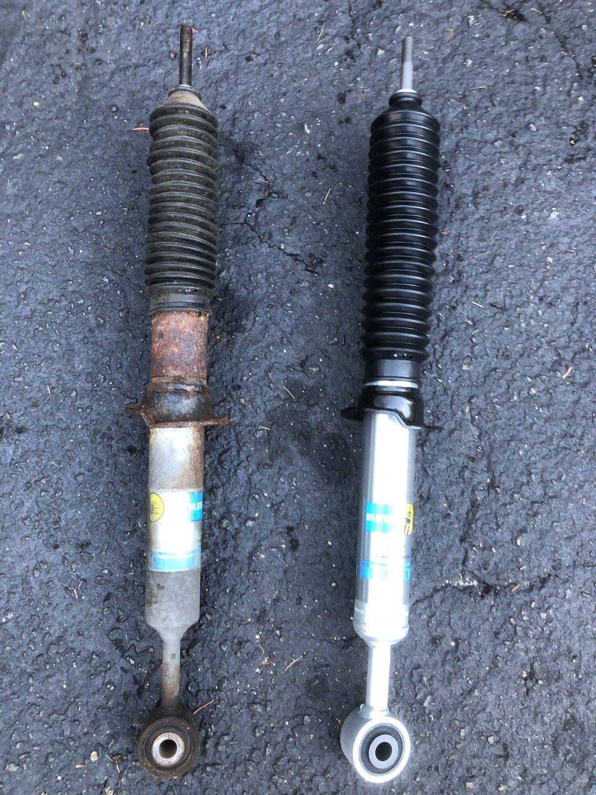

Not a huge fan of the 5100s they ride harsh and corrode pretty badly, I had these on my Tundra, at least they are cheap. My friend put Fox shocks on his JK at around the same time and they look a lot better with little corrosion.

From what I understand the 5100s AEV provides are custom valved to their springs. Not to say it won't be a harsh ride but it might not be the same as OTS 5100s. That corrosion does look rough though. I wonder if they would have survived better without the boot trapping dirt and moisture? I know it was always a big debate about pros/cons of shock boots.
