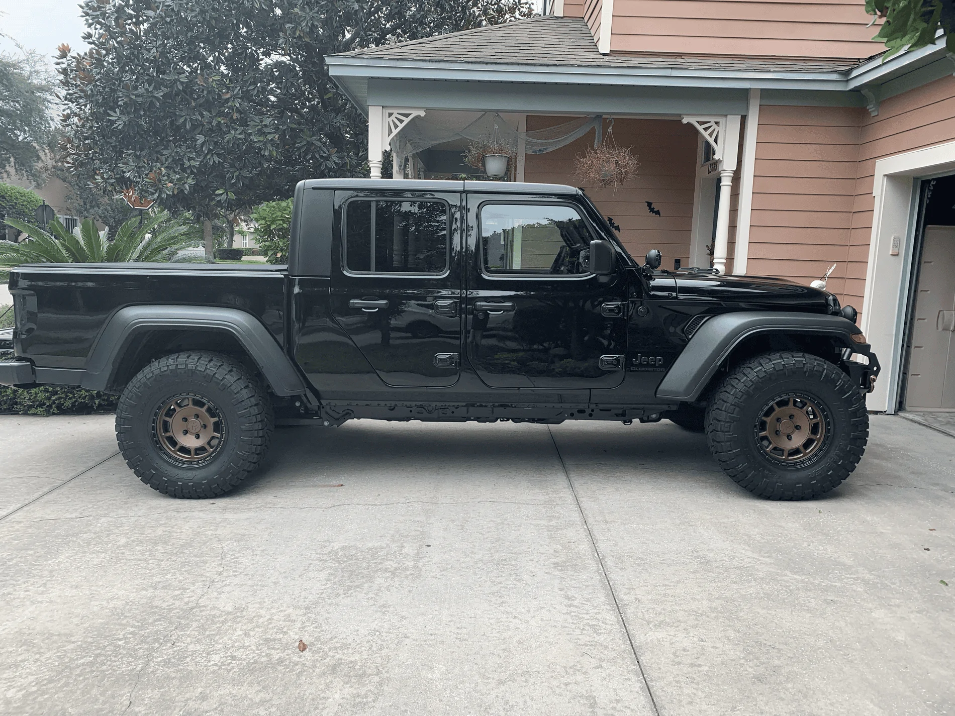

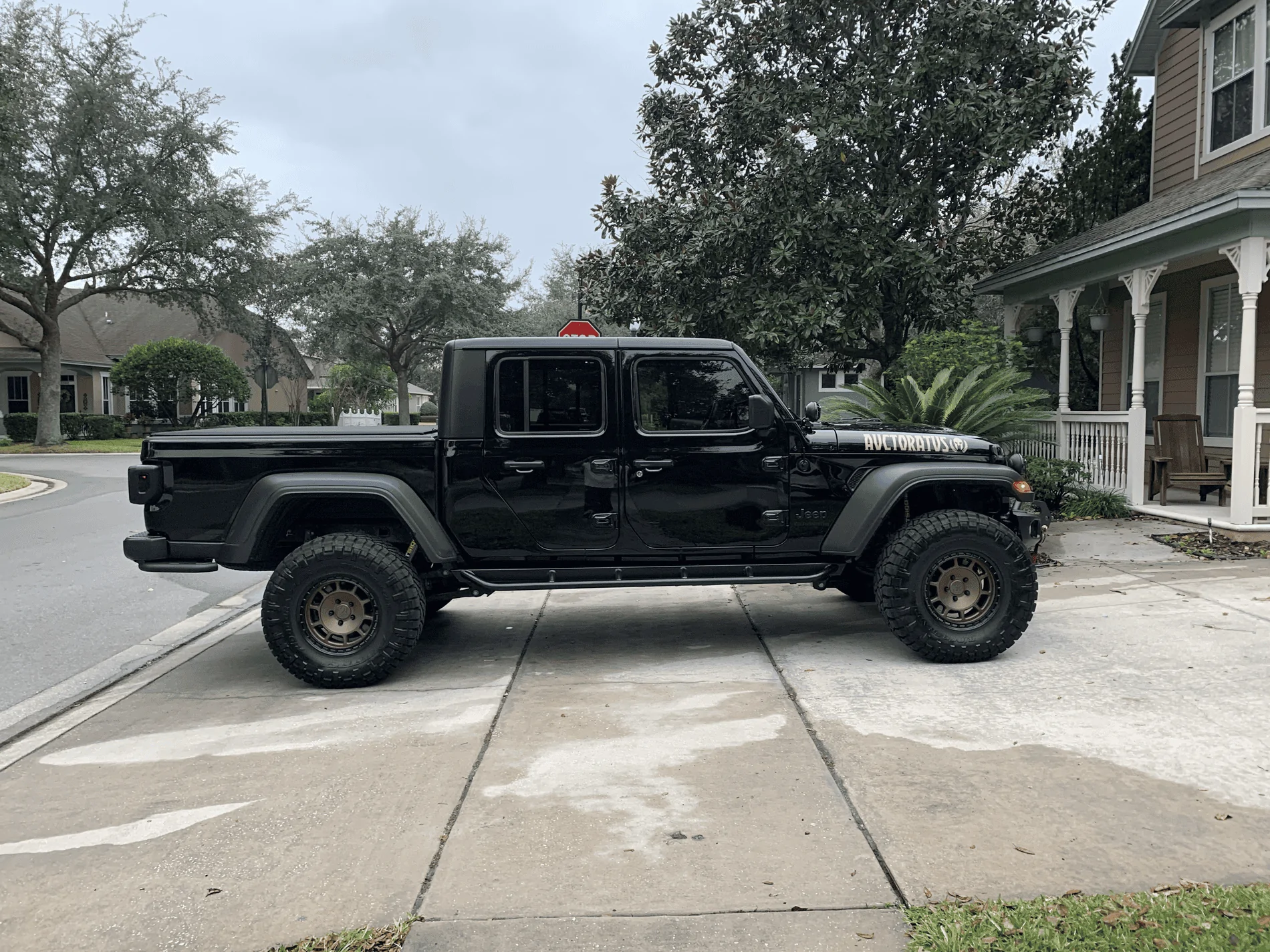

I know many people asked about towing with the AEV suspension. I finally had the opportunity to tow with this new suspension and it did not disappoint. I rented a small RV for a weekend wheeling excursion. The trailer was 3700 lbs (largest recommended before needing to add trailer brakes) so about half of my max tow's capacity. The AEV keeps the factory rake so when the trailer was attached I was still slightly raked and that was with the bed full of gear as well. Truck handled perfectly. Tracked straight, no excessive bouncing and solid under braking. I just continue to be really impressed with this suspension. Along with towing the RV, the Gladiator saw 3 full days of trail rides and just met every obstacle without issue (moderate stuff no crazy rock climbing in central Florida).

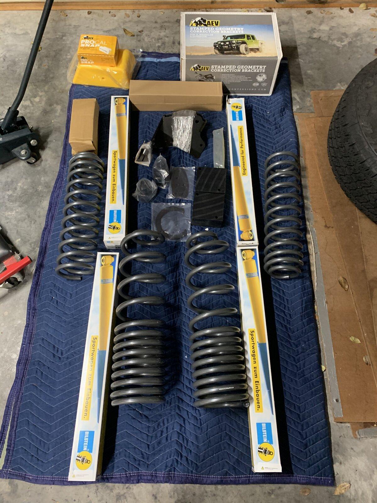

Like many I have labored over the selection of a suspension upgrade for my JTMT. Ran through the usual suspects (Clayton, MC, Mopar) and decided on the AEV DualSport. I just felt like it was the most complete kit for the money based on how I was going to use the vehicle. Its my daily driver but I am active in my local Jeep Club and go on several trail rides per month. I live in central Florida so no real hardcore rock climbing(mostly soft sand, mud, washout areas and moderate slopes and off camber situations) so the need for the articulation ability of the Clayton or MC was not as critical. I also like that AEV has taken the time to frequency tune the springs and valved the shocks to match. I was able to install it on Thursday but ran out of light to get some decent pictures of the completed work. Overall the install was pretty straight forward. Torquing control arms while lying on your back is never easy :). I was able to take it on a short test drive and I could feel an immediate difference. The vehicle just felt more stable and planted to the ground. Turn in was much more precise and body roll seems better controlled. The ride is definitely firmed up. Feels similar to driving a European vehicle (more damping, tighter handling, with a little more feel for the road). Once I get some daylight I will snap some pictures. and show before and after. I did not measure vehicle height before (lift height was not my determining factor)so I don't know how much lift I gained but its high enough for how I am planning to use the vehicle. It is definitely higher all the way around vs. what I got from the Teraflex leveling kit that I had installed previously so I could run 35's. .

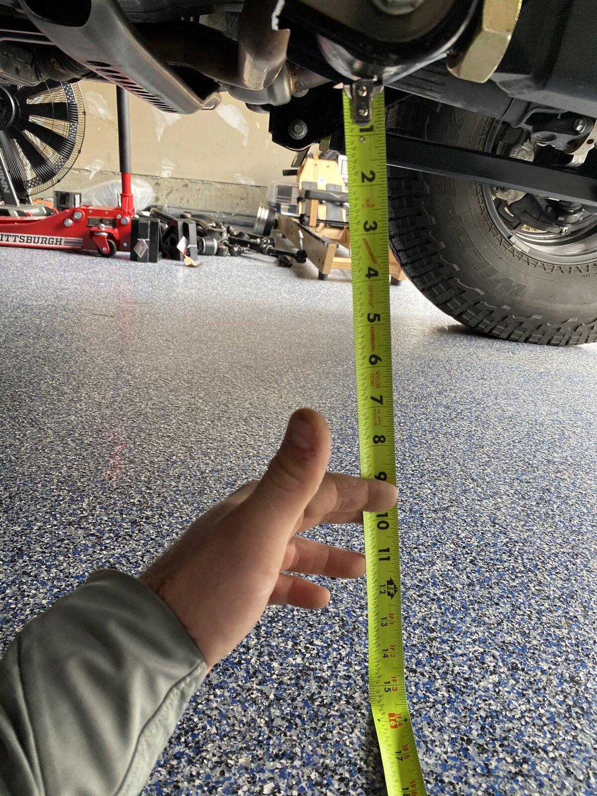

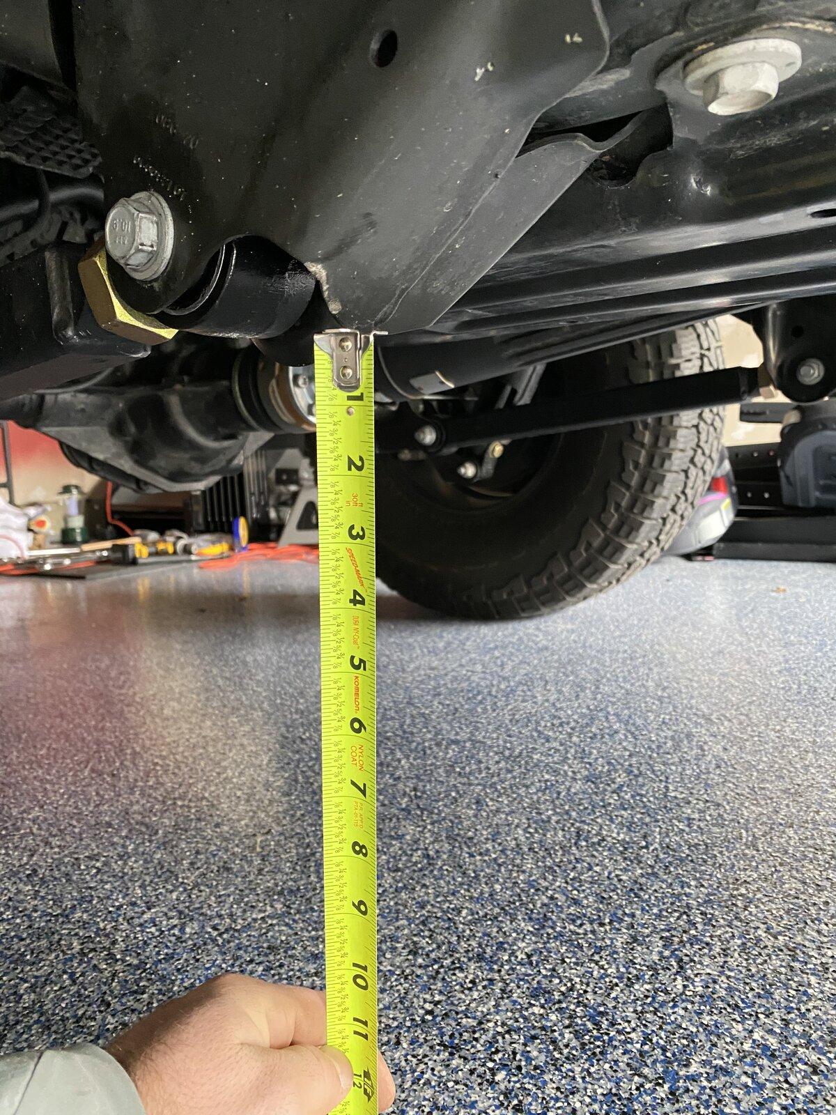

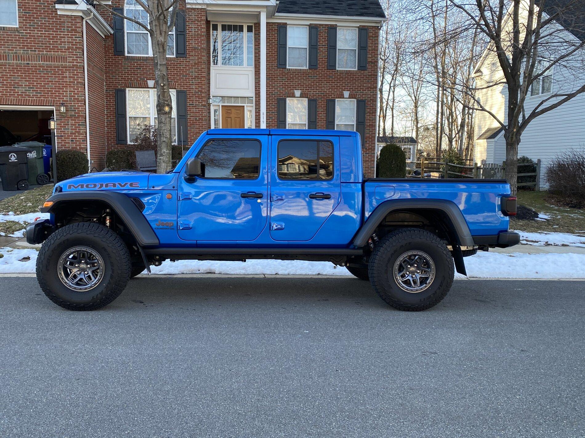

I did the AEV brackets with the ACA’s on my Mojave lift. It is such a game changer for vehicle dynamics. And, for my uses, no impact to trail use since it doesnt come down any lower than the rear lca mount
