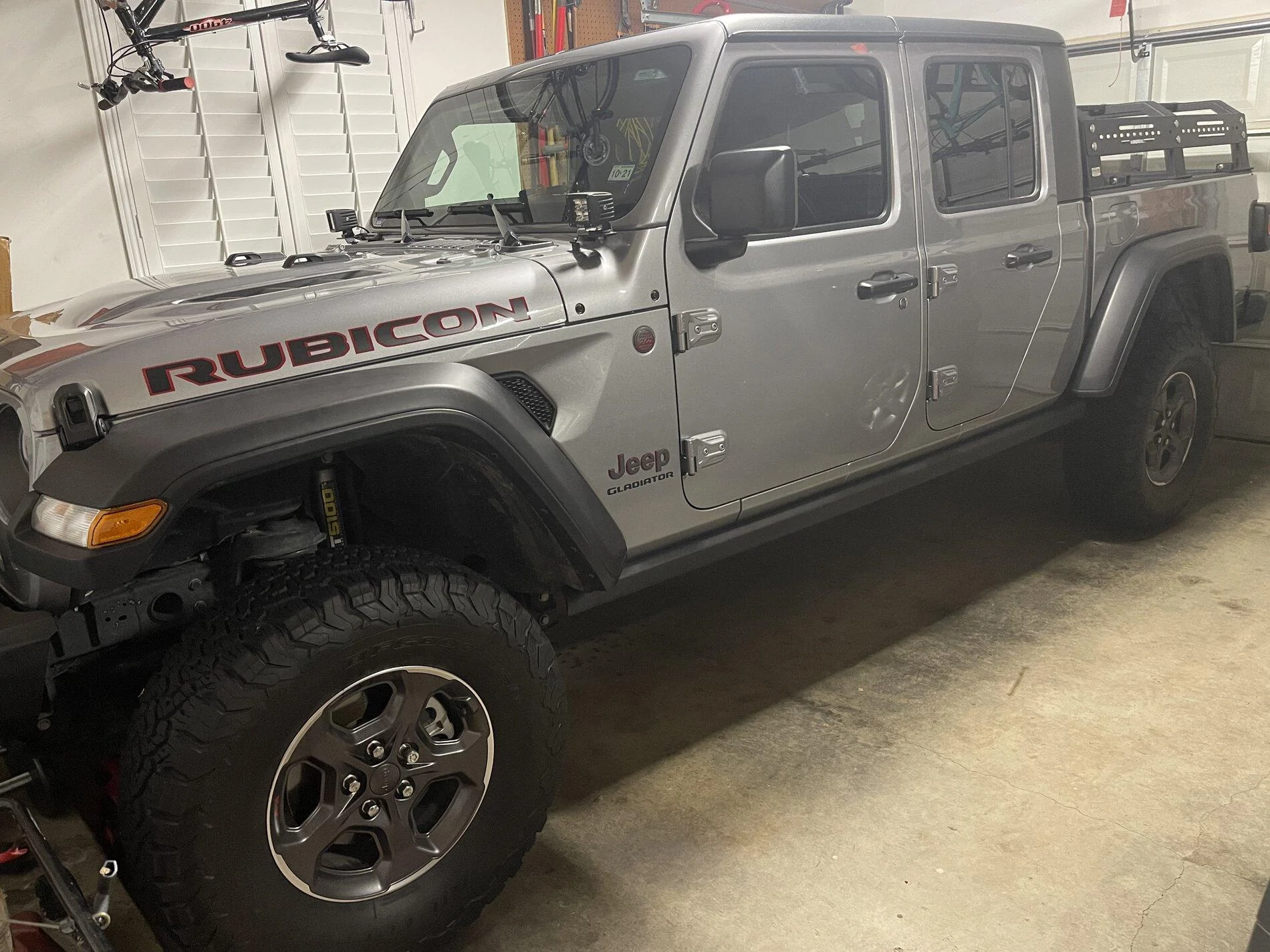

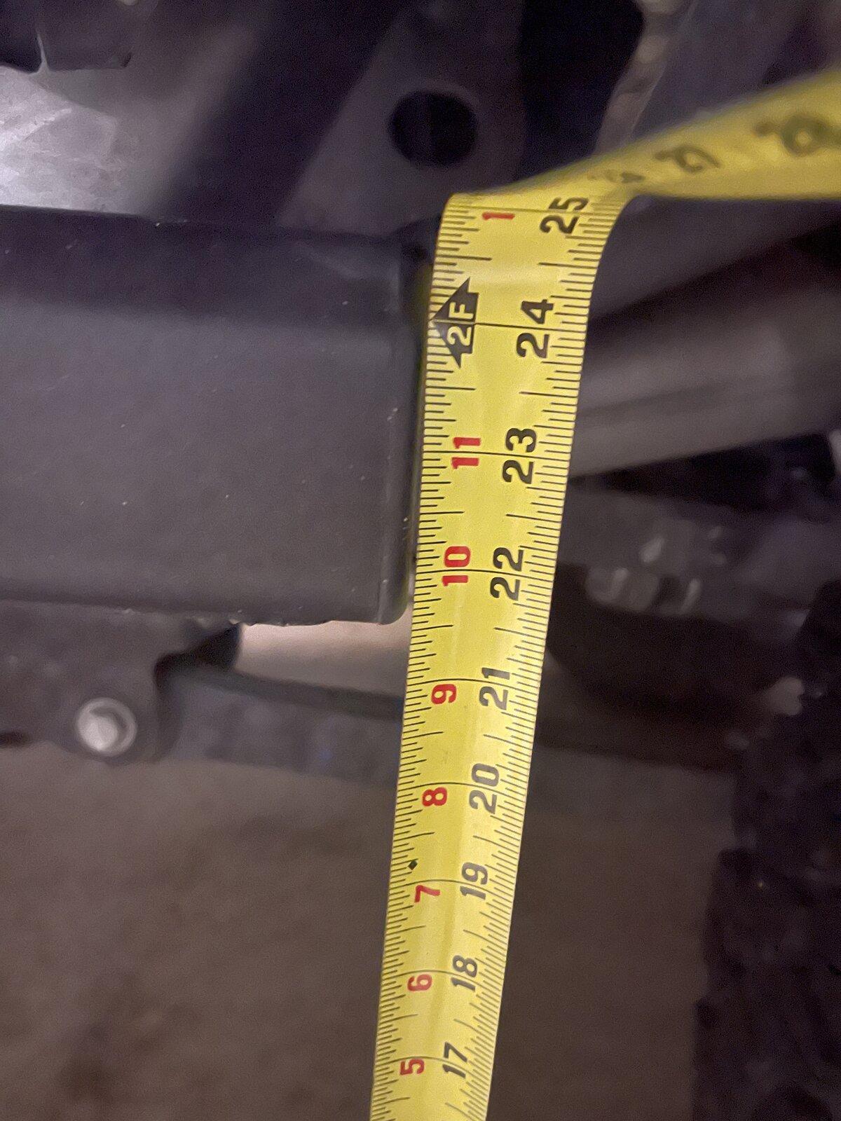

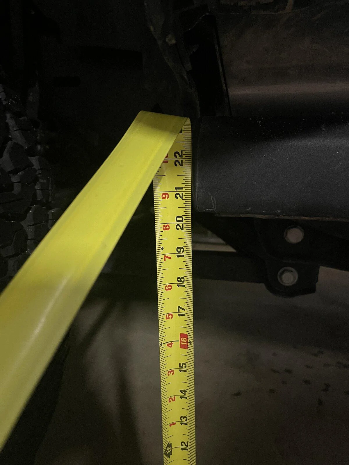

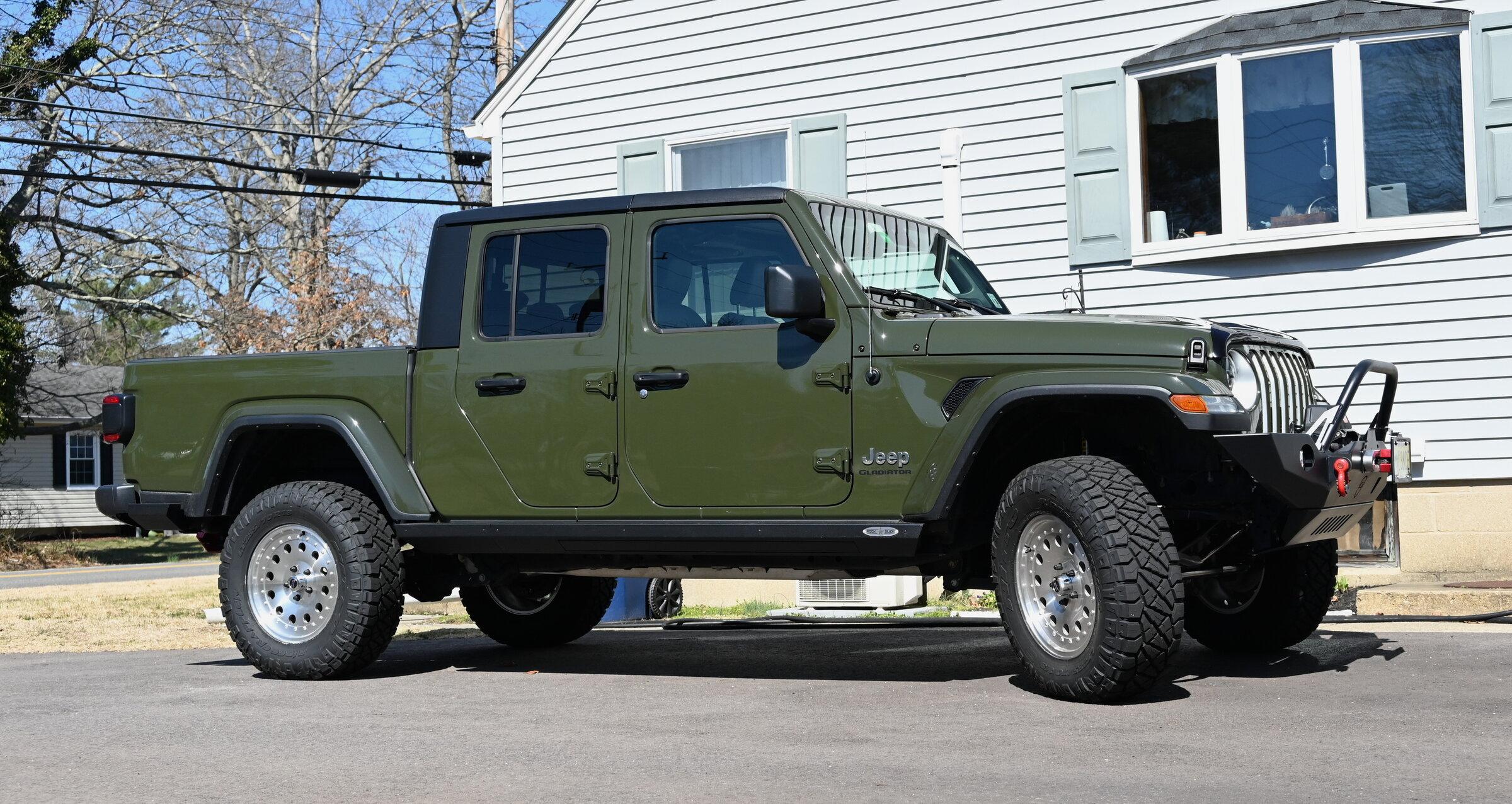

Looks like it is about 1.25” rake measured from bottom of slider. Not the best pics but hope this helps.

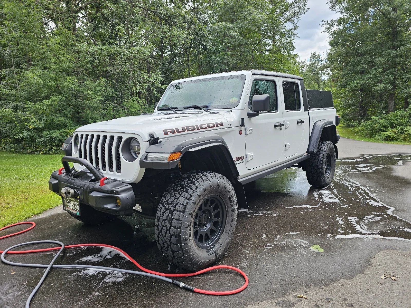

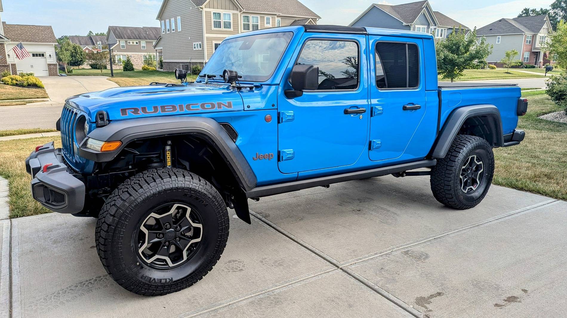

2.5 Dualsport RT with 37s nittos and 17x8.5 w/0 offset methods.
Installed about a month ago. I'm happy with this kit for now. I do want to swap out the shocks. The ones that come with the kit make the ride just a tad bit harsh for me especially when I hit a bump in the road with an empty bed.

looks good did you install a spacer in the front to level it?

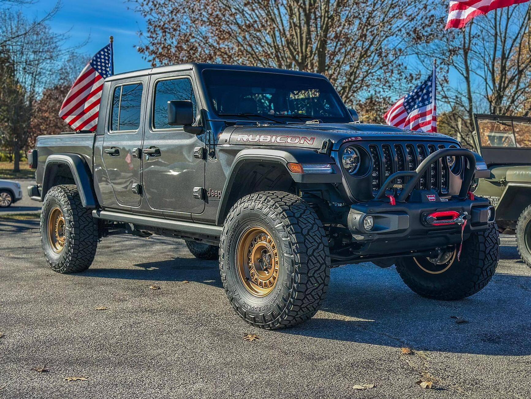

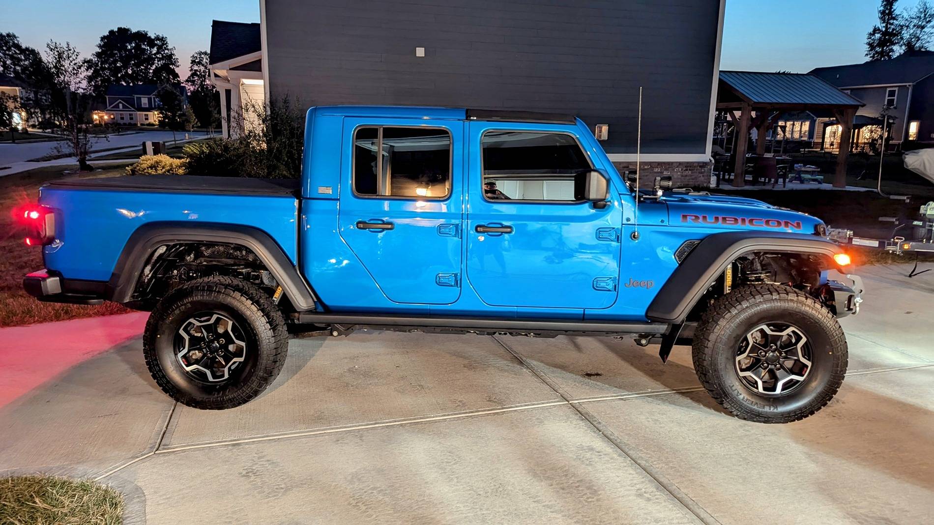

Here's a few shots of the AEV 2.5 Dual sport with 35's.....I like it, but it is all totally subjective.
Jeep Gladiator AEV JT 2.5″ DUALSPORT RT SUSPENSION - Installation, tips and MOAB results! PXL_20241021_224513826.MP
Jeep Gladiator AEV JT 2.5″ DUALSPORT RT SUSPENSION - Installation, tips and MOAB results! PXL_20240827_005959912~2
Jeep Gladiator AEV JT 2.5″ DUALSPORT RT SUSPENSION - Installation, tips and MOAB results! PXL_20240622_230331789.MP~2
