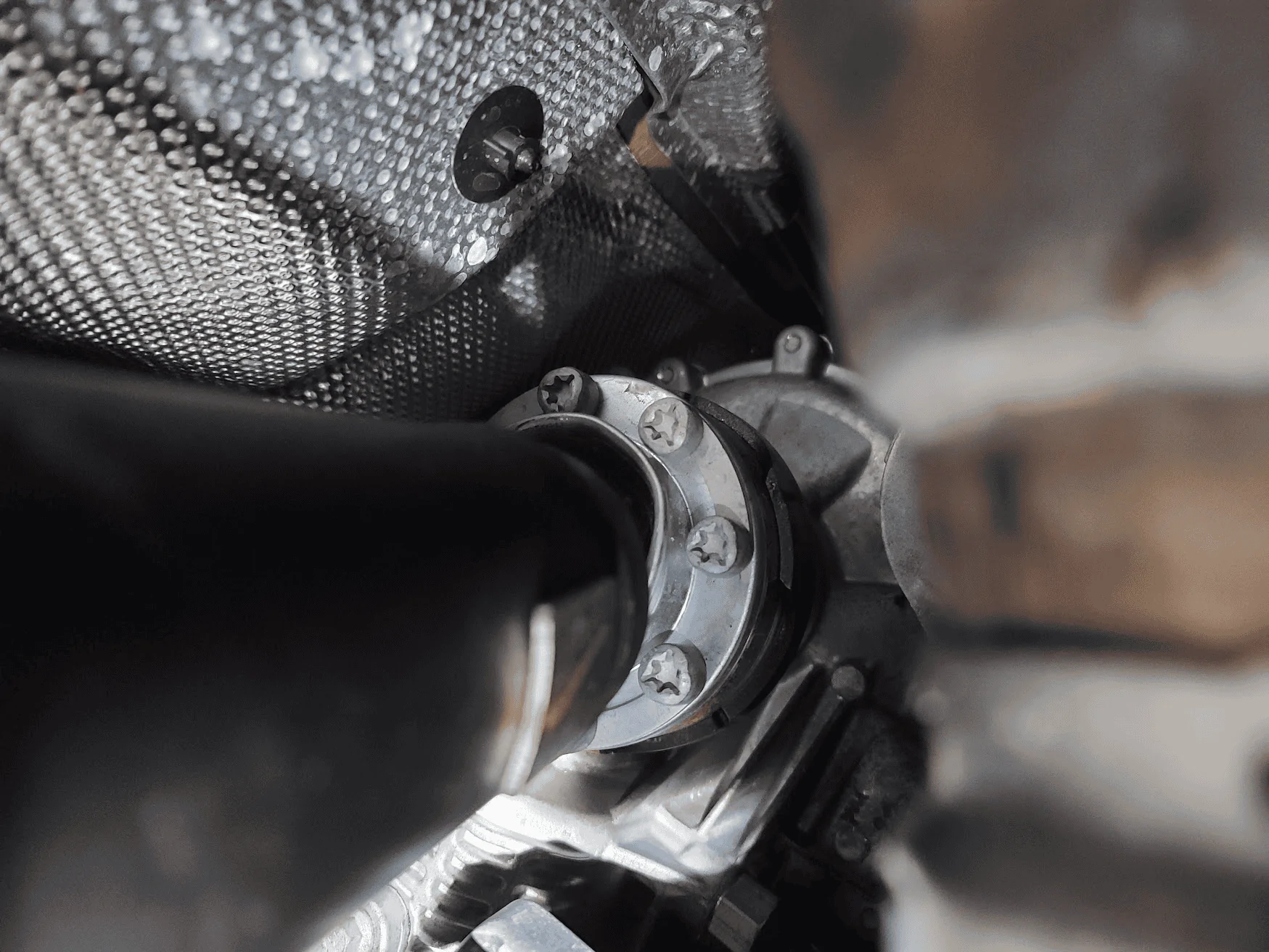

Also, when dropping the front axle: have you gone back and looked at the driveshaft mount on the transfer case side? Mine is almost oval-shaped now because I allowed the axle to drop far enough for the springs but didn't notice the driveshaft shroud (surrounding the boot) wasn't meant for that :facepalm:. Thankfully it doesn't hinder the driveshaft rotation when it's all put back together, but that could have been worse!
I had adjusting the headlights on my to-do list upon completion - but found that I didn't have to. My heavy bumper and winch set up gives me enough rake that it wasn't necessary. I haven't had a single "flashing" complaint from oncoming traffic to confirm what I found. (I kinda wondered about the spring strength with the rake I have, but haven't measured it ... dang it, now I have another thing for the to-do list.)
Next - I am going to have to go look at the transfer case shroud; I was super paranoid about dropping too much, and didn't see any damage, but will have to go purposely put eyeballs on it to be sure. Thanks for the heads up!

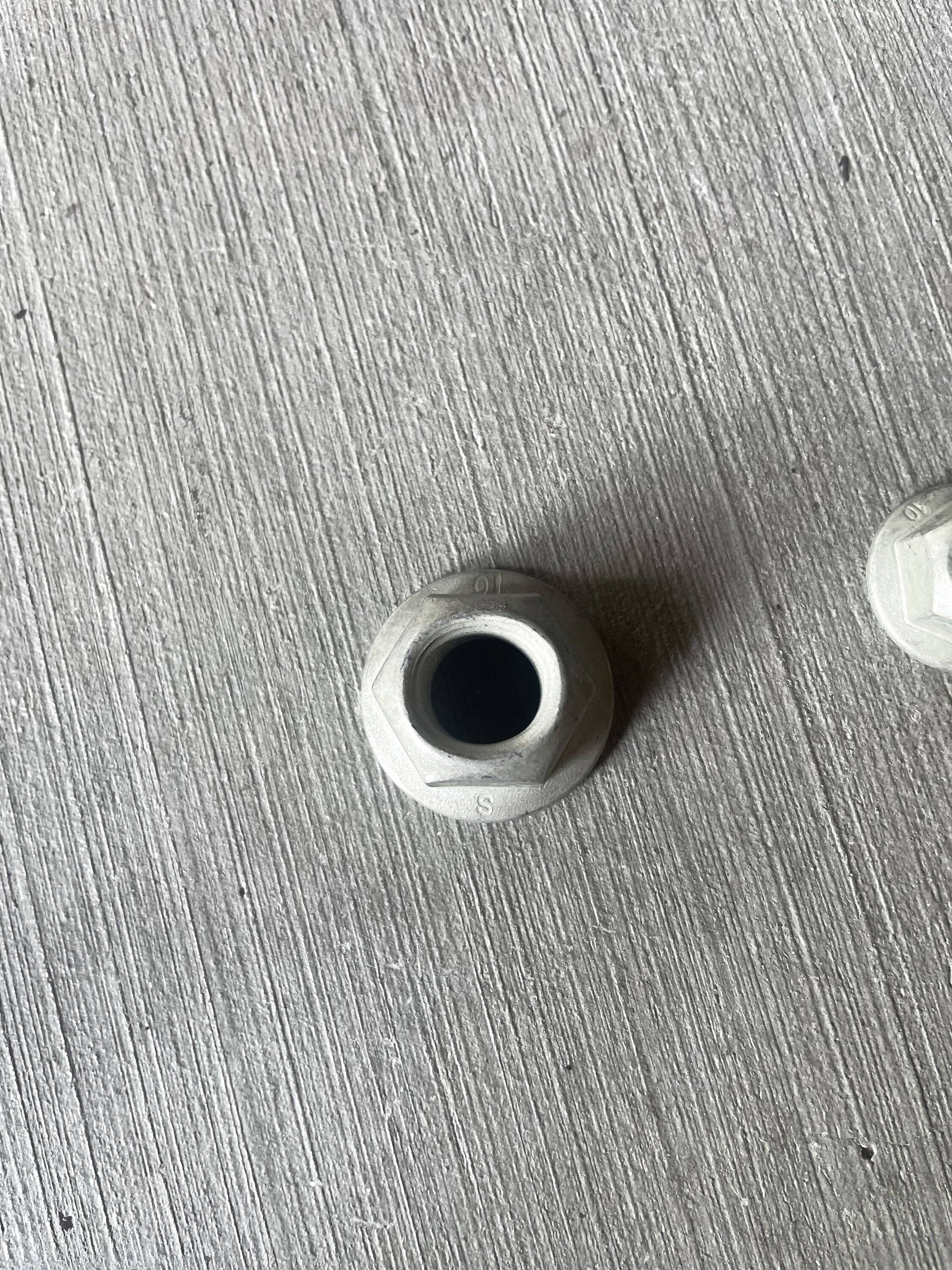

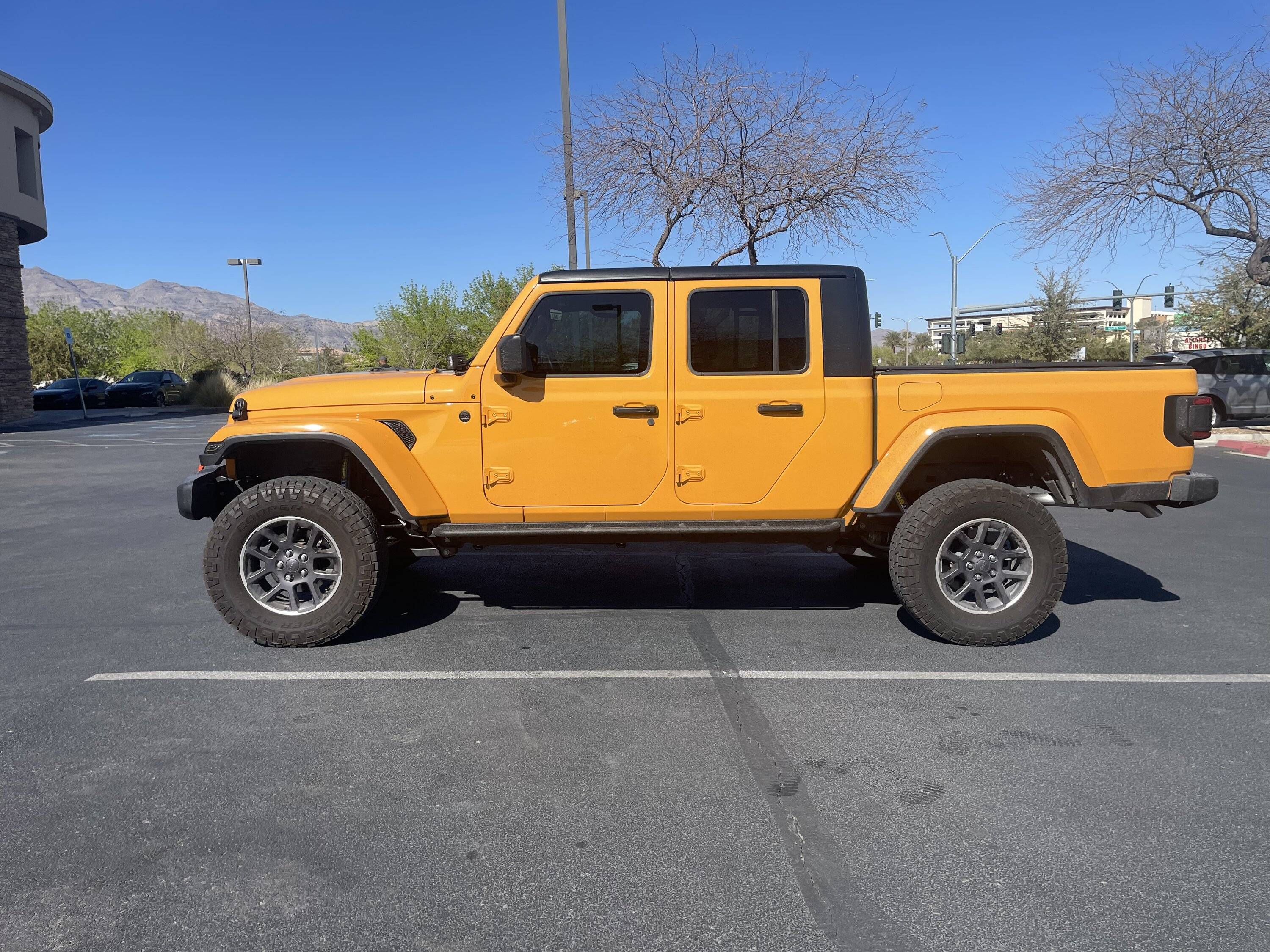

Some of my experience with this install. It took me 2 full days (jacks with jack stands) for install on my 21 Overland. First off, all the nuts AEV provides seemed to be bent which halted my install until I could make it to the hardware store. For me, the unforeseen hurdle was the front bump stop extension adapter thing. Had to be creative with my floor jack to get the rubber bump stop in the adapter.
Those nuts may just be a crimp style mechanical locking nut. If its round on the flange side and gets oval on the opposite side in a kinda taper, then its a locking fastener.
I'm most likely going this route, AEV. So Im reading up, lol
Supreme Nacho
Afro
Nov 21, 2021
Las Vegas
2021 Jeep gladiator overland
Military advisor
Didn’t know there was such a thing…. Would’ve saved my trip to the store if i would’ve known!!! lol
