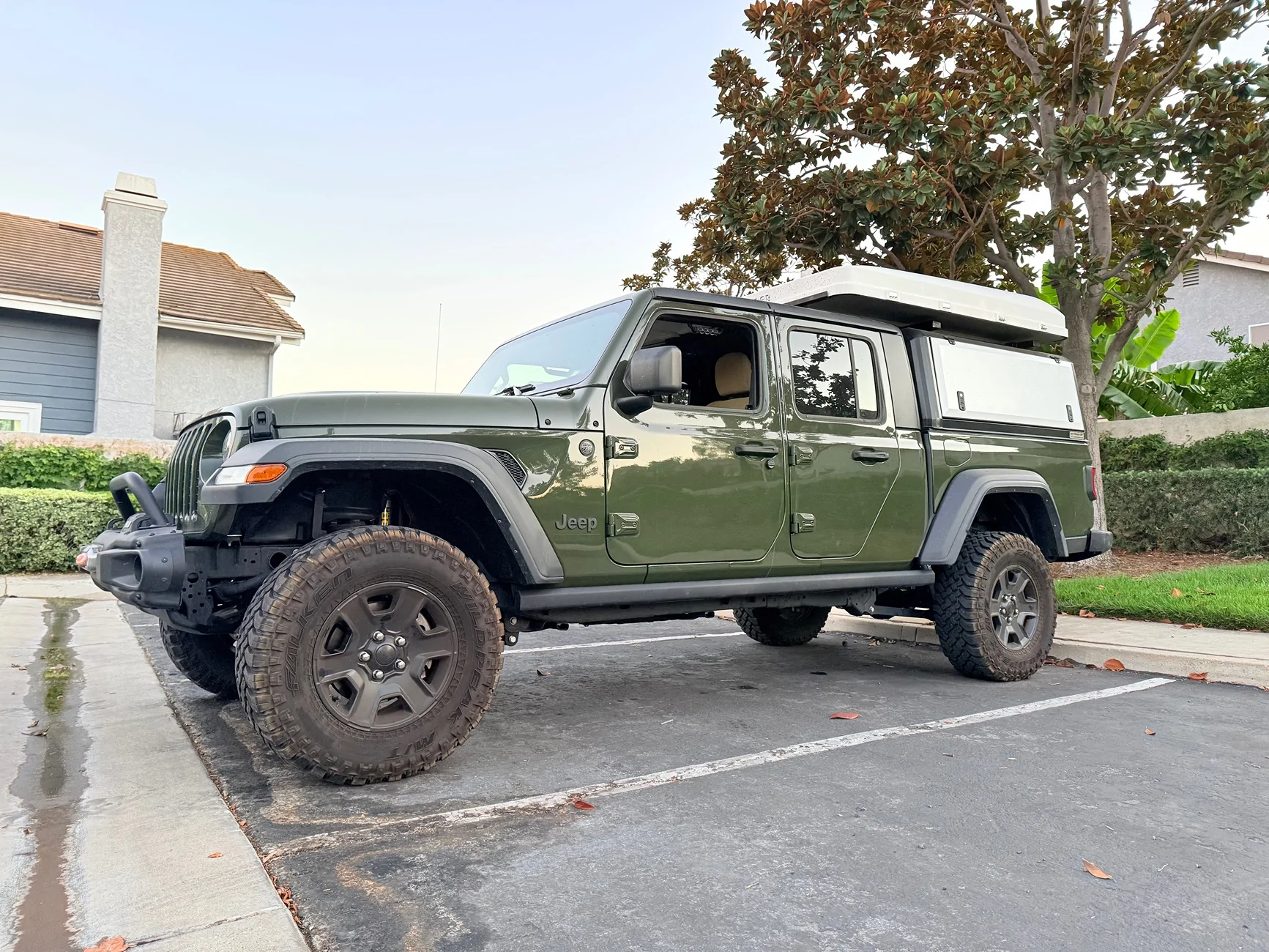

remlemasi
Elmer
Sep 30, 2019
314
221
SoCal
Sport Max Tow
I just installed the AEV 2.5" dualsport kit and decided last minute to do the opposite of y'all and throw on 3/4" daystar rear spacers I had from a previous project to ensure I have rake for when I load up. haha...
I did put TeraFlex isolators up front and they theoretically add 1/2" of lift. So I guess I have 1/2" spacer up front and 3/4" spacer in the rear.
I have a whiteline (compare to Hellwig) rear sway bar ready to install. I will try it on the softest setting to start and evaluate and adjust on the next fully loaded camping trip.
RTT, canopy, Hi-Lift, molle panels, are probably close to 400lbs on the rear "unloaded." Drives great right now, no sway bar strictly necessary. Probably another 200-300lbs with the camping gear.
I could probably have gone with the 3" HC springs, but didn't want to be oversprung. My backup plan was to add AirLift airbags if it was too soft in the rear, but decided to try the 3/4" spacer first.
Measured at the front and rear ends of the rock slider, it's around 1.75" of rake, but visually looks even enough to me to not worry about too much rake "unloaded." Should sit nice and level once fully loaded, which is the ultimate goal.
