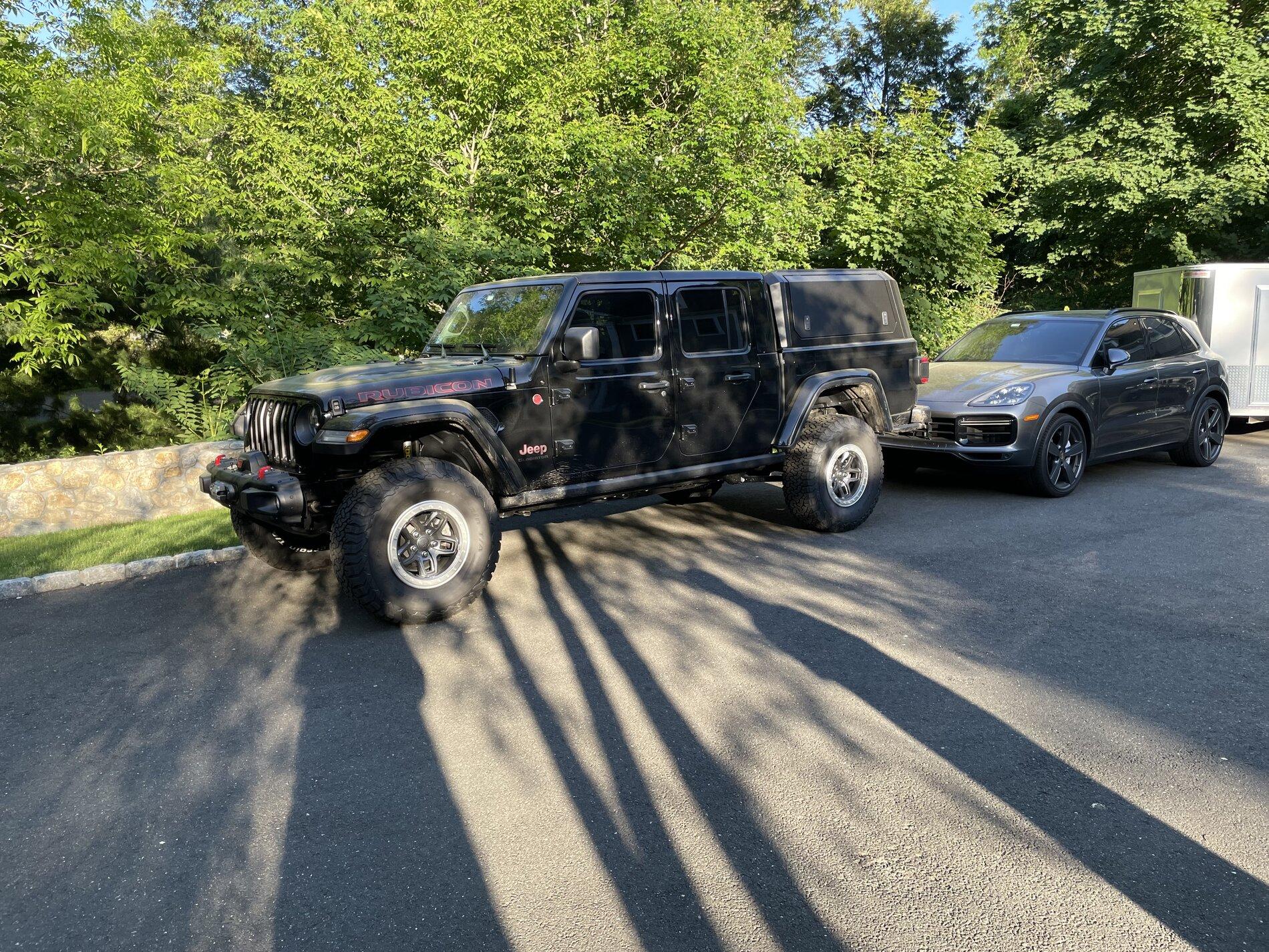

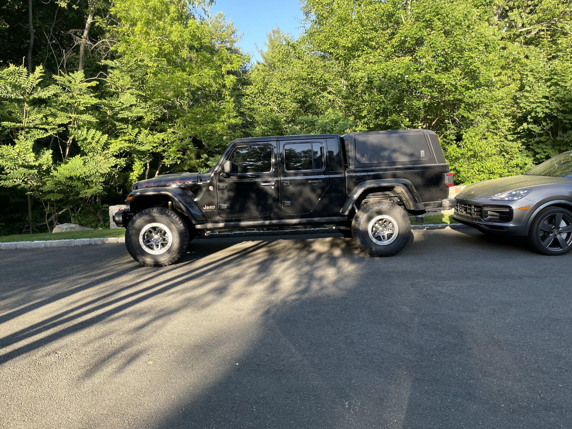

Installed the lift yesterday. Two issues with hardware that I am waiting on AEV to resolve, so can’t drive it until then. But I think it looks good...
will get better pics without shadows later

1. The u-bolt for the rear track bar bracket stripped the threads before getting to torque spec.
2. They sent the wrong bolts for the rear bump stop spacers. Check the bolt package before beginning the install.
I’ve done 3 of these kits now (2 on JLs) and this is the first time I’ve seen an issue with them. They corrected it immediately, and the replacement parts should be here today.

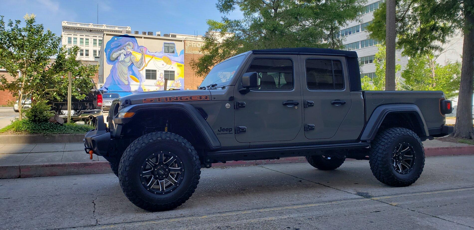

Got my kit installed. Had two issues. First, the kit was missing two of the rear bumpstop nuts. Second, the rear trackbar u-bolt torque spec said 43ft/lbs. The bolt snapped when I got to 30. I called AEV customer service but I think it was late on the Friday of Memorial Day weekend and they were closed. So I left a message and someone called me back farily early the following Tuesday. I told them the issues and they sent the two missing nuts and another u-bolt. Received them by Thursday! Kudos to AEV for that!! I haven't tried putting it on yet. I'm worried it's just going to snap again. The trackbar bracket seemed solid enough to drive it without the u-bolt, so I have. Initial impression is pretty much the same as others, it's stiffer but not harsh, and I like it better than the soft Rubicon suspension I had on there. I haven't pulled final measurements yet but it's probably closer to a 3" lift than a 2.5".

I had the same issue with my u-bolt. The new u-bolt they sent me is different (shiny zinc coated) and torqued down just fine. Give it a go and you should be fine.
