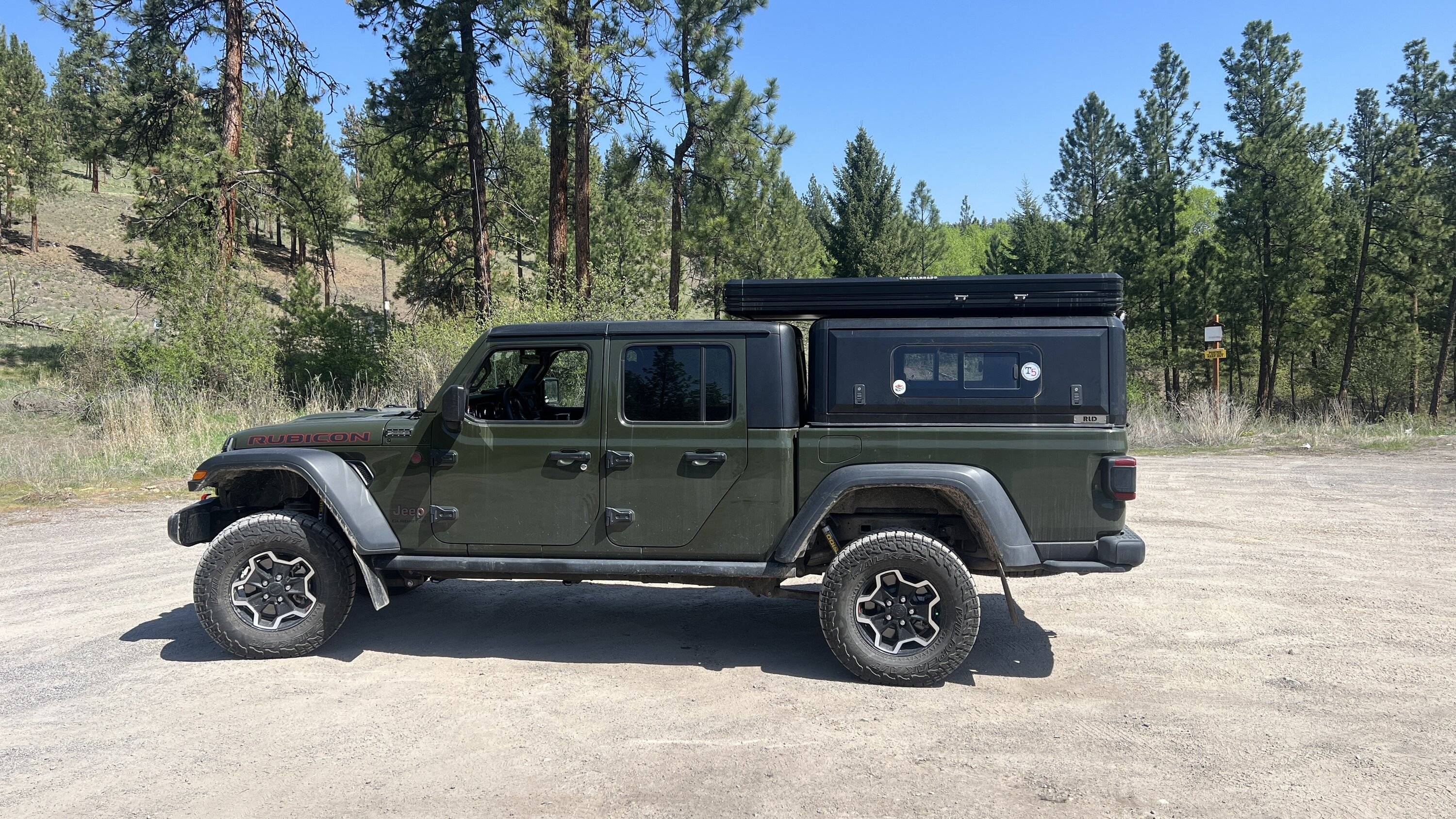

Never got measurements I guess. Here's a photo for reference. AEV dual sport SD springs with stock 33" tires and 650 pounds of extra weight (canopy, RTT, batteries, etc.)

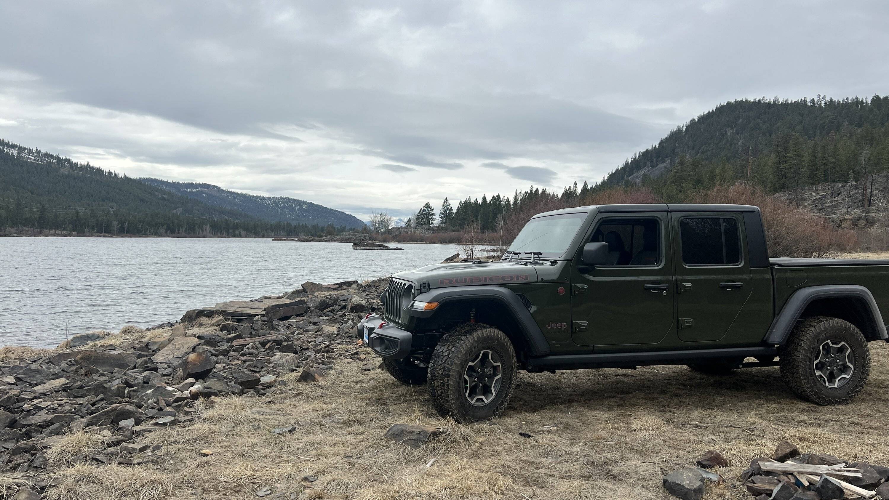

Here is the first pic ever - bone stock (well I think the soft top was in the bed before I realized it came with the JT).
Jeep Gladiator AEV dualsport 2.5" actual height image3
