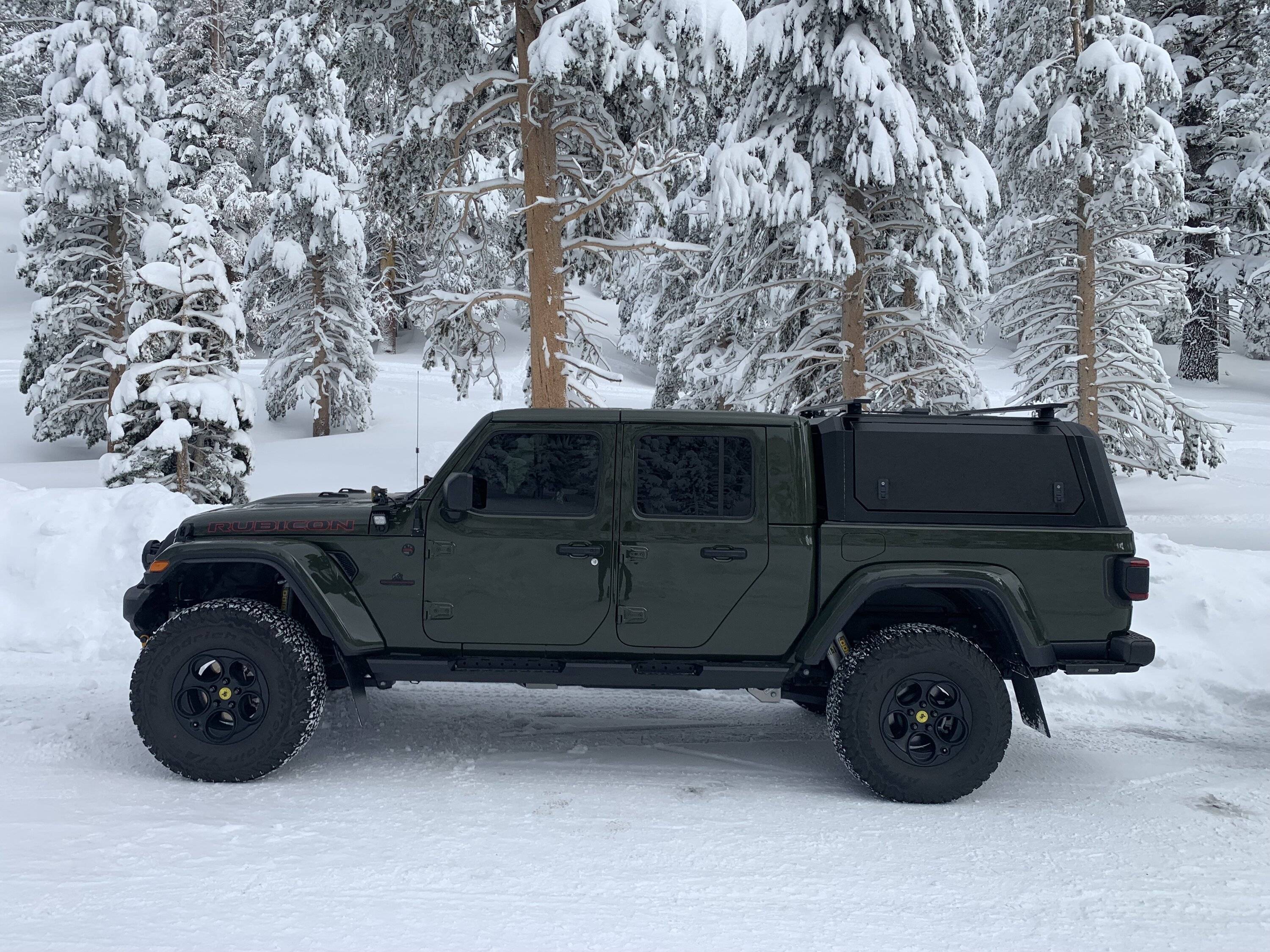

Here is my Sport S Diesel with the lift on 33’s. I think the picture does it justice, but I want to be clear I really don’t like how it looks with tires this small. My original plan was to keep these until the tread wore out. I’m throwing that plan out the window, I can’t take it anymore!
35’s would be good. And you wouldnt have to regear as with the 37’s
Yeah I couldn't take that either. Mines also got the Rubicon tires too. 35s it will have to be. Now that I've seen it. Ughh just empty every pocket at it again.

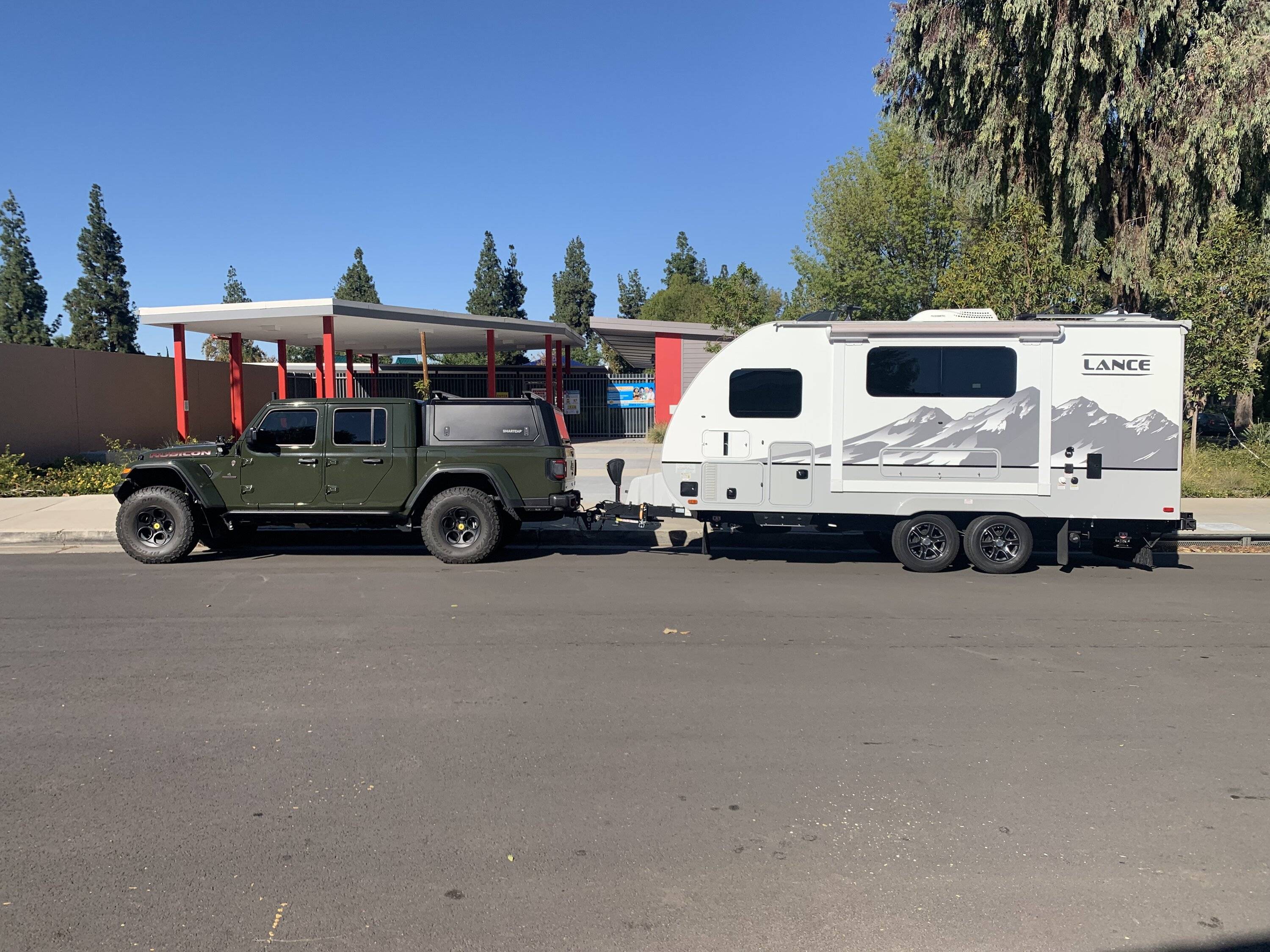

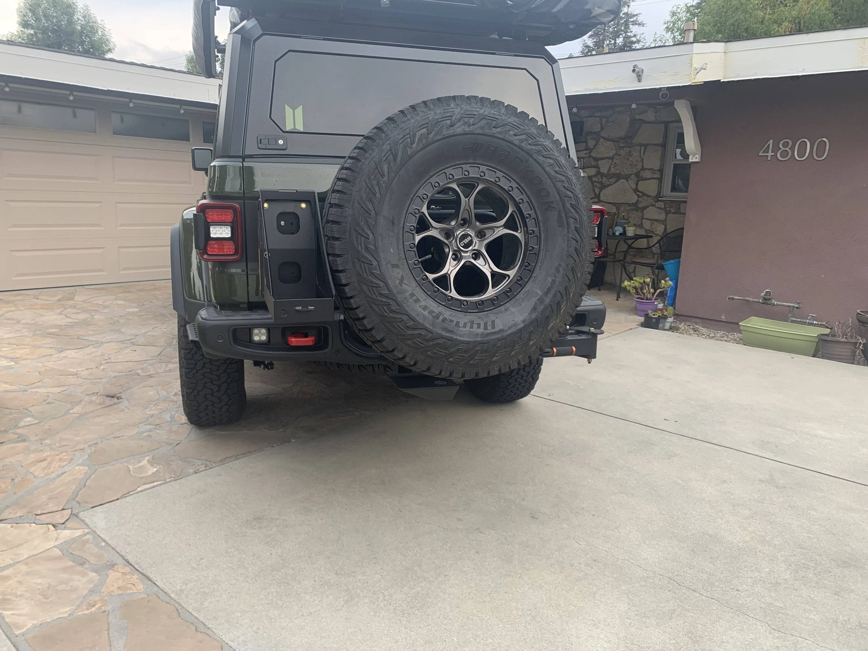

I have this same set up on my JT. Never drove it stock, but did go SD to HD on the springs. Ride is great. Gained 1/4" up front and a full 1.5" in the rear when I swapped springs. Backend is tall! Do some towing, shell and gear in the back plus a RTT at times.
Only issue I have run into that is my fault was putting the Metalcloak bump stops in the front. They are too long and bottomed out early. I cut off the first layer and it is a lot better. Probably cut off another 1/2" once I get a chance to measure and make sure nothing will hit with th shorter bump stop. The old ones were compressed into the center with barely any cushion. Should have just reset them and left it at that.
All and all a very nice ride even with the HD springs.

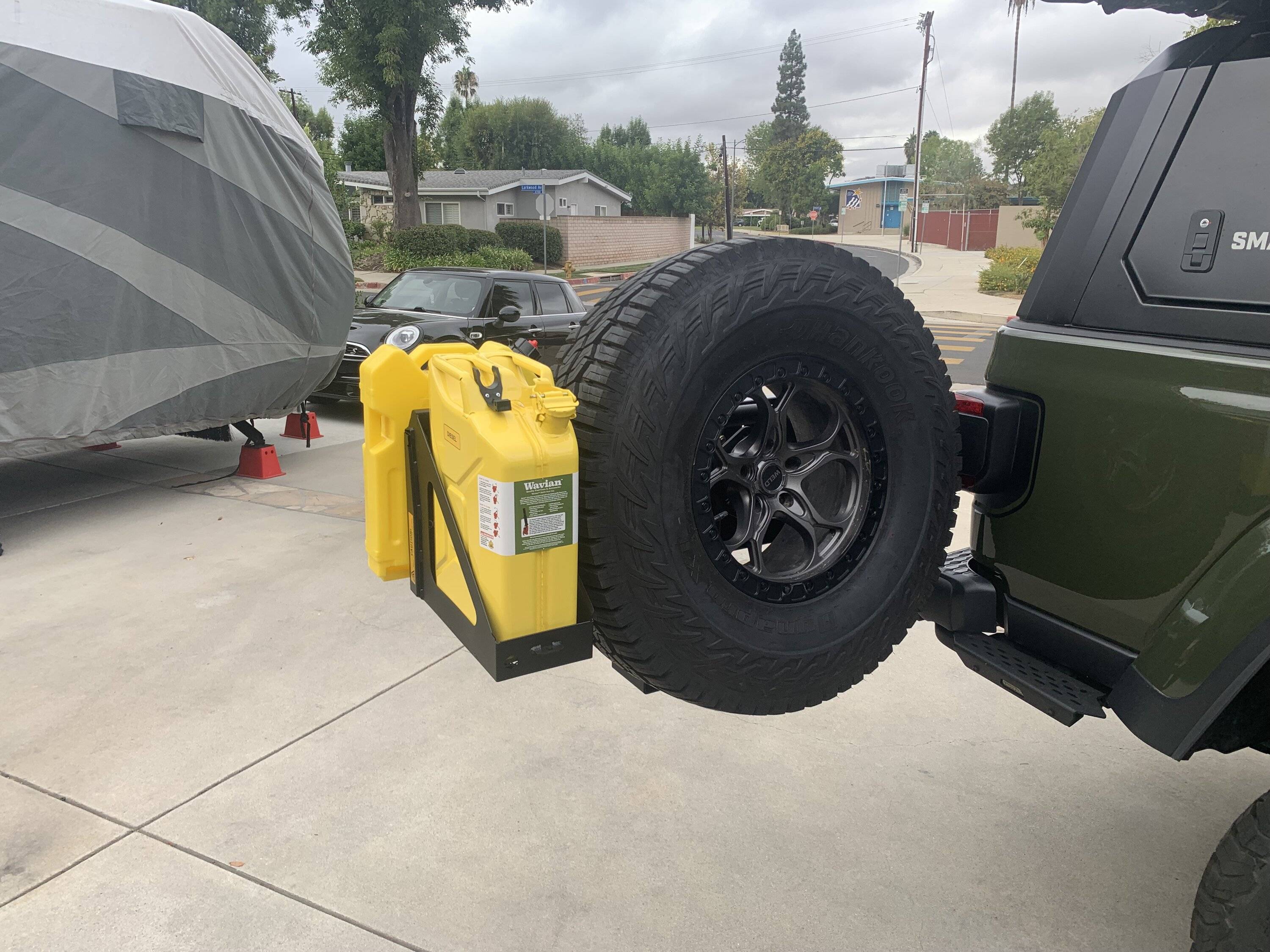

Not sure how much constant load I have in the truck. Will get it weighed again soon. Had to weigh it when it was delivered for registration so I can compare the numbers. But, shell, sliders, misc gear in the back, armor, etc its heavy. Here is a pic with the SD springs and our trailer. Tongue weight is over 500#s with a weight distribution hitch. It rode fine even when hitched up to the trailer. Not sure if HD springs are really necessary unless you are weighing it down.

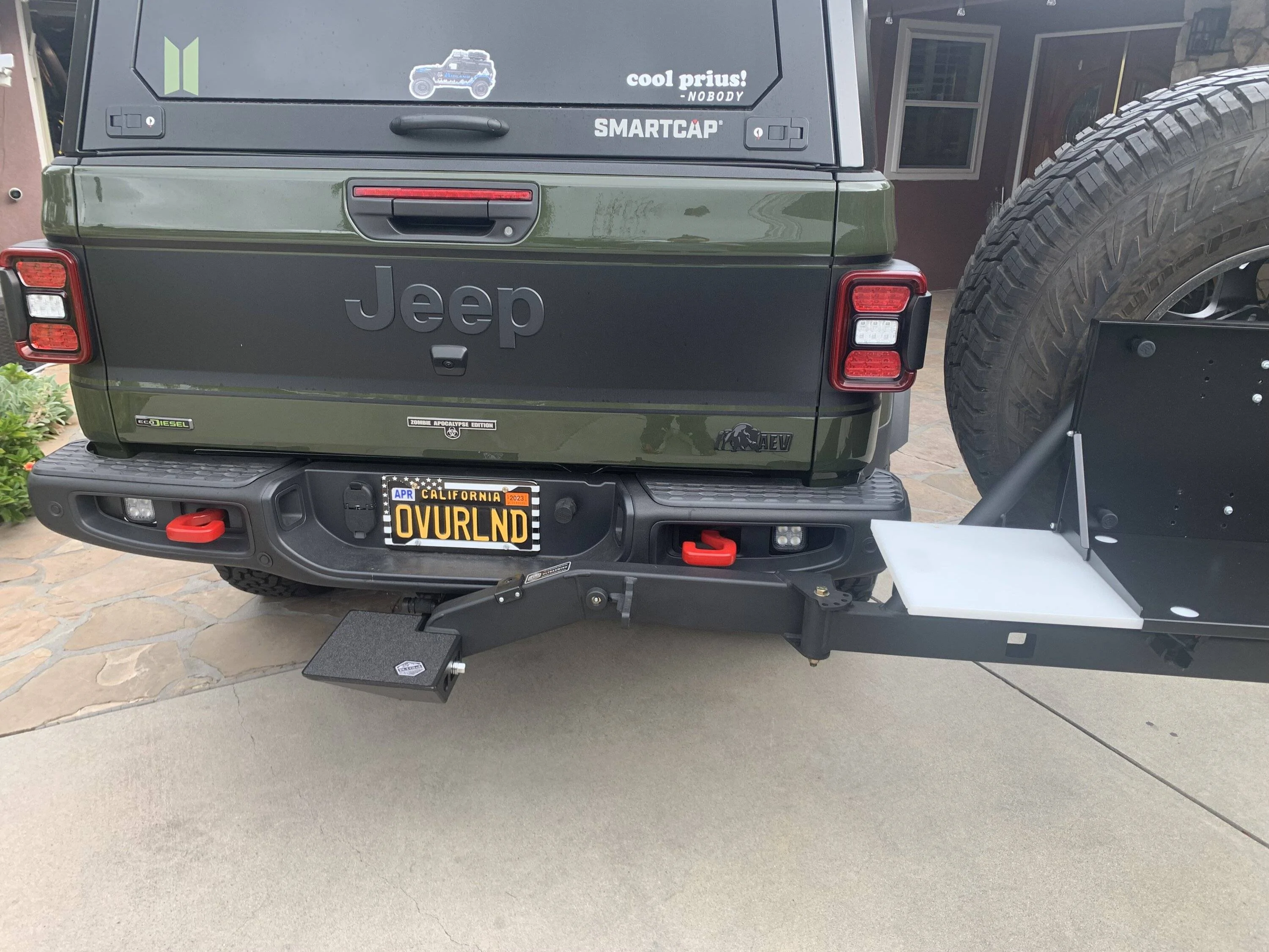

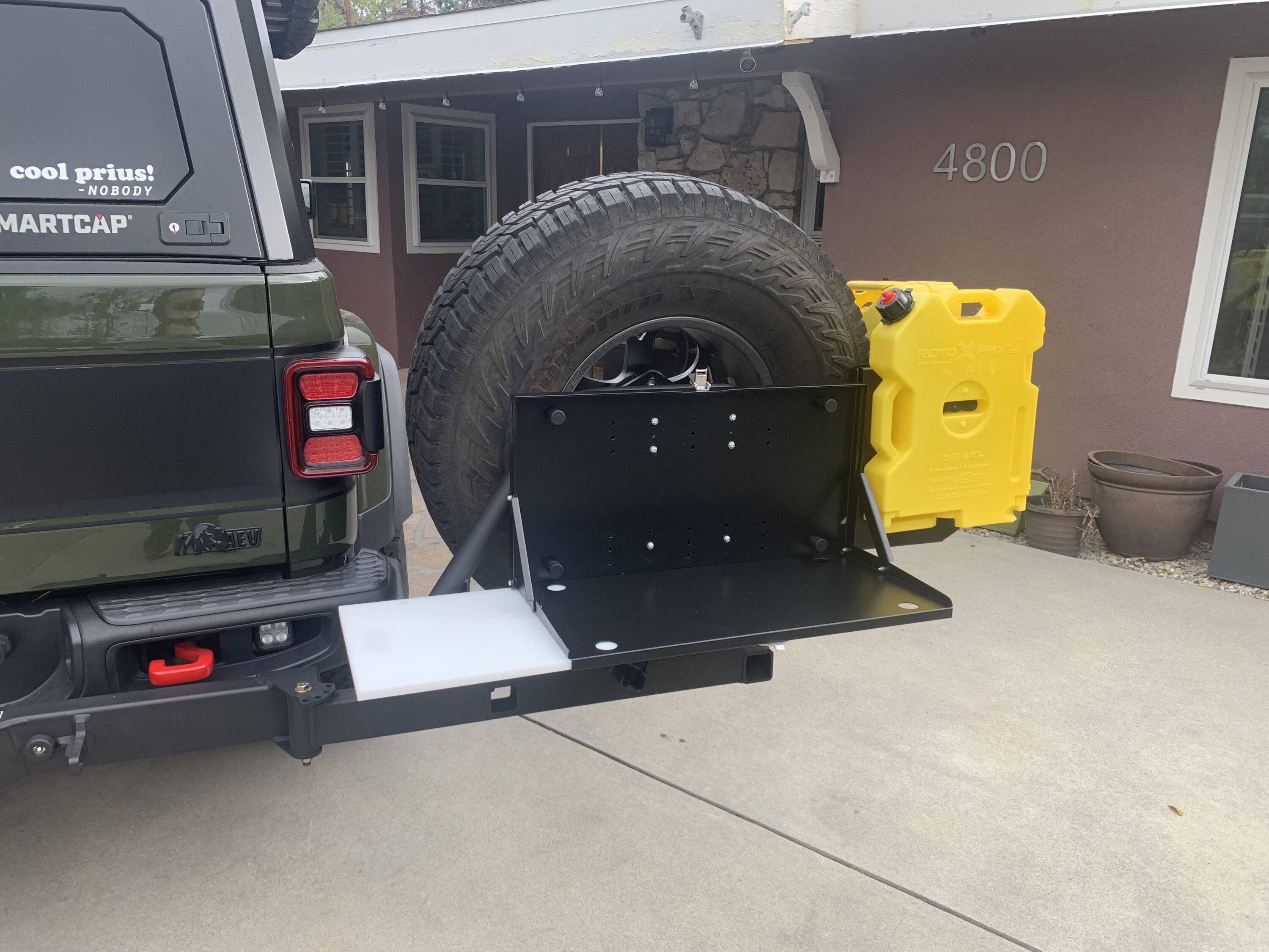

The only time the SD springs felt a little wonky is when I put on the Rigd Ultraswing, 37 spare, and all the swing accessories. That is a lot of weight hanging way out back. Haven't put it back on since the HD springs were added. Will get it mounted back up pretty soon for a couple trips and report back how it rides.
Got any pics with the ultraswing?

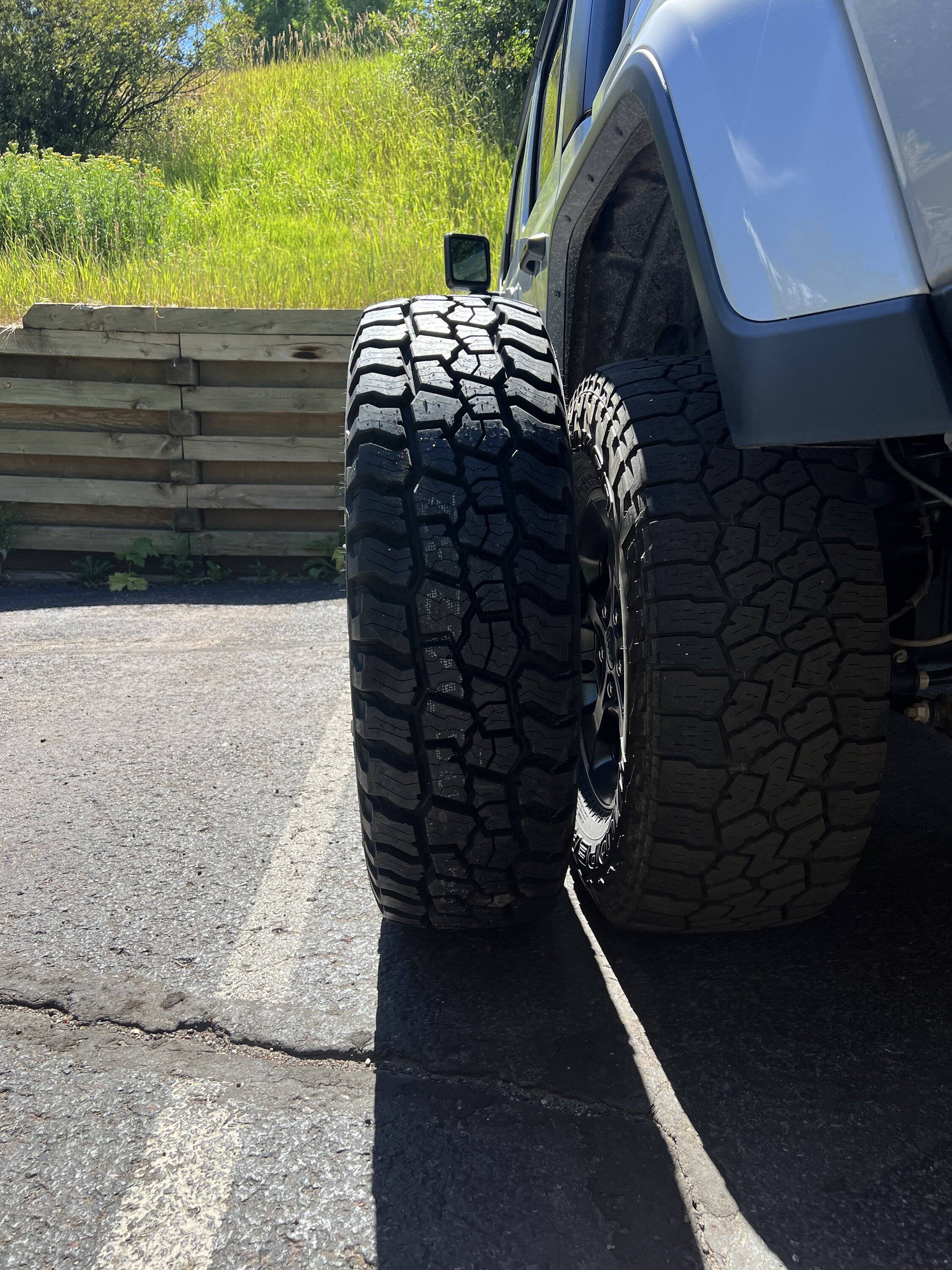

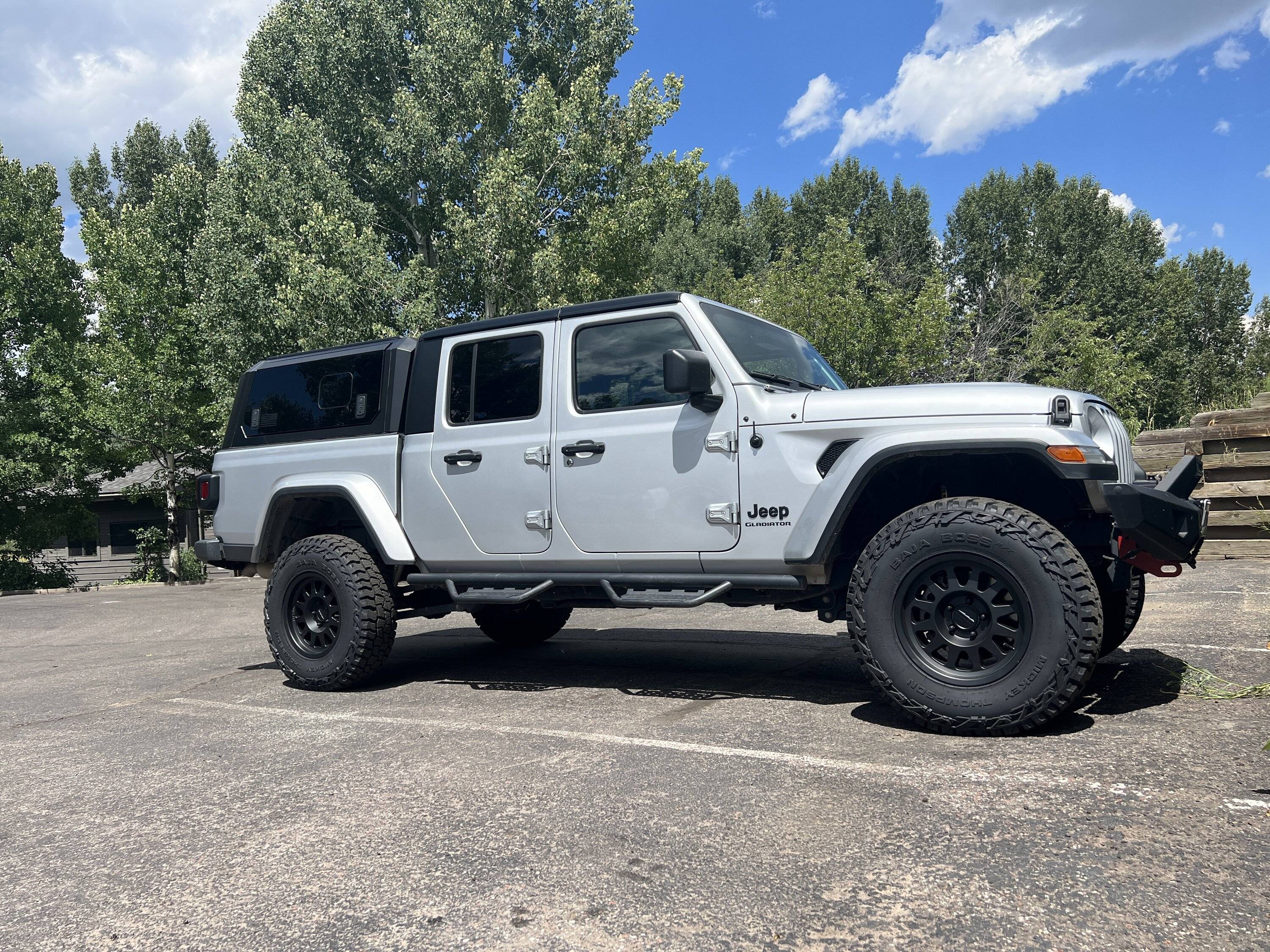

I finally got 35’s put on about a month ago. Couldn’t be happier. Went with the 35x10 essentially, (255-85 R17) Mickey Thompson Baja Boss A/T. Great on road and even better off road!
Jeep Gladiator AEV 2.5" DualSport on Rubicon Diesel IMG_2308
Jeep Gladiator AEV 2.5" DualSport on Rubicon Diesel IMG_2324
Jeep Gladiator AEV 2.5" DualSport on Rubicon Diesel IMG_2529
