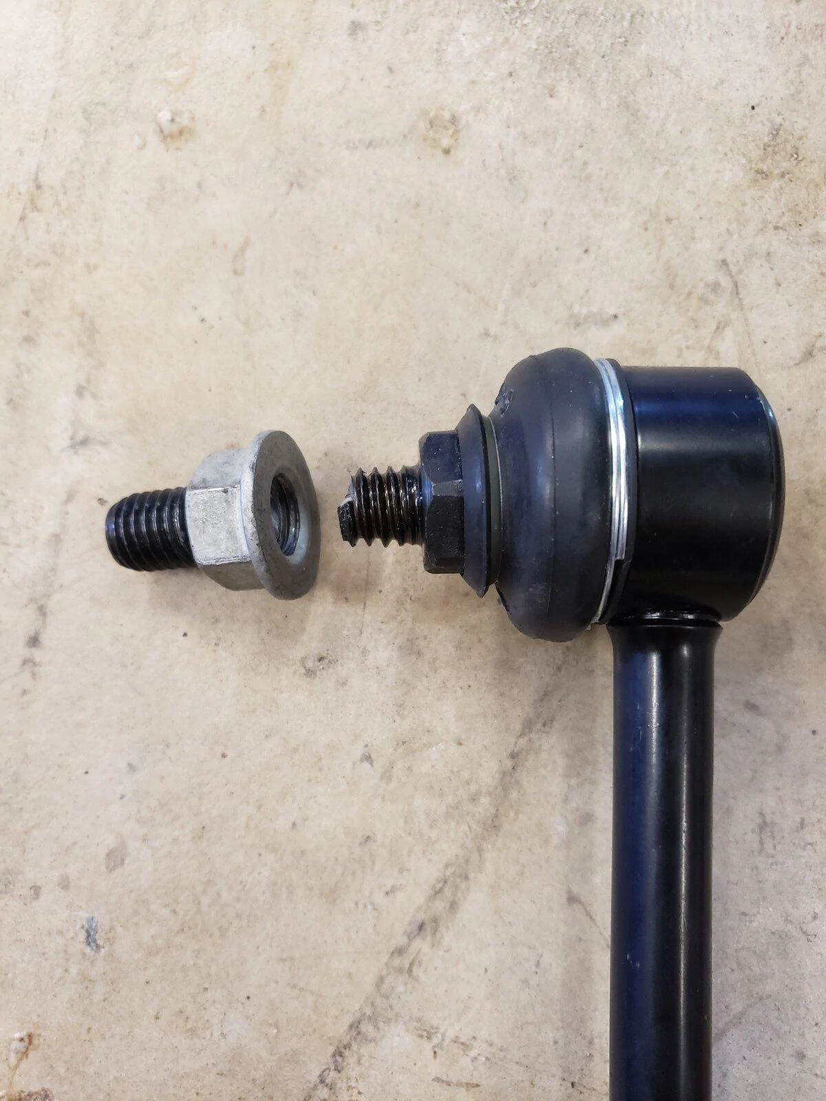

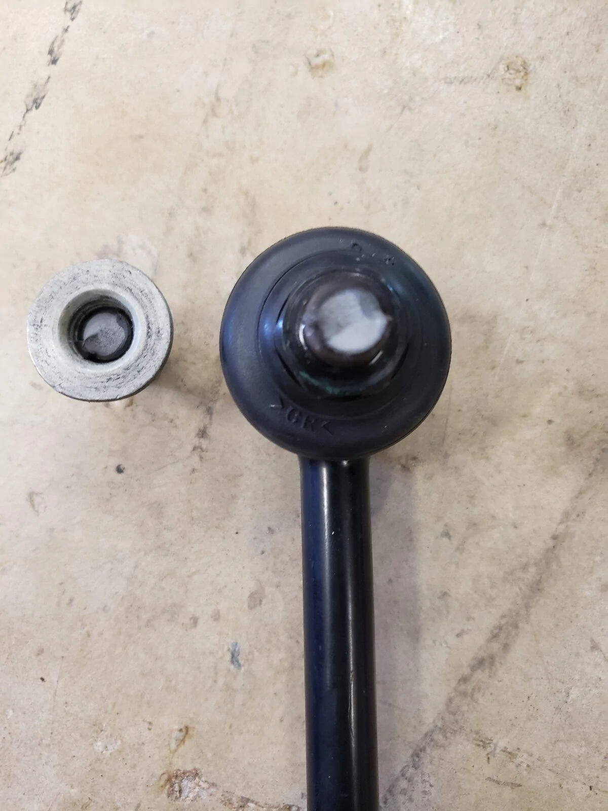

Got mine installed today. Took way too long (11 hours)! Ran into one issue...I sheard off one of the new rear swaybar end link bolts, see pic. So I had to reinstall the factory end links until I can get a new one.
Got dark so no after pics yet!
Got dark so now after pics yet!
The same thing happened to me during my install. Running on the stock rear sway links as well. Waiting on AEV to send out a new one. I called and sent them what they needed but still haven't seen the new link. Stock ones appear to be working just fine until then.
Whew, glad it wasn't just me! Just sent them the needed info.
