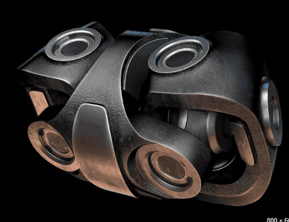

Which shaft is it?
Does it have a double-cardan joint on one end and a plain single cardan joint on the other end?
If so, you must run the end with the single cross or single cardan joint as straight as possible. You can't have any real angle on it.
In other words - if that shaft has one of these -
Jeep Gladiator Aftermarket front driveshaft noise 1714748852811-pa
That end must be run as straight as possible.
If there's a double-cardan joint at both ends, it shouldn't be a problem but they are still somewhat limited in angle.
These - a double-cardan - can be run with a fair angle, but not as much as a true CV -
Jeep Gladiator Aftermarket front driveshaft noise 1714748978842-qj
