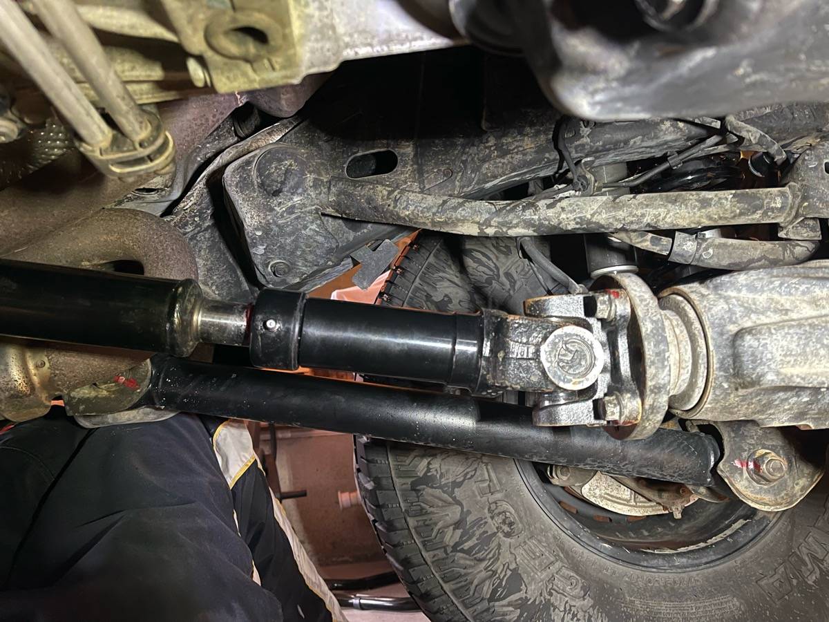

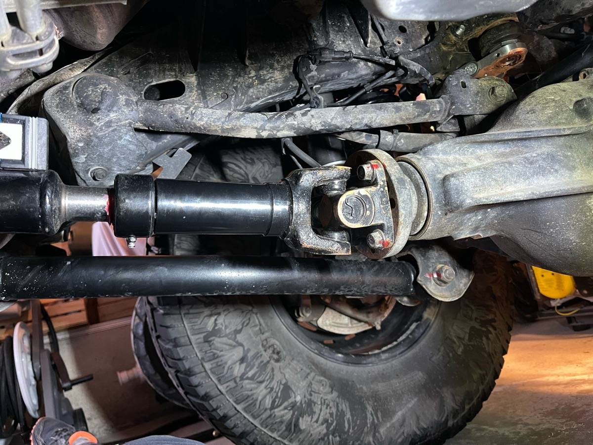

I've checked all the bolt torques and confirmed the driveshaft doesn't wiggle or feel loose when turning by hand. All the u-joints seem good, but I'm wondering if the angle is too much for them and if that might be causing the noise?
Assuming you have a double cardan at the transfer case, my understanding of these configurations is that the pinion angle needs to be straight or no more than 1-2* off center to the driveshaft. And therein lies the issue: how can you get it straight without drastically changing the caster.
I'm wondering if this is getting into custom territory where the spring seat needs to be cut off and re-centered back onto the axle.
Without a corresponding joint in phase sitting at an equal but opposite number of degrees, that's a problem for a single cross type joint.
Yes. It's really a dumb design, sorry, it just is. You can't run over a degree or so of angle on a single joint.

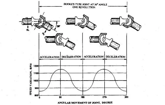

Here's the reason for that -
Jeep Gladiator Aftermarket front driveshaft noise ujoint-image0023
There's an RPM change for each partial rotation. If you don't counter that on the other end, then you will have stresses and vibrations as the shaft keeps changing speed - and whatever is connected to it tries to as well.

Here is what happens -
When the cross or cardan type joint is at an angle, there is a cyclic RPM change of the shaft on the other side of the joint.
The RPM change increases with the amount of angle on the joint.
So if the output shaft of a transmission or transfer case is spinning 1000 RPM just for an example, the shaft on the other side of the joint spins anywhere from 850 to 1150 RPM, like the chart shows.
So the shaft speeds up and slows down, speeds up and slows down, as that single joint turns at an angle - the more angle, the more RPM change there is.
To cancel that, you put a single joint on the other end running the same angle to the negative and that cancels the RPM change perfectly so that although the shaft between the joint changes RPM, the transmission output and the differential pinion spin at a constant RPM.
With just ONE such joint, you have the driven item trying to change speed up and down, up and down.
the double-cardan joint takes care of that because it's two joints in one - only the piece between the two joints changes RPM.
