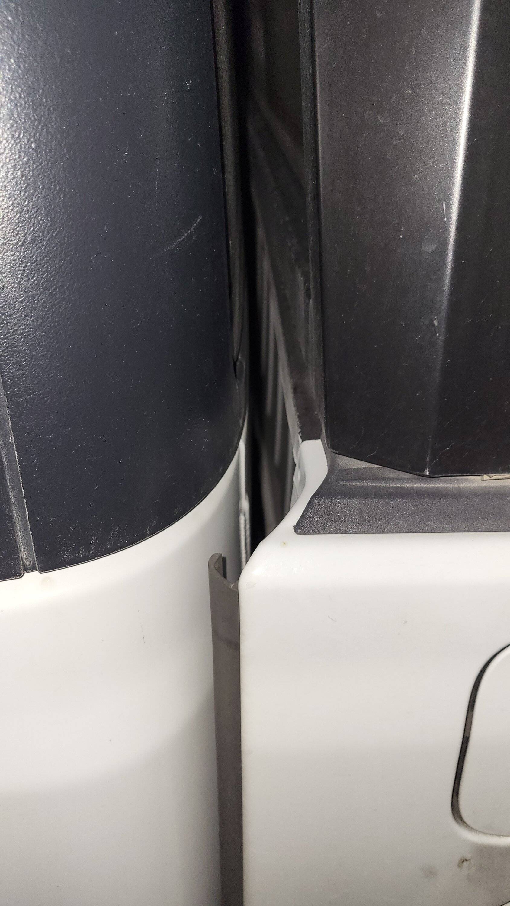

If it helps any, this is how my RSI Smartcap sat on my 2020 Overland. You should be able to loosen the clamps and move it forward. It should not need much, maybe an 1/8 or 1/4 of an inch.

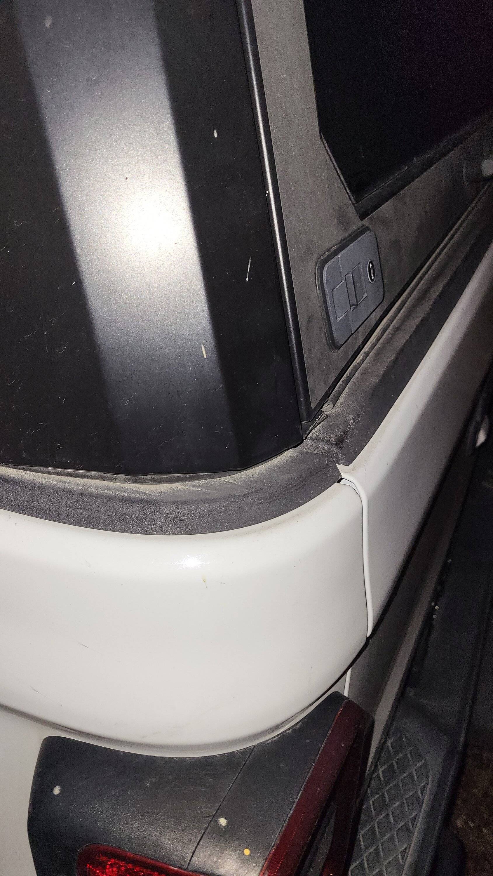

If thats an RSI Smart cap, they used the wrong gasket when then installed your topper. The gasket at least on mine gaps it about maybe 3/8 to a 1/2 inch, which allows the back to open. Forgot to mention that RSI also supplies this square hocky pucks as spacers between the bed rails and the cap to properly space it. Doesn't look like your cap has it.

Mr Bill, thanks for your suggestion to move the topper forward.
I had about 1/2” adjustment play. Unfortunately it made no difference. The rear wall of the topper is very close, to if not vertical, so that 1/2“ didn’t make any difference in the arc swing.
It was worth a try! :)
I'm not sure about the design of what you have installed. Another possibility is some foam blocks under the rear corners to raise it up just a bit (or minimize lowering from clamp compression).

It depends on the design. The Smartcap has a flat bottom with a weather seal around the outer edge. Foam blocks had to be placed in the rear corners, between the inside edge and the outer seal. This minimized compression when the clamps were tightened to keep the rear hatch from being pushed downward into the tailgate.

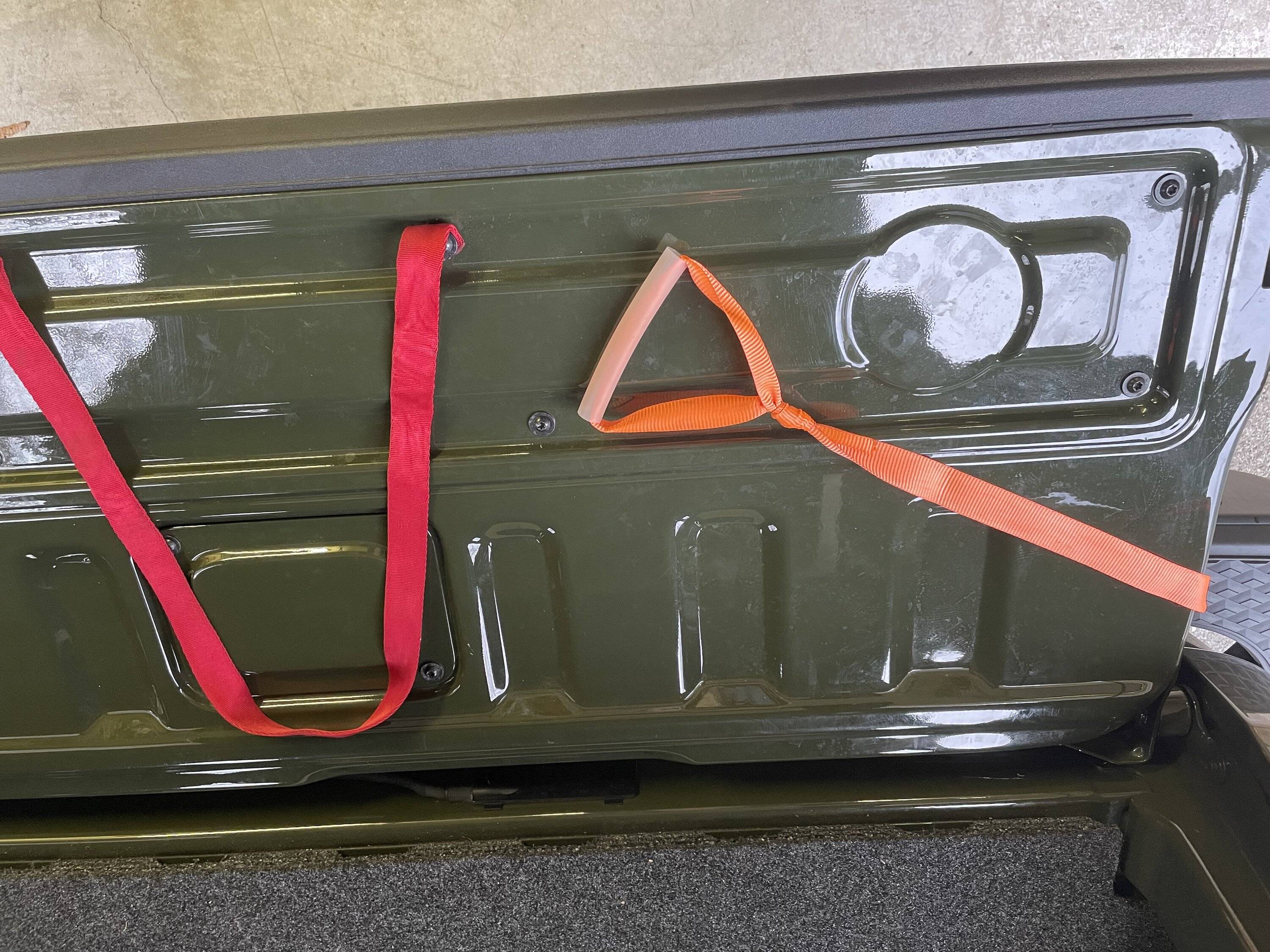

Getting back to the original theme of this thread, last night I buttoned up an idea I’ve had since before taking delivery. That is an inside tailgate latch release. It’s the orange strap with the handle. The red is to aid in closing the tailgate. Now that it works, the tailgate cap issue takes a much lower priority. Time will tell, but I kind of like the idea that the hatch won’t easily open without the tailgate opening, which locks with the cab doors.
I’m going to make another thread with how I did it. Pretty simple, really.
