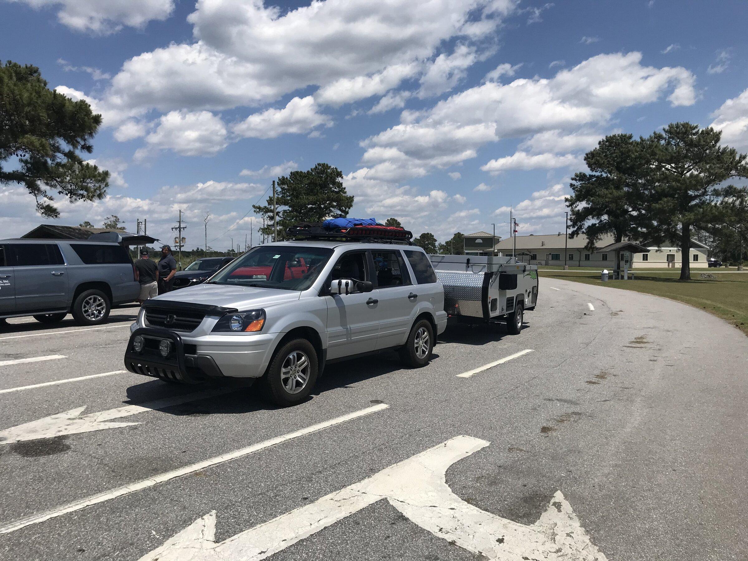

For now Im towing an Aliner LXE (A frame hard walled pop up) the weighs 2,500 loaded (has a GVWR of 3,000lbs but the axle is rated for 3,500lbs - go figure). I’ve been towing this camper and our previous standard pop up camper with a 2004 Honda Pilot, it’s done a great job. These Pilots were known to have weak transmissions and died prematurely due to overheated. From day one, I ditched the puny Honda transmission cooler and went with a robust Hayden cooler with low temp bypass. I now have 202k miles on the Pilot, with the original transmission and it runs beautifully.
