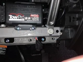

Jeep Gladiator Aftermarket Trailer Brakes? IMG_1939
Went with 2 self tapping screws. It's a little tight, but it works. You need to mount it high on the cross member, otherwise the cables won't fit.

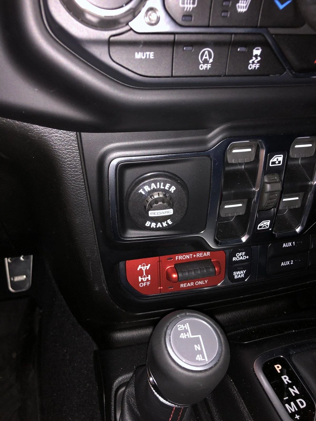

How well does that trim piece fit? e trailer sent me the smaller rectangle one and it doesn't cover the stock hole.
The round one fits really well. Once you remove the lighter socket, it will snap right in. I did need to make a small notch to let the alignment tab go in, but it’d covered completely. I would image the square one does not work at all. Here’s mine when I was all done.

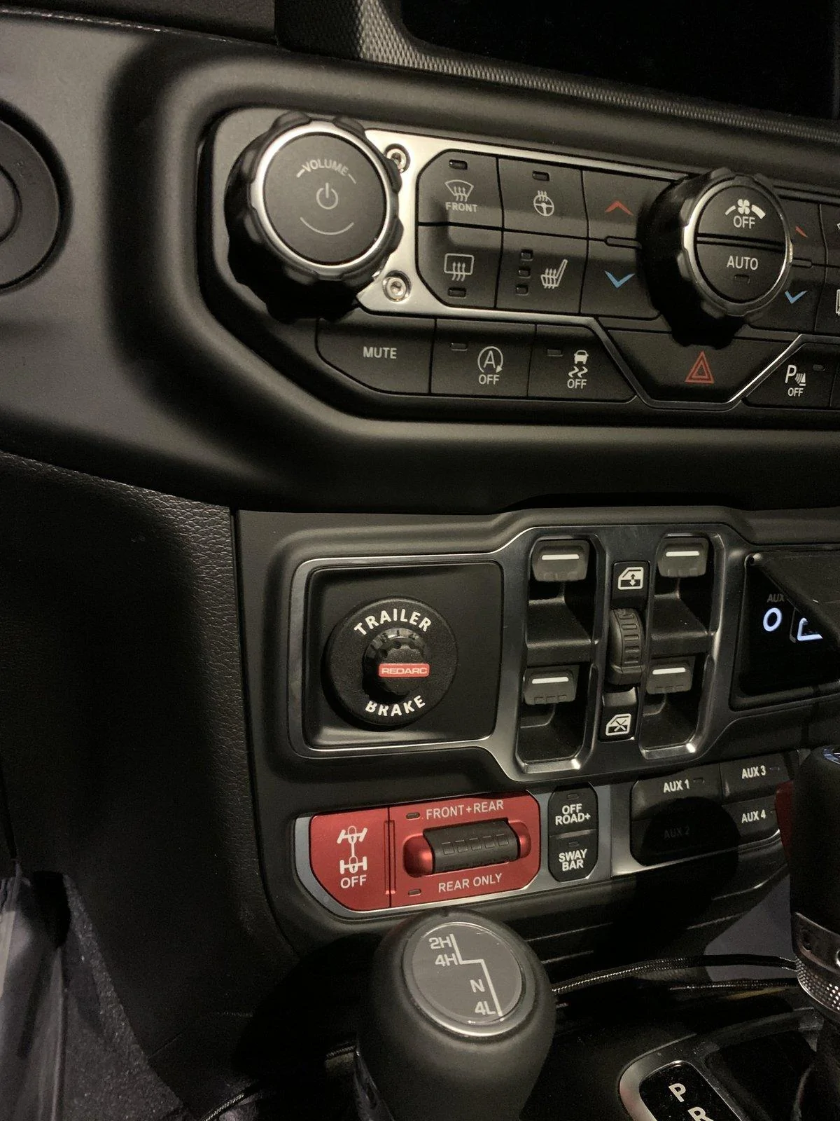

Installed mine today. I cut the tab off the bezel with an exact knife. And I used the cig lighter removal tool from Amazon. Smooth install. Lots of great info on the forum. Thanks to everyone for your posts.
Awesome, looks great. Glad to hear my testing of the tool prior to recommending was not in vain.
