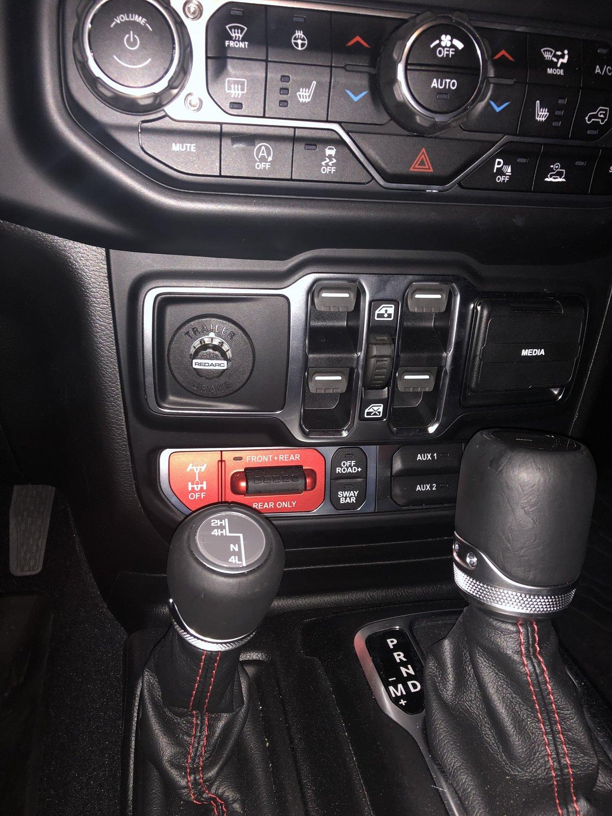

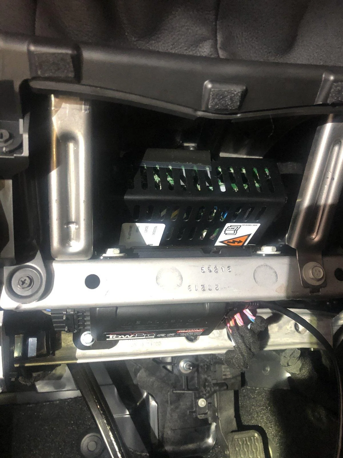

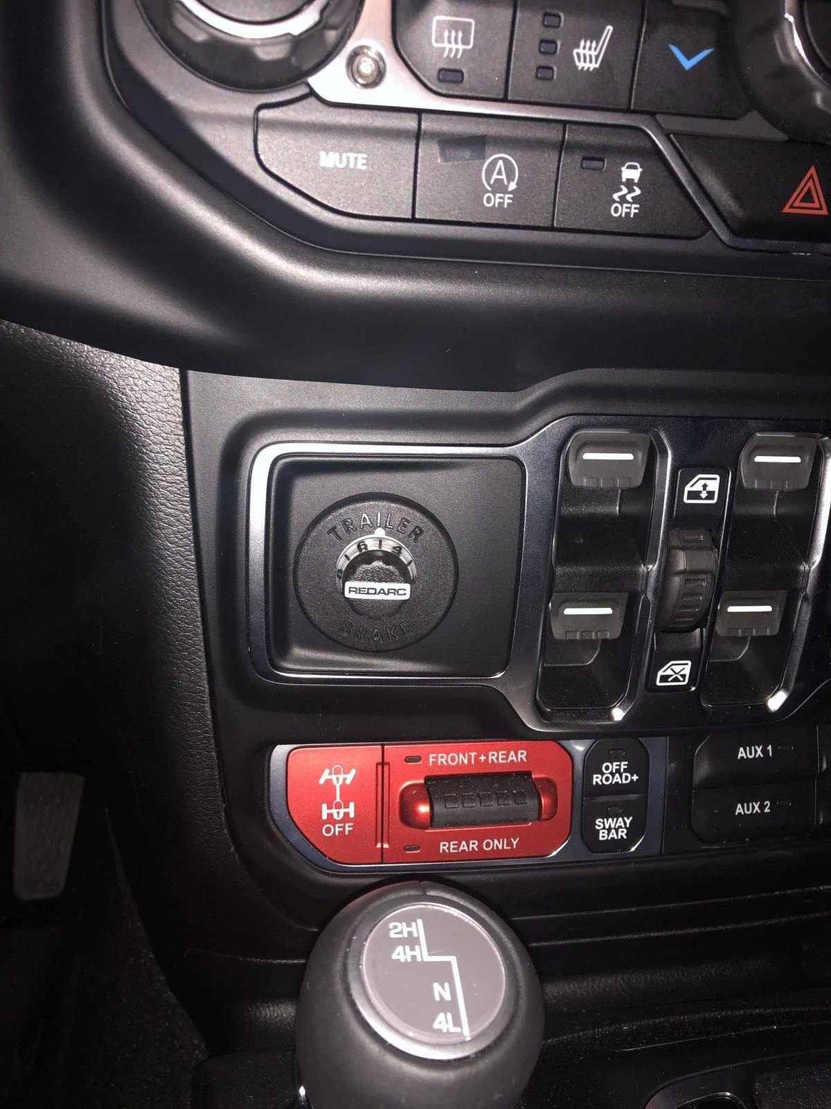

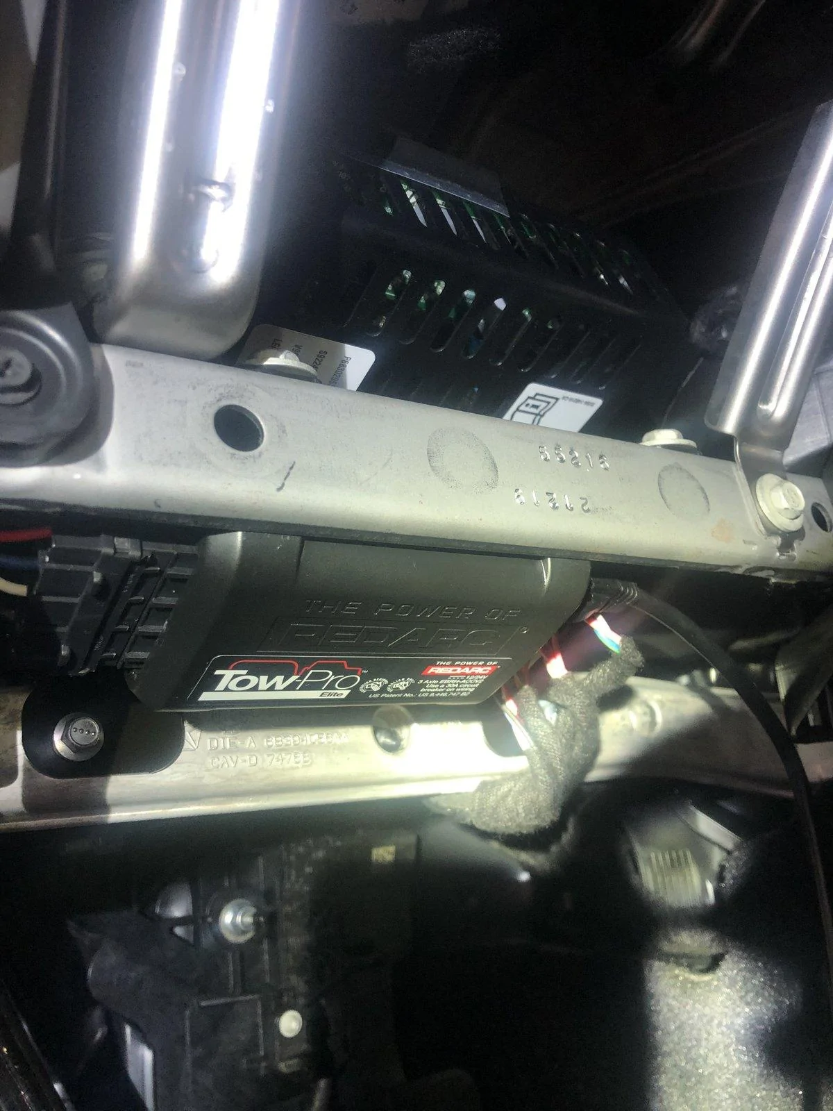

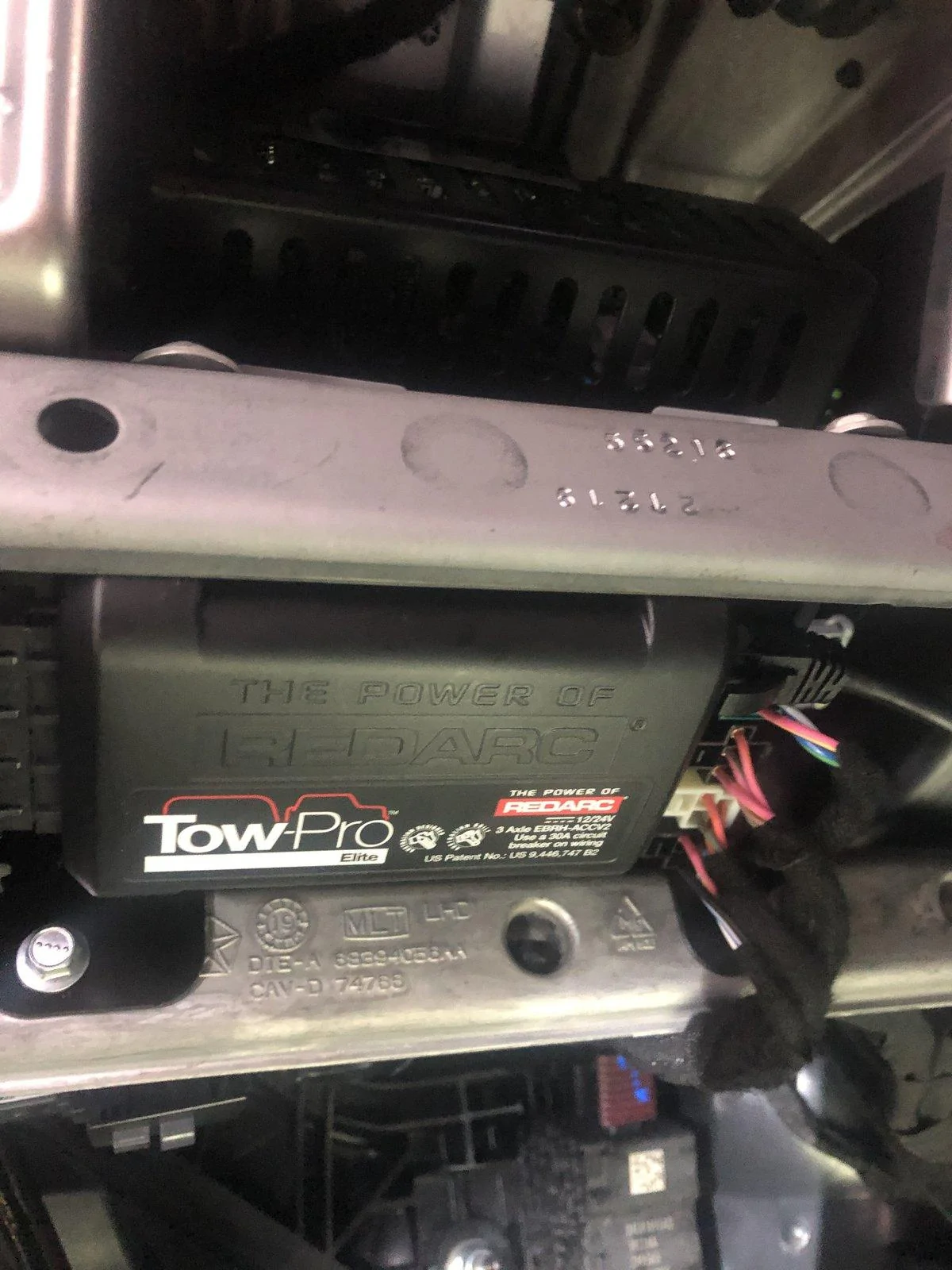

Got my Redarc installed today. Man that 12v plug was a MF’er to get out. I ended up breaking it apart piece by piece to get it out, after screwing with it for two hours. I must admit there was some slight joy in breaking it apart after all that. Anyway, it’s all done. Thought I’d post a pic of how I mounted the main unit. Double sided Gorilla tape to secure it to the box below the sterring column like Nordnded recommended. It’s locked solidly in place with no movement at all and didn’t have to drill or modify the cover.

I learned about it after I fought mine to get it out. I used a knife cut it apart too.
Now we need pictures of the knob, it’s a right of passage for those of us who have done it like @KVJ and myself.
