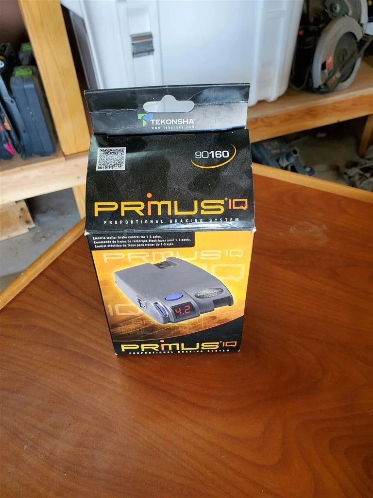

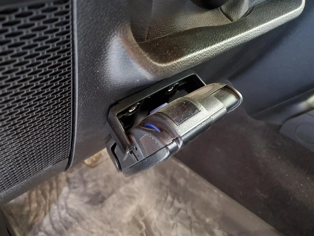

My plan was/is to get a Curt or Mopar brake controller. All of a sudden I needed a controller quick to pick up a newly purchased pop-up camper out of state. The dealer would not let me drive away if I didn't have a controller and they were sure willing to sell me one.
I had this Tekonsha Primus IQ sitting in the garage that I had on a Nissan Frontier years ago so I decided to use it temporarily so I could get the trailer. I bought a Tekonsha adapter cable for the Jeep JL/JT and mounted the controller under the dash. The controller worked great for the 1500 mile road trip. Surprisingly I had no problems hitting it with my knees. I hated drilling the mount holes in the panel but figured I can plug them later with a little JB Weld.
Anyway, easy and worked great. I'll make it go away eventually.

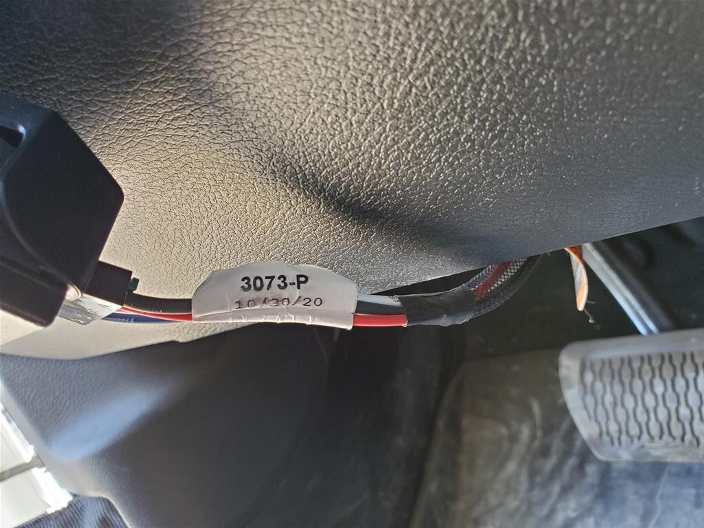

Would you mind telling me where you got the wire harness for this. I have a Gladiator on order and I am going to using the same controller that you have. Just need the harness.
250
40,596
54,277
From the people who make the brake controller. Tekonsha. The companies that make the controllers have harnesses unique to their own controllers. They make the harnesses to connect their controller to vehicles.
Buy a harness for a Redarc controller from Redarc, for a Tekonsha from Tekonsha and so on.
I can't remember where I bought mine but Amazon has them listed. Tekonsha PN 3073-P. Worked great. Plugs into the harness just above the driver's side kick panel.
