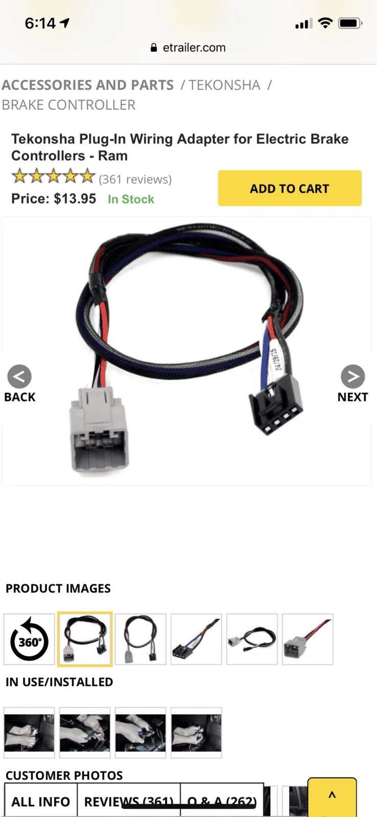

Is this the wiring harness your taking about?
Is this the 3045-P harness? Waiting on my JT, but have a Takonsha in my '08 wrangler. Had to direct connect that to the wiring harness.

So we want the wiring connector harness for a 2017 Ram 1500? Good info. Thanks.
NO - get the Jeep harness connector. The Ram connector has two wires flipped and does not work without swapping the wires (or mismatching the wire colors to the brake controller). I'm running the Tekonsha 3014-P harness linked here: https://www.amazon.com/gp/product/B00QRWR1YI
With a Hopkins agility controller without issue. Anybody telling you the 3014-P harness doesn't work is giving you bad information or did not wire it to the brake controller correctly.
You are correct that the 3014p harness is the right adapter for the vehicle side but it only works with a Tekonsha controller if plug and play is what youre after. For the Redarc controller I used their adapter for the Ram truck as they dont have a Jeep specific one and had to reverse the two wires you mentioned for it to work properly. It was a 2 min fix vs cutting and splicing.
The the redarc has a universal adapter that you just push the wires in I think, though you still have to cut and strip them, but yeah I thought you were talking about the tekonsha harness.
Can you remember which two wires needed switched. I'm installed but not working.
