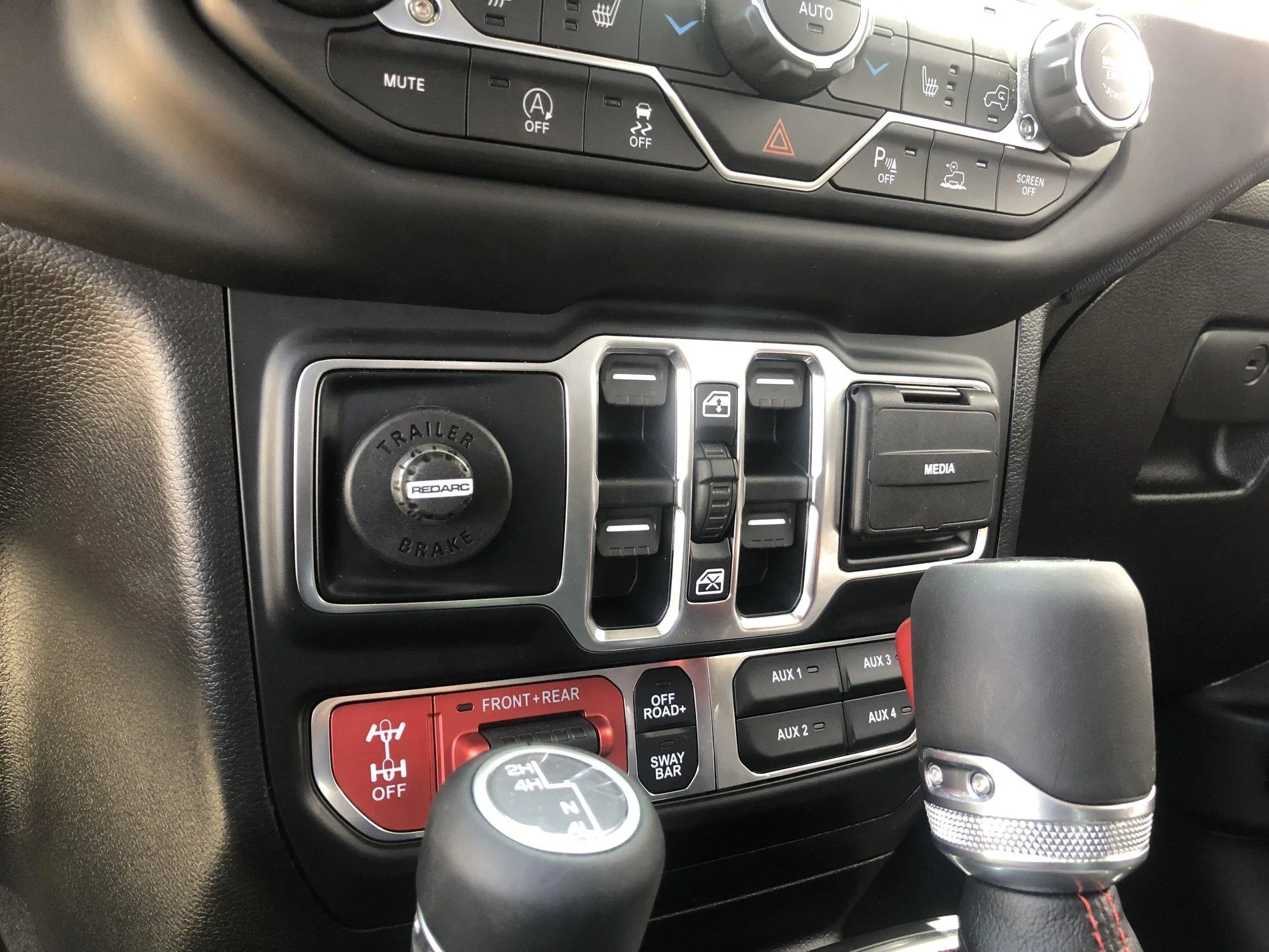

Redarc controller is done and installed in place of the 12v dash outlet. I will try to do a write up sometime soon in case anyone else decides to go this route.
Yes excellent install and share as much info on the details and pics if possible. And did you end up using the Colorado dash piece and or your friend make it with his 3-D printer?

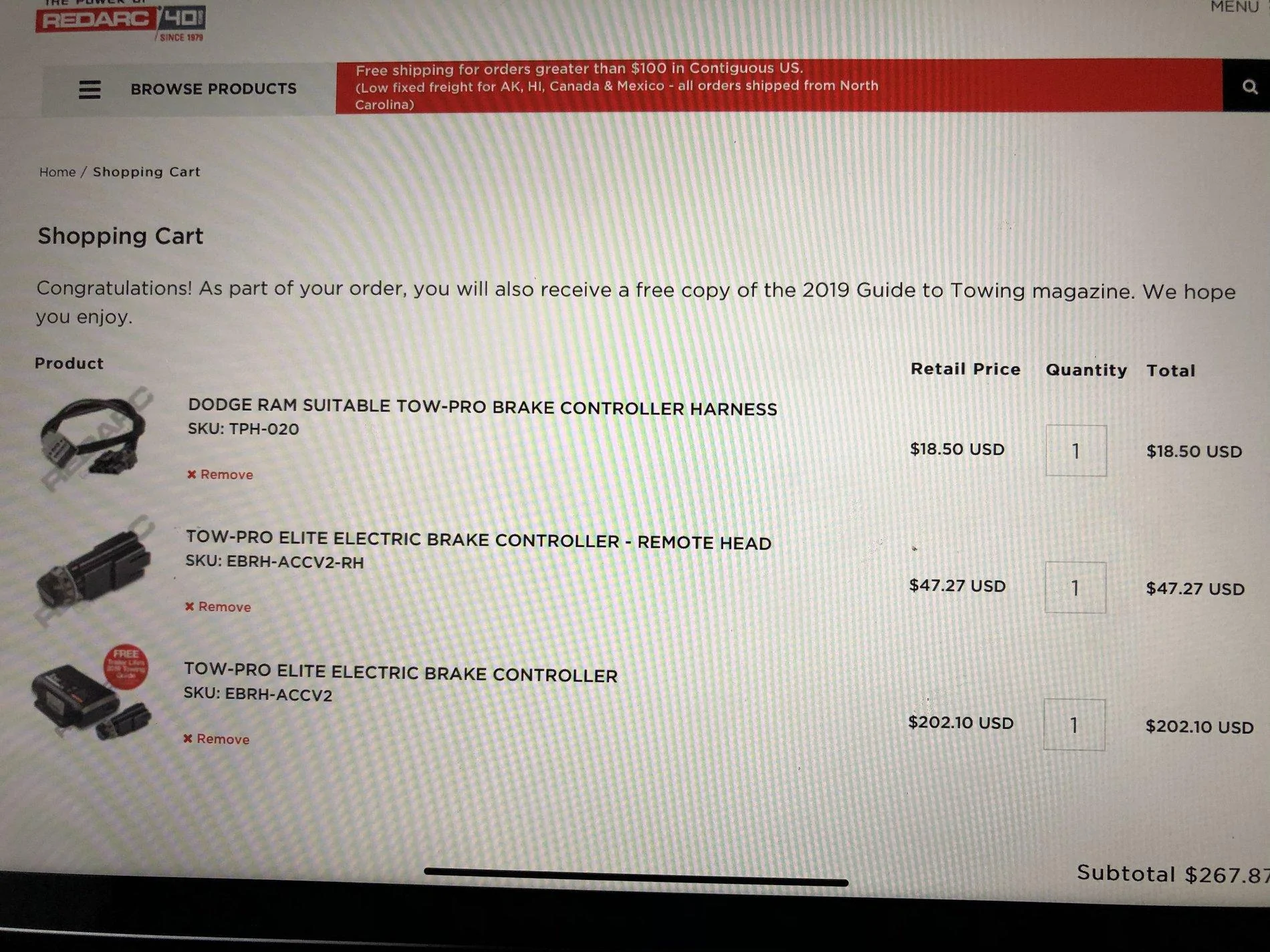

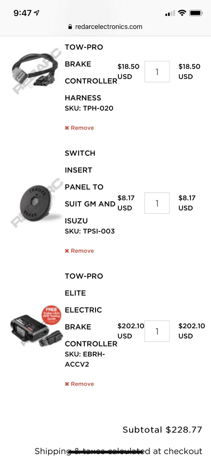

Is this the correct order?
Mostly yes, but you do not need the extra remote head for $47, it comes with the kit. The harness is correct. For the panel, order the one for the Chevy colorado as it fits perfectly but does require a very minor mod to the dash panel but it is not obvious as its covered up even if you go back to the stock 12v outlet.

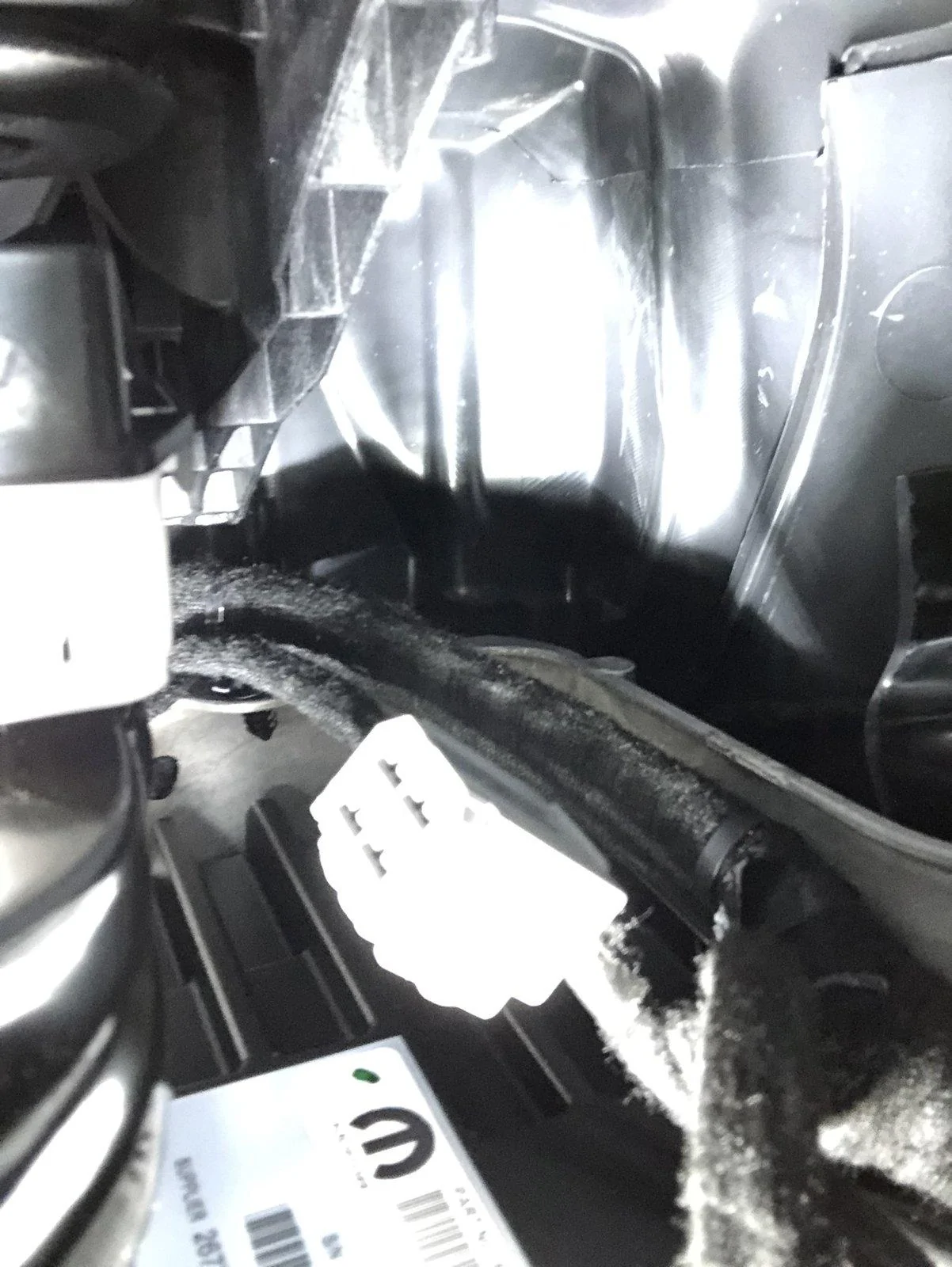

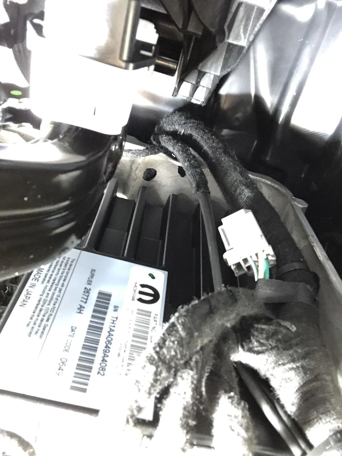

Thanks for the pictures of the connector under the dash. Every dealer I have asked about this is completely CLUELESS!!! It's one of the things that's been holding me back from buying/ordering mine.
RedTRex
Rick
Aug 25, 2017
1,973
1,449
Jacksonville, FL
2013 JKU / 2014 WK2 Diesel
Of course they are clueless....

So we want the wiring connector harness for a 2017 Ram 1500? Good info. Thanks.
