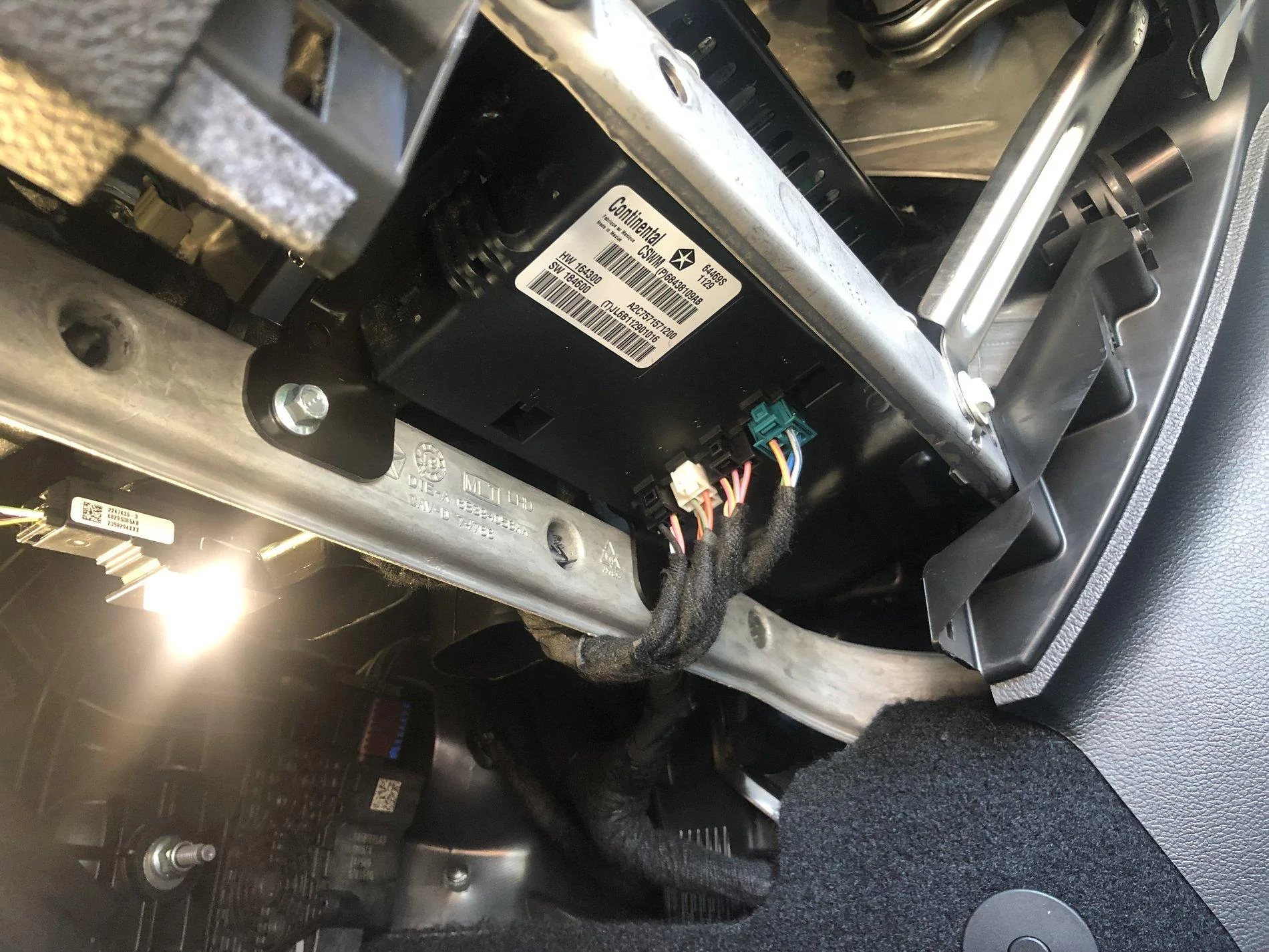

    Has anyone confirmed if the Mopar brake controller will be able to be retrofitted to any JT or will it have to be ordered on the truck from the factory?

    So you are disqualifying what is arguably the best brake controller on the market because of a two minute pull out two wires from the adapter harness and reinsert. A monkey can do that swap. All it takes is a small screw driver or a pick to get it out of the harness? Confused look...

    Yep, that's exactly what I'm doing. If it's the best brake controller on the market, why is it that nobody even heard of the brand until one person in this forum bought one, AND, why is it that they're the only one that doesn't have a PNP harness?
    It's like somebody said in another brake controller thread, this isn't 1990. It's just based on principle now. These things shouldn't require being MacGyverized to work. And my prior experience has been that changing terminals in these harnesses isn't always simple. In theory it should be, but it doesn't always go that way.

    What wires do you need to flip flop? I bought the RAM harness based on another thread and missed this.

    Nevermind i got it

    Sorry just now saw this. I haven’t installed it yet myself. Just from what others have said. Could you please share the wire that where needed to be changed over?

    On the tekonsha 3021-p (Dodge Ram harness) you need to switch the black and blue wires.

    Just another confirmation vote for the Tekonsha P3 being plug and play with the 3014-P wiring harness. I plan to do the bolt and wing nut plan to mount it to the bottom of the kick plate like the video of the JL Wrangler I saw linked on here.
