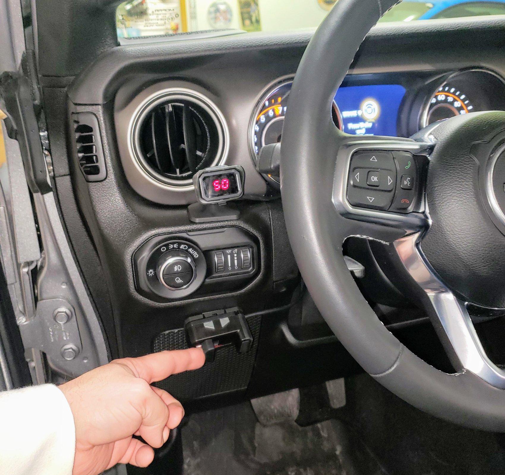

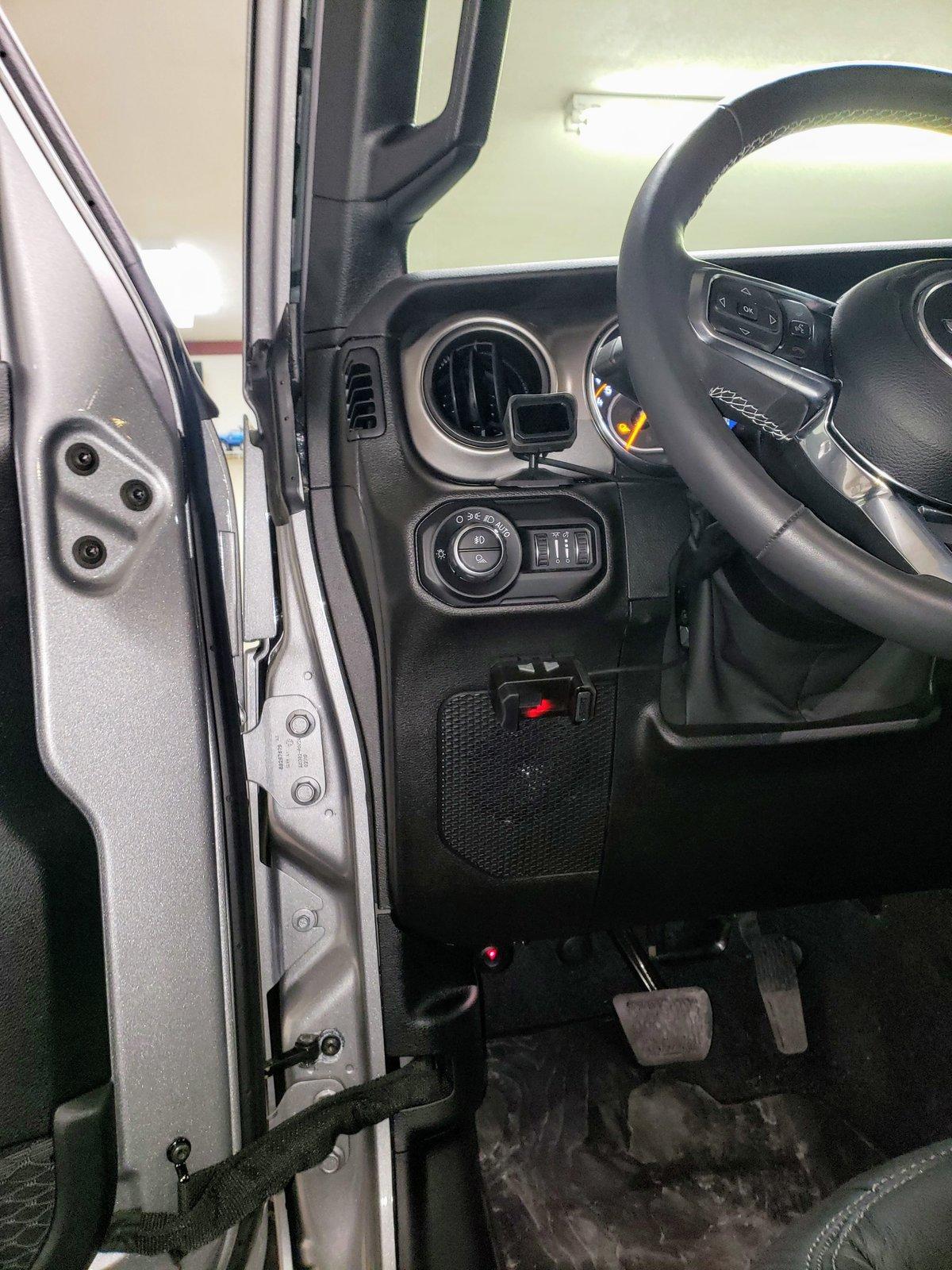

I use my trailer quite a bit, and really could not wait for a brake controller. I have had good luck with the Hopkins Insight Controller. I was able to put heat shrink spade terminals on the Harness that came in the box, and plug it directly into the factory connector. I put a piece of heatshrink over the whole thing. Works great! Has multiple brake curves and power settings. My trailer slows down nice and easy. The display works nicely, and the brake lights come on with the controller. Maybe my imagination, but I thought I felt the ABS shuttle the rear brakes once when I had to watch out for a "good" driver.
