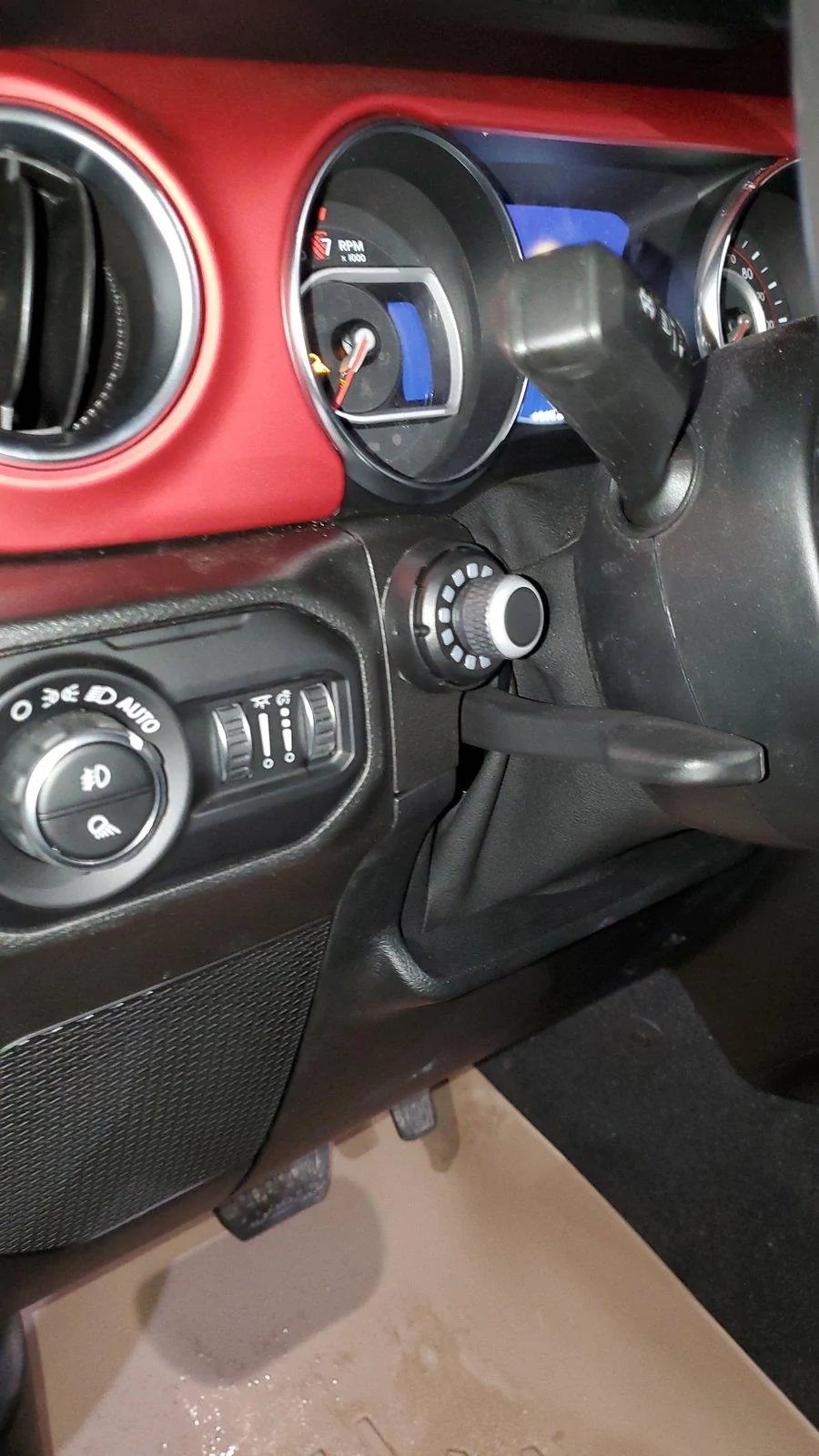

Get the curt brake controller, ram wiring harness, switch the black and blue and make it look almost dactory without waiting.
Do how did you get it up in there? I kind of like this location the most.
If you look closely you can see the cable near the column adjuster, I just ran it into the column fabric area and down to the controller. really easy to run and mount the dial.

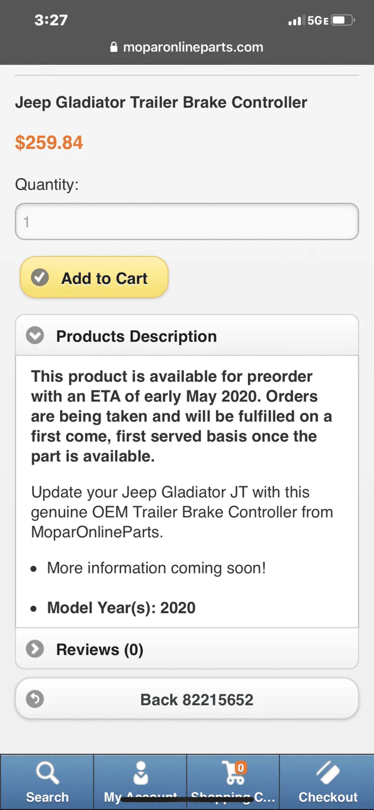

For what it's worth, it still isn't showing up as coming with any of the trims/packages on the build site nor can you option it.

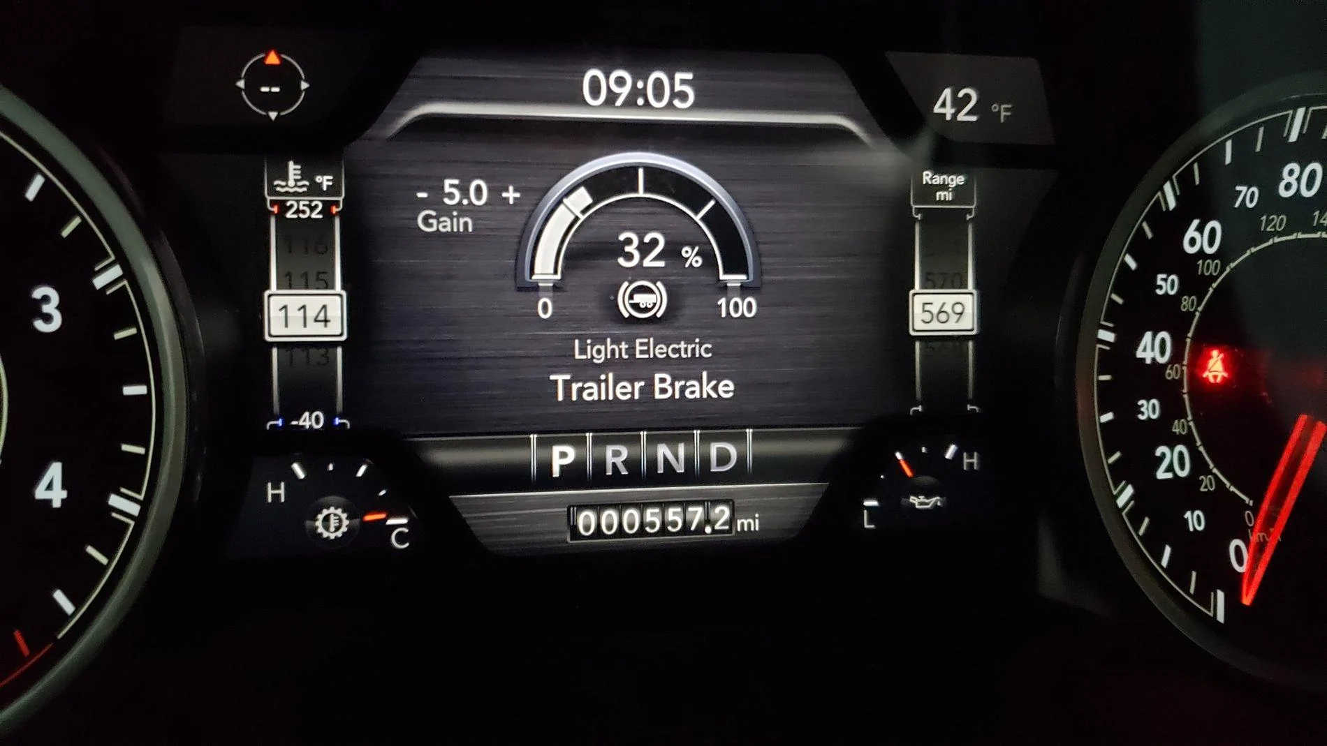

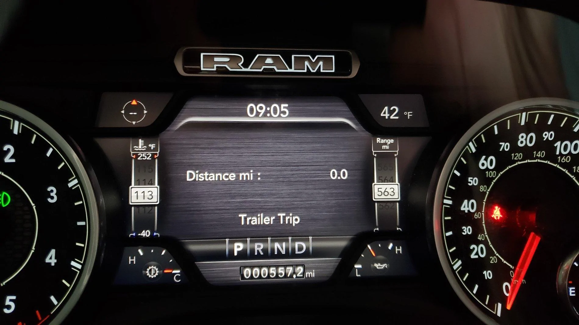

This is an example of what I was talking about regarding the factory controllers typically having more features. On the Ram, you have screens where you can adjust gain, track trailer mileage, etc. You also have memory for up to four different trailers so that your gain settings, mileage, etc. are automatic when you select each in the display. And, I believe that connecting a trailer "tells" the computer to adjust some parameters also (though on the Ram there is a dedicated tow/haul button unlike on the Jeep). Plus, this option is $250, which is exactly what I spent doing the Redarc aftermarket installation with a single control and no other features.
FCA needs to integrate the Gladiator controller like this for the 2021+ models. They should have had this ready for production BEFORE the Max Towing package was offered for sale.
That’s what I was talking about in an earlier post! Didn’t have any pics of it and my Ram was an older one so it had the smaller center display And didn’t have trailer trip miles but it too had memory for different trailers so I could set the gain setting lower for the flat trailer and higher for the 16’ cargo camper and select which trailer I was pulling that day. I bought a $10 adapter harness for my old Curt Discovery for now in case the factory controller doesn’t come out before my trip next month but am really hoping it comes out before that and has that kind of integration
BTW. Little jelly of the fancy integration you have right now. Lol
