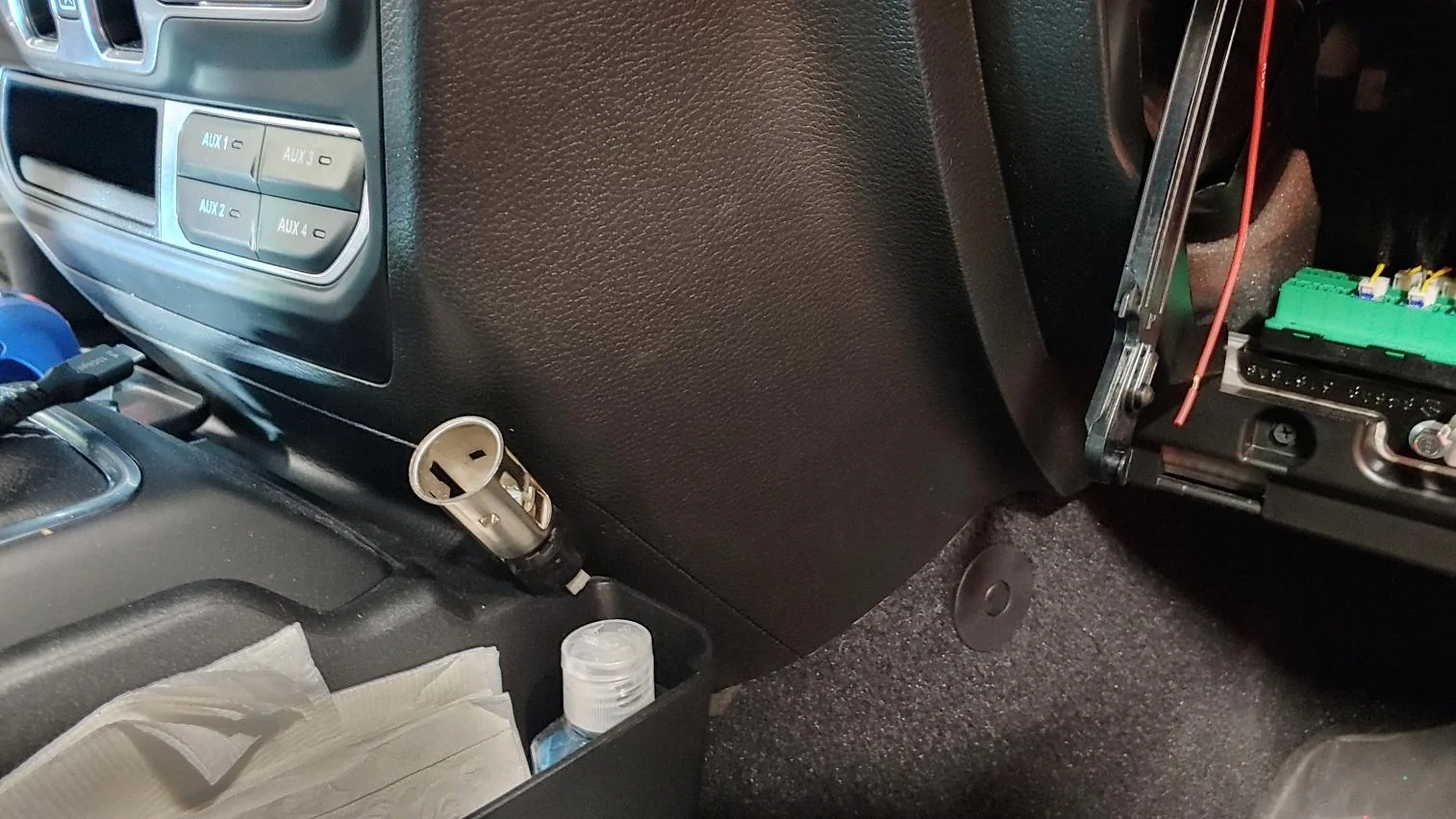

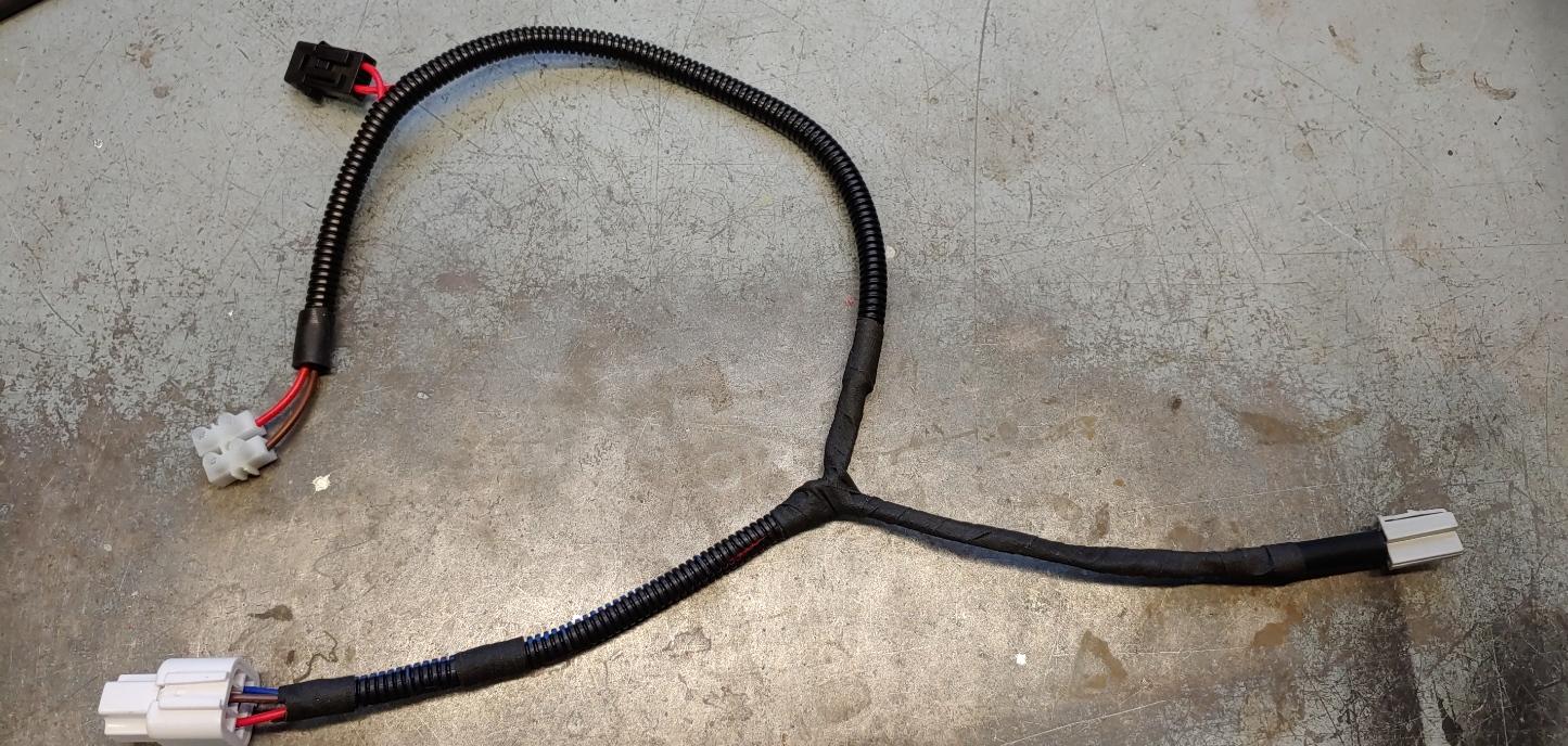

Even easier - make an extension and use the existing 12v outlet cable to power a 12v outlet. Gee, novel ideal - use a harness intended to power a 12v outlet to - gasp - power a 12v outlet!
I couldn't find the inside wires for my aux switches or I might have used the ACC power lead for my plow control, but since I had extended the 12v outlet wires over and that harness has a fused ACC lead coming from the 12v outlet circuit, I tapped into that for my snow plow control power.
I took the standard harness from Amazon that is intended only to give you accessory power from your 12v outlet, it's made to add a "power tap" - I extended it and turned it into a 12v outlet harness extension.
Jeep Gladiator Mopar factory trailer brake controller - my impressions and review 20201226_120858
Still have not actually mounted the 12v outlet yet - can't find a good spot for it that looks decent and won't be in the way of a passenger, but I'll keep thinking on it.
For now, it's just sort of stuck here................ (open to ideas)

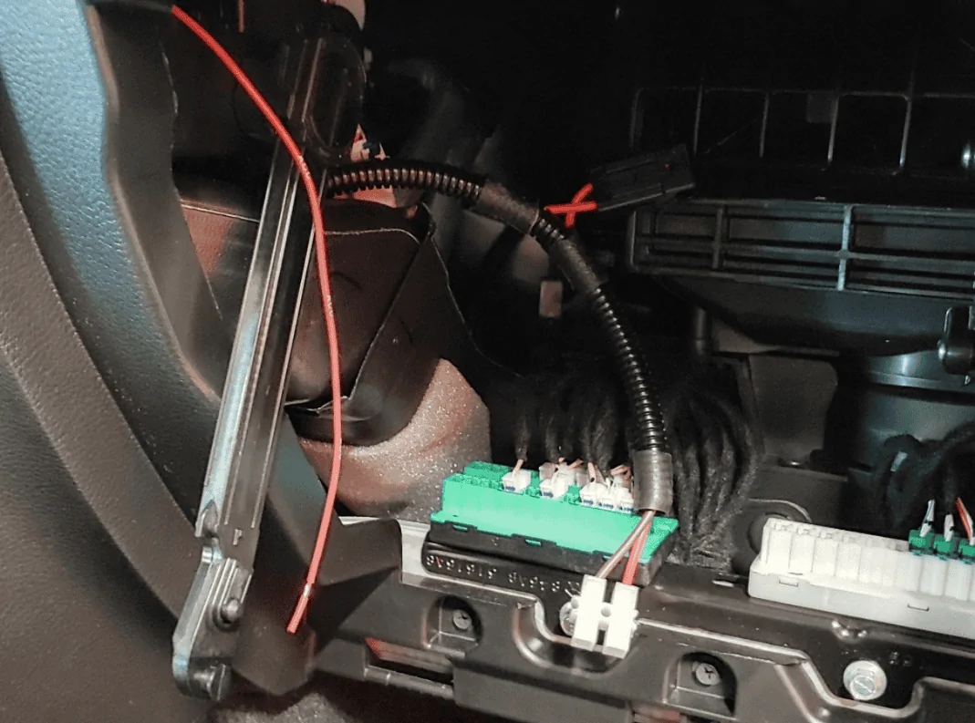

I used it on the Florida trip in conjunction with a 12v USB charger adapter that plugged into it and gave super-fast charging for my wife's new phone. Normal "fast chargers" just didn't cut it.
Red wire from snow plow harness - slip into the terminal from the 12v outlet harness - done.
(still didn't find the aux switch wires under there)
