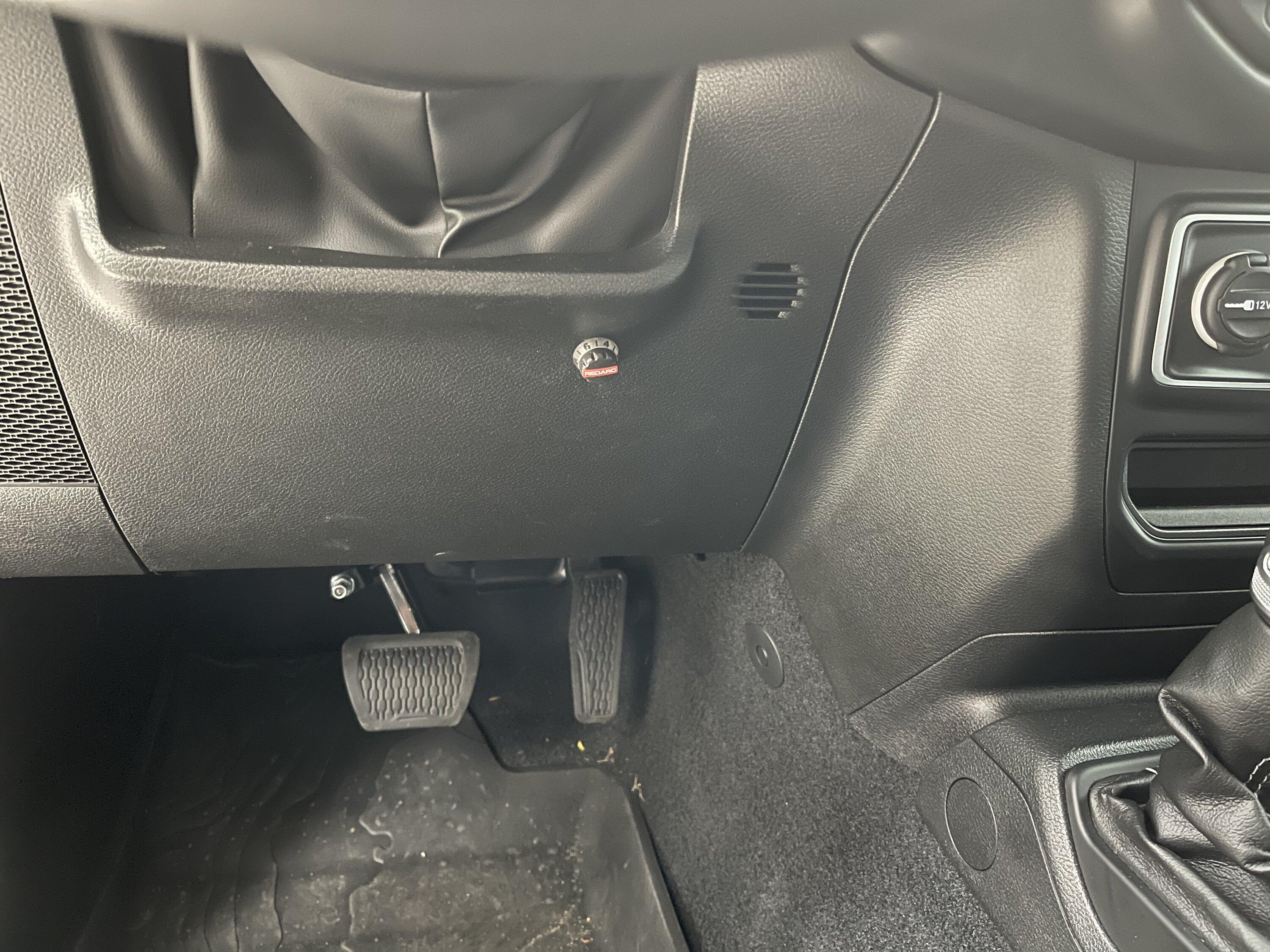

@Gren71
I've got a picture of the controller but I can't take a picture behind the dash!
just installed the same controller in my in-laws wrangler. He wanted to retain the 12v and asked for it to be installed here- (photo).
install was super easy and very clean integration.
