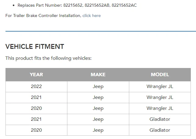

That is an option for sure. It would be easier just to install new, fresh, than to remove this one and mess with pulling things apart, hoping the cheap plastic of the dial doesn't break, and so on.
The part that confuses me a bit is that the ones for sale are not listed to fit 2022,
they fit 2020 and 2021 only.
I think the websites just aren’t updated. There have been no changes. Similar situation for my wife’s GCL Summit. Jeep gave me the pn for the brake controller and it’s avail. The instructions are even specifically showing pictures of the new GCL but everywhere I looked at said it was for the old GC body still - still to this day actually.
