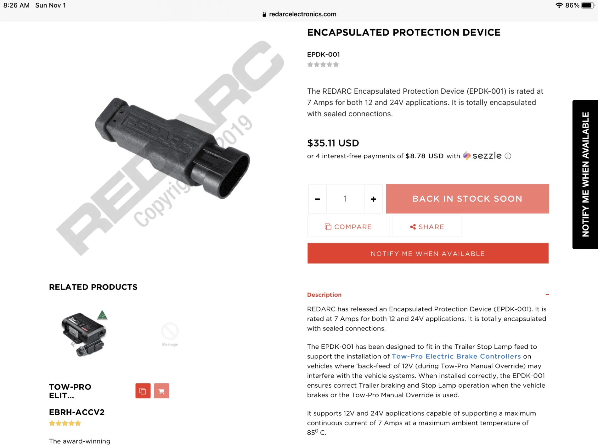

Can confirm that this also caused errors on a Launch Edition JT (which has the ACC option). Same errors as mentioned here, causes all sorts of lights to go off on the dash when you push the manual brake center button of the controller's knob. We did not test with a trailer hooked up though. Only other issue as others mentioned is needing to flip the controller on the mounting plate so the plugs faced the rear of the vehicle when the plate is mounted.

They may have added the diode to the factory harness knowing the controller harness wouldn’t have it. If that is the case then some 2020’s may also have it depending on build date and when the change was incorporated. If that is the case they should have an optional harness for a VIN range that needs the diode.
Now this is a good theory. 2 of the ones I’ve seen working were 2021’s and my 2020 is a July 2019 build, so this is very possible.

This appears to be Redarcs answer to the feedback issue
Jeep Gladiator Factory Trailer Brake Controller releases ...EDIT: STILL WAITING 041D8402-499B-404A-B795-97AC8EA916EC
