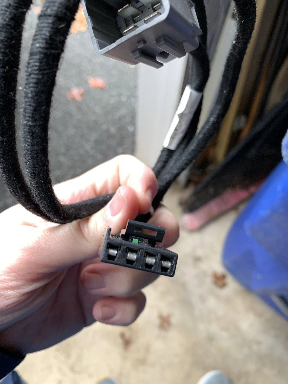

My controller arrived today, now I just need the rain to go away. Might be a tomorrow job at this point.
One thing I noted was that the controller has been speculated to be made by Redarc, however I believe it may be Tekonsha instead. I say this because the wiring harness that connects the controller box to the truck appears to have a Tekonsha connector on it. Here’s a picture of the connector from the kit harness and the one Tekonsha sells for their standard controllers, appears to be the same thing.
Jeep Gladiator Factory Trailer Brake Controller releases ...EDIT: STILL WAITING BBCEDA94-F553-43AB-873C-644C62AC0FD9
Jeep Gladiator Factory Trailer Brake Controller releases ...EDIT: STILL WAITING 00FA9482-968D-433C-BAB1-6085A0559CAD
I think you may be correct. I noted that cable and the the interface cable as well.
Plus all parts made in Mexico. I would bet Redarc, unless they licensed a design, would not be made in Mexico.
Both are good brands. I had the Tekonsha in my Chevy and it was fine except after 5 or 6 years the lever became impossible to move over to manually apply the brakes. It was like it corroded inside or something, otherwise it worked fine.
Mine also arrived today - will be a tomorrow job as it's cold again here and I have some plating to do and wiper motors to work on. My stuff has to wait. Tomorrow will be warmer, though.
Should go easy since all I have to do is remove the Redarc and put this in its place.

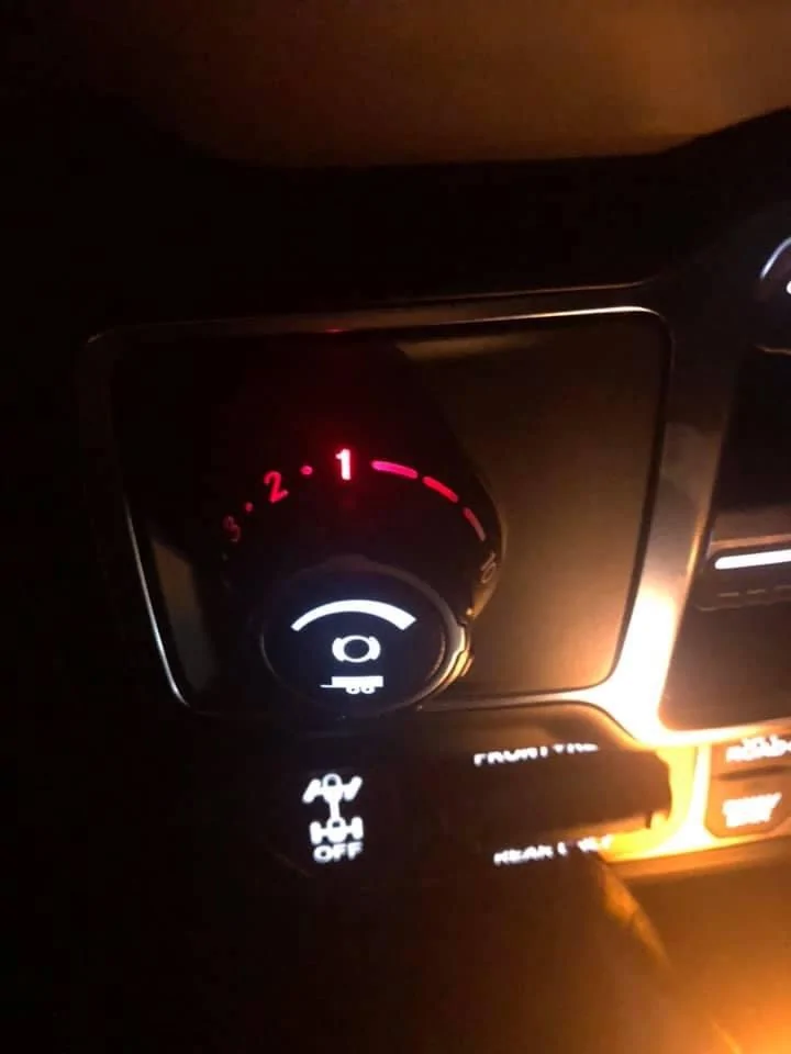

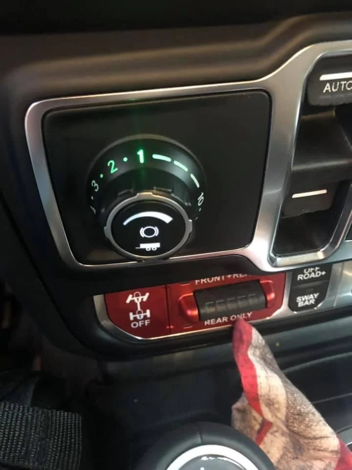

Did anyone else find their controller put together BACKWARDS???
Look at my real controller AS IT ARRIVED, then look at the "instructions" and compare how it really is to how they say it is.......
I still have not found the mount points - I find nothing with holes spaced like this, but before that, it appears I have to take this apart and turn it around??
Who else has actually installed one themselves - is the book correct, or did the staff in Mexico do it right and the illisturator screwed up?
Oh, and the controller must have the circuit inside to isolate it from the brake light system as there's no diode in the cable that comes with these.
Jeep Gladiator Factory Trailer Brake Controller releases ...EDIT: STILL WAITING IMG_20201030_130934
Jeep Gladiator Factory Trailer Brake Controller releases ...EDIT: STILL WAITING IMG_20201030_130946
