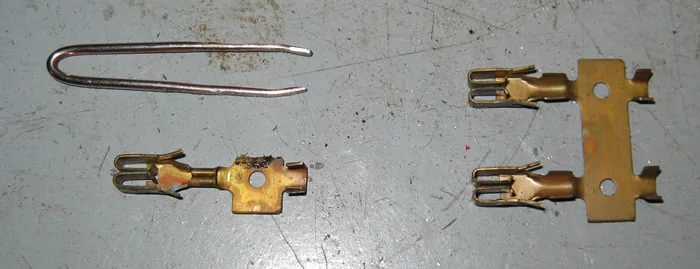

I'm not exactly sure how the connector you are working on is constructed so my suggestion may be irrelevant. Your local parts store or Grainger or Tractor supply (maybe radio shack, do those still exist?) should have a pin extractor tool. Youtube has loads of vids on pin extraction. be patient.
40,500
54,019
RadioShack went into bankruptcy years ago. No more stores.
Grainger would be a good source. There are flat and round tools, and of the flats, there are different sizes, there are types that you squeeze together, types with tabs....
and there's this type I made a tool for (fuse panels when I restore automotive fuse panels)

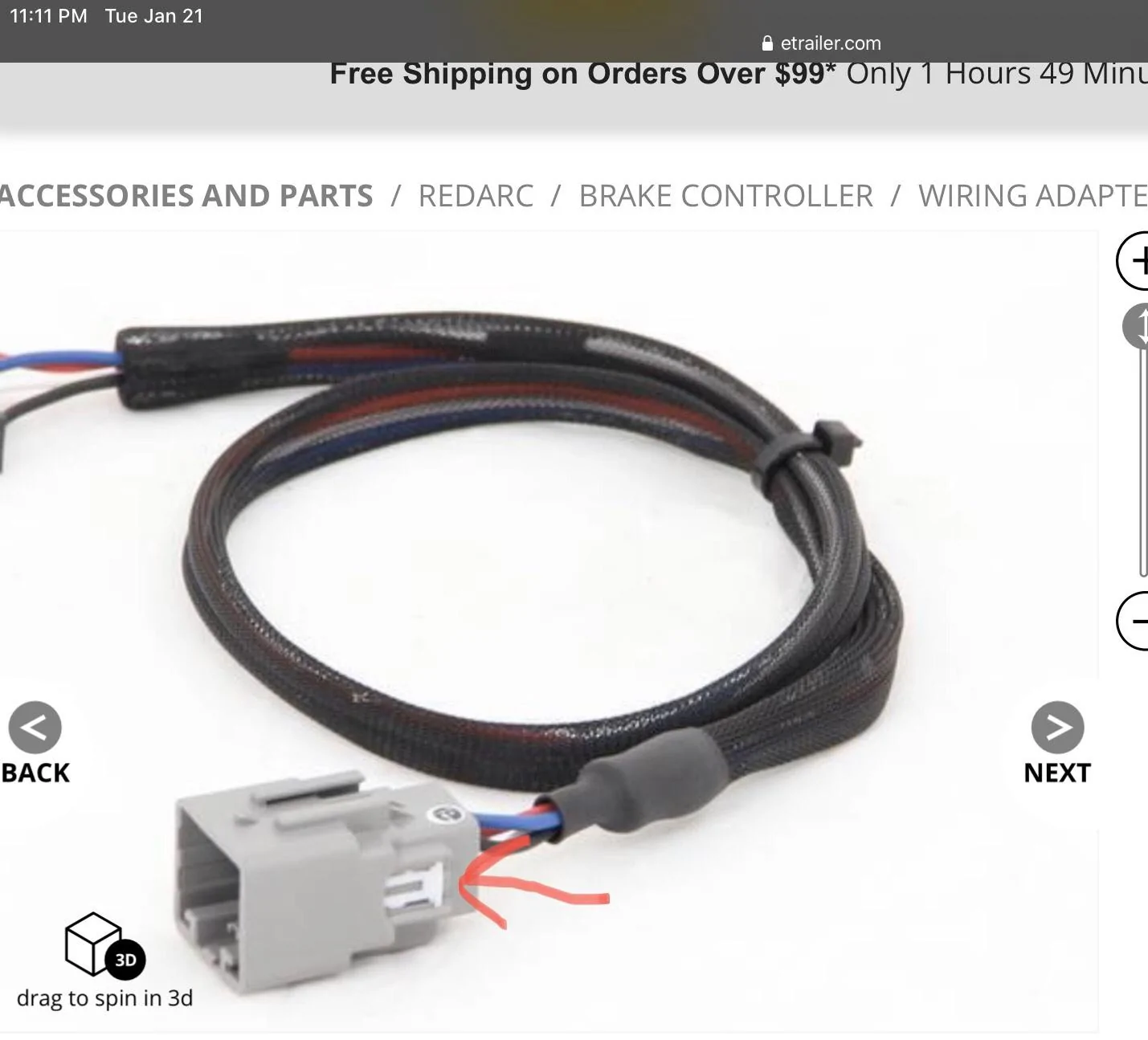

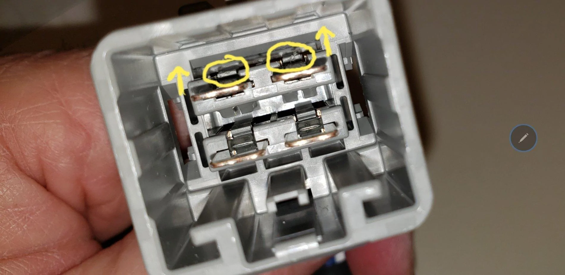

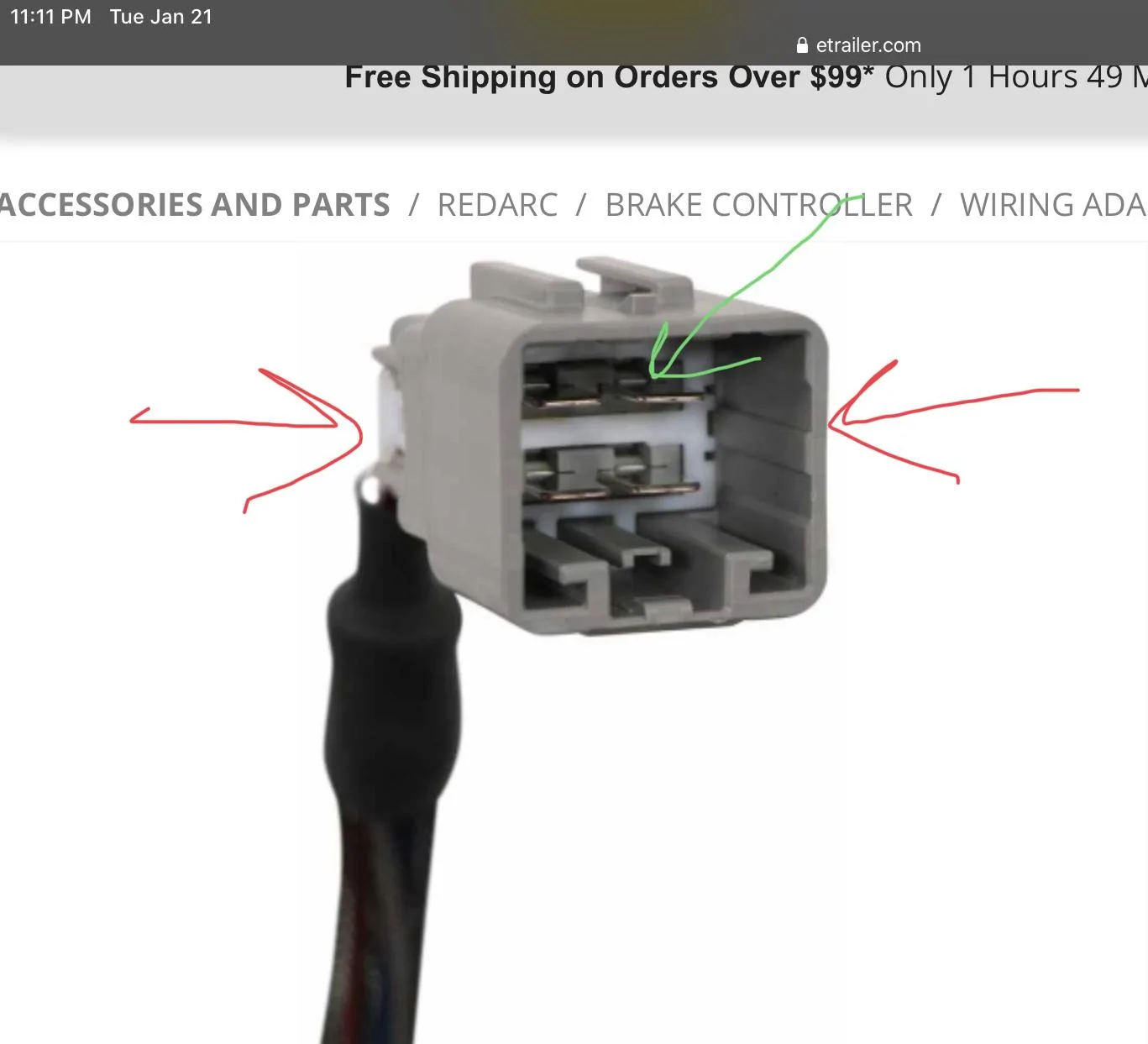

Im sorry I didn’t take any pictures of mine, so I stole a couple pictures from the eTrailer site, hopefully it will help some. There should be 2 white tabs on the outside of the plug, marked with red arrows in my picture. If I remember right, you pull them out some from the connector, the slide them towards the connector opening. Once you have both released, the entire white section should come out of the opening. One you have removed that, you can look inside on the pins where I put the green arrow and you should see a tab on one side of that pin that holds it in. Using a small screwdriver or pick, you can push that tab up out of the way so that you can slide the pin out the back of the connector. Do the same for the other wire, then swap and push them back into their new locations until the snap in. Then the white retainer just pushes back in from the opening until it snaps in.
I can try and pull mine back out if you need me to for better pictures/video but it might be a bit before I get to it since I’m pretty busy the next couple of days.

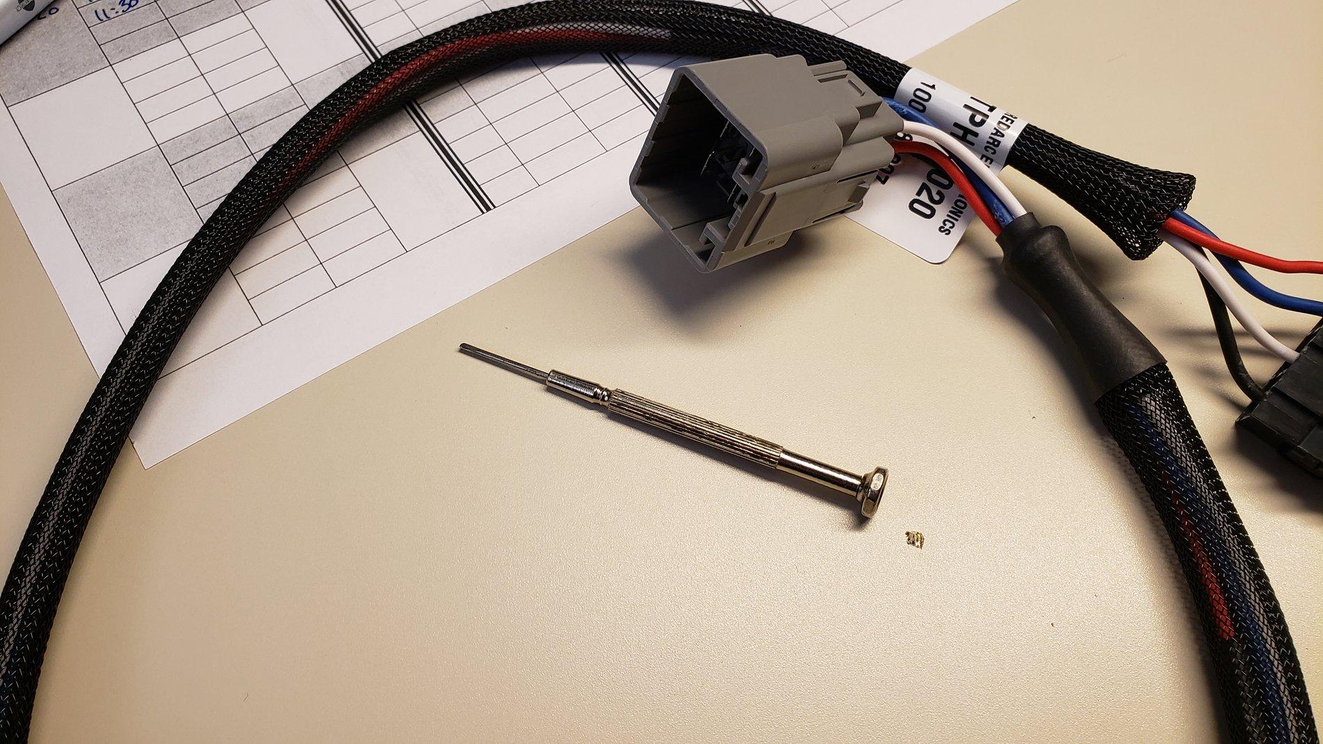

Thanks, I just wanted to make sure I was going after the correct tab. Like I said, didn't want to break it and it's difficult to see inside there. I ended up trying a variety of tools I found laying around and finally found one that was able to hold the tab up enough to pull the spades out. Sheww..what a pain. But it's done now. Thanks again.
