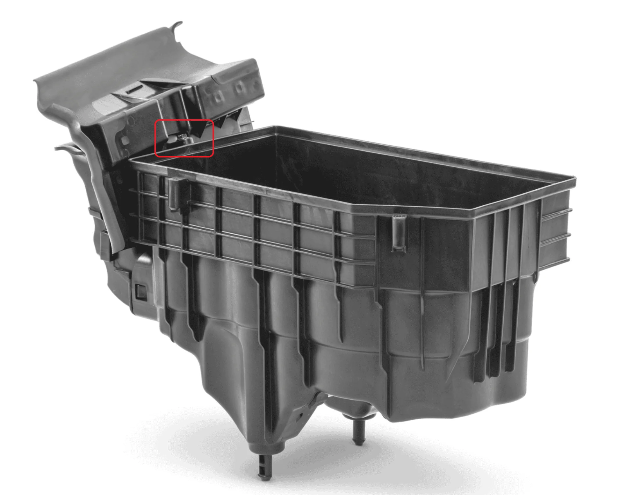

Hi all,
I'm looking to see if anyone knows what the screw size/part number/etc is highlighted in the photo below. Mine is missing and probably my own doing a long while back when I removed the air box to route winch cables and forgot/lost it. It has a slightly lose connection to the other part that is clipped in that hangs over the engine bay rail. Thanks for any info.
Also, I noticed that the air cleaner body doesn't seem to be secured from the bottom all the way. Does it require a lot of pressure to get those grommets pushed through? My truck is kinda high up so I might not of had enough leverage to push down on it. Might need a step to get above it and push down.

I ask my dealer where my air compartment lid screw was.....they said they ALWAYS discard it because it is the one most difficult to access. Your dealer should have a bin full of those!

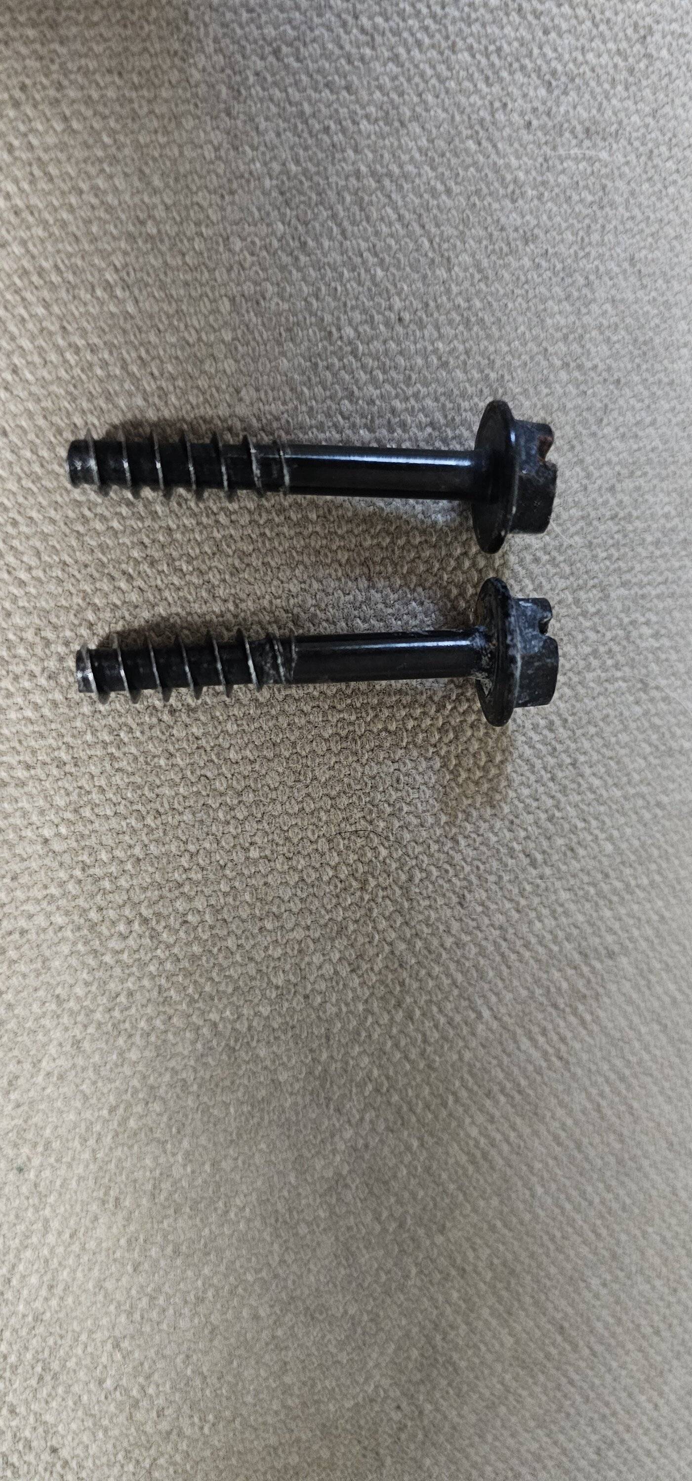

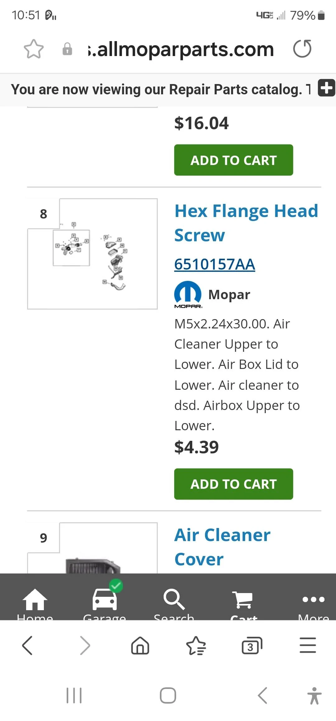

Is the bracket screw the same as the cover screw? The bracket screw looks larger and is very easy to get at.
Lost1wing
Tim
Dec 22, 2020
2,609
2,860
West Georgia
Retired AMT
Same screw. You are correct, but you knew that already.
Bracket screw next to the cover screw...
