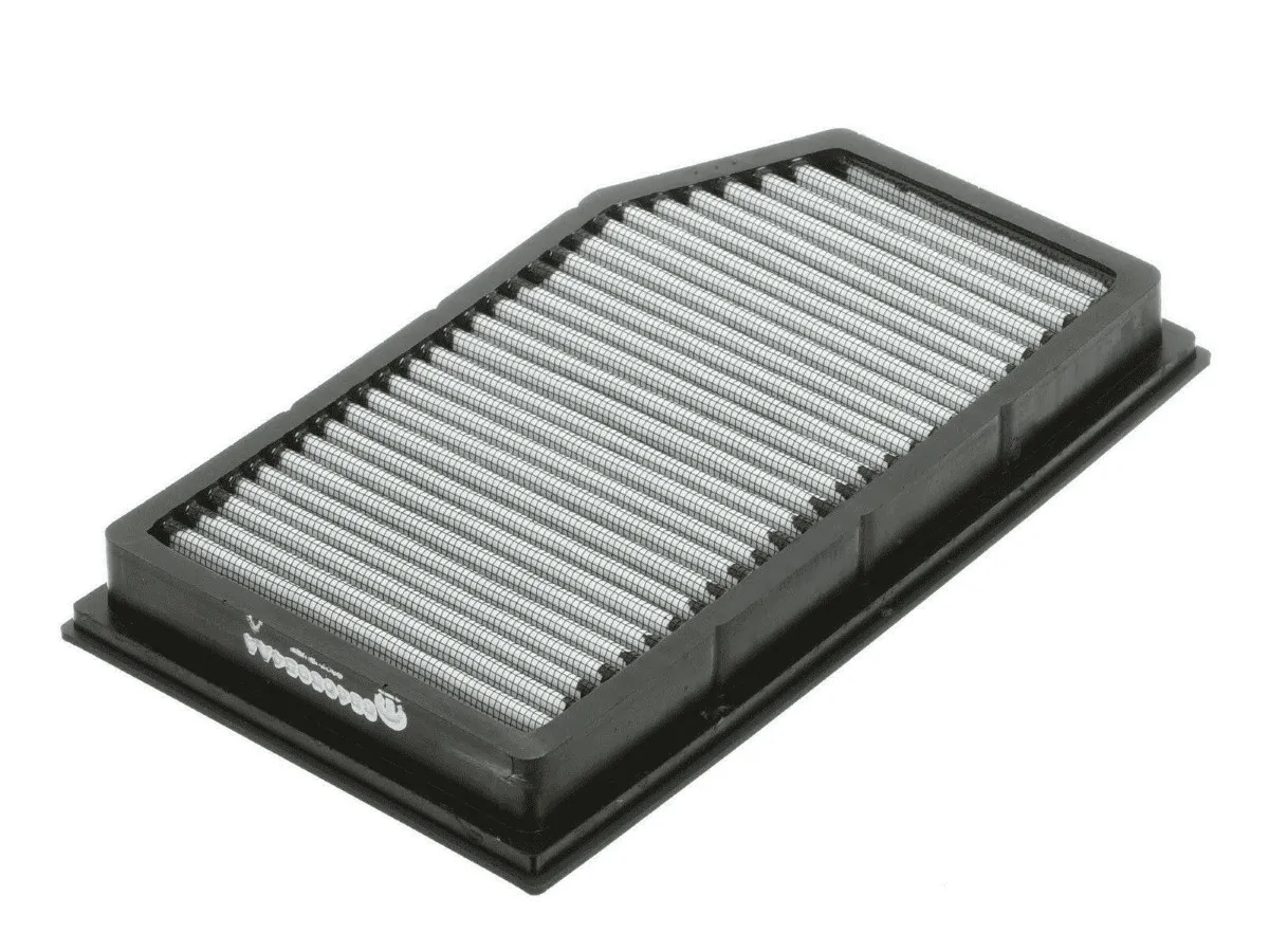

I agree when it comes to intake manifolds. Engine masters did a yt video comparing air filters on a big block. Obviously different and not definitive, but an actual results
The air flow through an engine starts at the air filter and ends at the tip of an exhaust pipe.
It's why I can do a teeny bit better with tall, funnel-shaped air cleaner stacks compared to just a stock air filter housing on my car.
Jeep Gladiator Post up your cold air intakes and experience? Looking for better mpg 1747168796532-7e
You have to be careful comparing things.
Our engines are also tiny - their ability to pump air is limited. They operate in low-lift mode up to 3,000 RPM. So they aren't even pumping near capacity in most situations. The majority of run time is spent with the intake valves opening only a fraction of full lift.
Small displacement, lower RPM, low intake valve opening and so on - they just don't need the CFM that anything beyond what we have offers.
Another video showing a performance air filter option on a Ford V8 showed a very slight improvement - in RPM over 5,000.
Do you run over 5,000 RPM for any appreciable time?
The air filter on these is actually the same size and capacity as used on slightly larger displacement engines in the past.
You just aren't going to gain on a tiny engine using low volumes of air and that spend much of their lives under 3,000 RPM - even under 2,000 RPM.
If you want MPG - run skinnier lighter tires at the suggested PSI, and drive accordingly. Don't lift it, keep the light bumpers and air dam up front, run a tonneau cover on the bed,
Keep air filters clean, run Top Tier fuel, use the recommended lubricants, keep the oil clean and so on.

lol. I’m not worried about mpg or hp. I’m trying to use available hp as soon as possible
probably not the best photo to prove a point. Again, not interested in mpg or hp. I know they won’t gain. Just am curious if there is a throttle response improvement. Not interested in a throttle controller either. I had one on a different vehicle and would intermittently set a tbody plausibility fault code putting the vehicle in limp home mode. Which cold air did you have?

lol. I’m not worried about mpg or hp. I’m trying to use available hp as soon as possible. Also, that
You won't change throttle response either. These are actually set in such way that response is deliberately delayed.
If you had one of the certain throttle re-mappers out there, yeah, they have been known to throw codes and cause trouble. IF I was so inclined to get better throttle response, I'd only go with the Banks unit. They are totally different in many ways.
I know enough about engines, response, intakes, filters and so on from decades of experience in stock and performance vehicles. I know enough to have not even wasted my money on a cold air intake since they already get cool air, and I know where the restrictions are and are not.
It's what I've done since the 1970s.
Funny thing - when I ordered my last JTs, even the sales guy going down the list of options said right out "no cold air intake, right?"
Right.
Take a deep dive into how the throttles are mapped on these. You might be amazed.
Again, since they are on low intake lift up to 3,000 RPM - the response will be sloppy below that level, aside from the fact that the pedal is programmed to delay said response.
