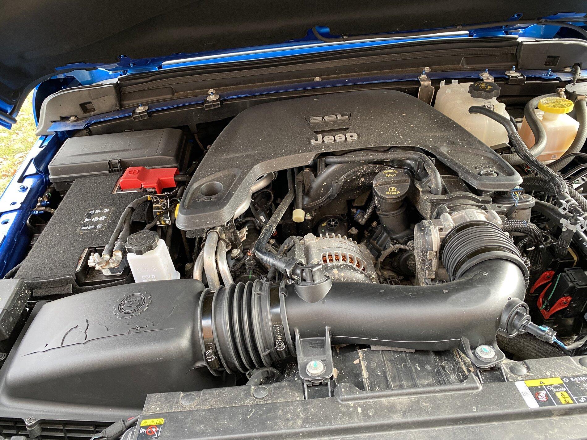

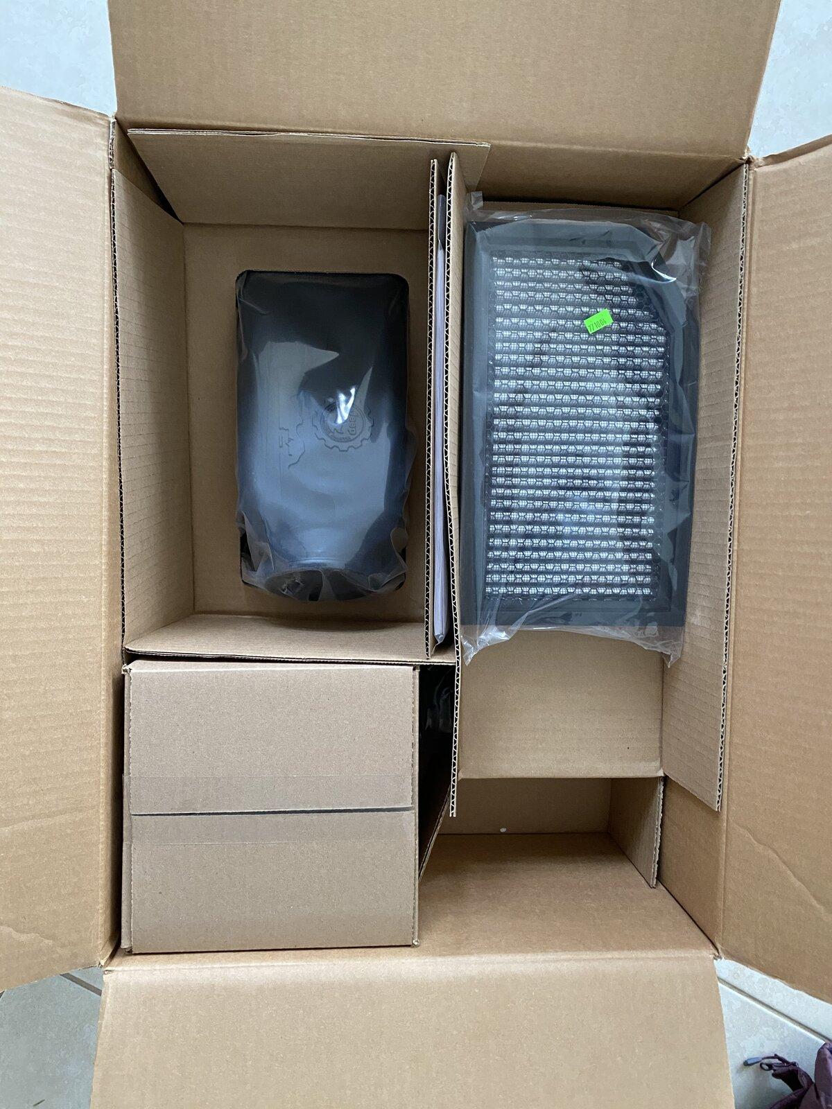

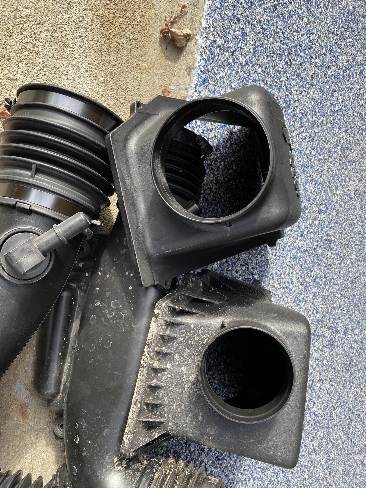

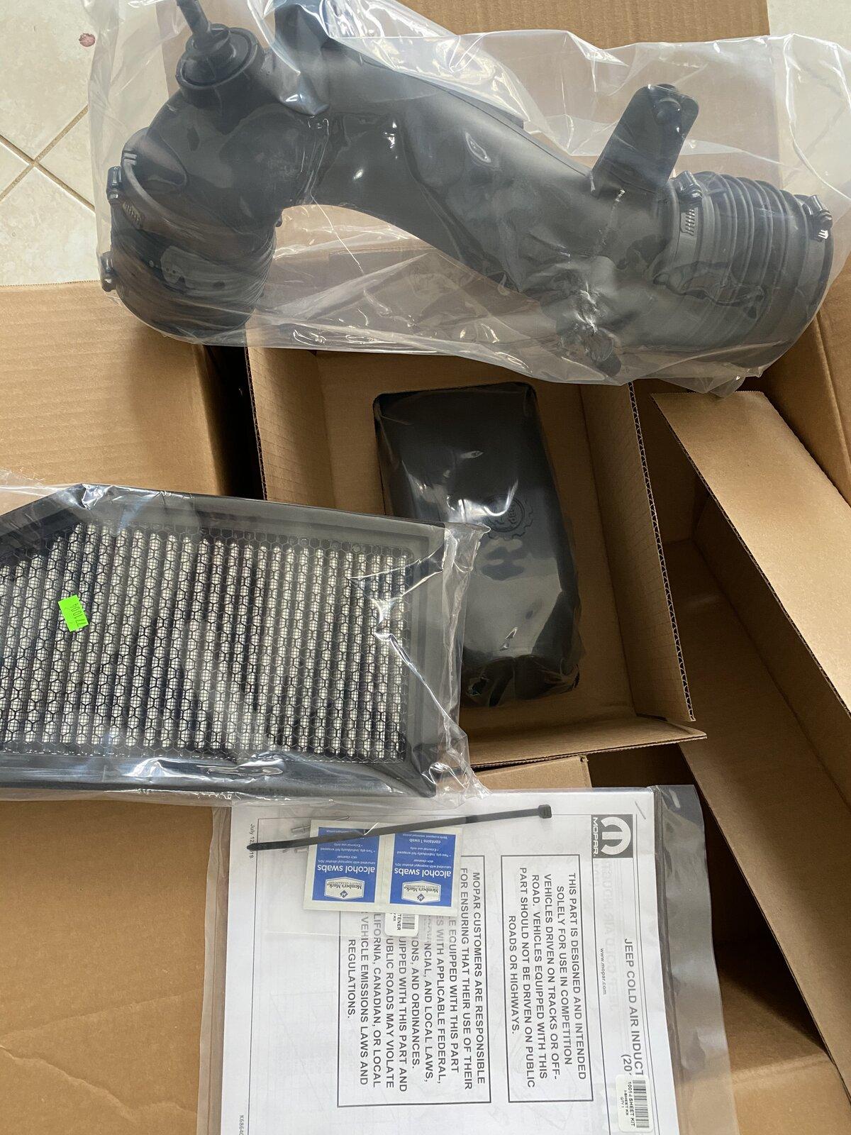

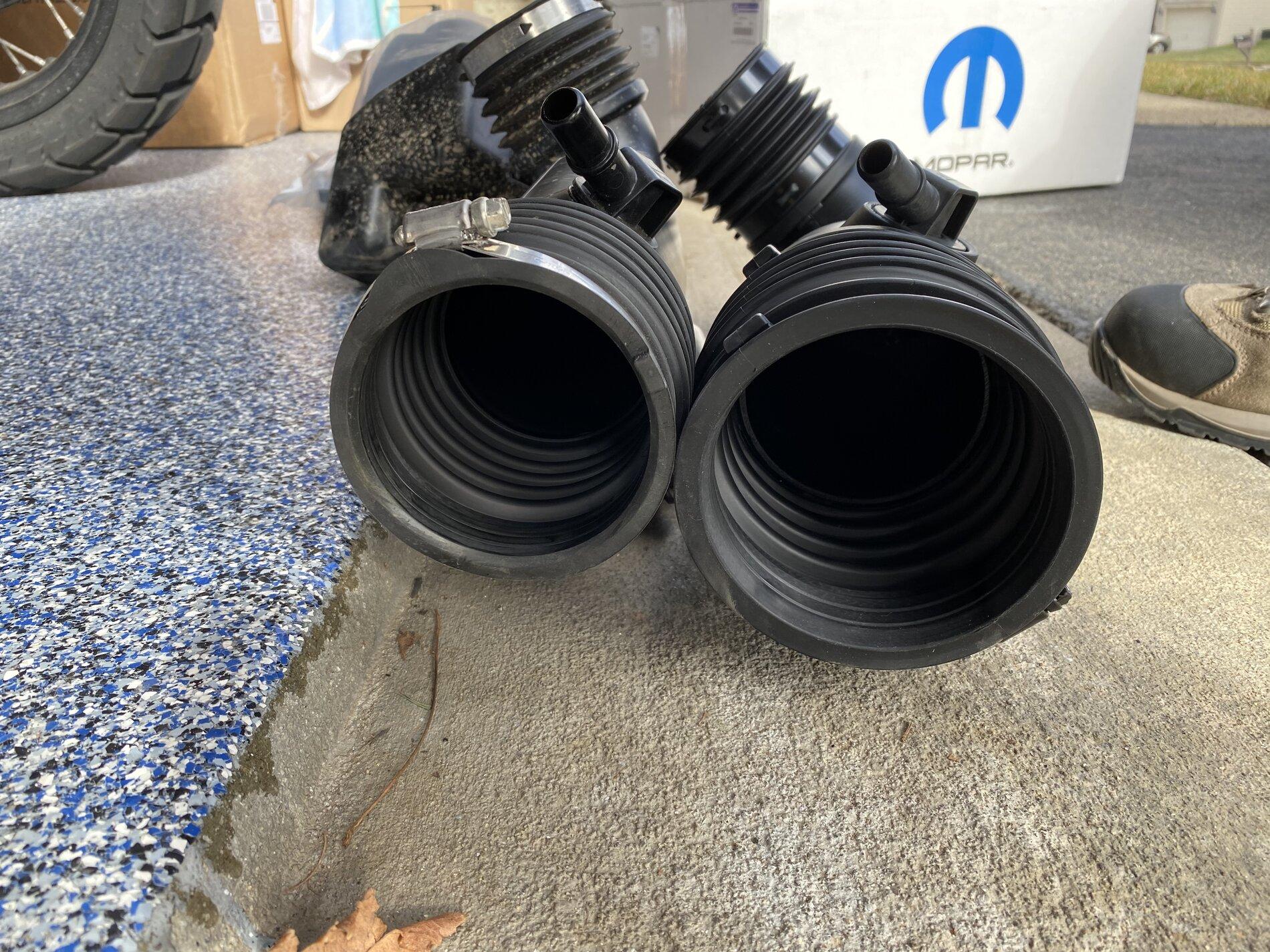

Gains
Jeep Gladiator Cold Air Intakes are a waste FCD16825-93F0-4F7D-8BE0-194D4BB9F0ED
Jeep Gladiator Cold Air Intakes are a waste FEDD187A-DC61-4042-AEF0-1502979DF6CD
Jeep Gladiator Cold Air Intakes are a waste 8F288591-2000-42B3-9B57-3BA57505A0C5
Jeep Gladiator Cold Air Intakes are a waste 9948AFBA-0947-4701-8A33-C312A1B81A79
Jeep Gladiator Cold Air Intakes are a waste B99ACEF7-6019-4052-981C-98519C06D11A

Filter size, box size, tube size, air velocity are also at play

i did not install the hood cut grill. A snorkel is the only reason I would cut my hood.
it picked up power up top, and further helped the pedal feel. The sound is great. Not too loud or obnoxious, but a nice tone when you stand on it. It also decluttered the corner of the engine bay where those stupid resonators were before making getting the pulsar in and out a lot easier For dealer visits/reflashes/updates. Its also nice to be able to run a more performance oriented filter commuting on the road and be able to drop a paper filter in for the dusty conditions out west.
im curious to see what kind of MPG increase it nets, but It’ll depend on what happens with STFT. the Pulsar netted me damn near 4mpg, Id be ecstatic to see 1mpg. I had a 200mile all combined mpg of 18.9 last week. Pretty good for 37’s and 4.10’s.

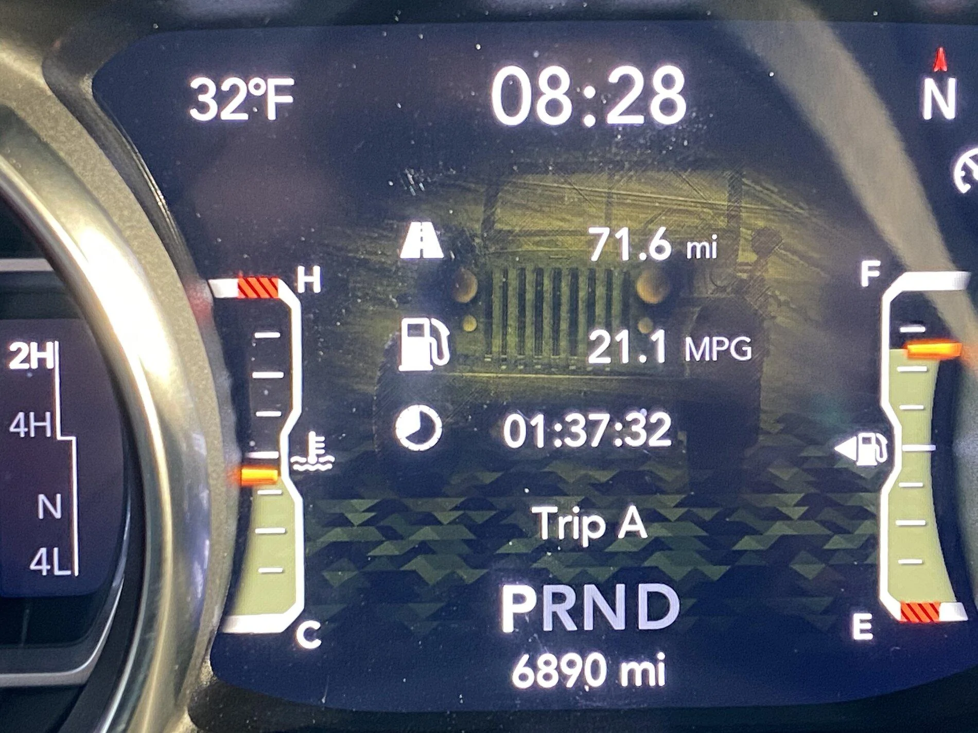

commute loop half done......its looking promising to say the least.
KurtP
Kurt
Oct 9, 2020
68
2,310
3,020
VA
S/C Mojave
Only Fans Content Creator
same loop i always drive. Mix of interstate, highway, stop light to stop light, and rolling hill country road. Its about as “combined” as a loop can be. Drive is the same. Accelerate from light with traffic, on highway and interstate i do about 5mph over. Cruise control used as much as possible.
-my average stock on stock 33” mud terrains was 18.5. All time high was 20.4, which i only saw once.
-i did not complete the loop stock with pulsar only
-37” AT’s and Pulsar was driven 3 times. best of the 3 was 18.9
-today with 37’s, pulsar, and mopar intake. the drive was overall pretty clear minus some city congestion that held me up a bit. so probably not a record day, but a high-average day would be my guess. There were two hills that i track where it stayed in 8th with the intake that it downshifted to 7th without.
-pulsar is always set to 91oct “performance”.
que point and sputter.
Jeep Gladiator Cold Air Intakes are a waste FE6BC57E-6858-4CF9-A140-162AEB6DEBA8

113.5mi; computer said 22, hand calc was 21mpg. Pulsar, mopar intake, 37’s and 4.10’s.
its almost like they work.
