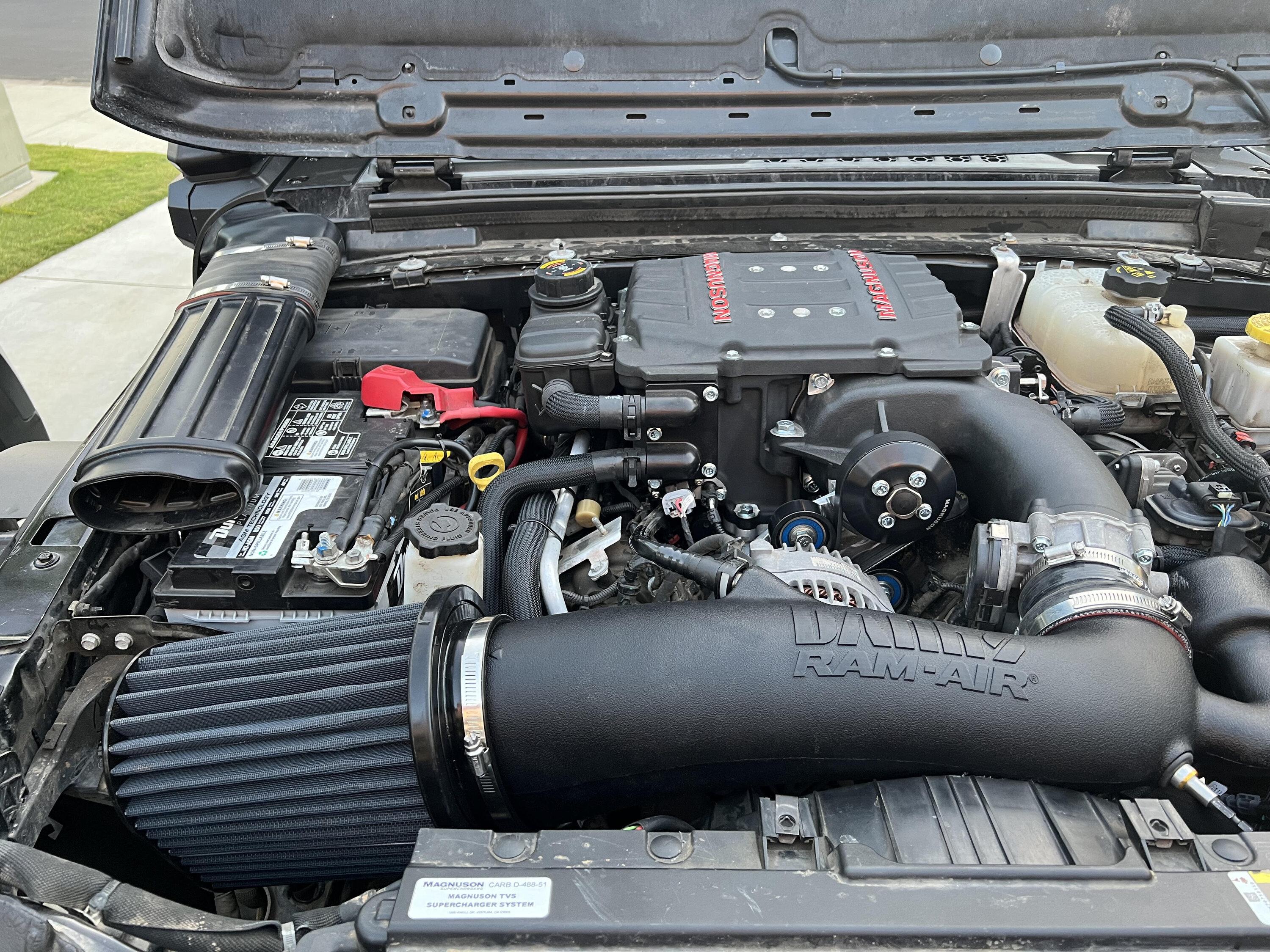

Pros:
Makes my Supercharger whine
Cons:
Sucks for water crossing(i remove it and put my stock box back on during raining season or any trip that requires crossing rivers)
I have BorlaAtak cat back so it goes well together. I did gain power but thats more do to more breath for my SC
