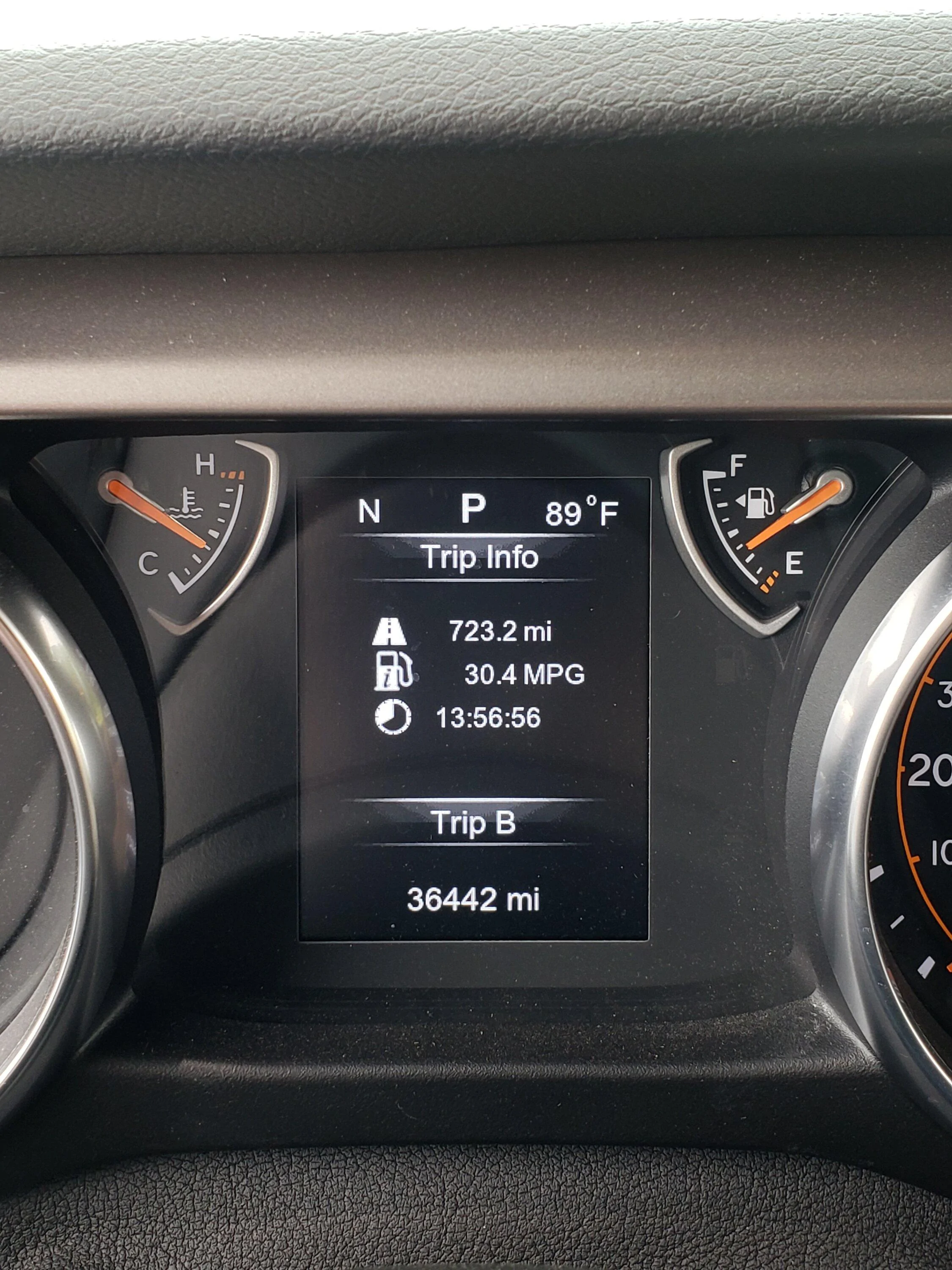

You guys just don't know how to drive. Lol. Always drive downhill with the wind at your back.
