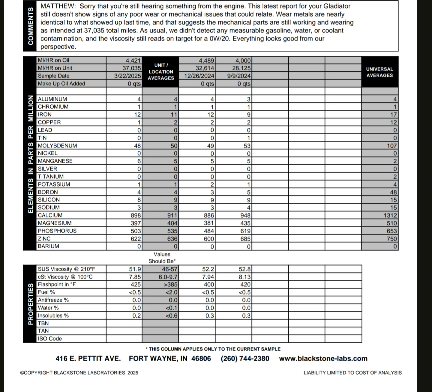

WncMatt
May 5, 2023
Western NC
2022 gladiator sport max tow
Farrier
Towing 3,800 lbs 5 days a week
Western NC
Pennzoil platinum 0w20 ( probably try something different soon) .
One of lake speed jr videos I noticed he was trying to get the iron ppm to 5 or under on his car.
Jeep Gladiator Post up your oil analysis. Screenshot_20250807-170956
40,493
54,052
Western NC
You have to put it in the perspective of how many miles are on that oil. the PPM will increase with more miles on the oil and it doesn't mean a worse analysis.
So we can't compare without knowing how many miles were on this oil.
If you changed it at say 3,000 miles and someone goes 10K and has double your numbers, theirs may still be better than yours.

It's says on the analysis... 4500-5000 miles

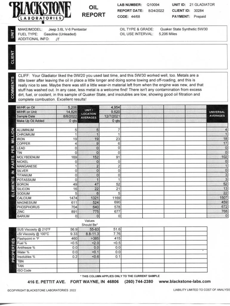

cb4017
Cliff
Feb 15, 2021
36
519
990
Northern Nevada
2025 Gladiator Mohave, 2005 Jeep TJ Wrangler Sport
USN Retired, FPD Retired, CHSO Retired
Here are a couple from my 21 Gladiator. At 9,620 miles was M1 EP 0W-20. At 14,826 miles was QS Full Synthetic 5W-30.
Thanks for understanding the post ! I just thought it would be a cool data point if everyone posted up there oil test results to one spot.
