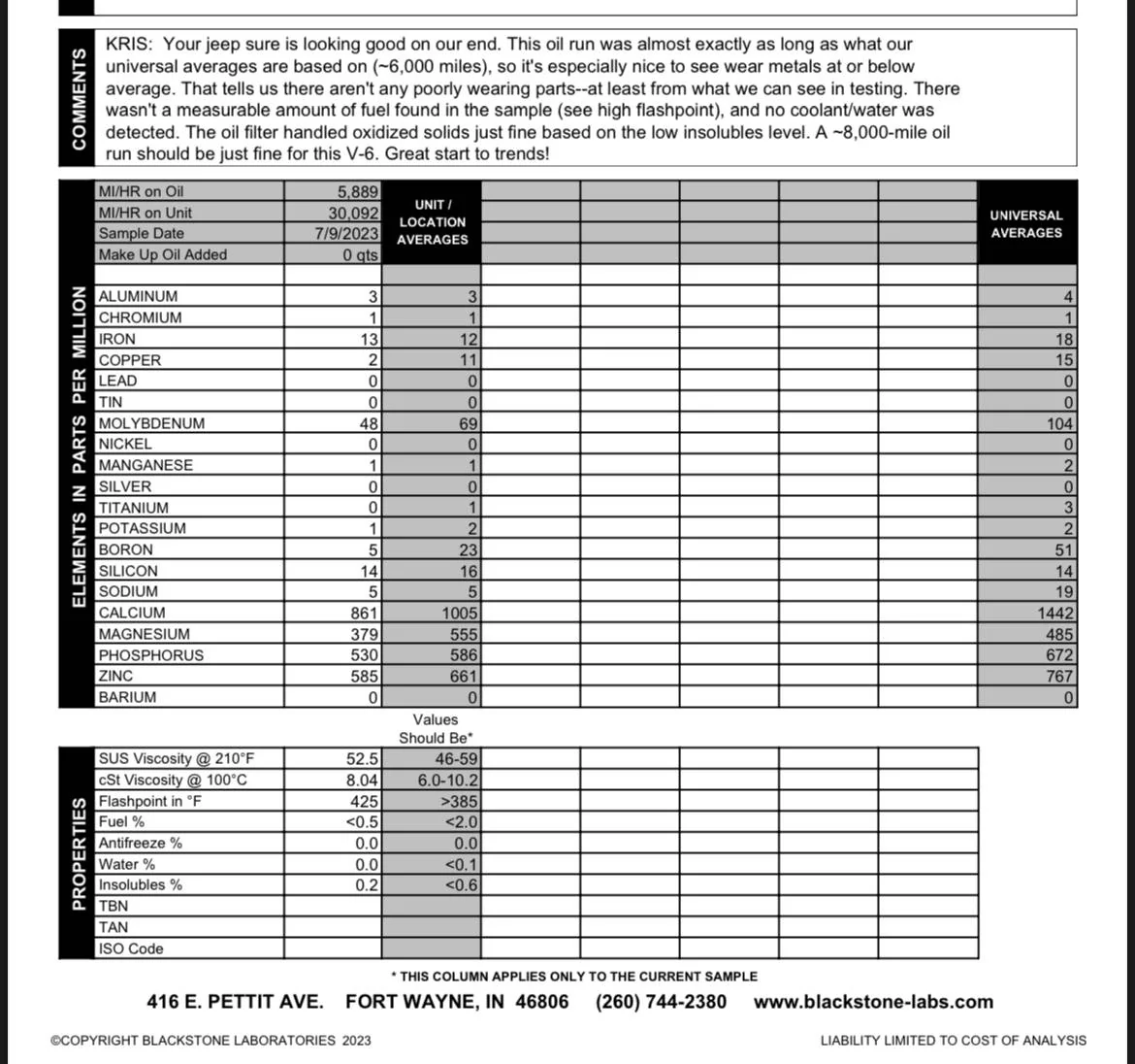

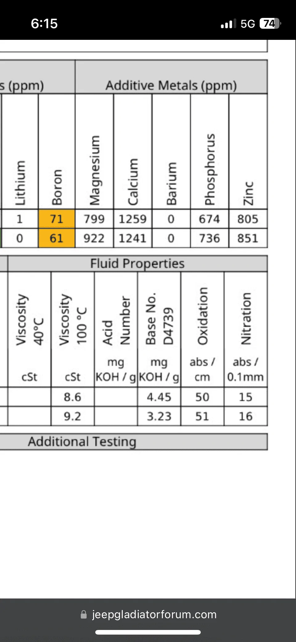

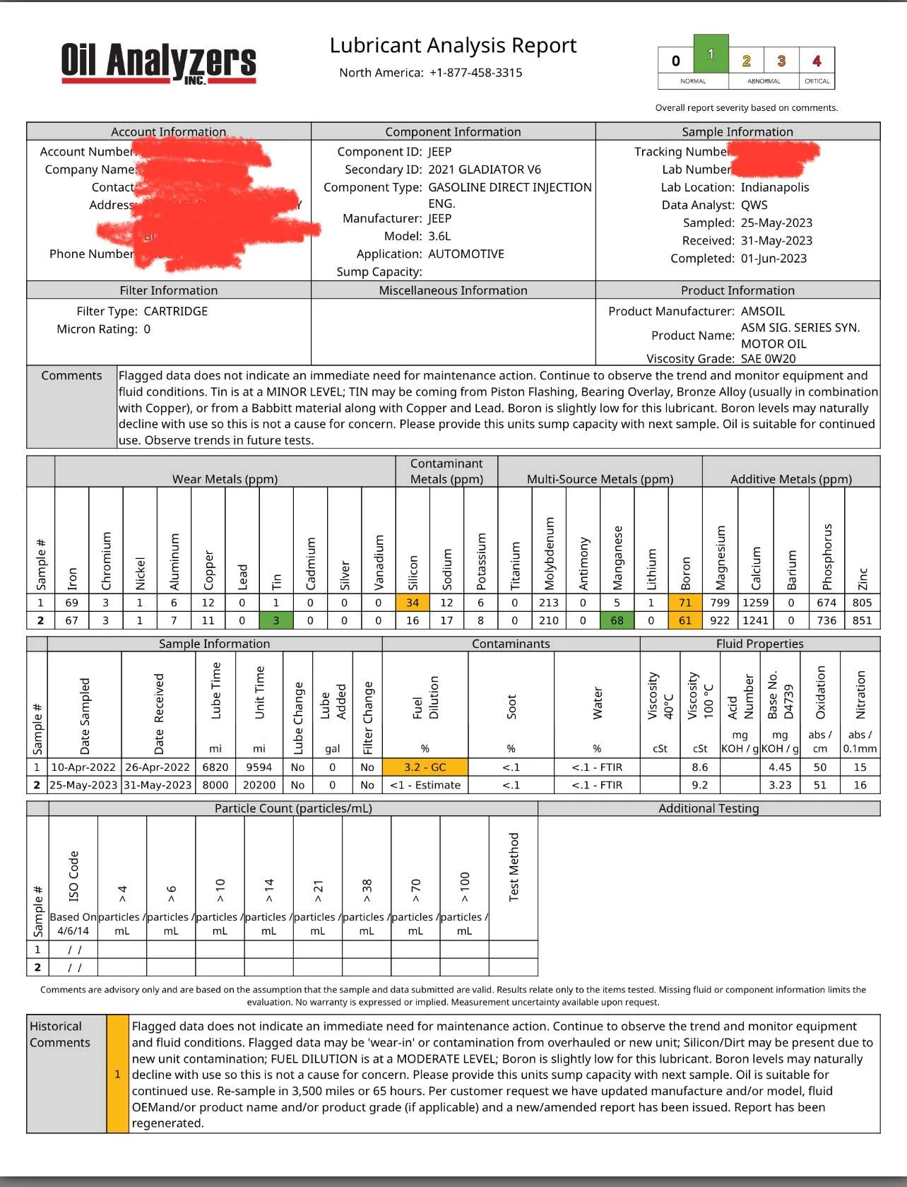

30K mile JT oil analysis
40,493
54,049
That’s the acid test and the base additives to keep the acids from building up. 2.5 and the additives abilities to keep the acids at bay are done.
I need to post some photos of acid-etched bearings and the pinholes in a couple of oil pans I have......... acids, moisture. Short drives and too long oil change intervals.
I don't care what Amsoil says - we're not typical consumers, and they aren't replacing a toasted engine if I exceed what the engine maker says. I don't like giving them excuses.
The bit about tin, babbet and so on assumes old-school bearings. These bearings are very different with a different surface so there should be little to no tin from crankshaft bearings. (can't speak to the cam bearings, however.......)
